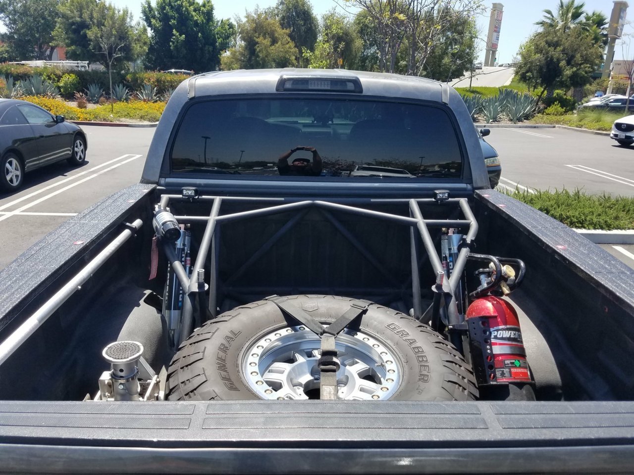

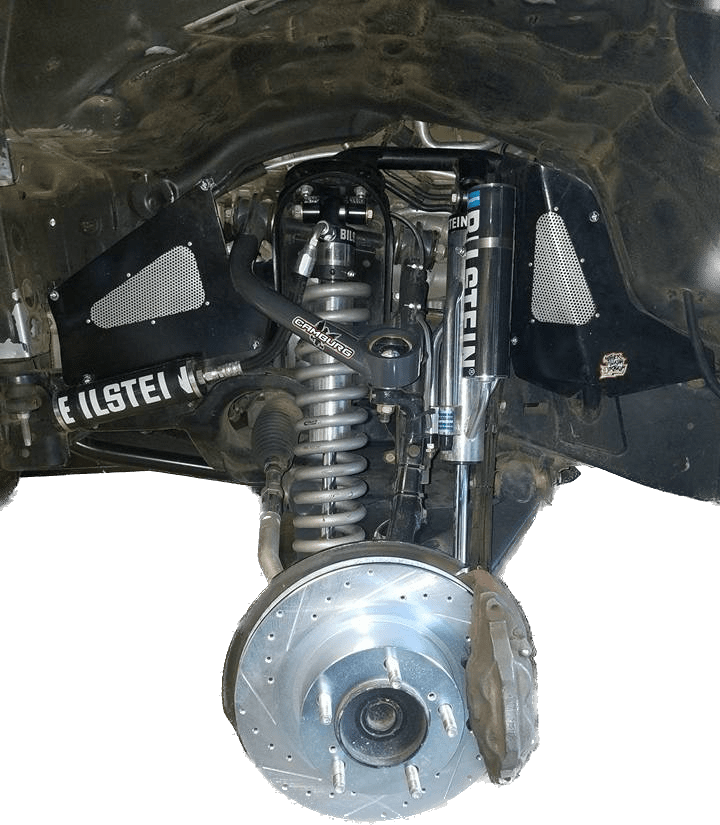

    Curious. Did you have them re valved or using them straight out of the box? They are great for fast over washboard! Had my friends beat on their King and Fox shocks. They felt like they were going to lose their kidneys after. One of the friends has since switched over and not go back to other shocks. Yes pricey. And well worth it. They are also good over the slow stuff and not feel too firm. Their whole thing was whyyy did I go for the brand least used in Baja?!? In my eyes they are coming way up in the off-road world as I been using them in my old tundra since 2017 and in my 2018 taco. Here on my 07’ tundra(same as the one in my thumbnail pic. Converted frt end to 2014)
    Sorry. No pics in the 2018’ taco. Did a bad lawn dart at Pismo beach. Whoops!!

    I see. Yeah. I did have mine valved for progressive as I never really use my truck as a truck for hauling anything. It’s mainly just going to be used as a daily and off road ride. The rear of the tundra was rendered useless after the suspension mods. It was fine. Like I said above lol.
    50881265-D2F4-4FBD-9CD7-AFD3144956E2.jpg BBD35D66-DD58-4EC5-9A4F-35474BD70BA0.jpg
