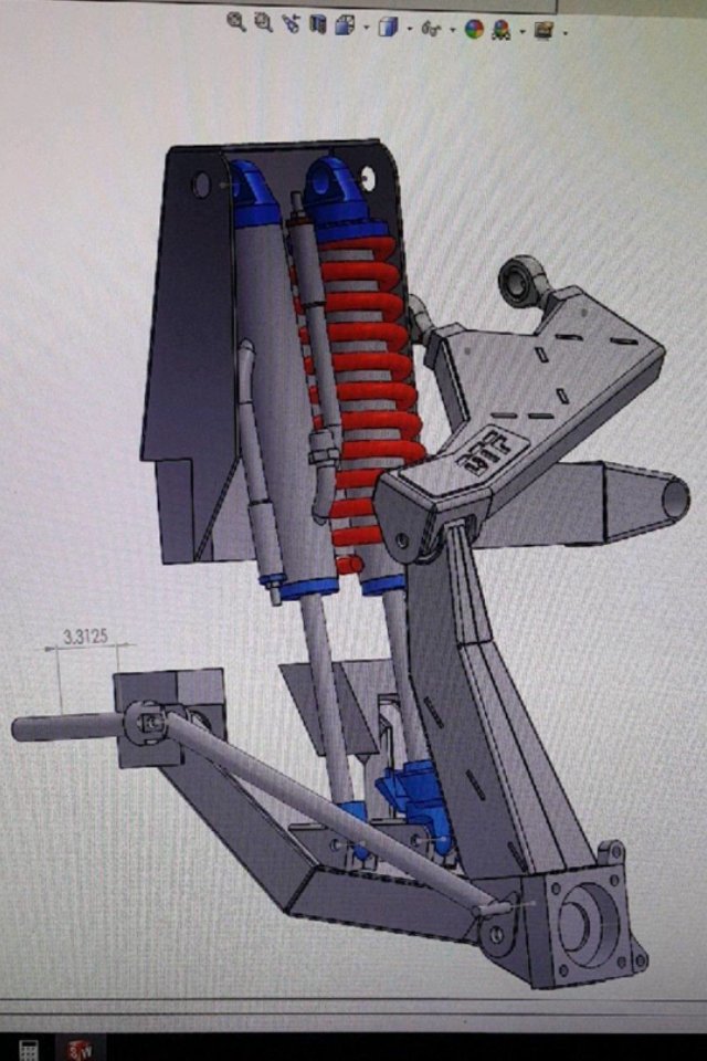

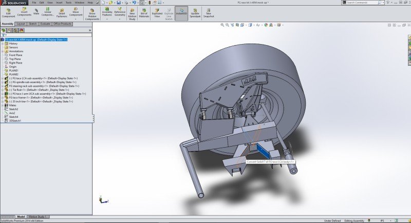

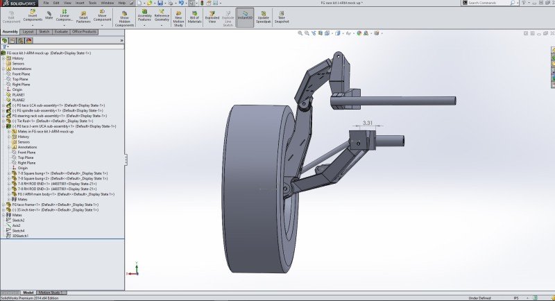

    What is the advantage of that J-arm type upper? Or is it just a packaging decision?
    DTFtacoma likes this.
  5. Jun 30, 2017 at 2:20 PM
    #205
    MadTaco461
    MadTaco461 BRO runner
    Dec 30, 2009
    #28470
    13,426
    CA
    99 turbo 5 lug long travel
    Kinda stock

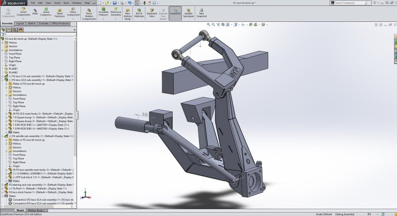

    Only advantage you really gain is if you are having a hard time stuffing in parts. J-arm becomes mandatory on Center Mount suspension because the J arms would go in front of the motor. This design won't buy you anymore than the UCA wrapping around the shocks like the kit out for the 2nd gens. This design sure looks cool. You do need a strong engine cage to handle a J-arm. Puts a lot of force on the little toyota frame.

    Thanks! I've got lots of time into it.
    :thumbsup:
    My J-arm actually reduces the anti-dive angle and allows for a little more wheel travel.
    Also makes it way easier to fit a 3.0 bypass on a first gen tacoma.
    The j-arm mounts with be stout! :benchpress:
    :mudding::mudding::mudding:

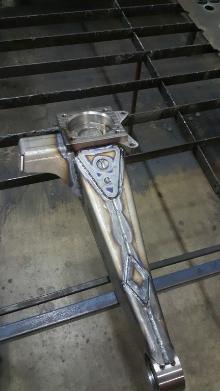

  9. Nov 9, 2017 at 12:10 AM
    #209
    DTFtacoma
    DTFtacoma Dezert Toy Fabrication Vendor
    Mar 5, 2009
    #14364
    6,951
    Anthony
    Santa Maria, CA
    06 PreRunner D-cab
    DTF LT front & rear

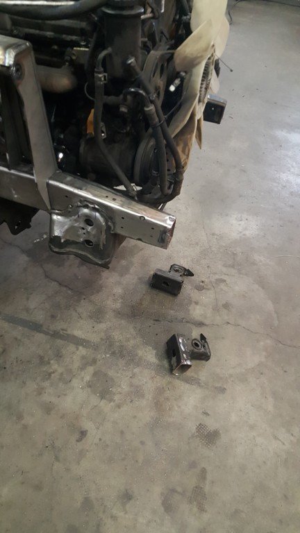

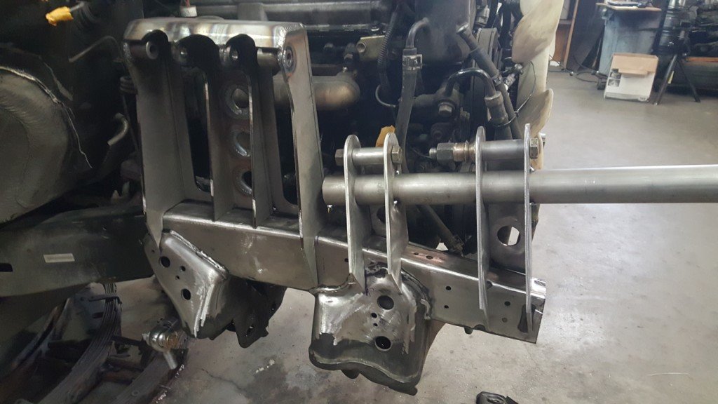

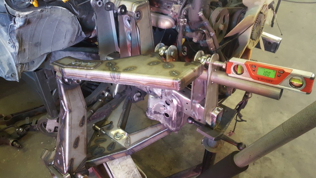

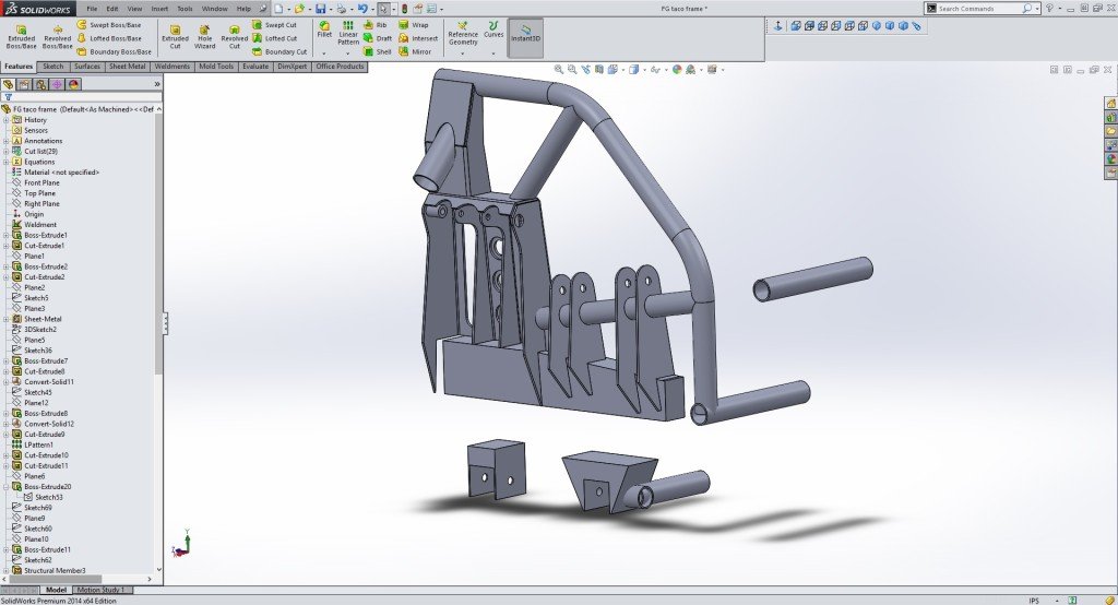

    Hmm..
    Migged up.
    Cleaned up.
    Tacked up.
    Mocked up. :dancingbacon:

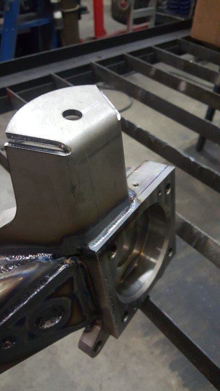

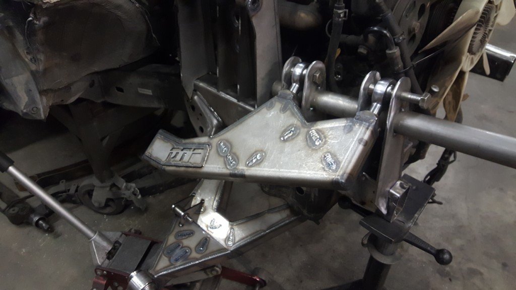

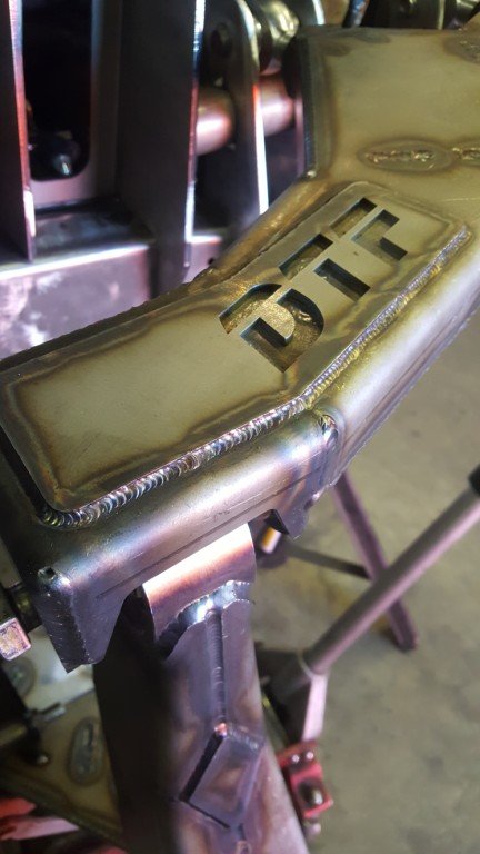

  10. Nov 9, 2017 at 12:12 AM
    #210
    DTFtacoma
    Mar 5, 2009
    #14364
    6,951
    Anthony
    Santa Maria, CA
    06 PreRunner D-cab
    DTF LT front & rear

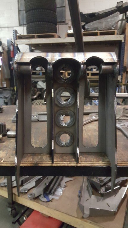

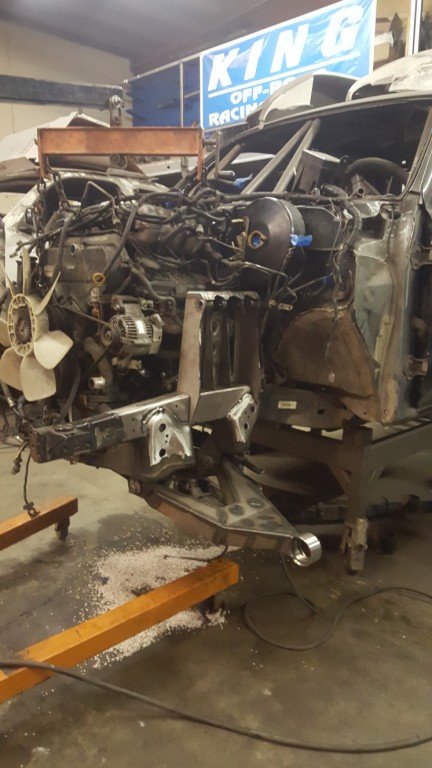

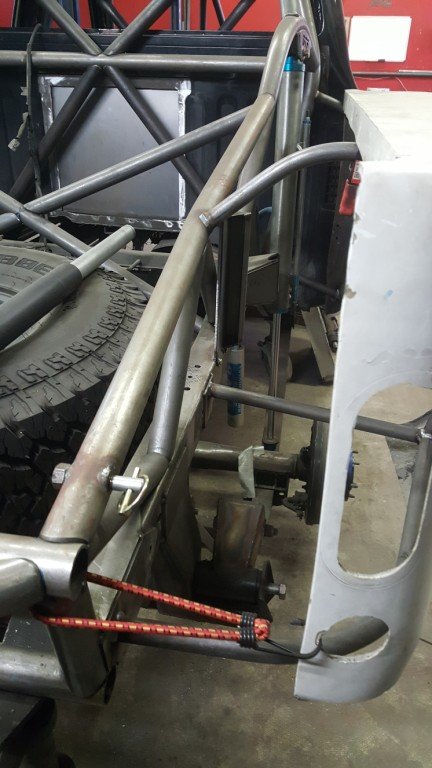

    Bedsides mounted

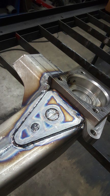

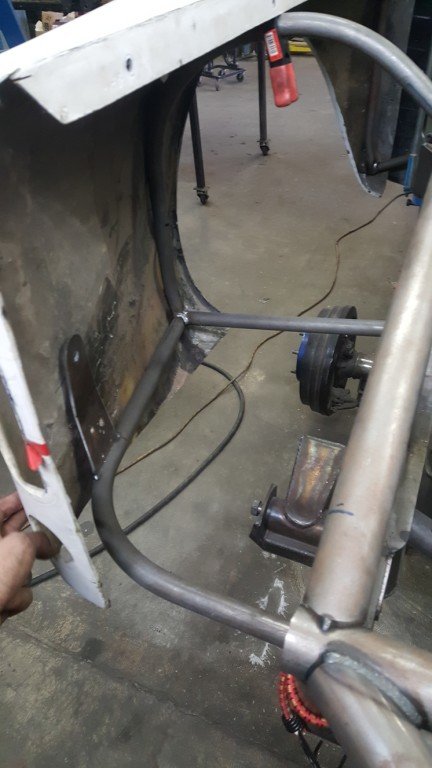

  13. Nov 9, 2017 at 8:43 PM
    #213
    DTFtacoma
    Mar 5, 2009
    #14364
    6,951
    Anthony
    Santa Maria, CA
    06 PreRunner D-cab
    DTF LT front & rear

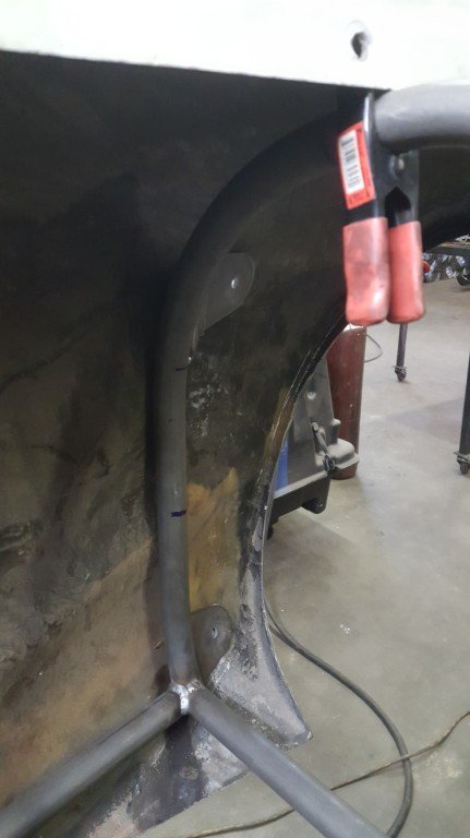

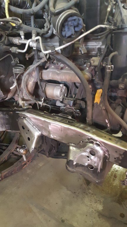

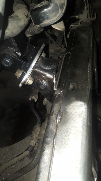

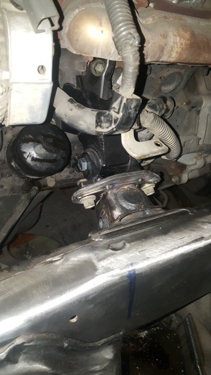

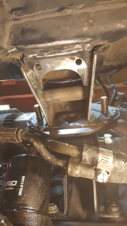

    Boxed the motor mount perches.
    I hate overhead welding lol

    JuansTaco
    JuansTaco JuanInAMillion
    Nov 18, 2012
    #91397
    8,904
    Juan
    gilbert az
    2004 PreRunner SR5 stormtrooper
    ESB long travel kit, Deaver f67s with DTF 12 inch shackles.
    You get tons of what looks to be track marks haha
  15. Nov 9, 2017 at 8:48 PM
    #215
    DTFtacoma
    Mar 5, 2009
    #14364
    6,951
    Anthony
    Santa Maria, CA
    06 PreRunner D-cab
    DTF LT front & rear

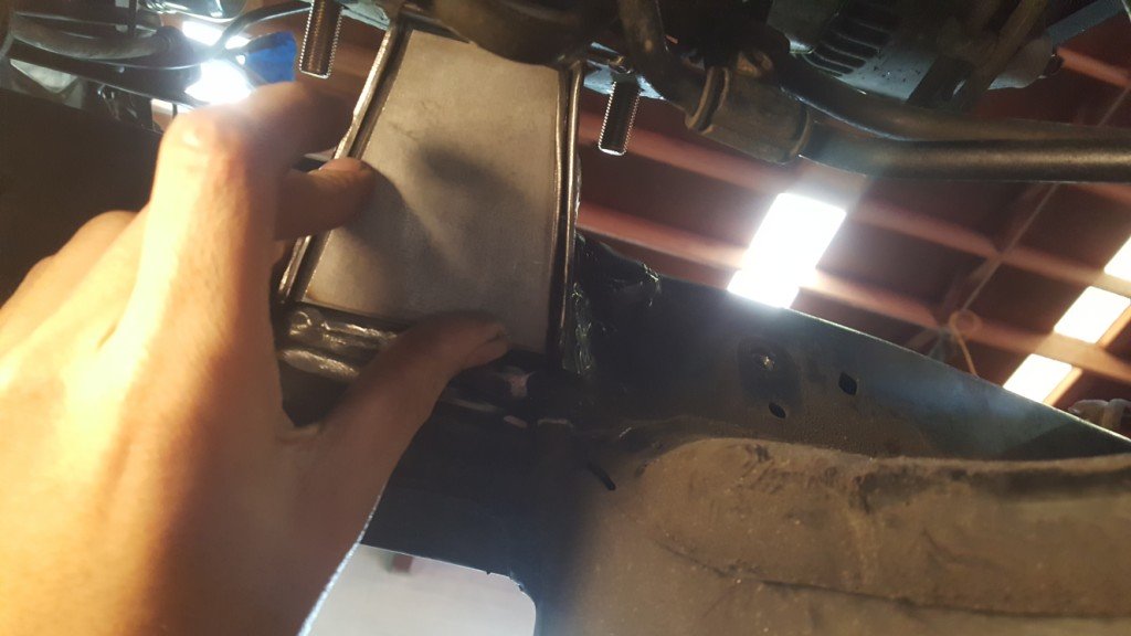

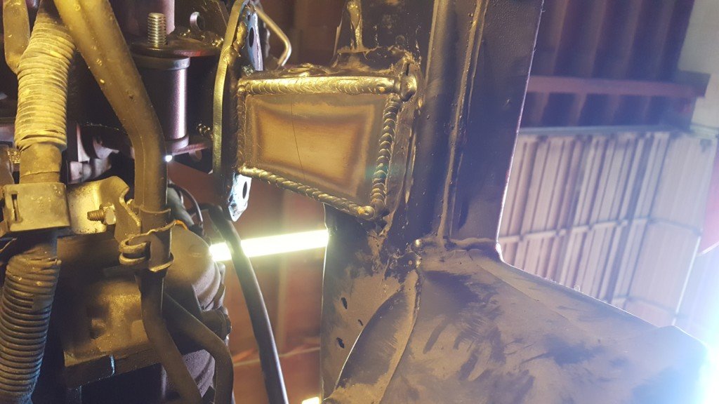

    Better pics of the bedside and jack mounts.

    killer job on the motor perch gusset. I hated welding in there.

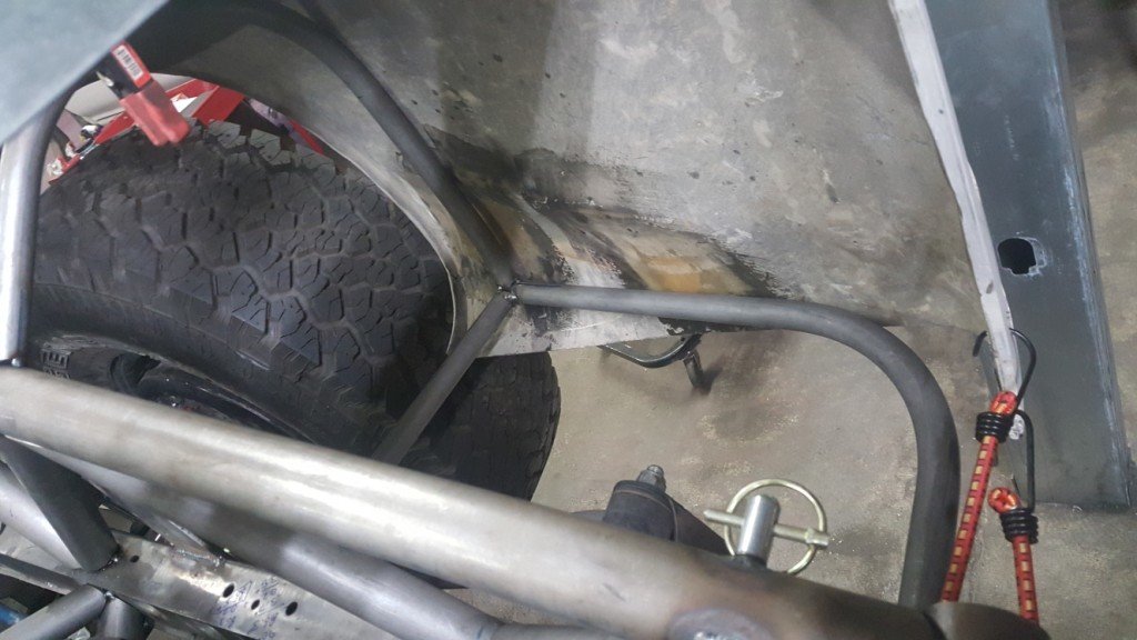

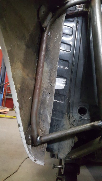

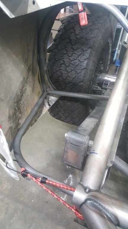

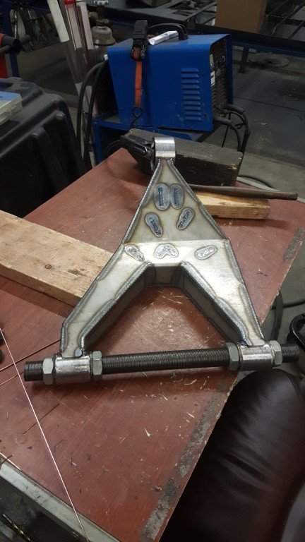

  18. Nov 19, 2017 at 9:22 PM
    #218
    DTFtacoma
    Mar 5, 2009
    #14364
    6,951
    Anthony
    Santa Maria, CA
    06 PreRunner D-cab
    DTF LT front & rear

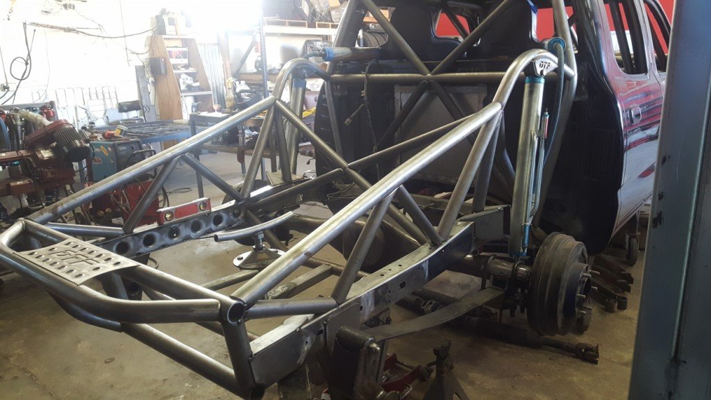

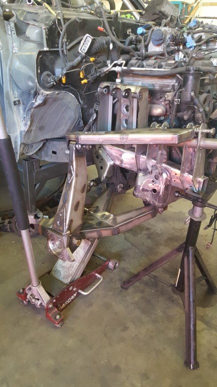

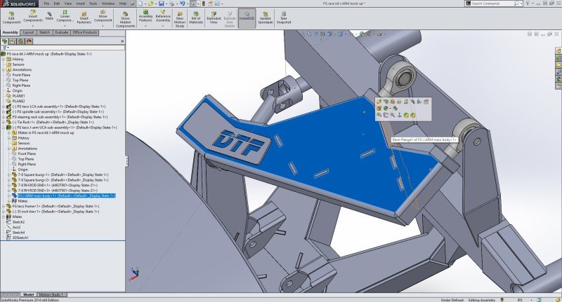

    More updates.
    Mocked up
    Tacked up.
    :yay::yay::yay:

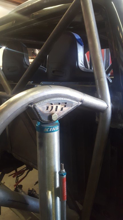

    so with the shock towers will the tubing for the upper arms and the tubing that runs to the bump be included in the kit? asking for a friend :anonymous:
