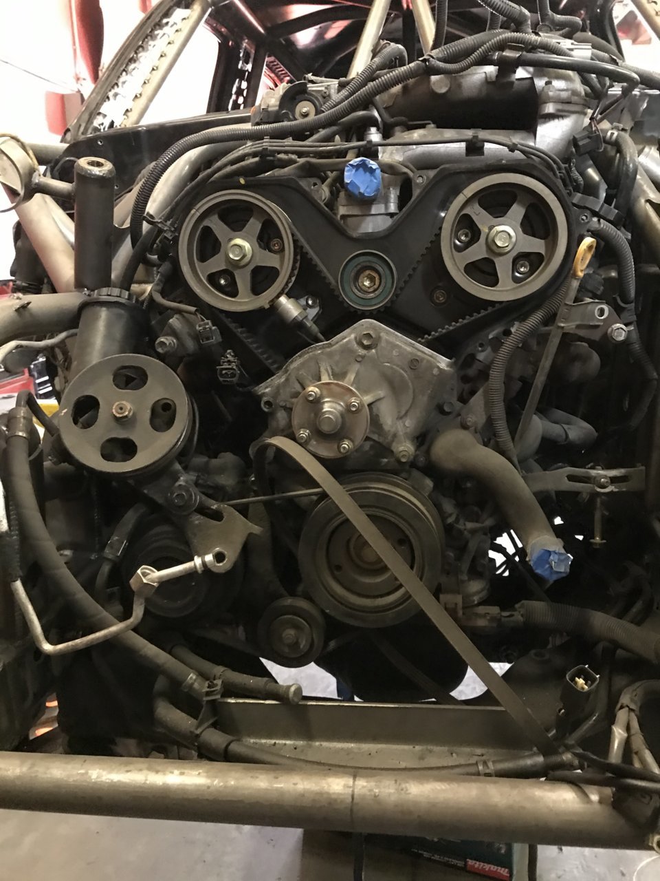

    We knocked out the timing belt/water pump dealio

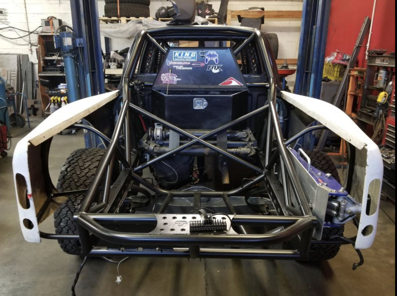

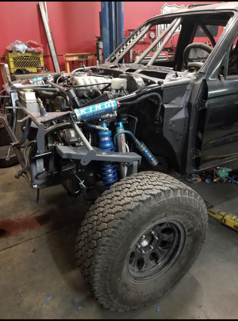

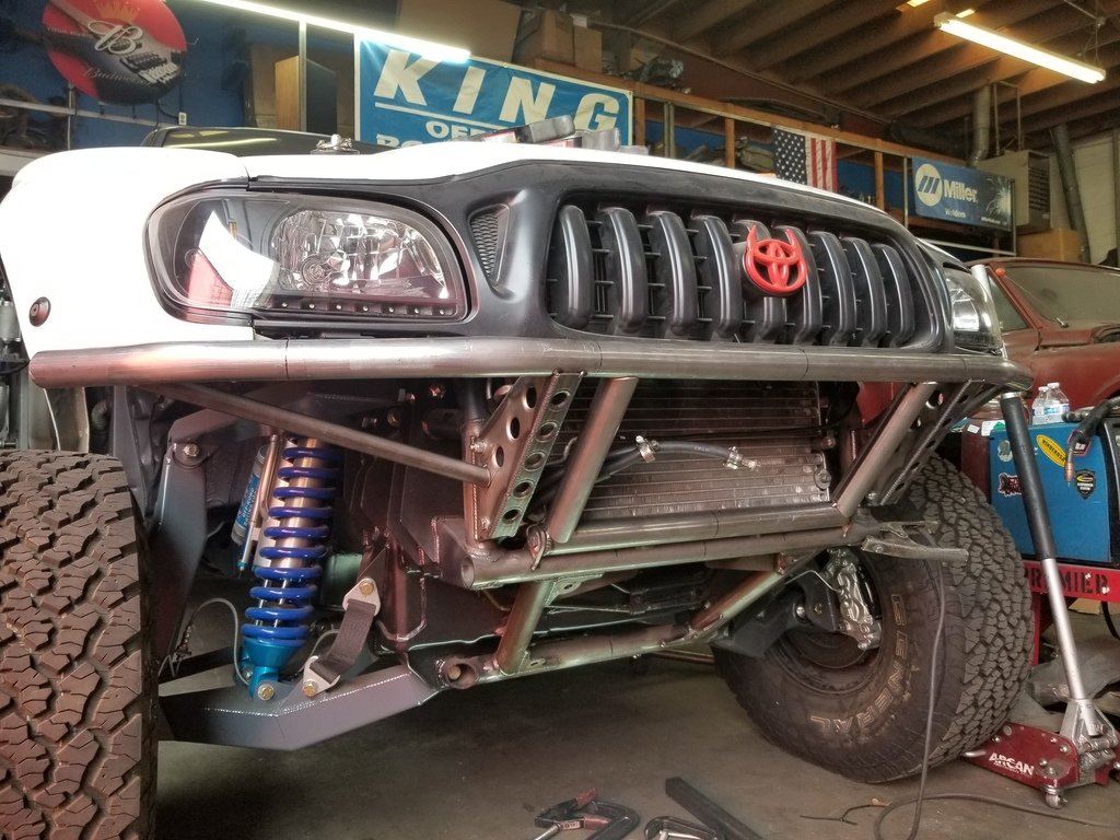

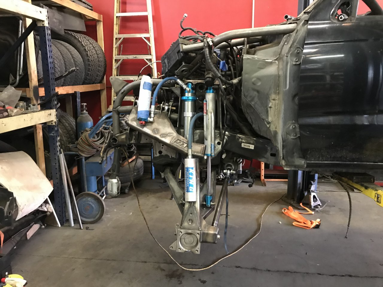

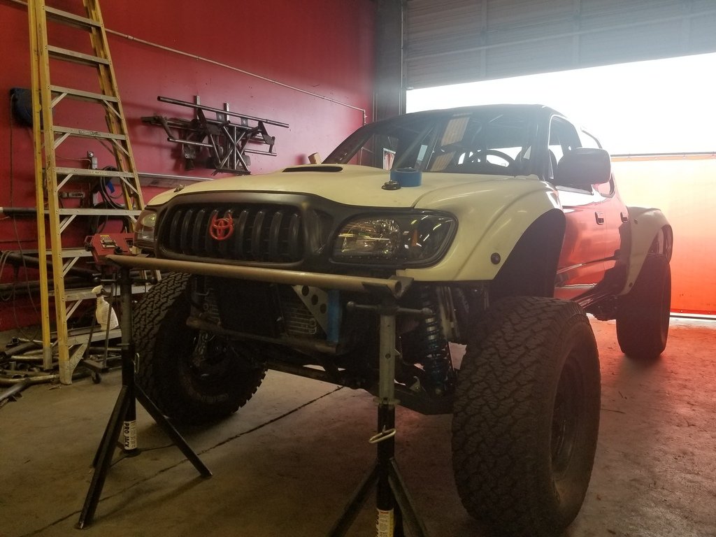

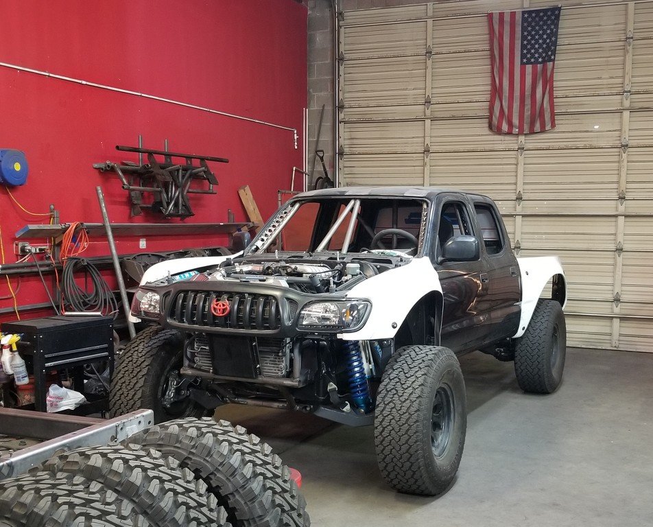

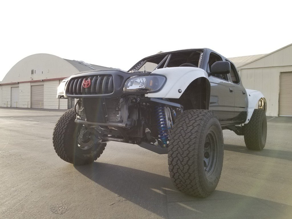

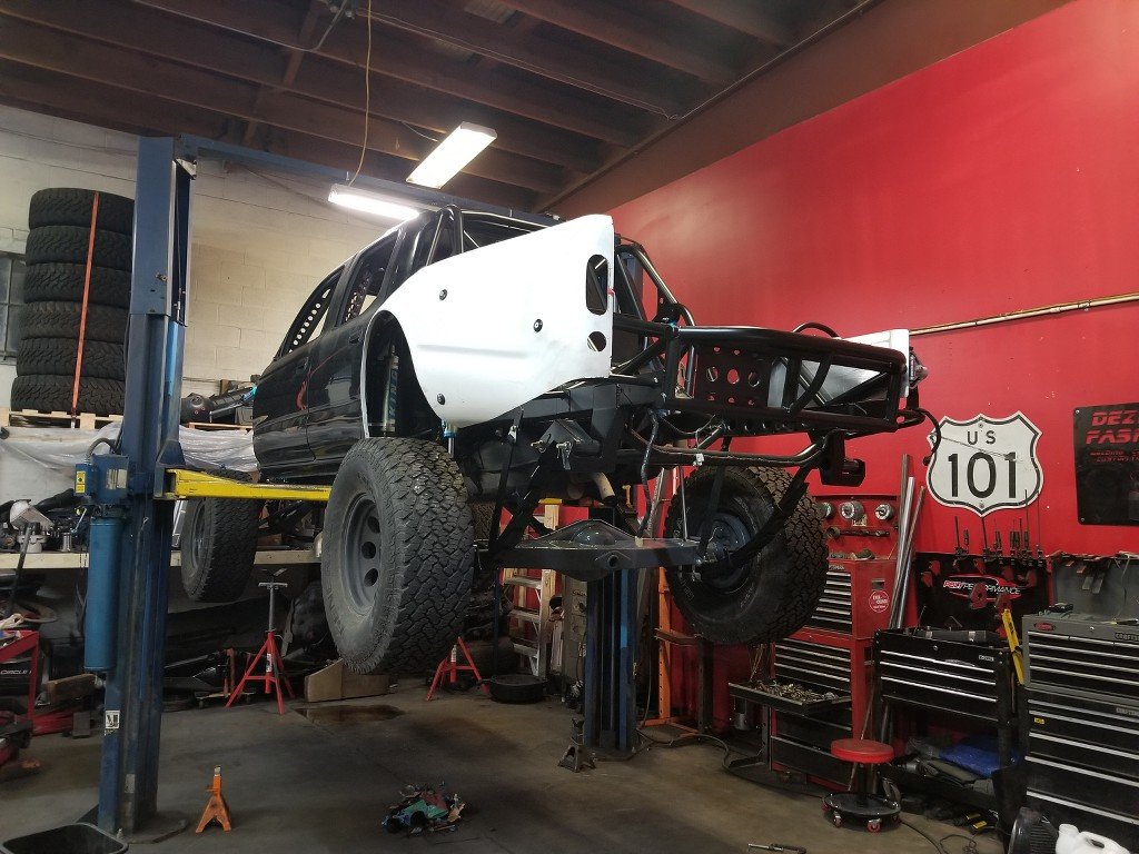

    I still have a truck and yes it is still in the shop. But I have some updates, she’s on her own weight after years!! 4AE32267-4499-47D2-A8CB-11AB96B7B5E7.jpg 1A118CEF-0BD1-4FD5-BFEE-2F84E805ECBB.jpg

    Don’t forget I parted out the red one after decided to not cab swap the black cab to red truck and just start with a fresh slate. Using the wheels, rear bypasses and leaf springs from Rojo. Everything else is new/different. Truck should be pretty sick for leaf springer.

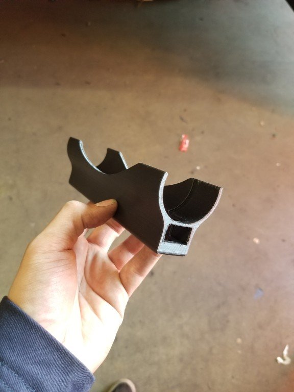

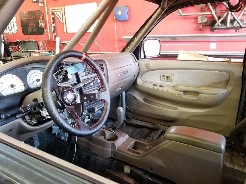

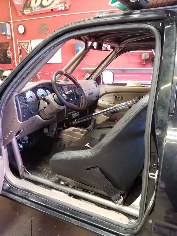

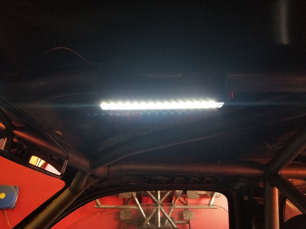

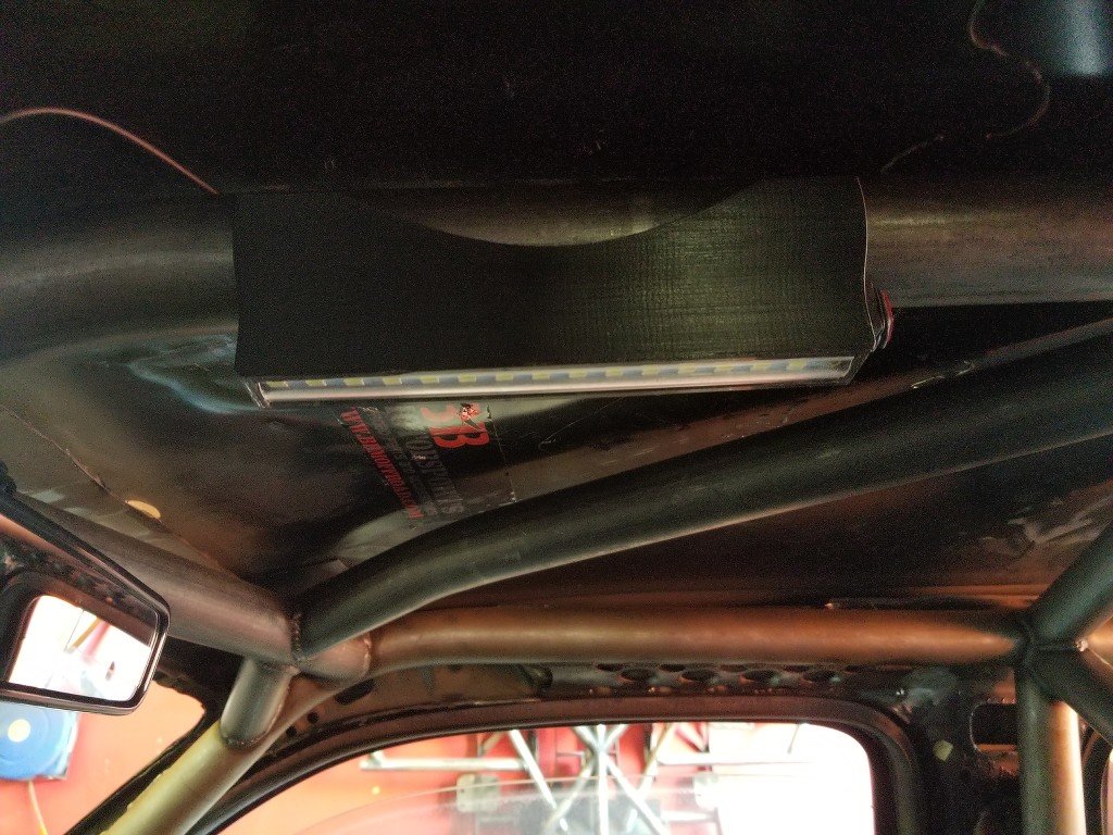

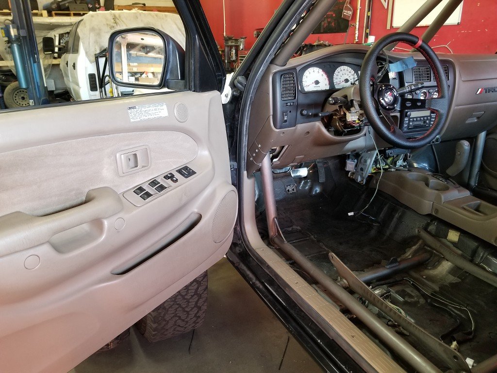

    Interior is almost ready.
    More 3D printed parts for this build. Made a little dome light housing that snaps onto the tube.
    Version 1.0 (10 hr. print)
    Ver. 2.0 with thicker sides and more wrap over the tube.(11.5 hr. print)

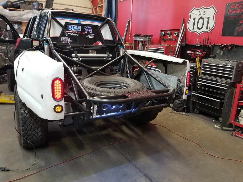

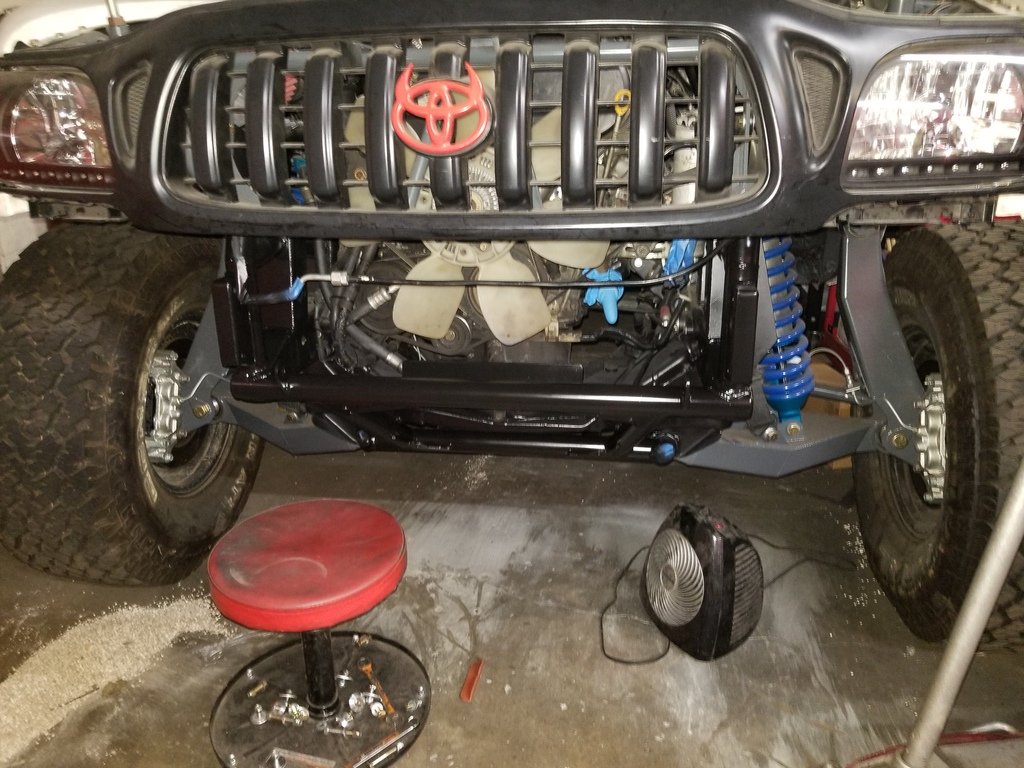

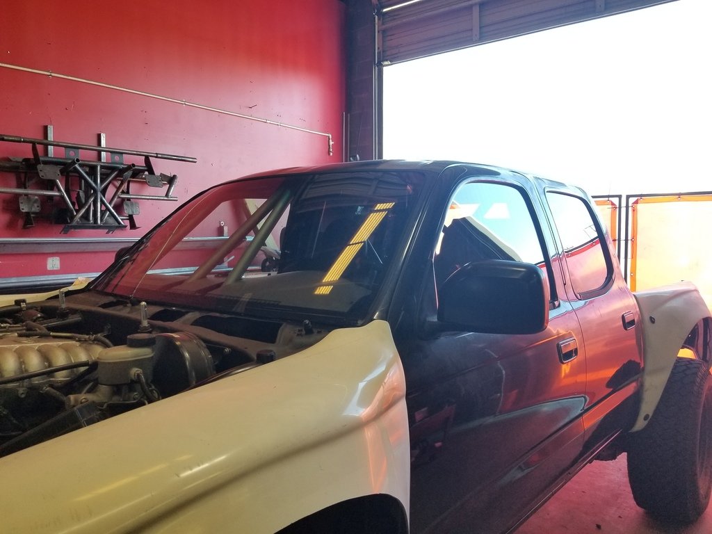

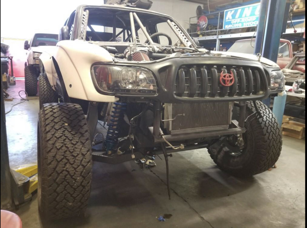

    Some updates for my Tacoma bros
    Windshield in
    ARP studs installed on rear axle ad longer studs in the spacers

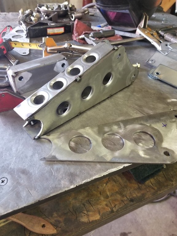

    Bumper started
    *concept*
    *Horns tacked*
    *Welded horns*
    *tacked on*
    *Bumper tacked*
    *Mocked up valance*
    Bumper is now fully welded just needs valance tabs and paint.

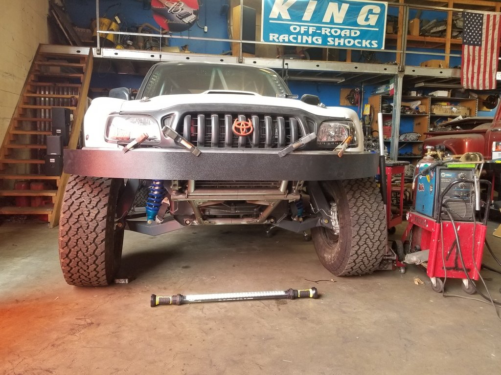

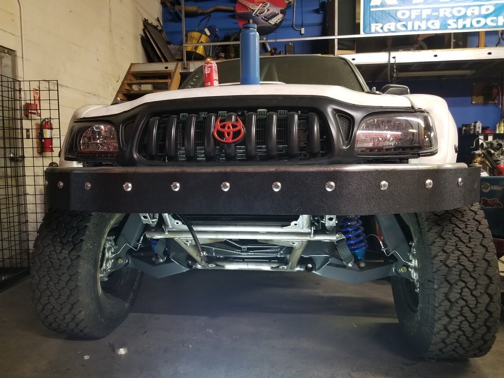

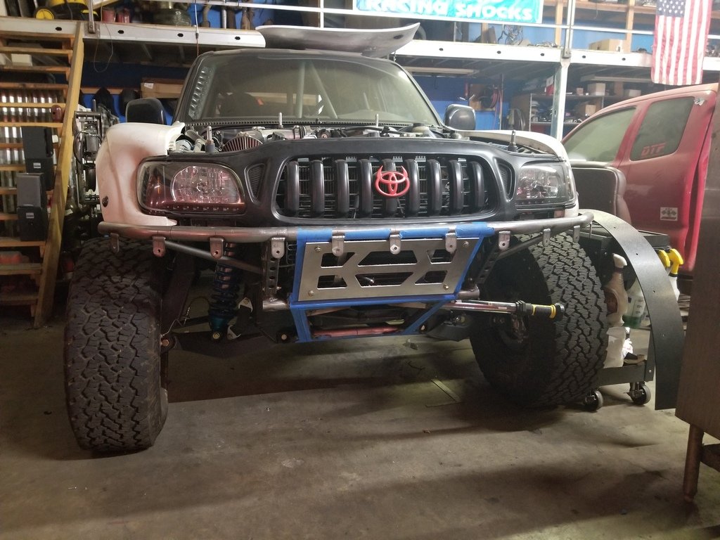

    Valance mounted
    Still need to trim ends, mount cooler, skids, and paint

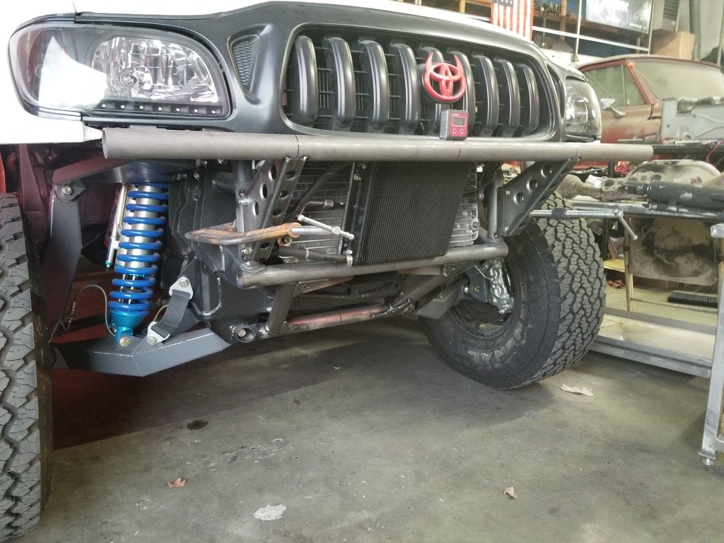

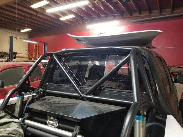

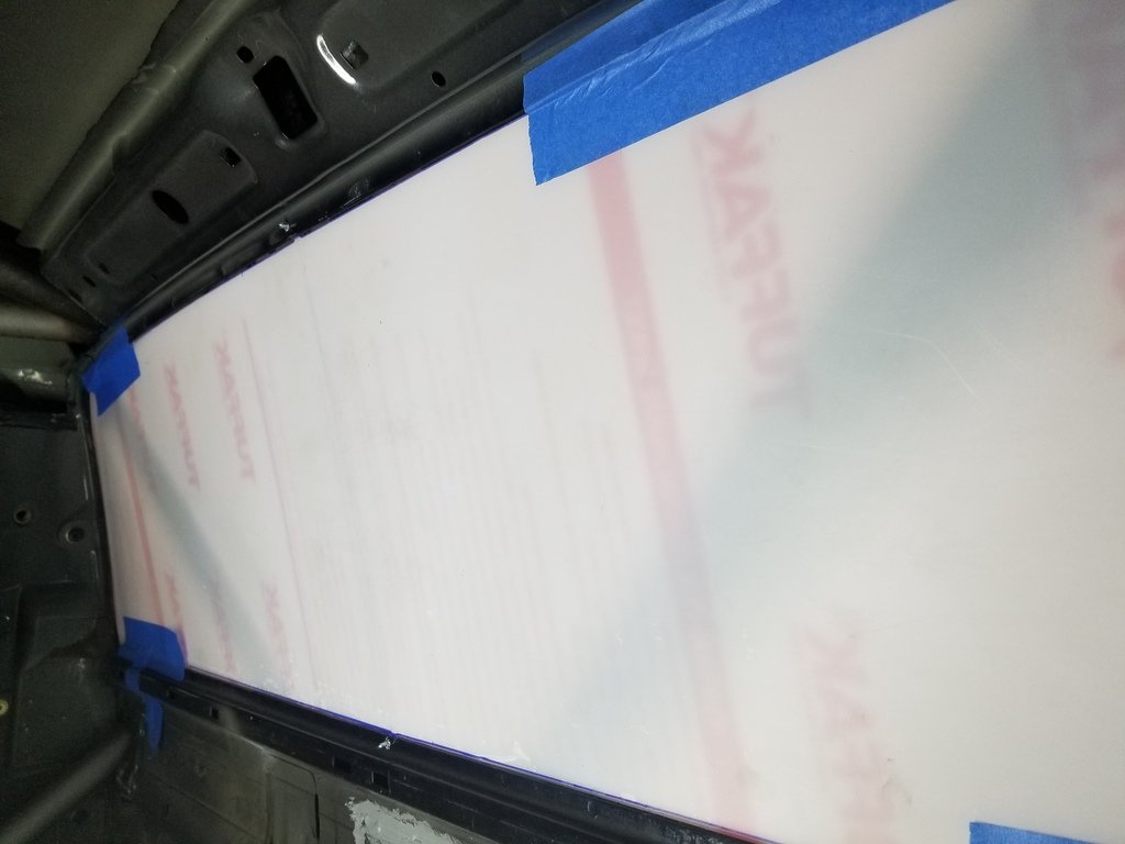

    New trans cooler mounted
    Skids cut out. Mocked up the top one.

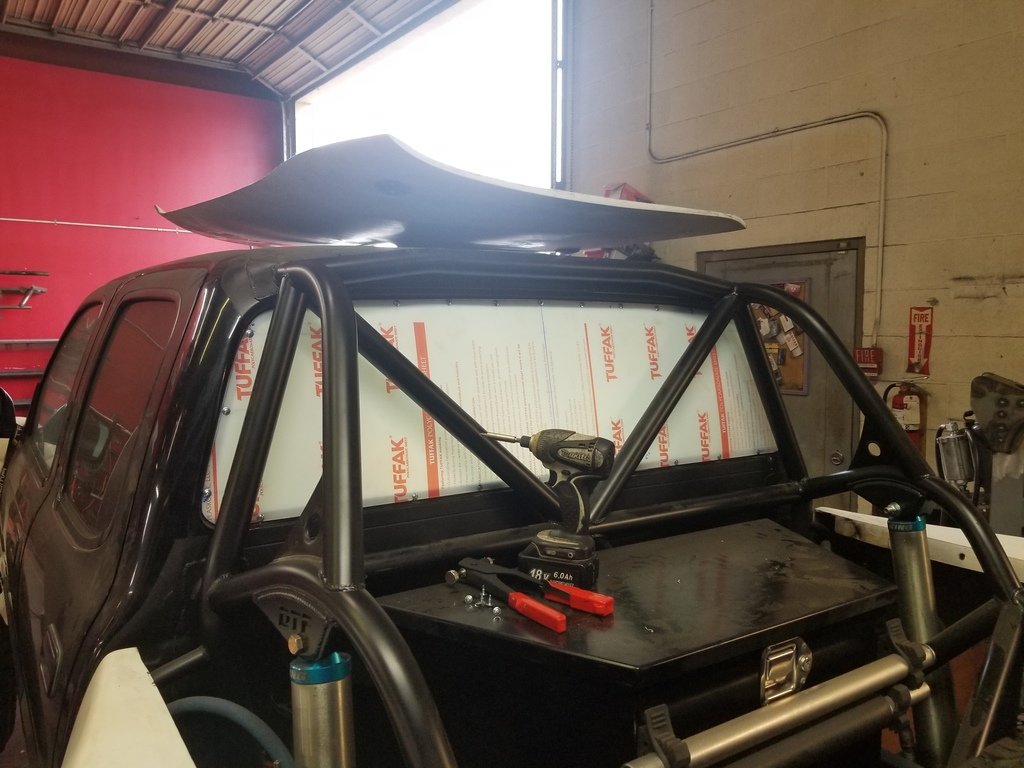

    Lexan window cut out and mocked up
    Rubber Gasket trimmed and fitted
    Rivet nuts installed also just didn't take a pic.
    Bumper primed and ready for paint tomorrow :yes:

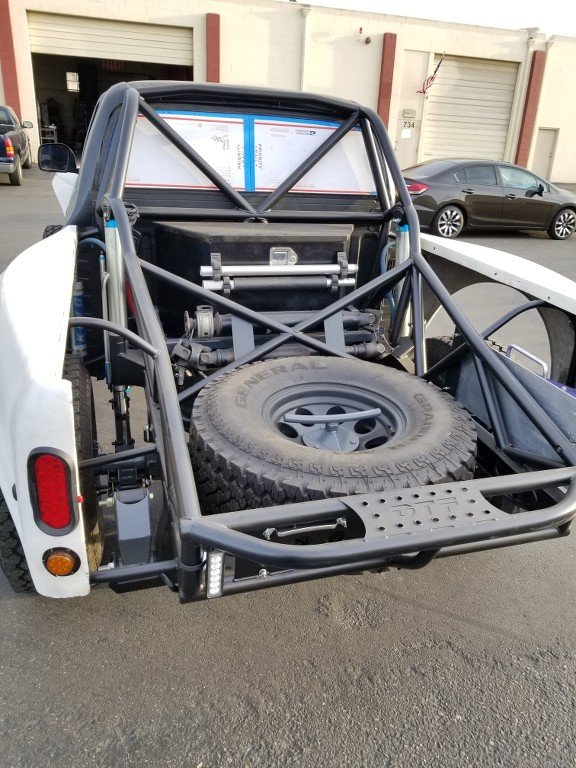

    Bumper and front of cage painted.
    Back window is in.
    Installing bumper and skids Thursday. Hopefully have the interior wrapped up this weekend.
