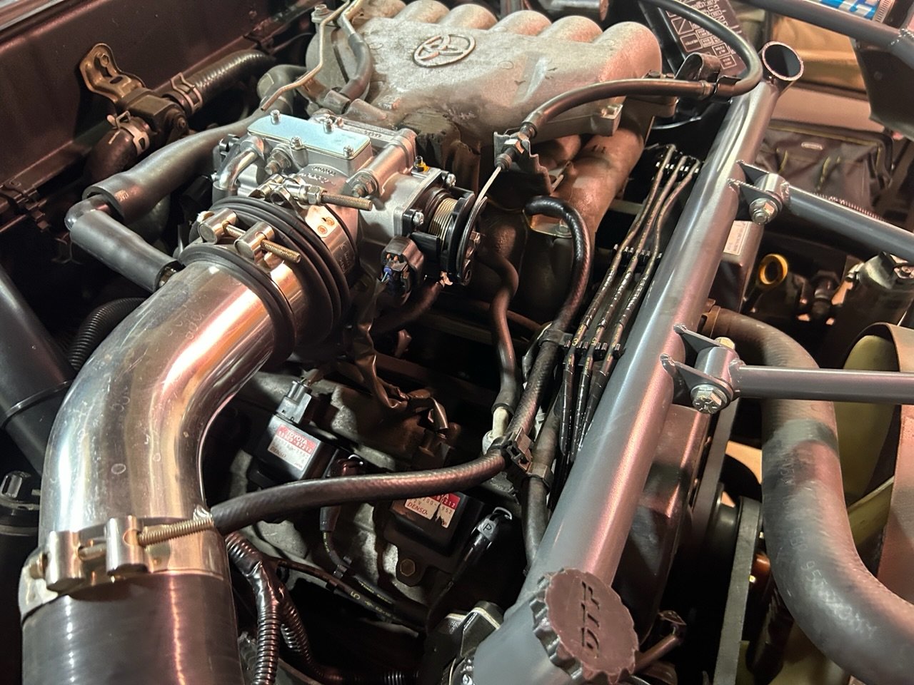

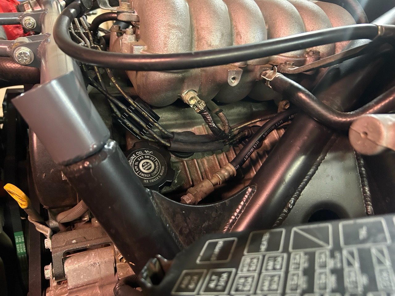

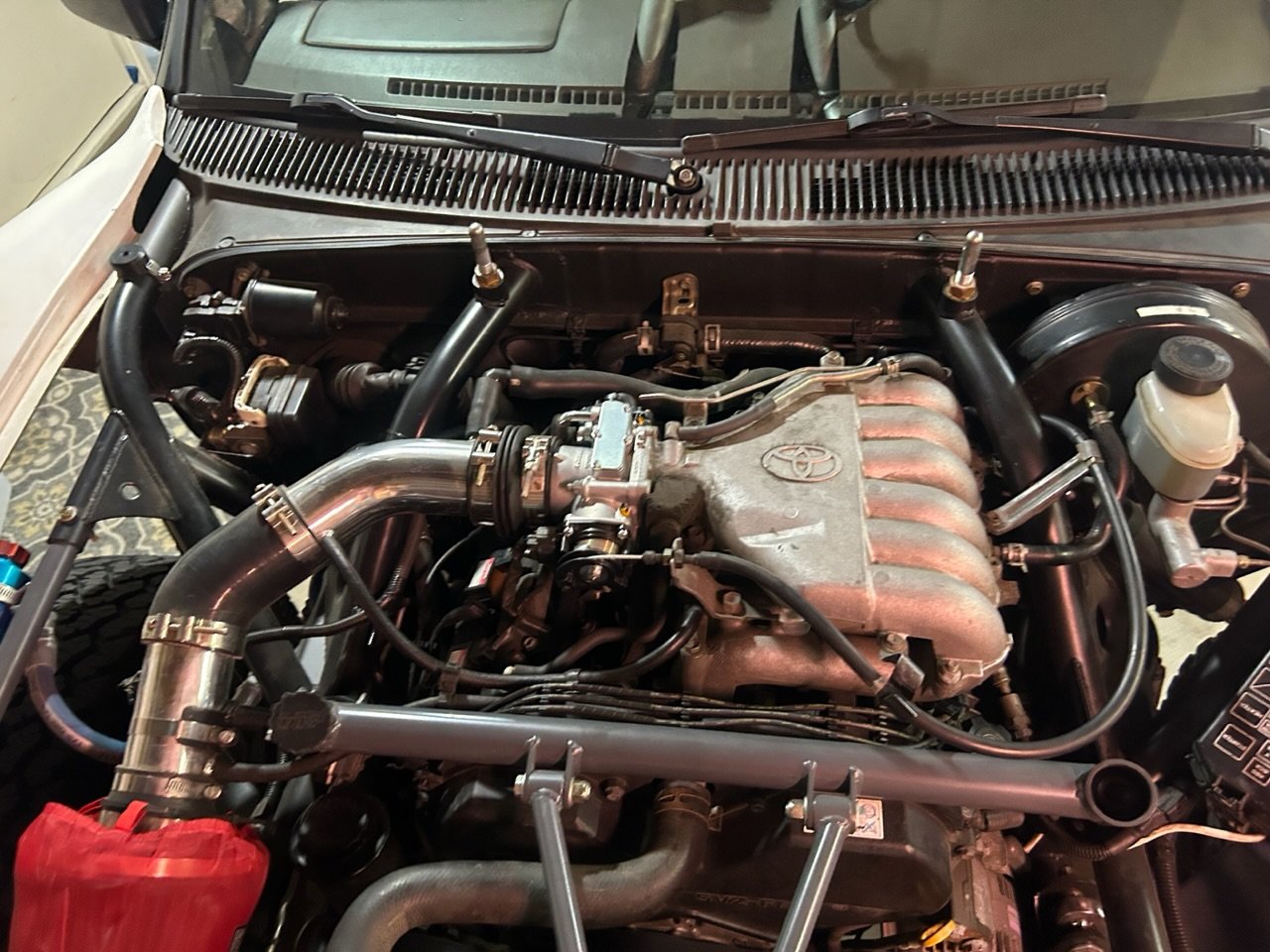

    IMG_1345.jpg IMG_1344.jpg IMG_1343.jpg New wires and plugs.

    Drove truck around very briefly and gave her the onion :burnrubber:
    I think misfire is cured! Old plugs were original with 167k miles. I will have to take it out again this week for a proper drive to be sure :pray:

    Ripped around last night again and it appears misfire is cured

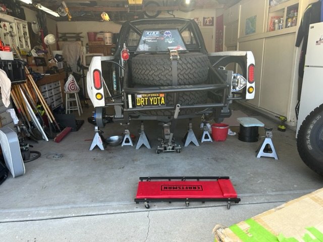

    I made use of some jack stands today. Swapped in the new to me diff, 5.29s w/Toyota LSD. Pulled the stock 1st gen Tundra open diff with the standard 3.91. One Reign energy drink, few f-bombs, one sore knuckle.
    The good: Nice to have some power off the line! Felt good compared to where it was!
    The bad: Of course, it has a distinct howl on coast/deceleration.
    It’s quiet durning acceleration, smooth as far as feel and LSD so far has no chatter. Guess I’ll see how long it lasts!

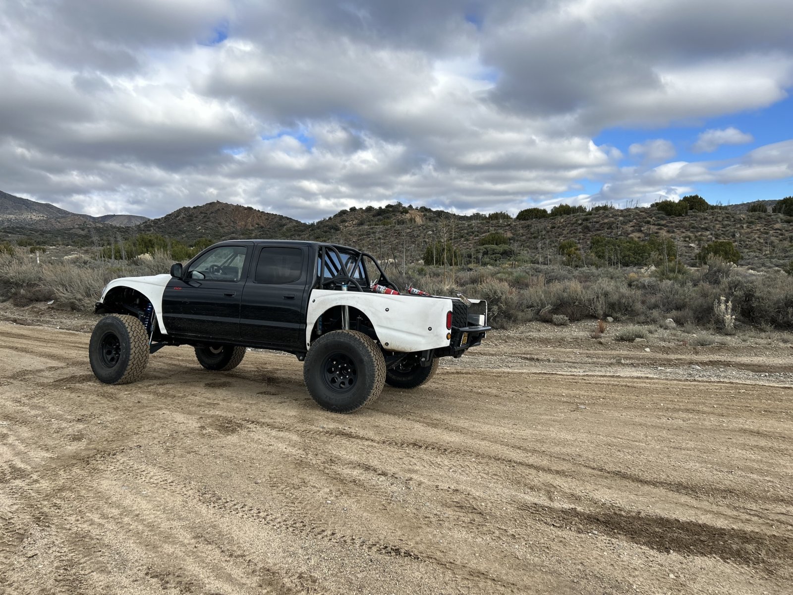

    Some shots a buddy took from a piano trip while back.
