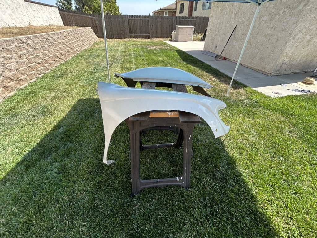

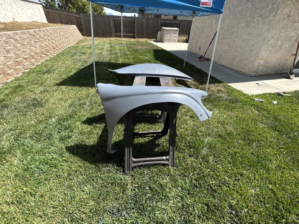

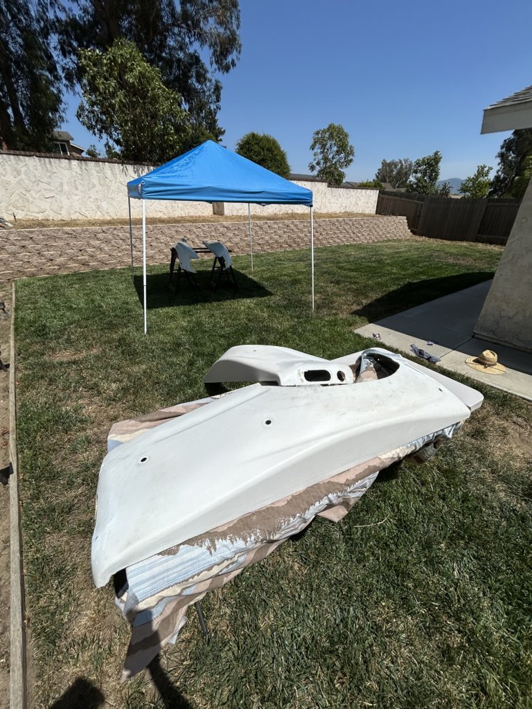

    Over the white glass!

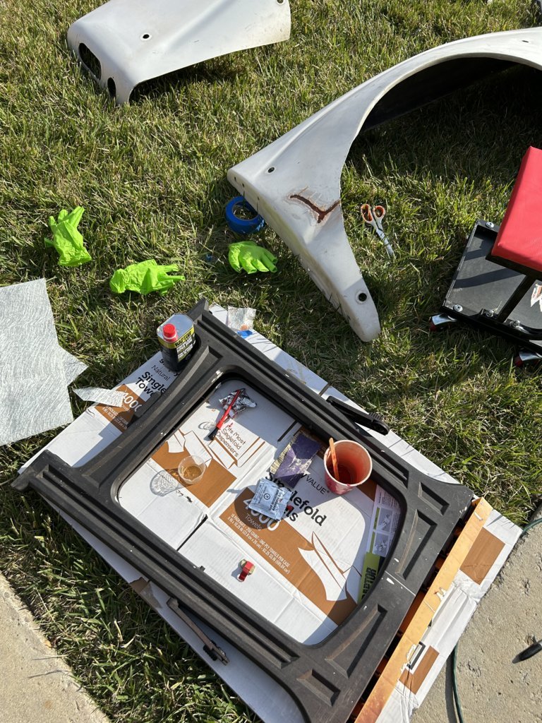

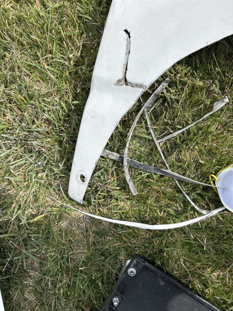

    A trim and glass repair for these cracked bedsides

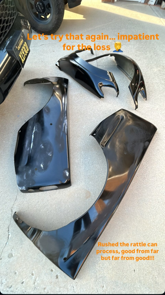

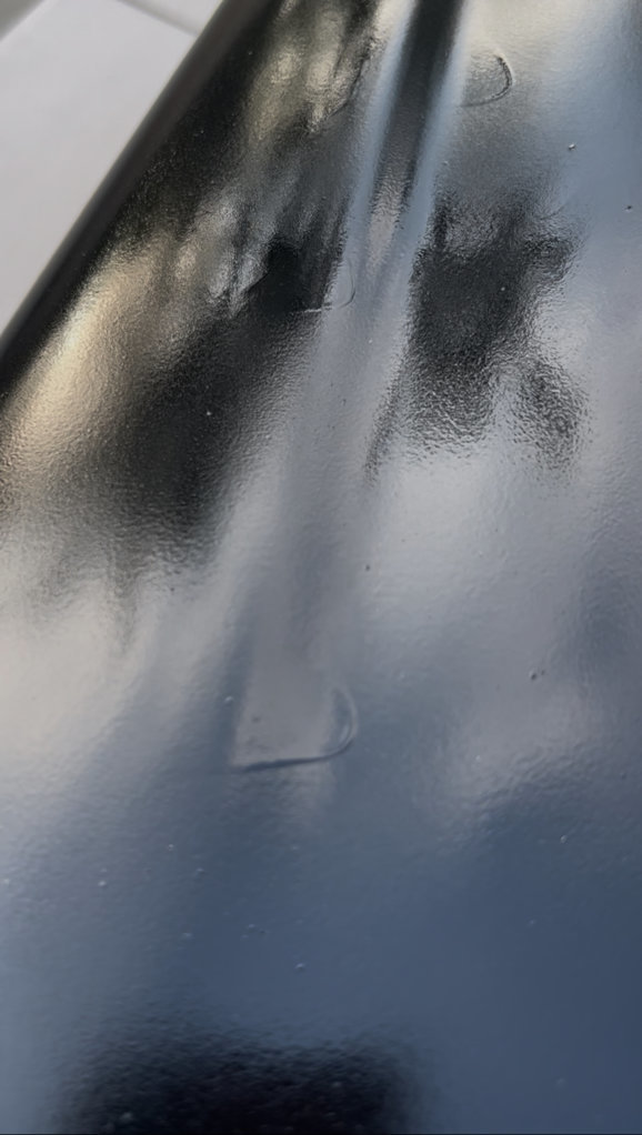

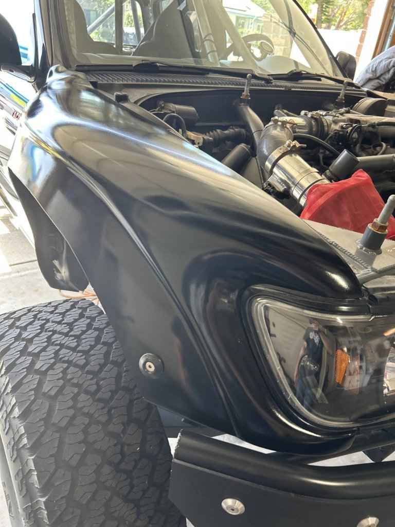

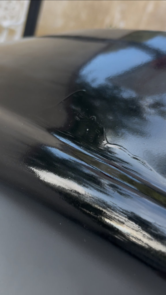

    Got tired of the oreo look so after my horrible glass repair it was finally time to rattle canning black it one color! This go around I did outside not in garage. Lil wind and no patience… leads to this shit!!! :bananadead:

    Sanded down the heavy spots and I’m going to complete it in the garage like I did with the old red truck. No wet sanding as it is a play truck just needs to look good from 10’

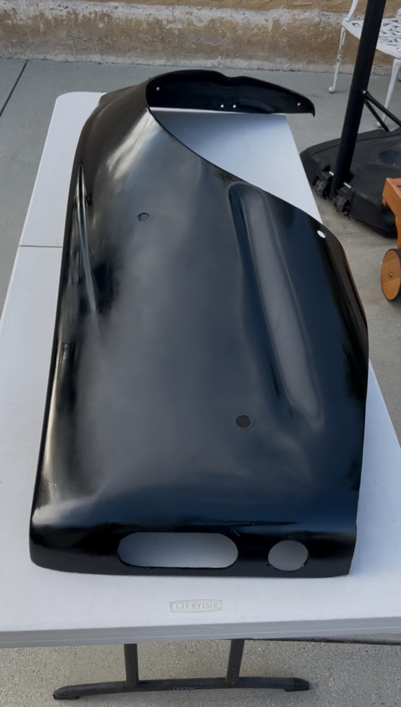

    https://youtu.be/Wa09FRWlS94?si=un6lfF4wn52CwkKz

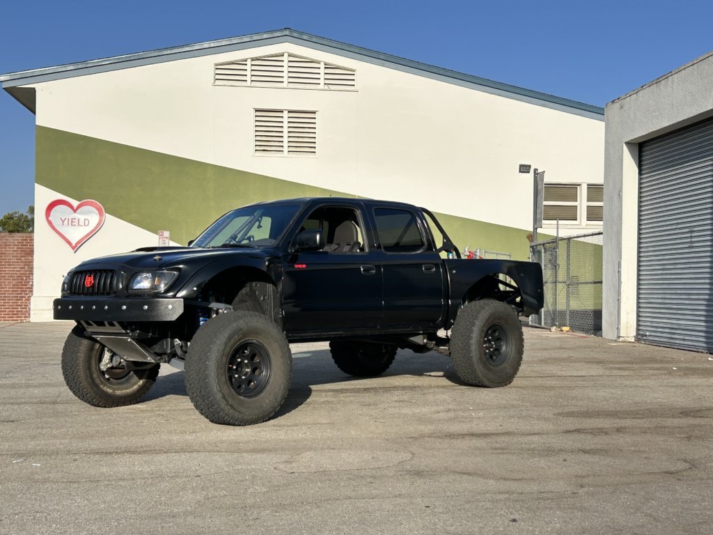

    She’s all one color finally!! Black on black, Dirt_Yota Pirate Ship ready to sail!!!

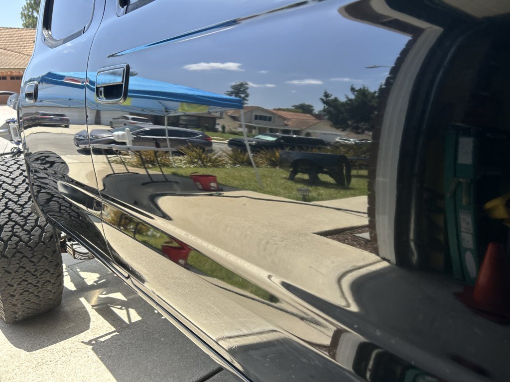

    Not bad for rattle can and gloss black, mistakes were made more than once but after some elbow grease she’s all one color! I just rattle canned it and was against putting in the effort to wet sand. Since I had no patience and had orange peel twice and put a bunch of time in to fix said orange peel I gave in and wet sanded the clear coat which was hazy and splotchy. Gotta say wet sanding is the trick! Wish I would have done the paint prior to clear coating. I followed with a heavy polish then a fine polish and wax. For a driveway/garage paint job it’s fine, not perfect but it’s not two colors!!!
