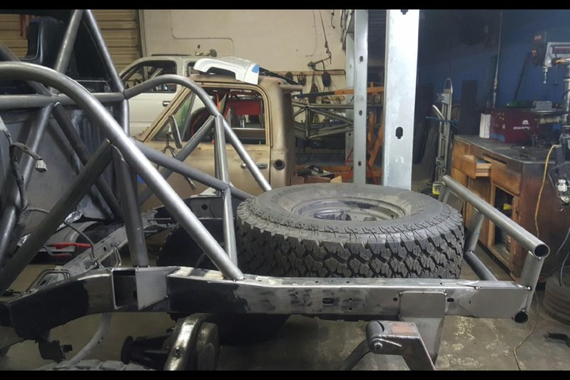

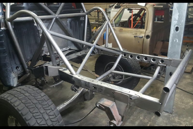

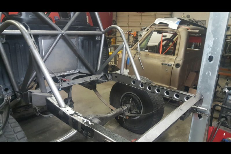

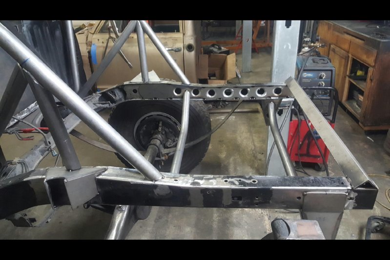

    image.jpg image.jpg image.jpg Slowly moving along. I can't fucking wait to rip this thing around!

    Springs outside the frame. Doing it like a ranger. 64s or 62s?

    #117294

    Yup outside frame inverted shackle w/ 62". Should be a blast to drive! I really am starting to freak out its been so long since I romped in the dirt ahhh

    I like it. Seems a lot of sprung under guys are going that way now. I never analyze the 2 different types. I know it changes your roll center.

    Figure mounting it further out towards the tire like this will only help with stability and handling, well that's the plan. And yeah the 1st gen dbl cab is a very small cab. I'm gonna keep the stock bench until I decide to go fuel cell then I can cut the floor out and drop it a bit and gain leg room. Besides the back is really for my kids.

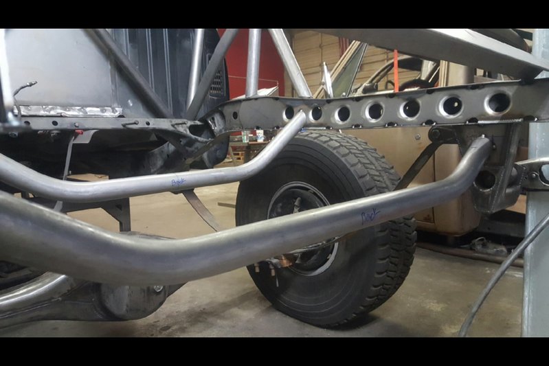

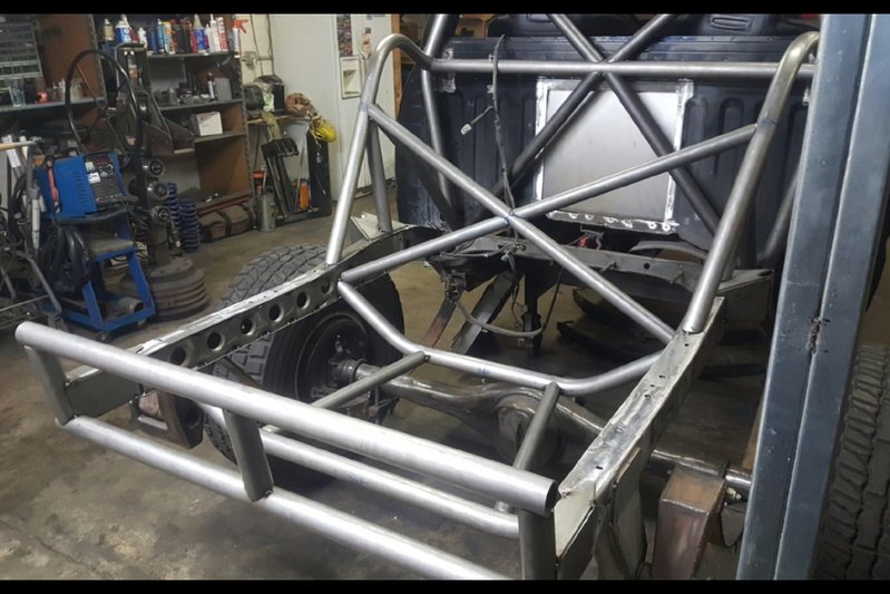

    A cpl more that Anthony sent me. Every tube is one step closer to finally get back in the dirt!!! Been a long two years since roll! image.jpg image.jpg image.jpg

    gonna do double stack spares?

    Yes sir that's the plan, drop one or leave one of need be. @FlapJack935
