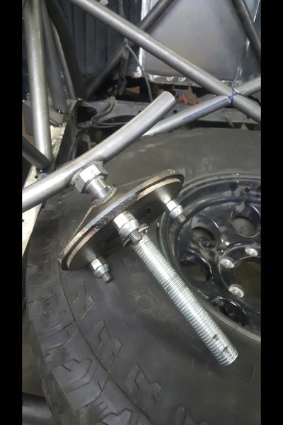

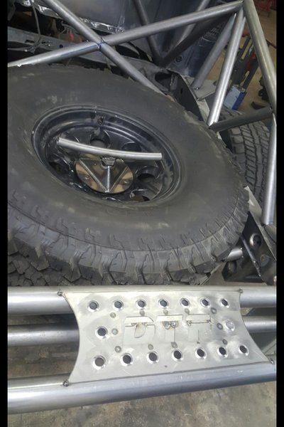

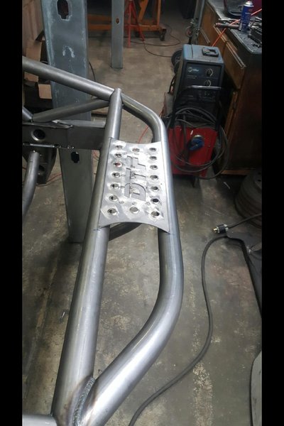

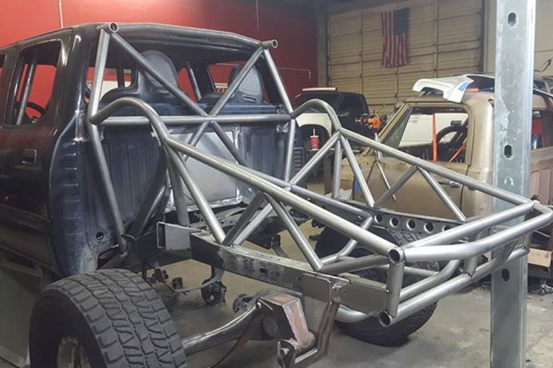

    So more pics. Gonna run dual stacked spares using a Y strap. But have ability if want or need to run a single spare recessed between frame a bit. Anthony wipped up this cool T handle for single tire mounting. Second tire fits on top. Nice lil no slip step on rear bumper

    Damn just stumbled upon this. This is like my dream truck, especially if you swap an LS into it. Just FYI on the outboard shackles and flip, basically the geometry allows for a lot more down travel. The frame basically gets in the way on a standard set up so someone figured out to just bump the mounts outside.

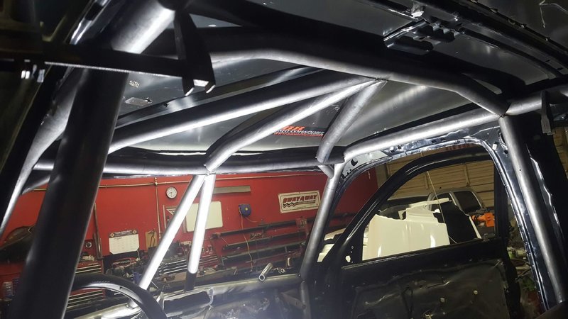

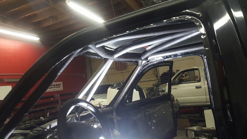

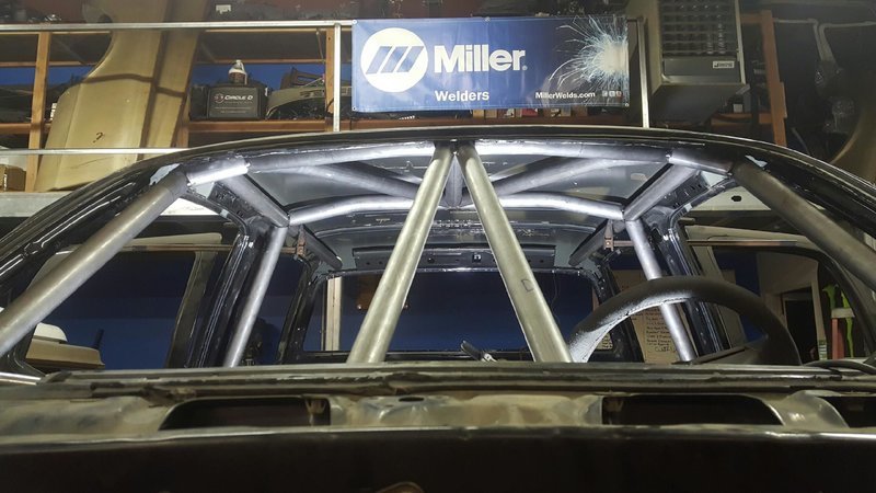

    Are you going to lift the cab and weld the top or just leave it. Also painting the cage? Just a lot of masking? Or will it be able to be removed

    Prolly supercharge and leave it but I really would love a LS swapped in!!! And yes more travel #s but also a bit more stable.

    No @DTFtacoma is able to reach most of it and the spots he can't just gonna cut out small section of cab skin to reach for full 360 welds. It's welded to frame/cab so just a s ton of masking.

    Thread needs more pics lol
    I'm a huge fan of mixing my two favorite hobbies.
    The first gen kit getting laser cut/bent soon just hammering out the final details. Sorry 4x4 guys, 2wd race kit is the only thing I've got planned for the first gen tacomas.
    The J-arm version will fit both shocks with ease and be bumped and strapped at 17+"
    A bolt on version will be available too. Bumped and strapped at 15"
