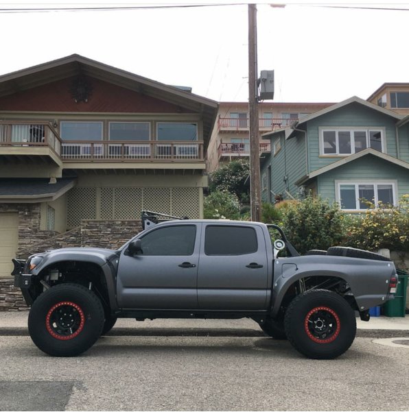

    hell yea. the 6 holes are clean. ive debated getting new wheels but i can do some different stuff with my omf rings if i get bored. something about the 6 holes that keep it simple

    whole reason im going to a race kit is to ditch the balljoints and crap, and i see horizontal uppers and lowers on the DTF kit and thats exactly what i want. he makes dreams come true lol
