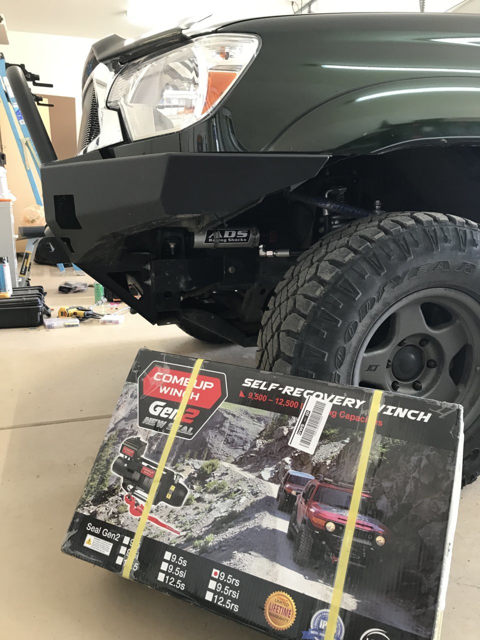

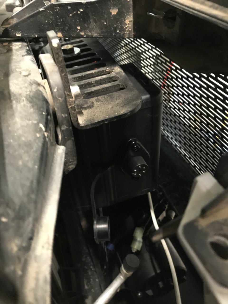

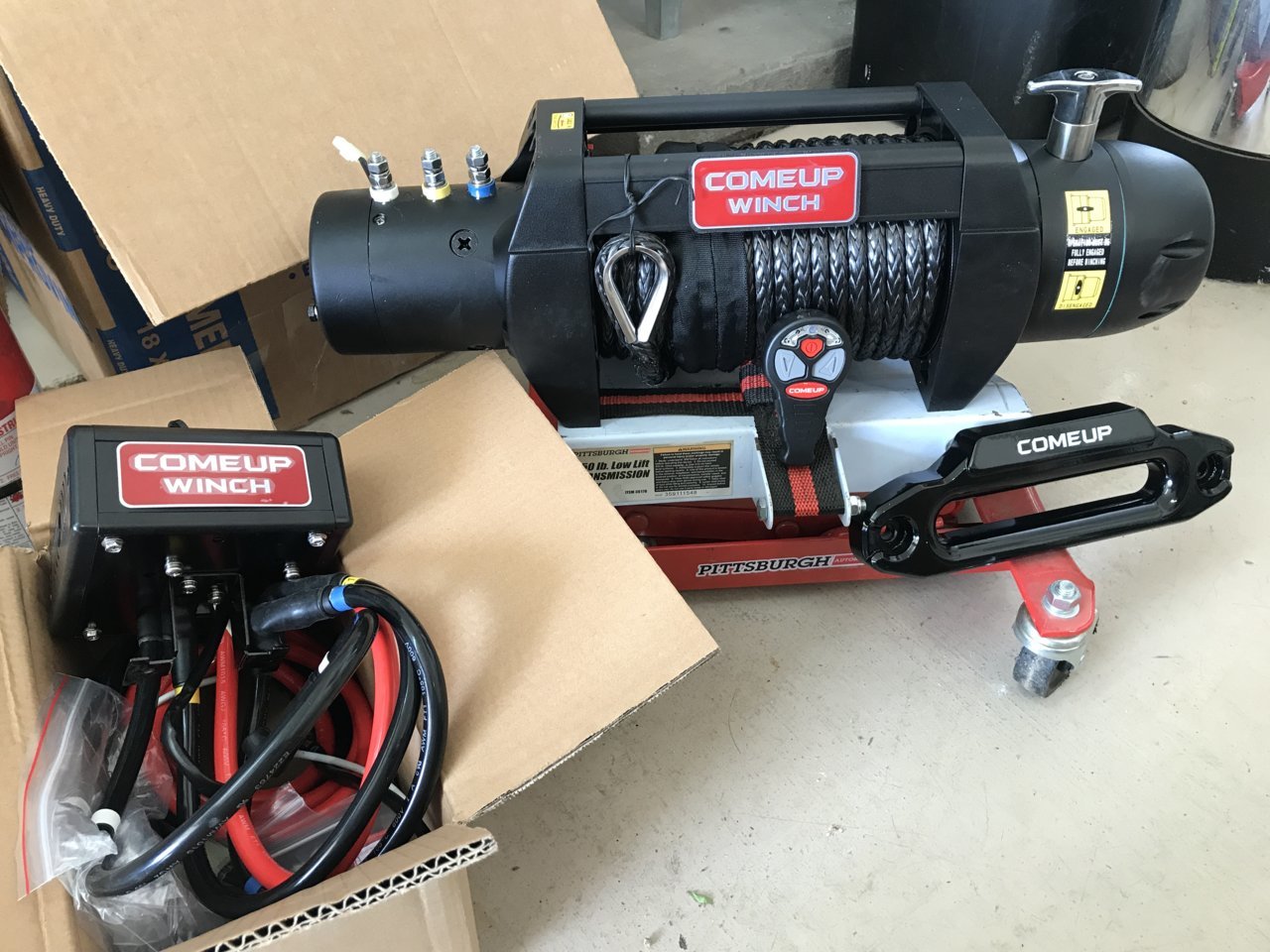

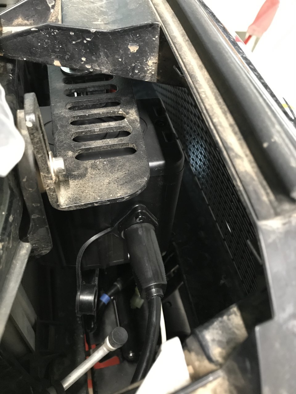

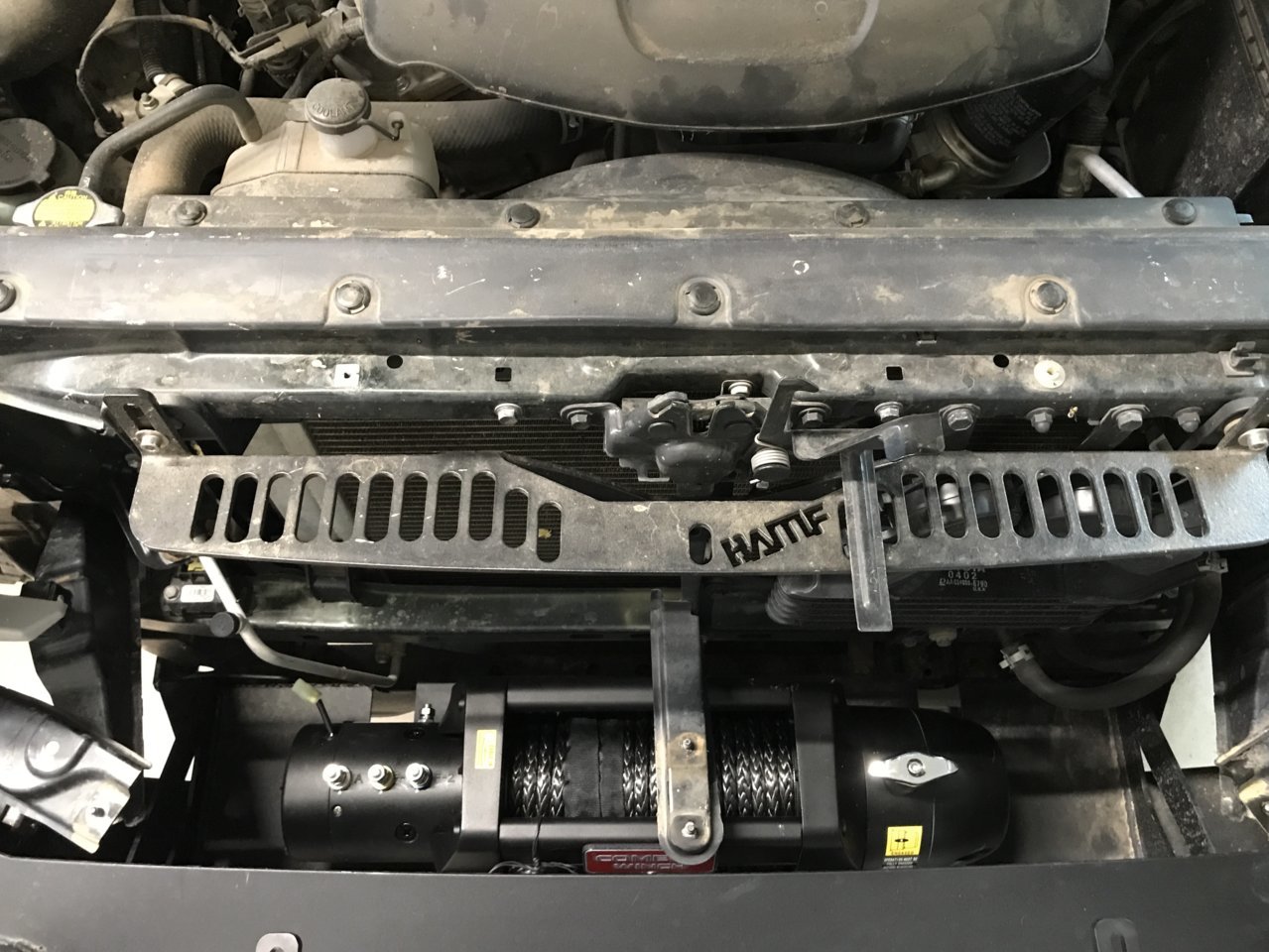

    New toys....thanks to @Jon@Mule
    Electrical next....

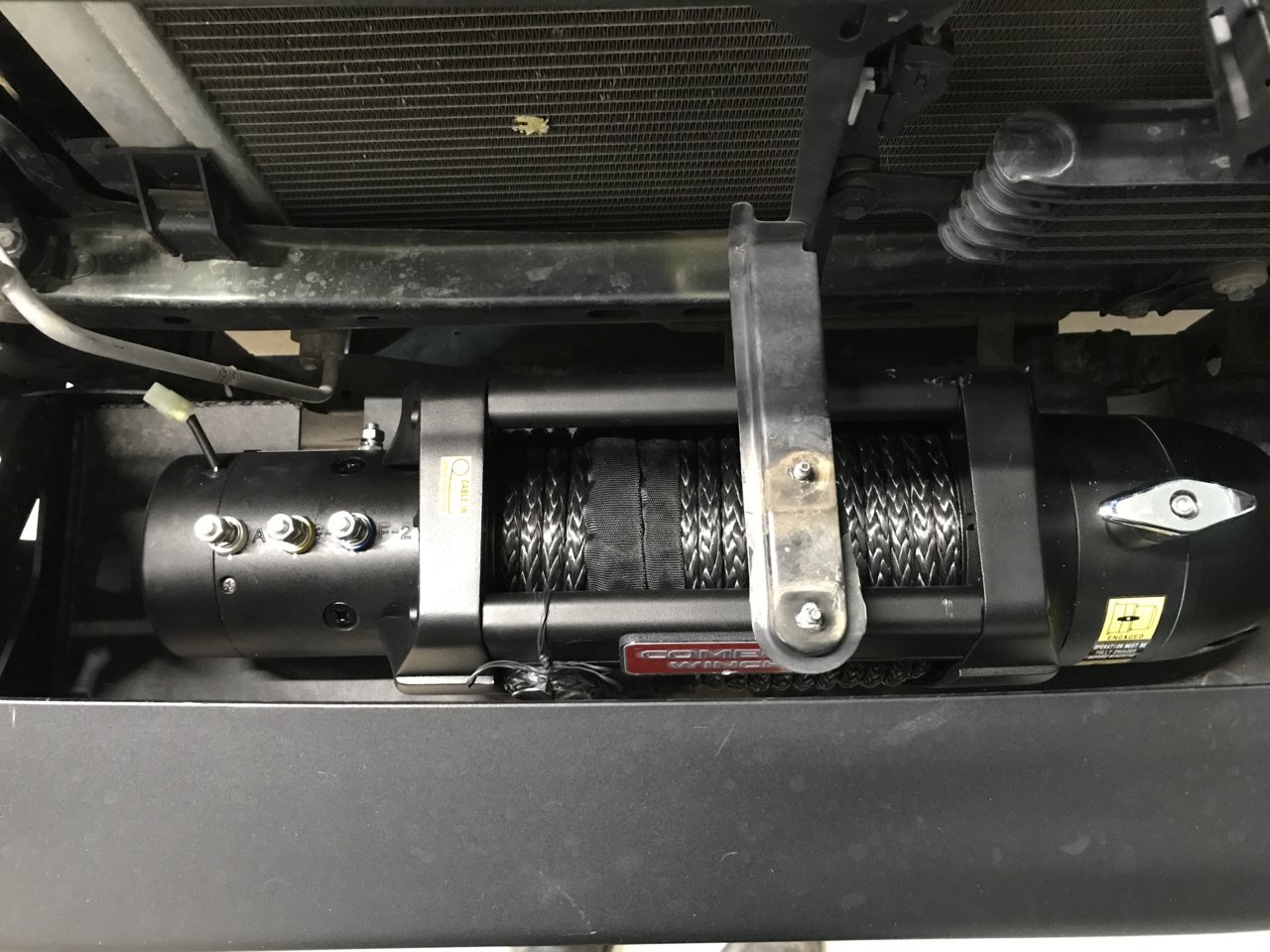

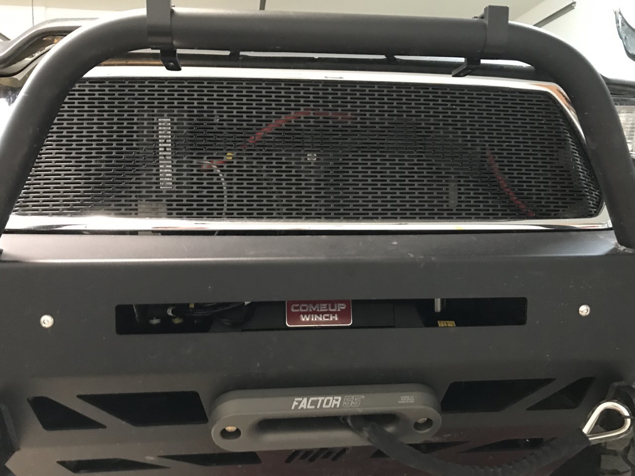

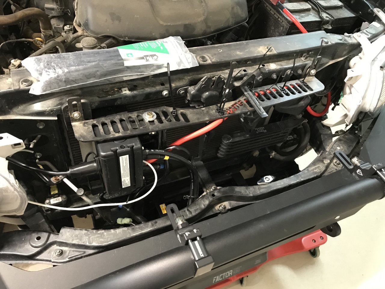

    All hooked up.

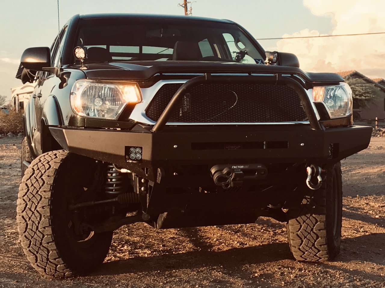

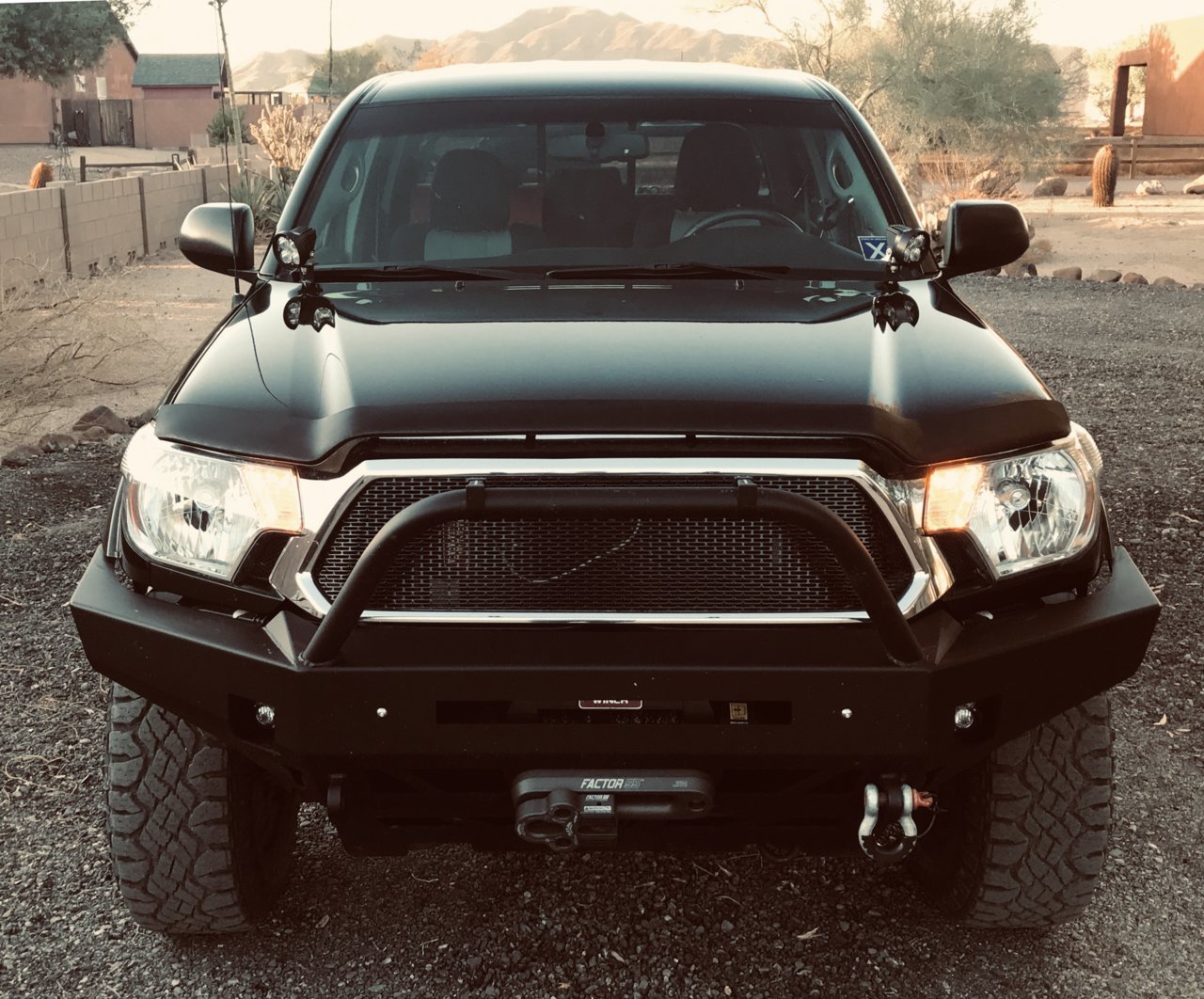

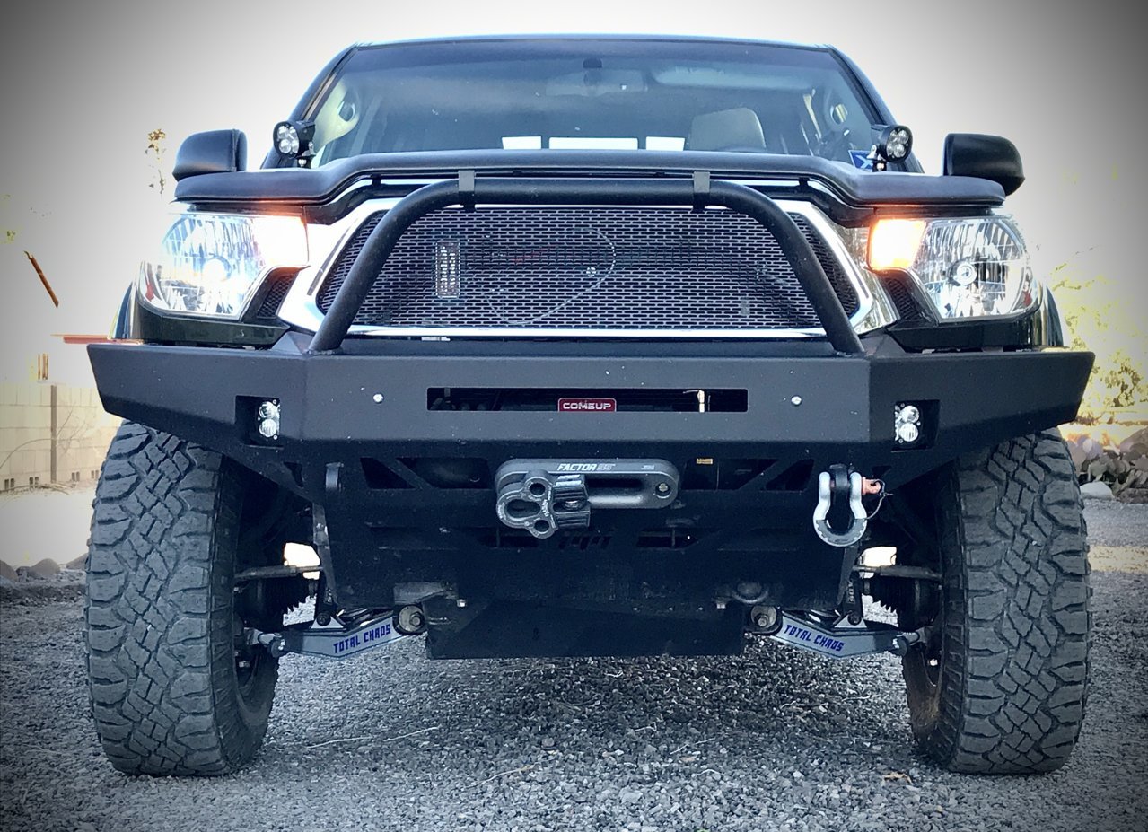

    Factor 55 Flatlink Multilink installed today. Pretty much done with the winch now.

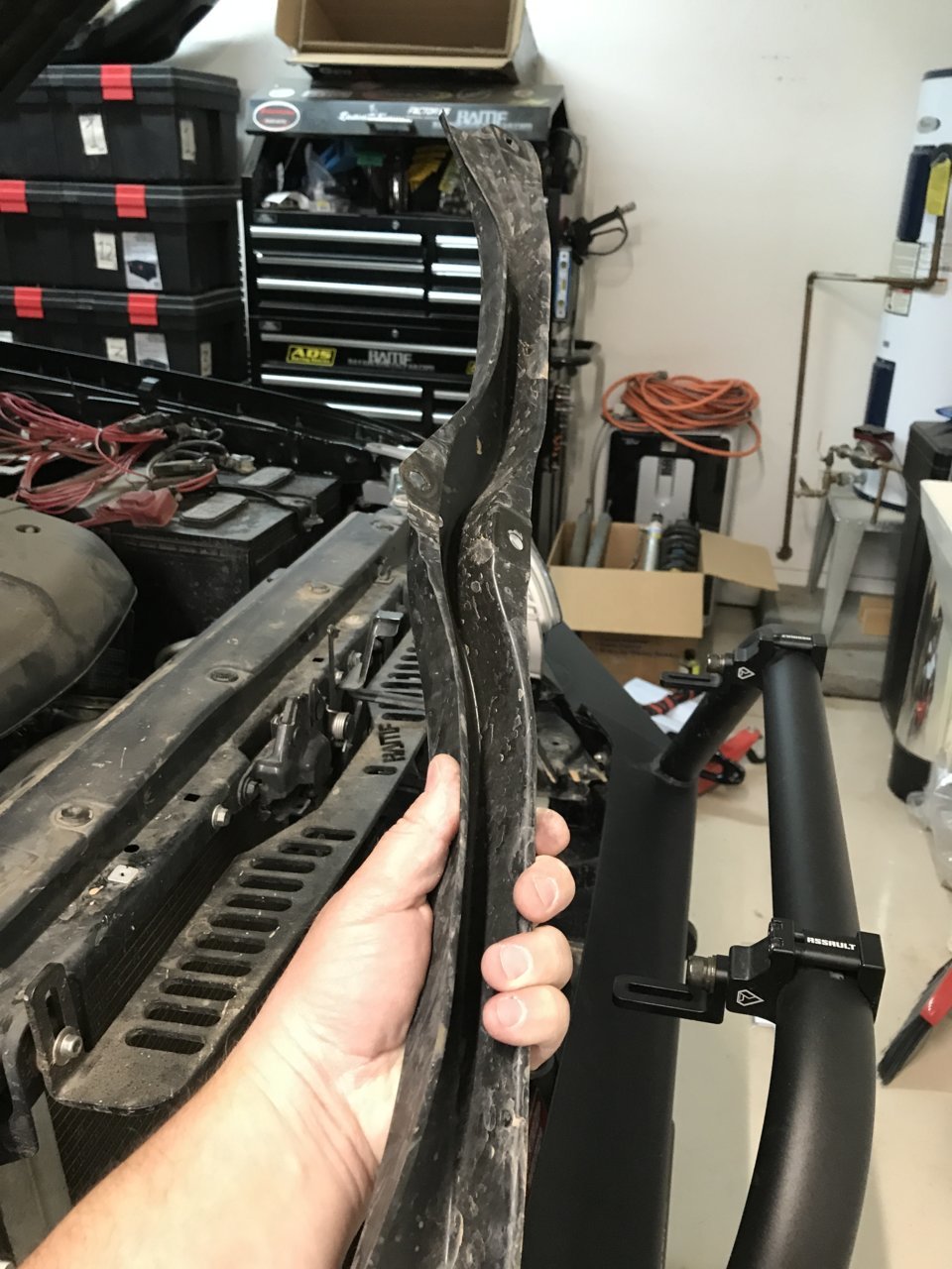

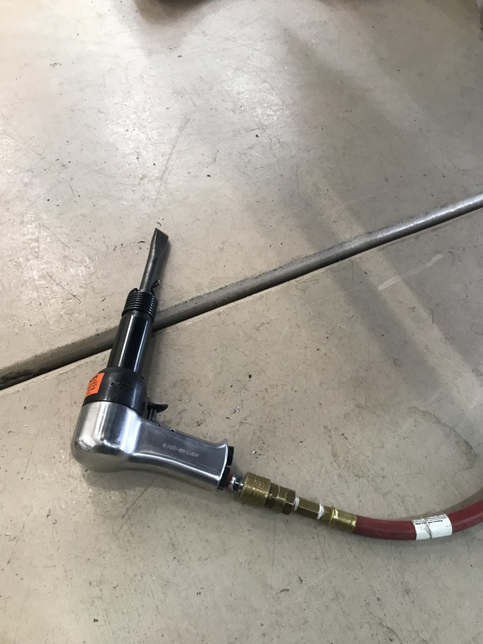

    Rivets....damn rivets.....

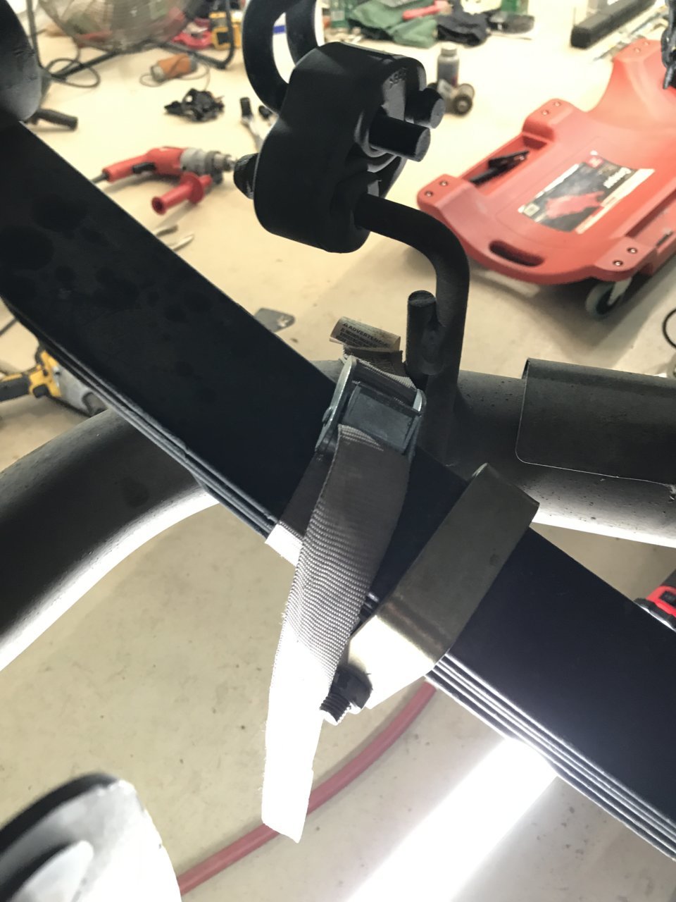

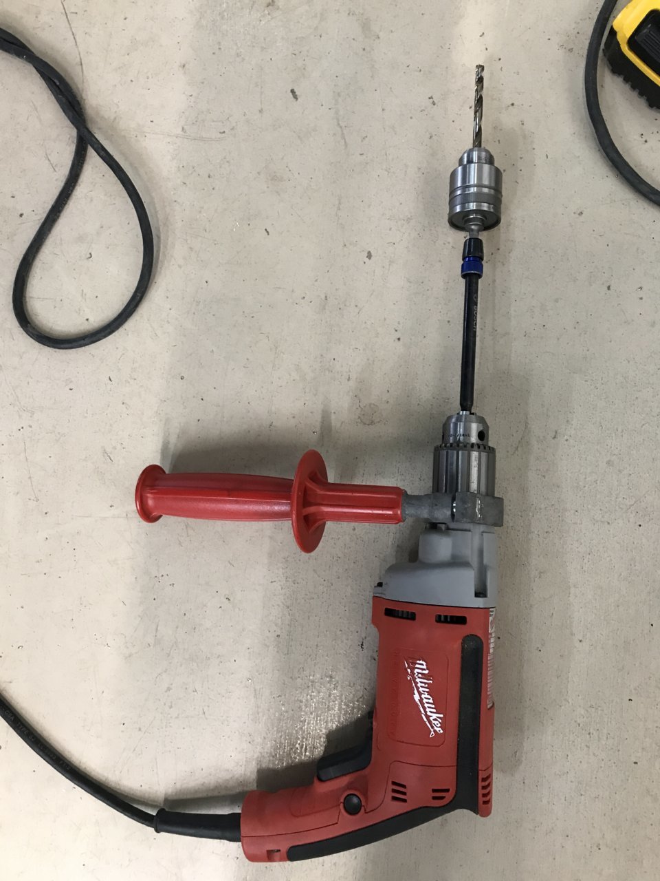

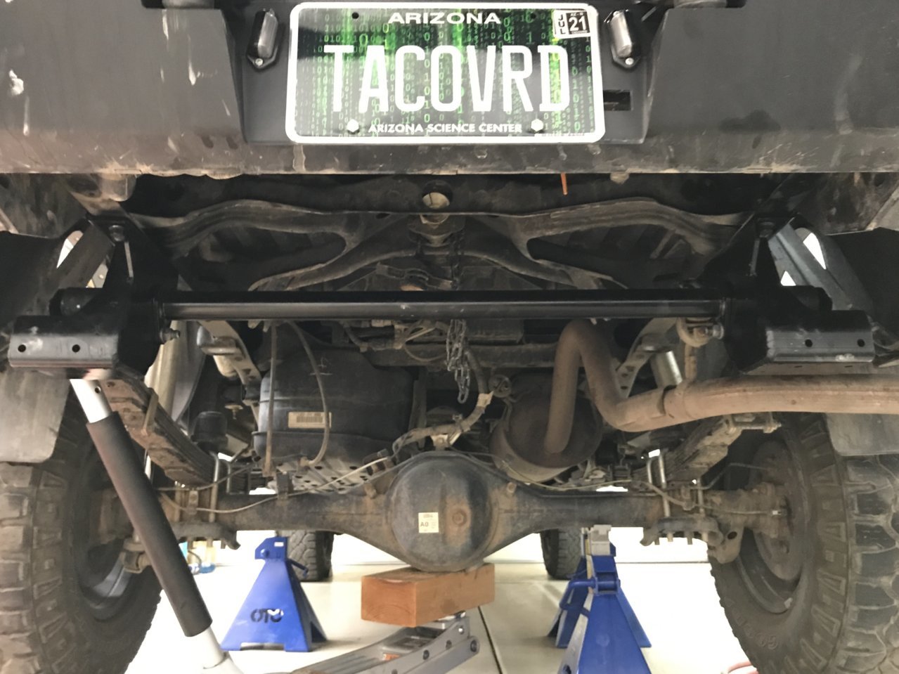

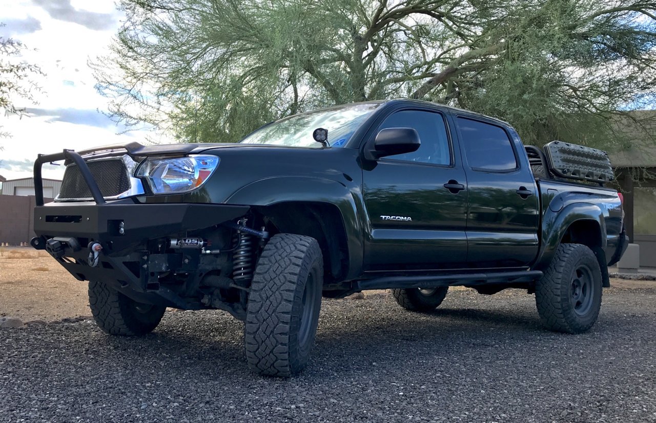

    Hammer hanger install went down last weekend. Spent several hours over a couple of days drilling pilot holes, enlarging holes and grinding rivet heads down overhead. Took plenty of breaks and primed & painted underneath the old shackle hangers that came off the truck to get rid of any surface rust and let it completely dry overnight before installing the new hangers.
    Some tools and tips that I gleaned from this install were:
    1. An angle grinder, air chisel and several cobalt bits (5/32, 1/4, 5/16, 3/8, 1/2) on an hex extension with keyless chuck made precise holes in the rivets allowing the rivet head and shaft to gradually be drilled out and the heads popped off. Some other people have reported using a ball joint press to remove the shaft of the rivet but this was not required for me.

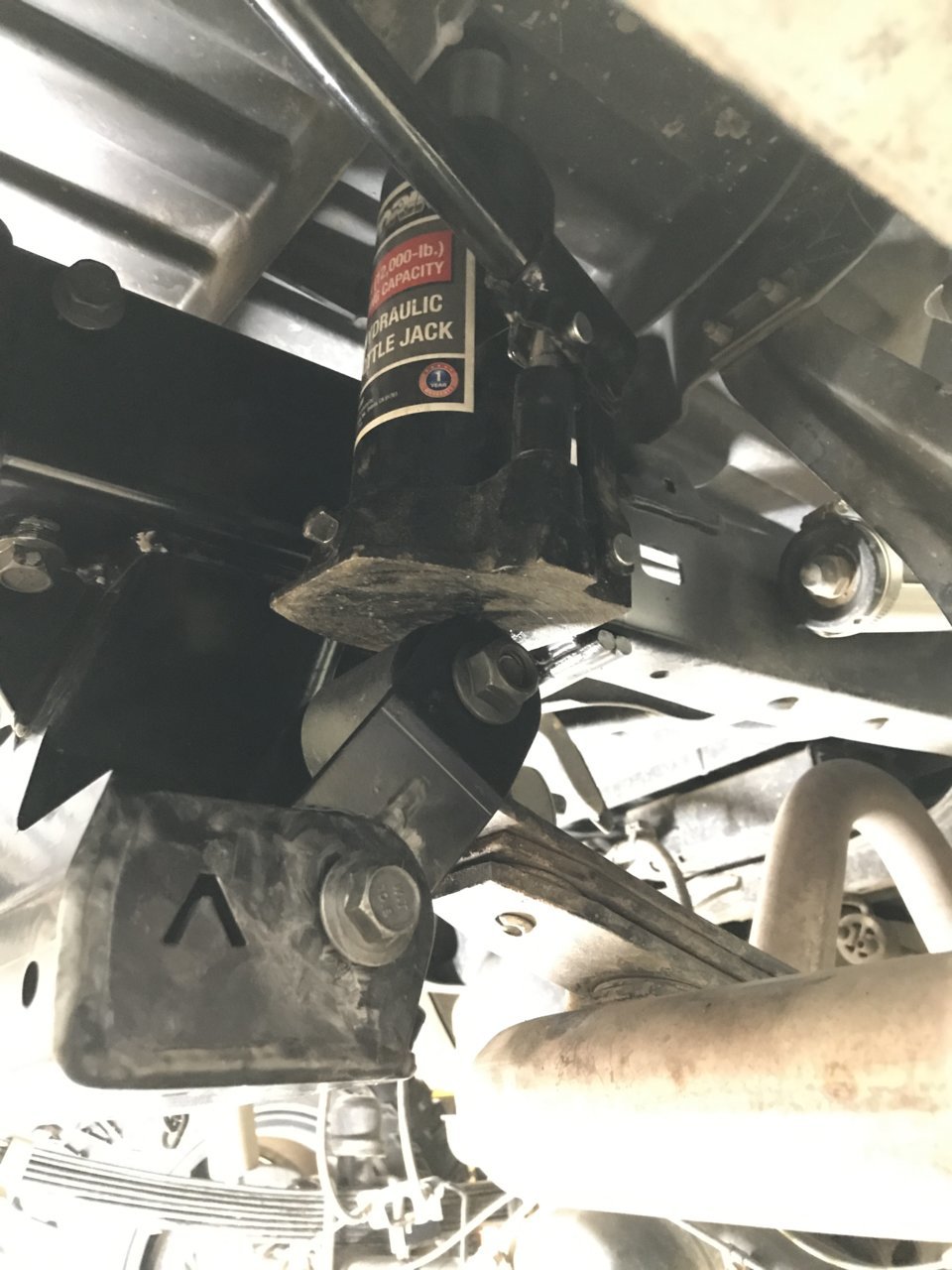

    2. Use a tie down strap to pull the exhaust out of the way enough to get your drill centered over the front vertical rivet on the passenger side hanger. Also a bottle jack between the leaf eye and the bed will help you easily push the shackle down into the hanger to get it installed.
    3. Finished install!

    Well, drove the truck for the first time since the hammer hanger install and on the quarter mile of washboard and rutted gravel road to get from my house to the main paved road, it’s night and day how solid and planted the rear end feels now.
    Fairly impressed. I’ll be honest I was just expecting beefier shackles but the increased stiffness is shocking.

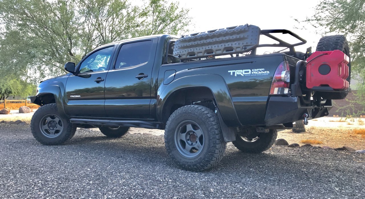

    Some glam shots from the last time it was washed.

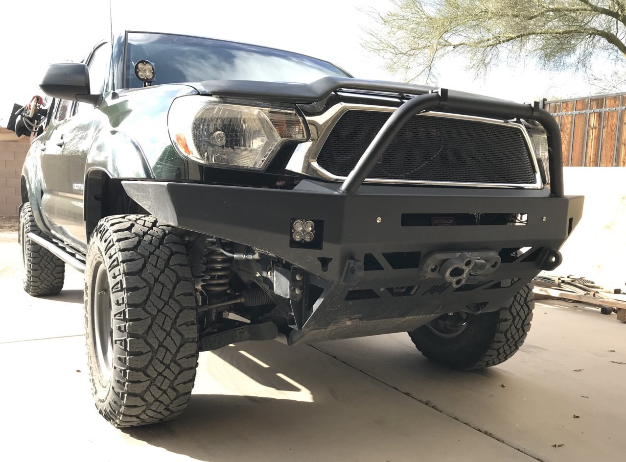

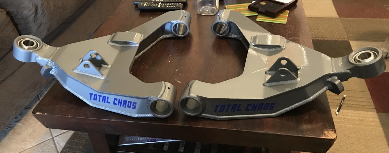

    TC LCA's installed. Heavier than stock arms but lighter & more ground clearance than stock arms + LCA skids that I was running previously in addition to a much stronger 1" uniball vs ball joint.
