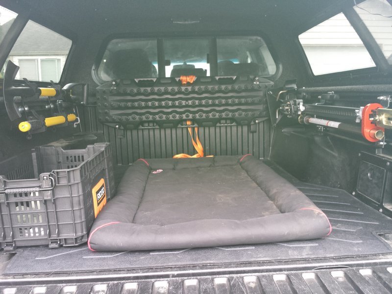

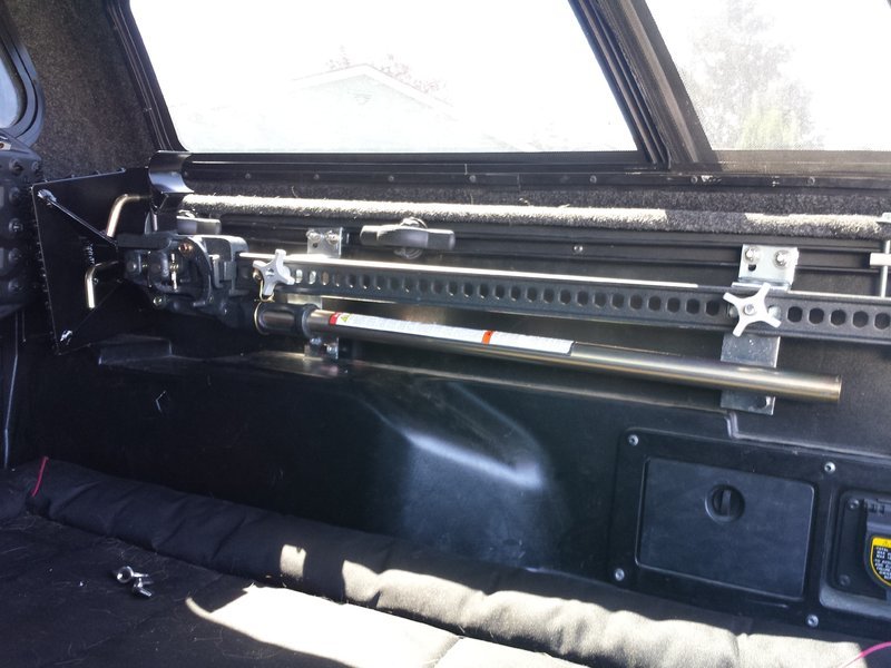

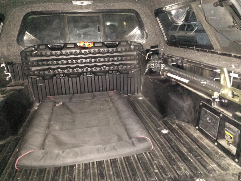

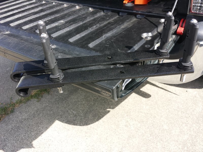

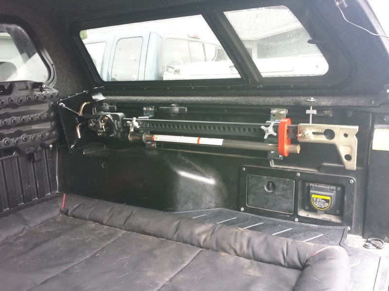

    Worked on a few things over the last couple of days. First off is a DIY Maxtrax mount made out of 14" hinge straps, T-slot nuts and a Maxtrax mounting pin set.
    I also replaced the wing nuts on my DIY Hi-Lift mount with some aluminum knobs I found on Amazon.

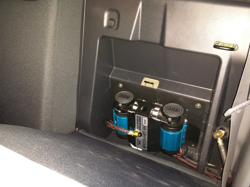

    Also, headed down to Mule Expedition Outfitters in Issaquah. They did a fantastic job installing the ARB Twin air compressor I picked up a few weeks ago. Big thanks to the awesome team of Dana, Joe, John & Phil!

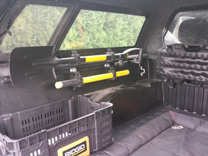

    Finished the shovel mount and now everything in the back has its own spot.

    Subd! Very nice looking truck! How do you like the ARB compressor?

    Thanks man! I've only played with the compressor a little bit so still early on but it seems to be an excellent quality unit and it pumps up pretty fast. Long term I'll look at Air Lockers but that won't be for a few years.

    I was debating getting one of the twins but had never seen one in person or talked to anyone that had used one. My compressor just takes wayyyyy too long to pump up my tires.

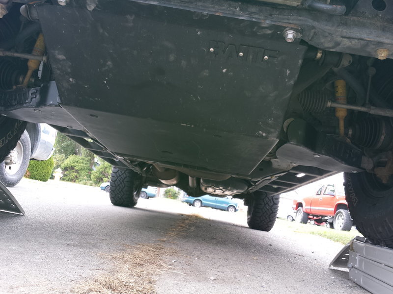

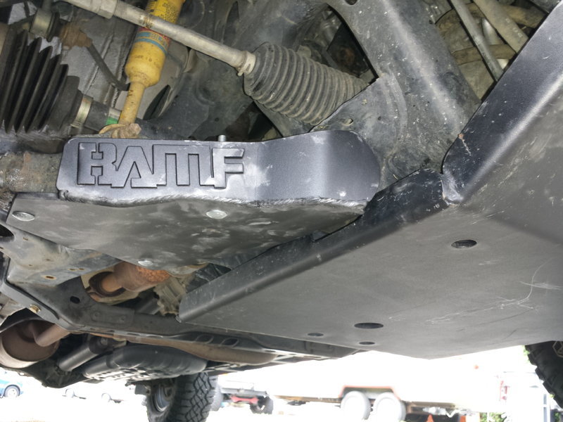

    Installed some LCA skids today....Bruce Wayne has the batmobile, I'm working on the BAMFmobile......

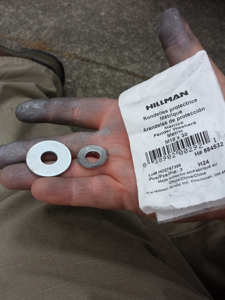

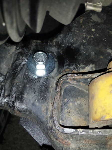

    When installing these skids the outer hole in the LCA has to be enlarged slightly to accommodate the bolt. I used a step bit for this.
    The hardware that came with the LCA skids had washers which were too small. If you look at the top of the LCA, the top hole is considerably larger than the hole on the bottom of the LCA. The washers that came with the skids started to suck into the upper holes of the LCA and deform as the carriage bolts were tightened. A quick trip over to Lowes and replaced the washers with some M10x30 fender washers. Much better.....

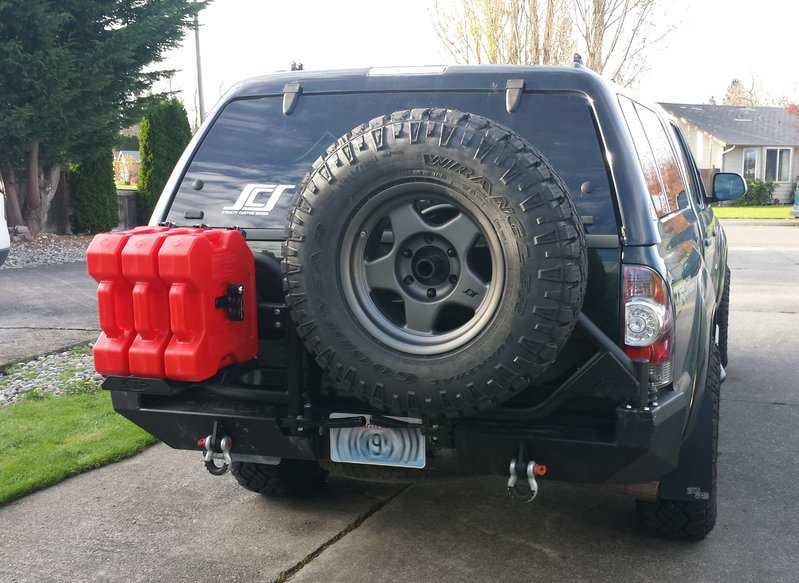

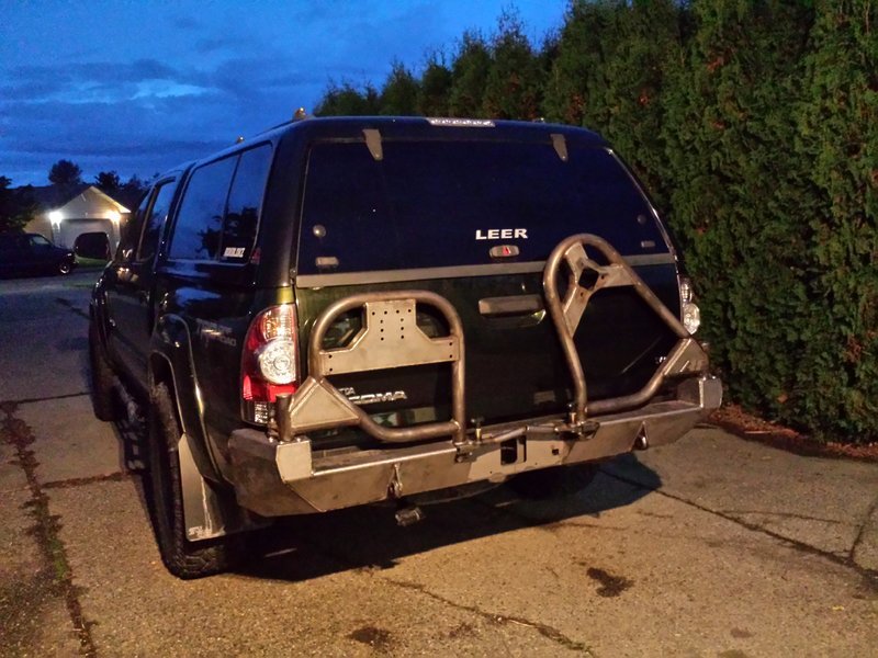

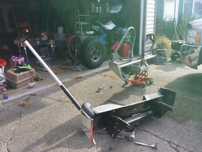

    Out with the old, in with the new -- All-Pro Dual Swingout Rear Standard Clearance w/ Rotopax mount.
    The short tranny jack saves the day again when working alone and you need another set of hands.
    Test fit is perfect. Now to remove it, pull all the hardware and get it prepped for the powder coater.

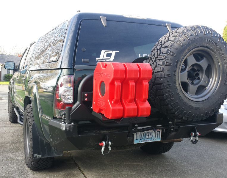

    Well, I've had the All-Pro Dual Swingout for about a month now and I have to say I love the design. The gates close firmly, there is no slop or bounce and everything just feels solid.
    Big thanks to everyone @allpro -- very well thought out design.
