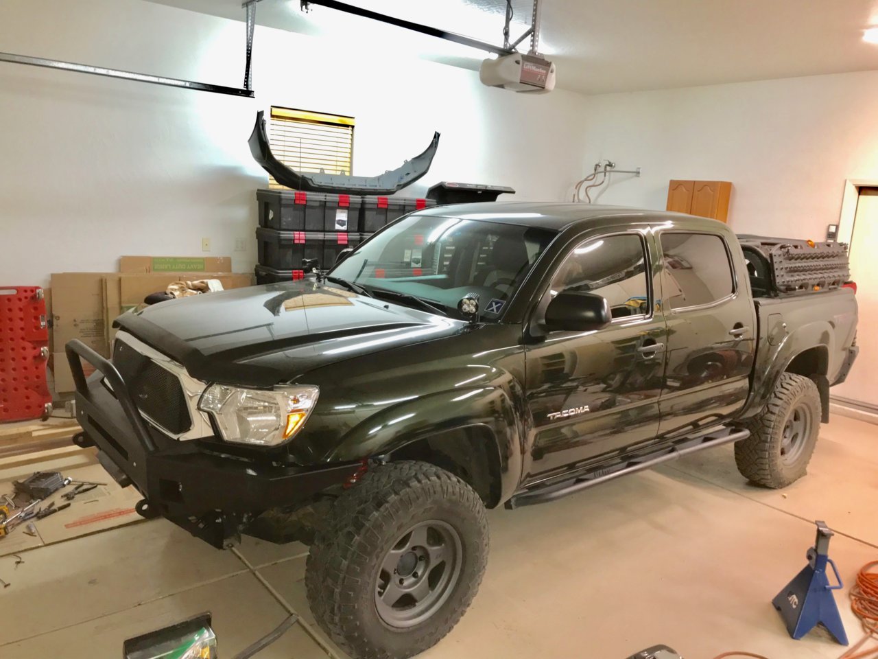

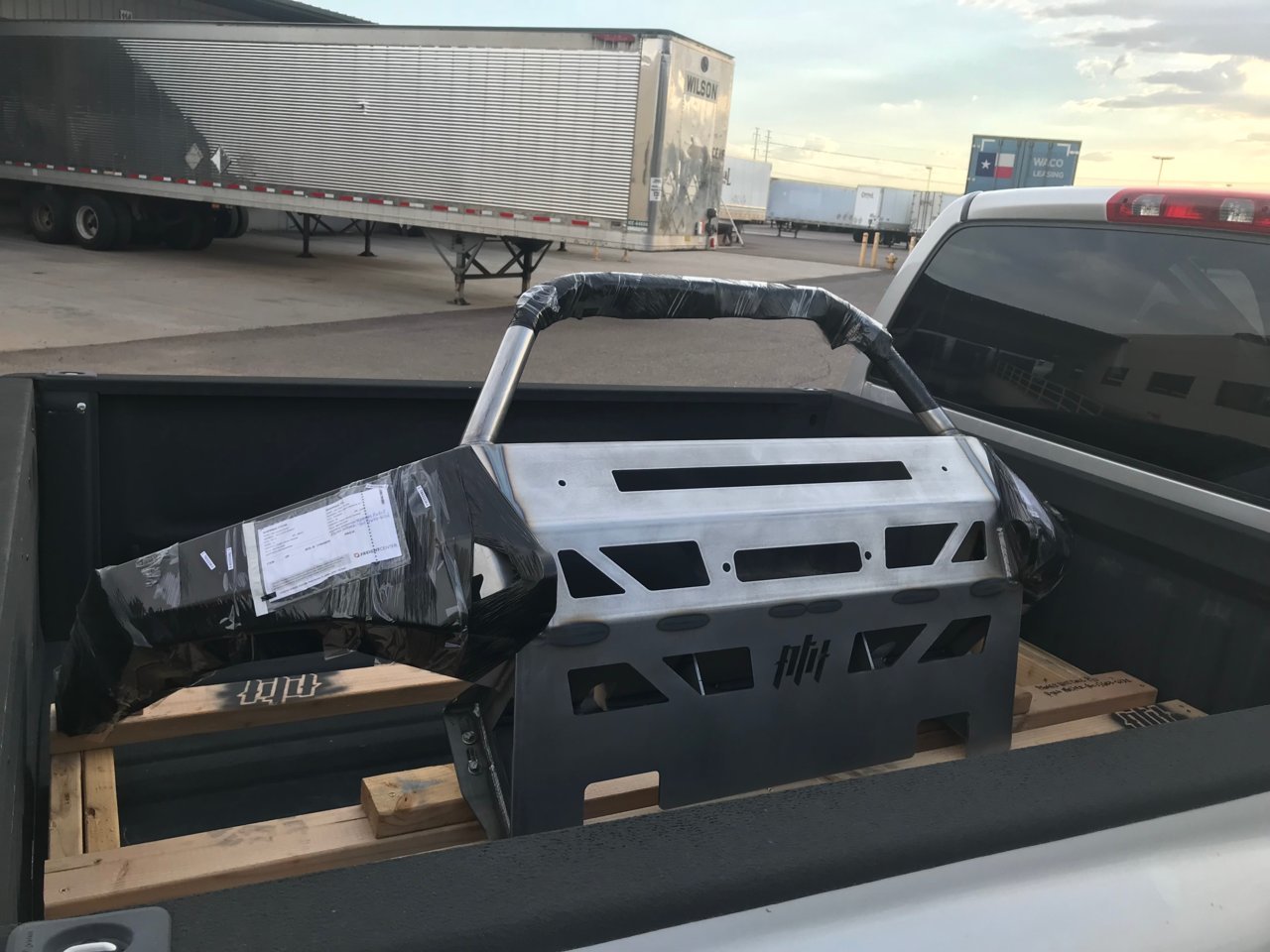

    Well this piece of artwork showed up today. Going to test fit tomorrow and hopefully get her dropped off for powder coating.
    @At The Helm front bumper!!! :hattip:Morgan!

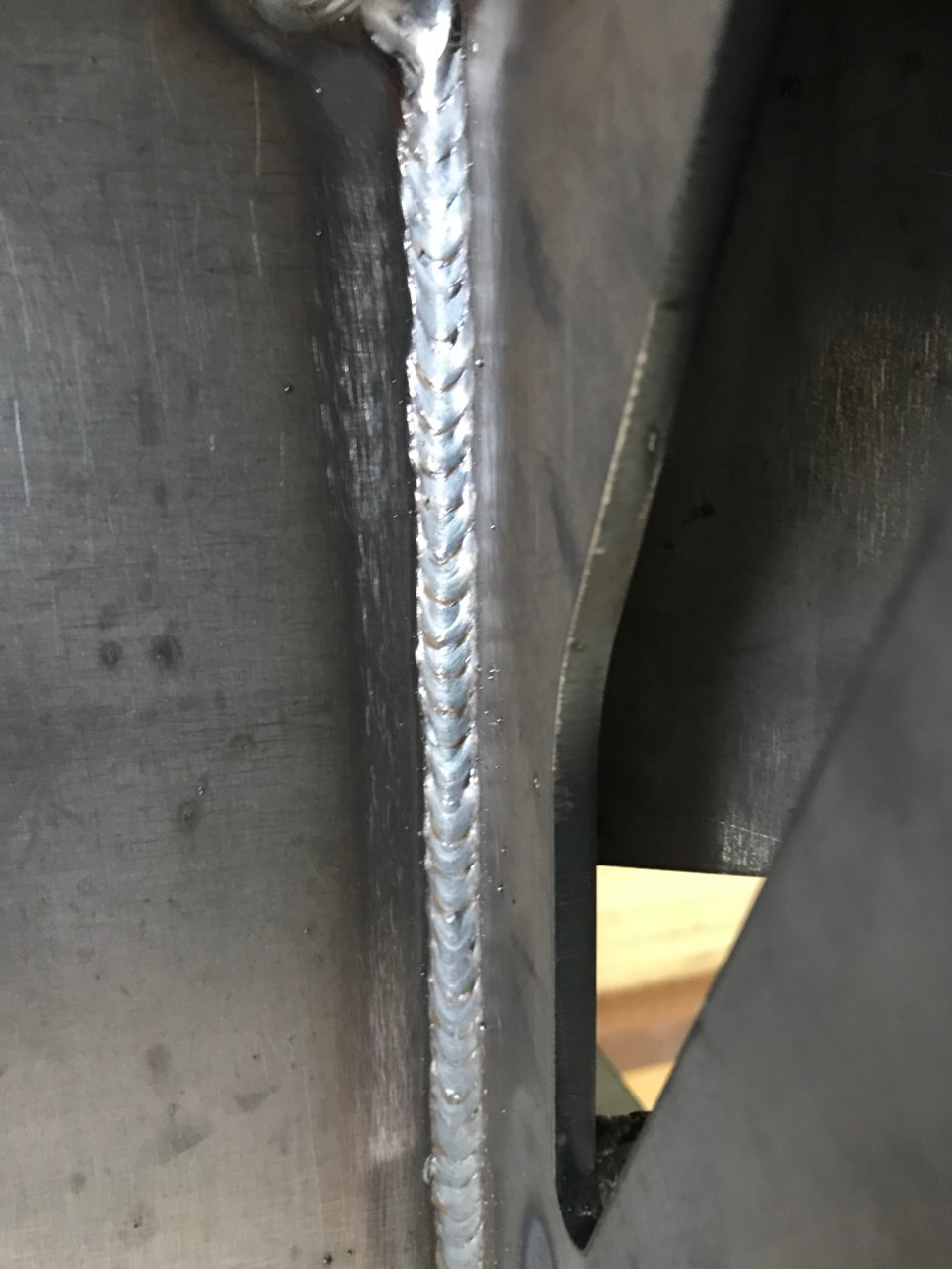

    I went with this bumper for several reasons which include full 3/16" steel construction throughout - main structure / skin / frame capture brackets / everything, integrated Hi-Lift points, nice clean lines and a style that isn't overdone or unnecessarily complex, and lines which offer a little more coverage over the front wing area compared to some other makes.
    Off to powder coat tomorrow :D:D:D:D

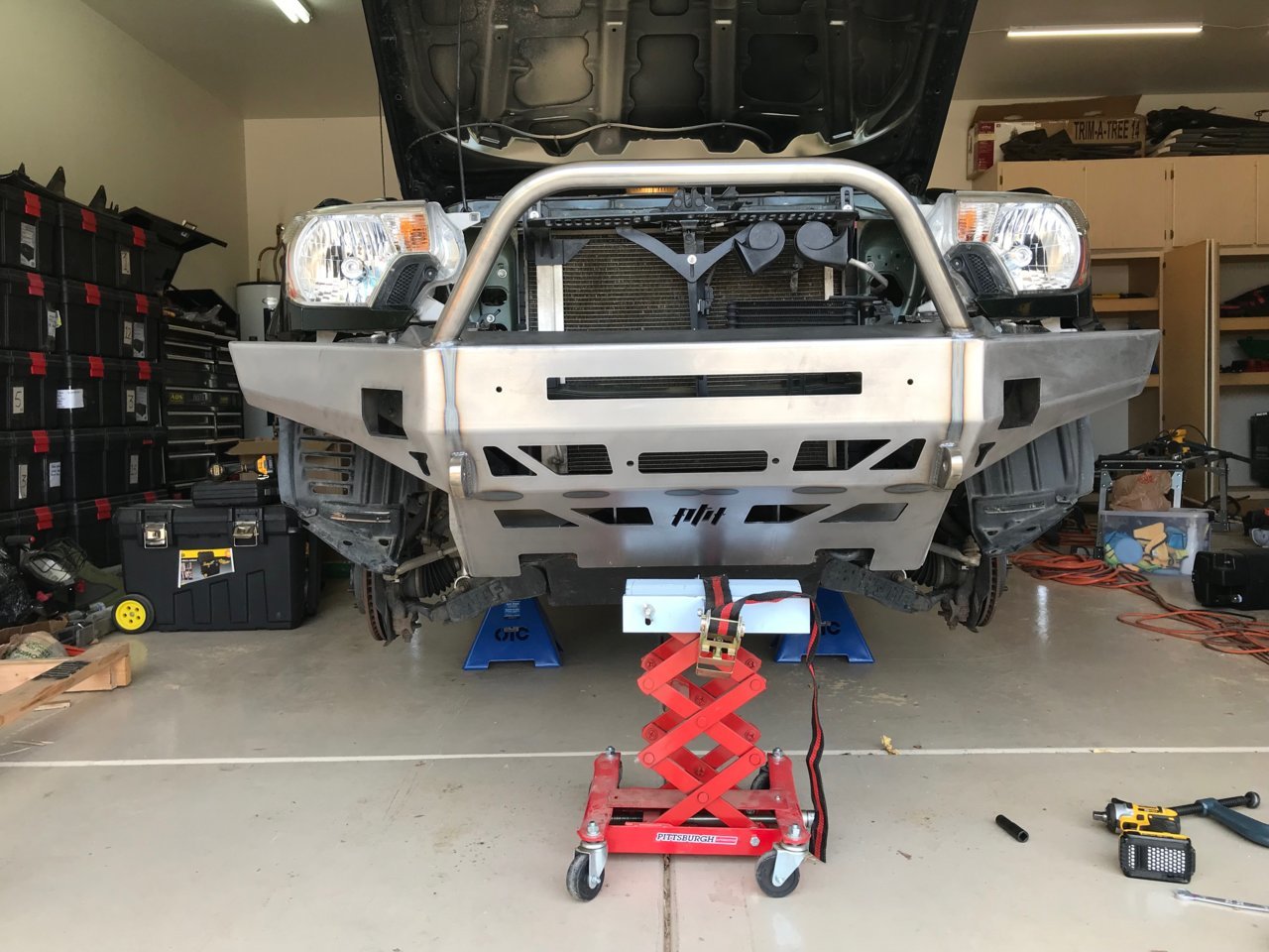

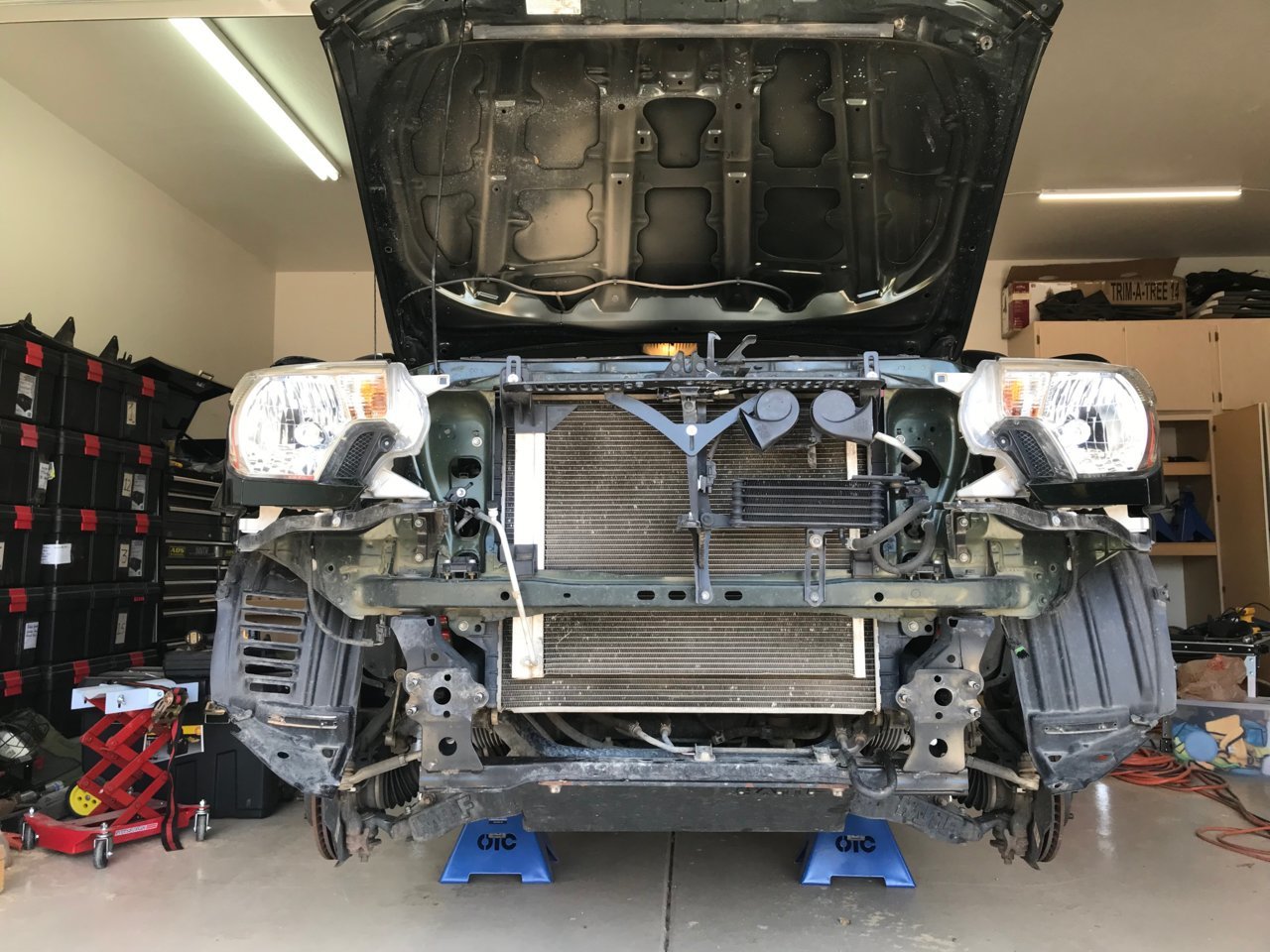

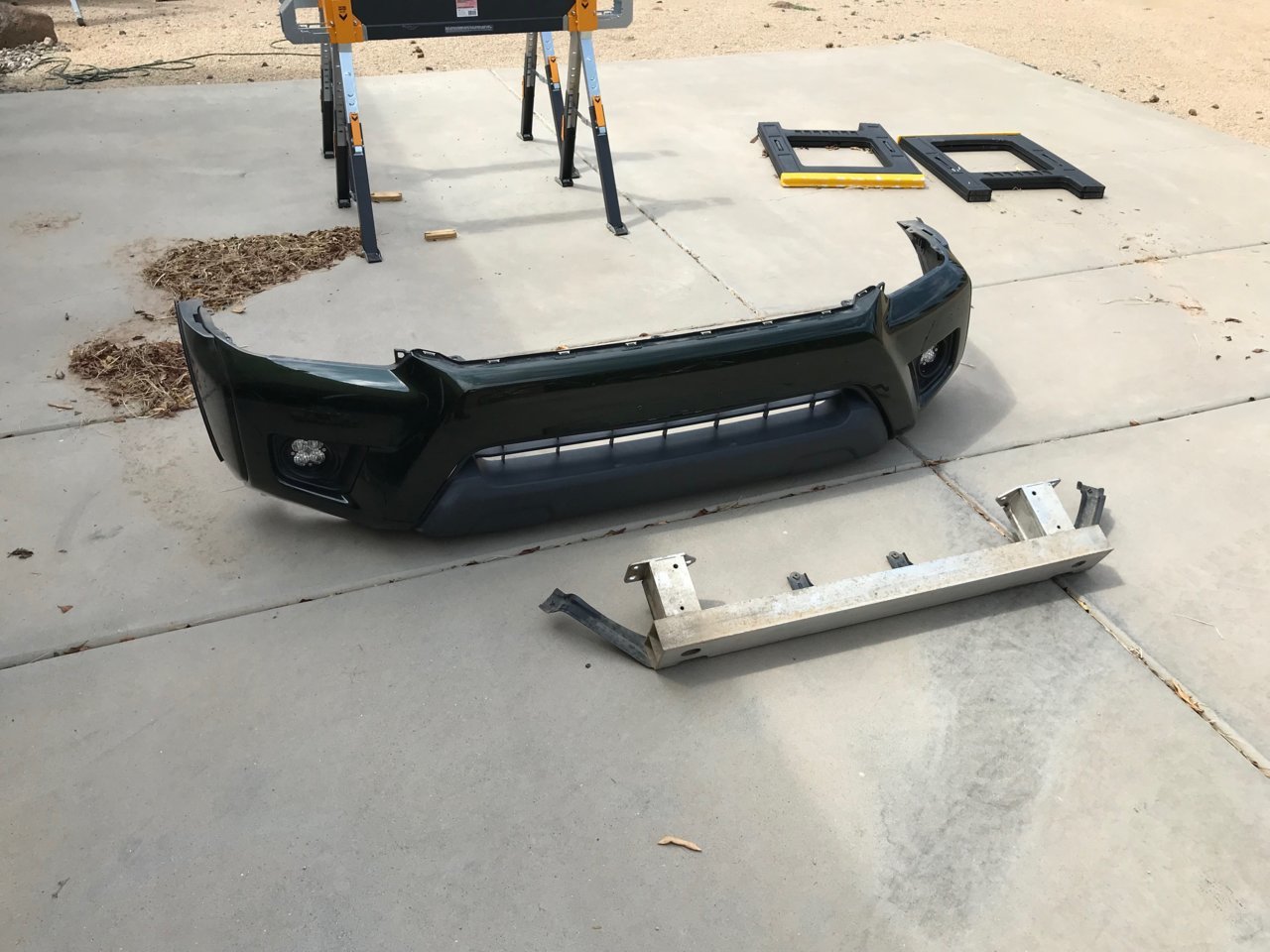

    Took the front end apart today to test fit the bumper before powder.
    Started with this:
    Popped the grille off by removing the two Philips head screws on top and removing the plastic rivets.
    Removed additional plastic rivets holding the top of the plastic bumper on.

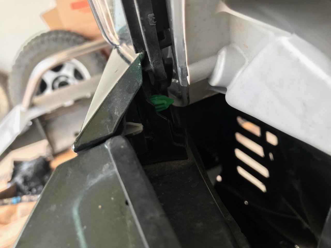

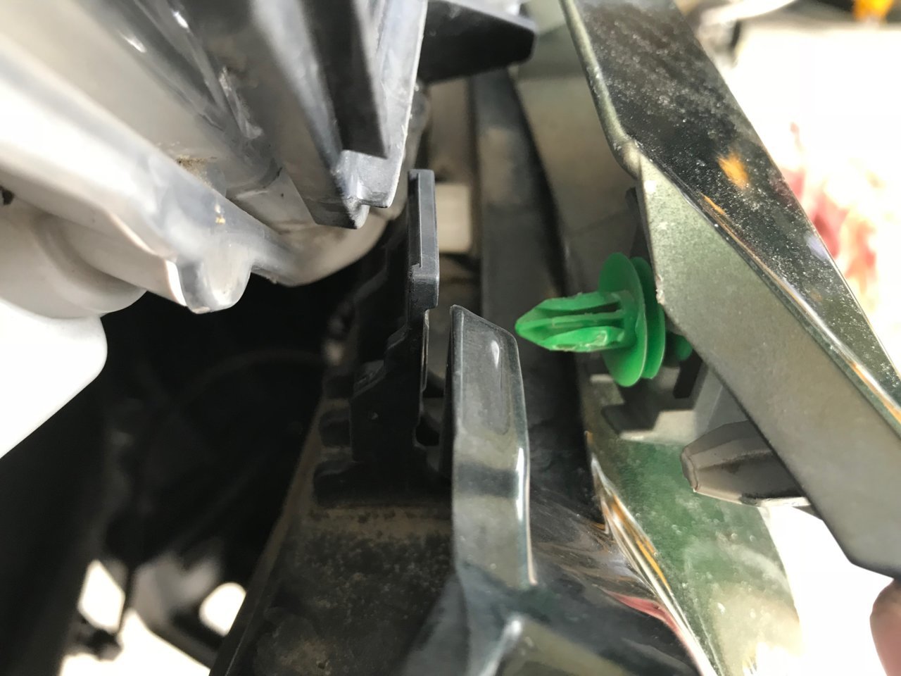

    Removed the headlight filler pieces by squeezing the green clip with some 30 degree needle nose pliers and once removed, pulling the filler piece towards the center of the bumper.
    Next, removed three Philips head screws and another plastic rivet and two 10mm bolts from the underside of the bumper below the fog light and up by the attachment to the fender and in the middle attaching to a brace.

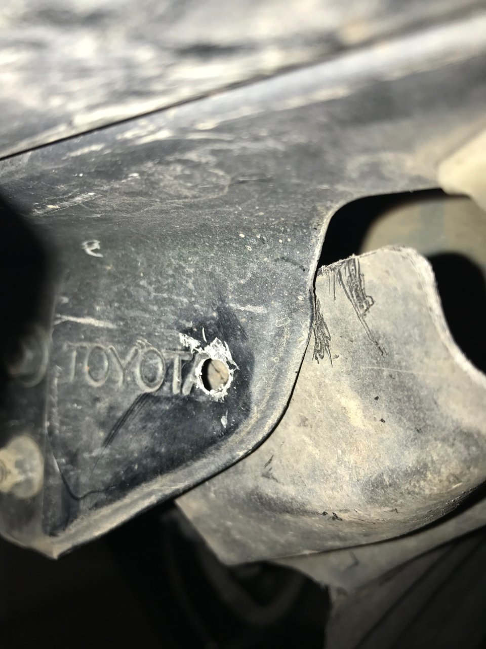

    The bumper should now only be help on by the clips between the top of the bumper and the fenders. My passenger side clip was not wanting to release easily so I took a plastic interior trim removal tool to apply some downward pressure to get the clip to release.

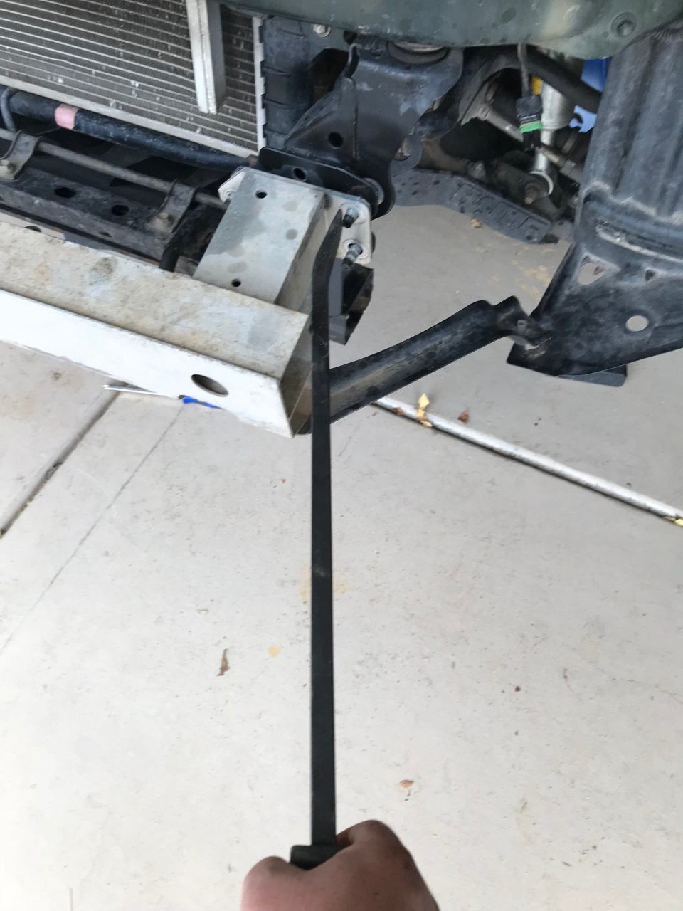

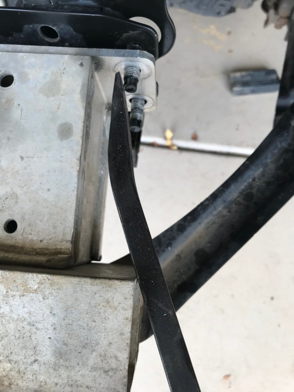

    Next the bumper pops off and the aluminum crush bar (the only real bumper on the stock truck) is removed by removing the 14mm nuts off of the 6 studs.
    I had to put a small amount of outward pressure on one of the studs to get it to slip off easily (you do not want to damage the threads on the studs!!)
    And voila!

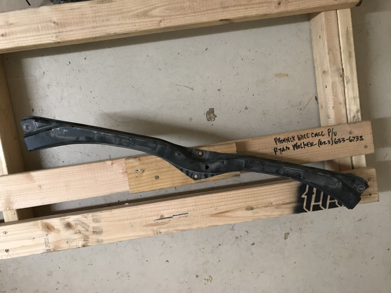

    The horizontal sheet metal bracket between the headlights is removed and now the truck looks like this.
    Test fit.....
    Dropped off at Avid Offroad today for powder coating.

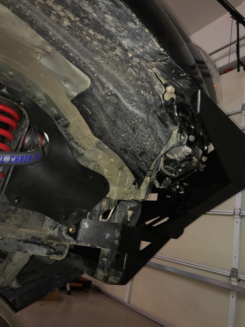

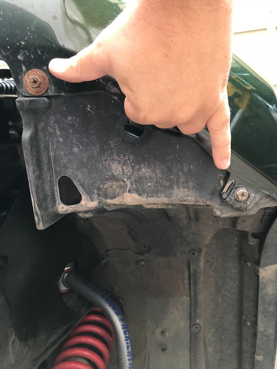

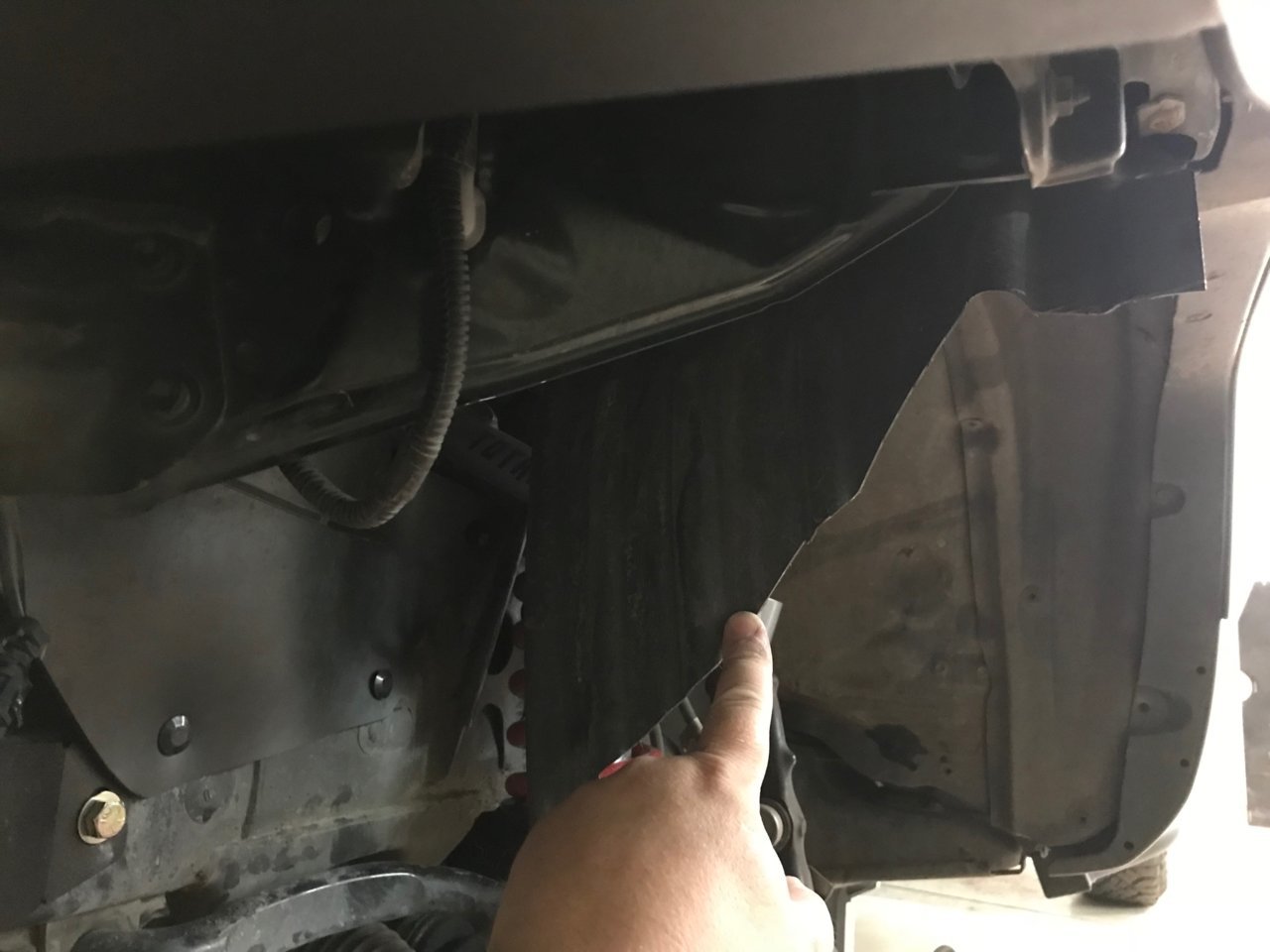

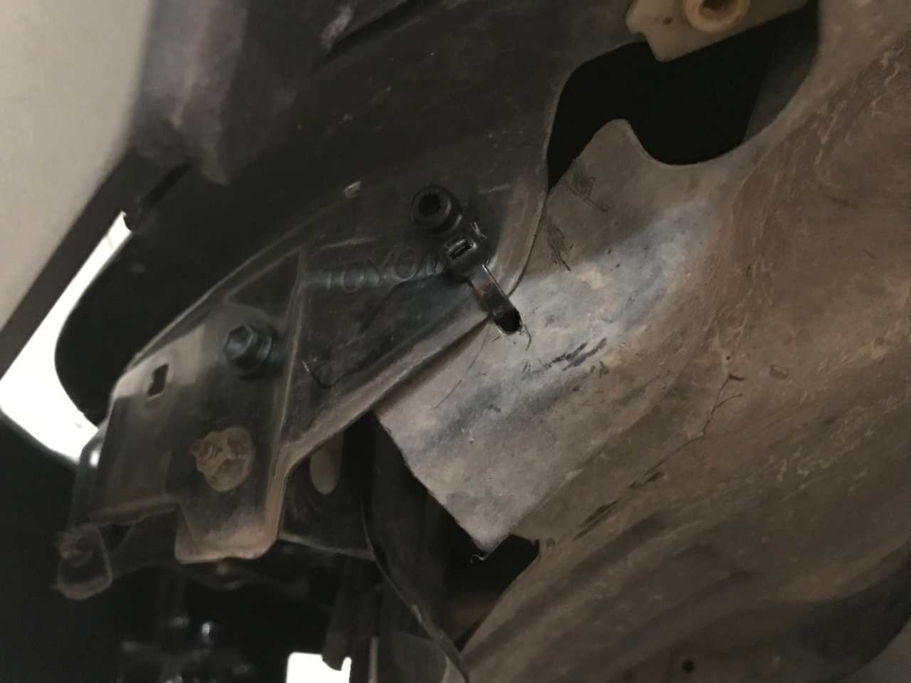

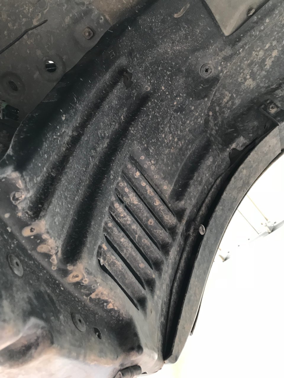

    What did you do with your plastic fender liners when you installed your bumper? Cut them off or I've seen where some have kind of folded them up?
  8. Jul 14, 2018 at 4:53 PM
    #128
    Juforrest
    Juforrest Dumb!
    Nov 23, 2015
    #170434
    5,948
    Justin
    Seattle
    Reformed Taco driver in a GX460
    Chop chop. Now that I'm making room for 35's they are gone altogether.

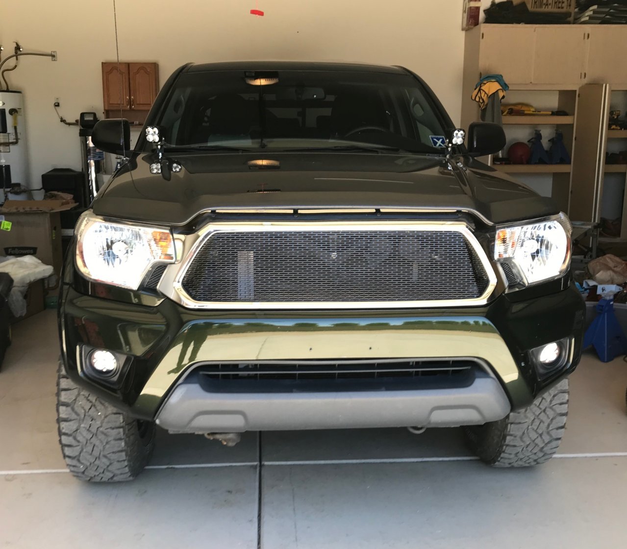

    Almost done, just need to drill some holes in the grill or get some long zip ties to secure the bottom.

  14. Jul 21, 2018 at 6:30 AM
    #134
    Juforrest
    Juforrest Dumb!
    Nov 23, 2015
    #170434
    5,948
    Justin
    Seattle
    Looks good.
    TACOVRD[OP] likes this.

    When you installed your bumper did you remove the horizontal brace between the headlight supports?

    No, did you need to remove that to install yours?

    Yeah that’s what the instructions said to do but looking at it now that everything is assembled I’m having a hard time just eyeballing where the interference is supposed to happen so I’m going to pop the grille off and try and reinstall that piece to see if it works.

    I took it out to drop the winch in and then put it all back together.
