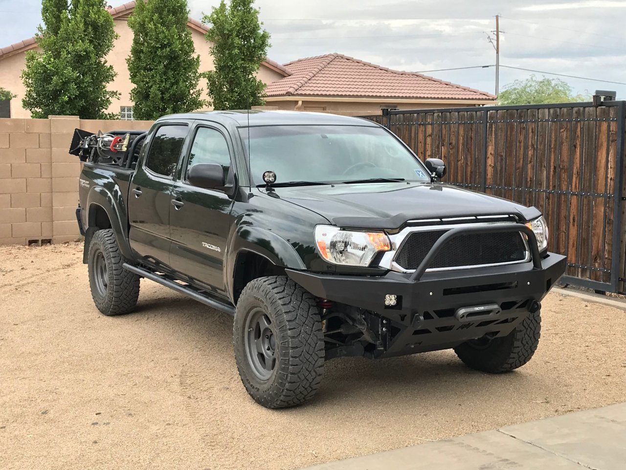

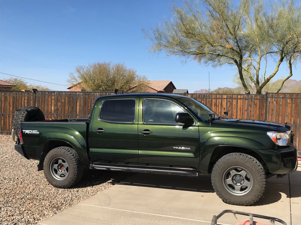

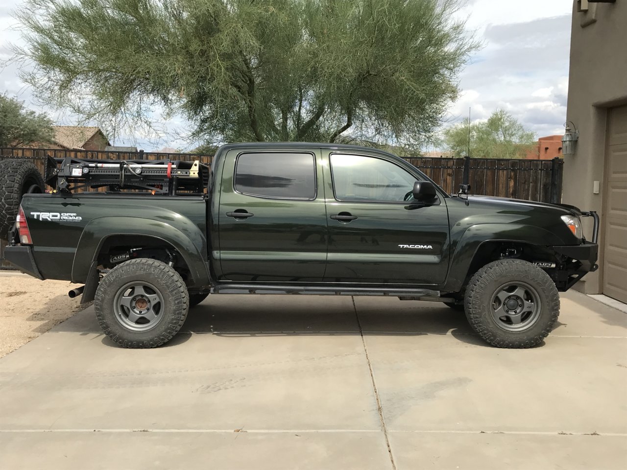

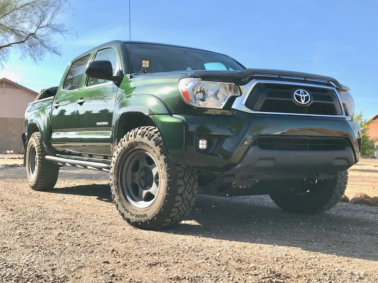

    Just a couple of comparison shots comparing pre- bumper, bed rack, grill and rear ADS shocks to current.

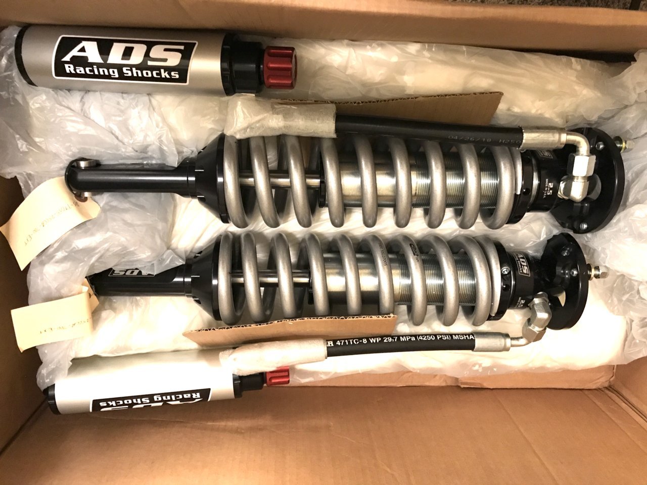

    Thanks!!! She’s slowly coming together. I’m going to be ordering the matching front ADS extended travel remote resi’s w/ clickers this week.

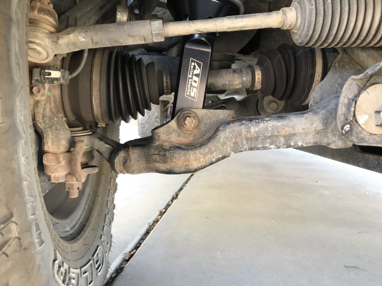

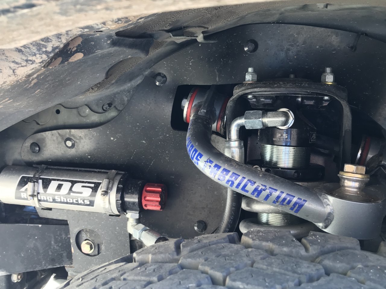

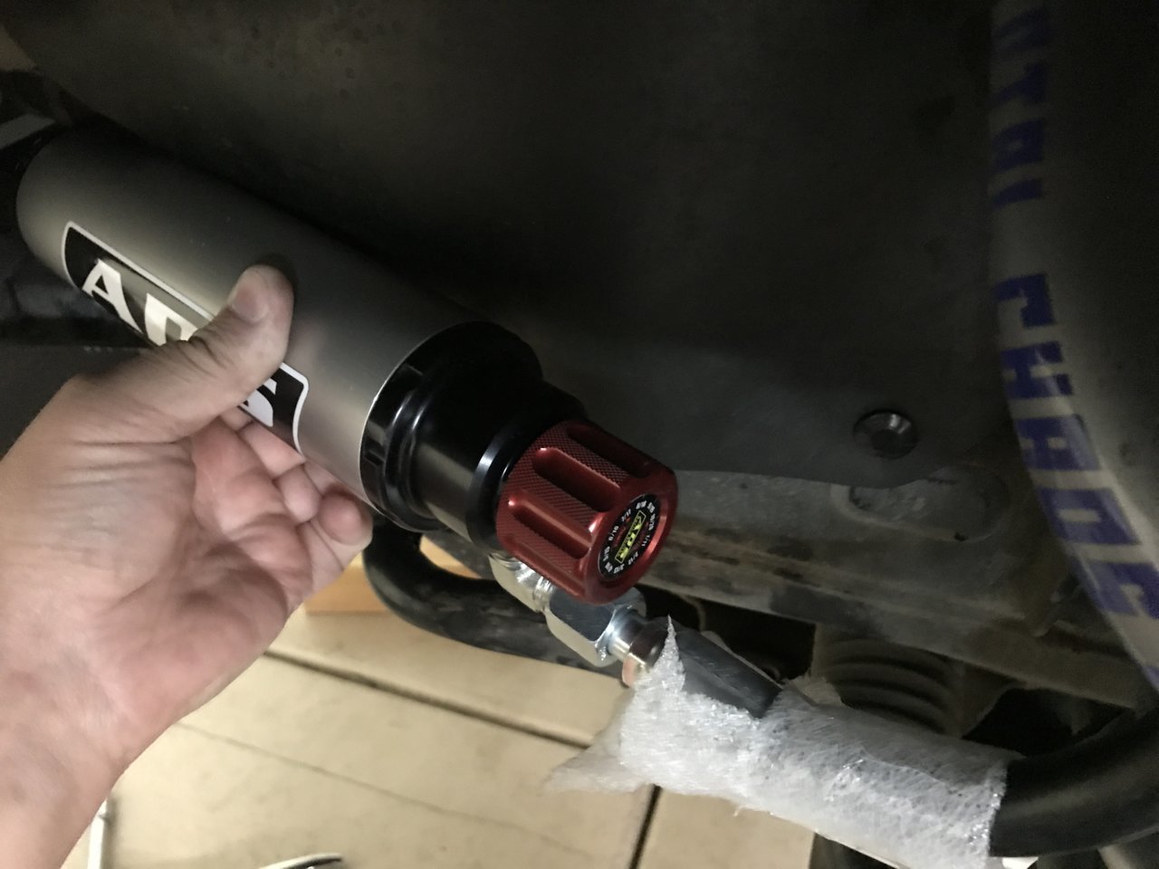

    Workin' on it....
    Got everything buttoned back up today.

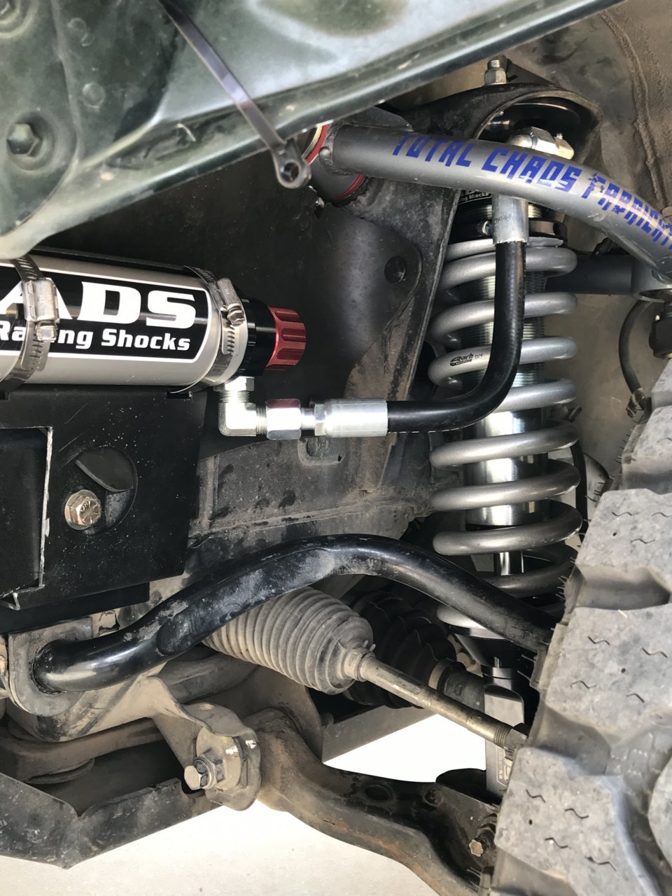

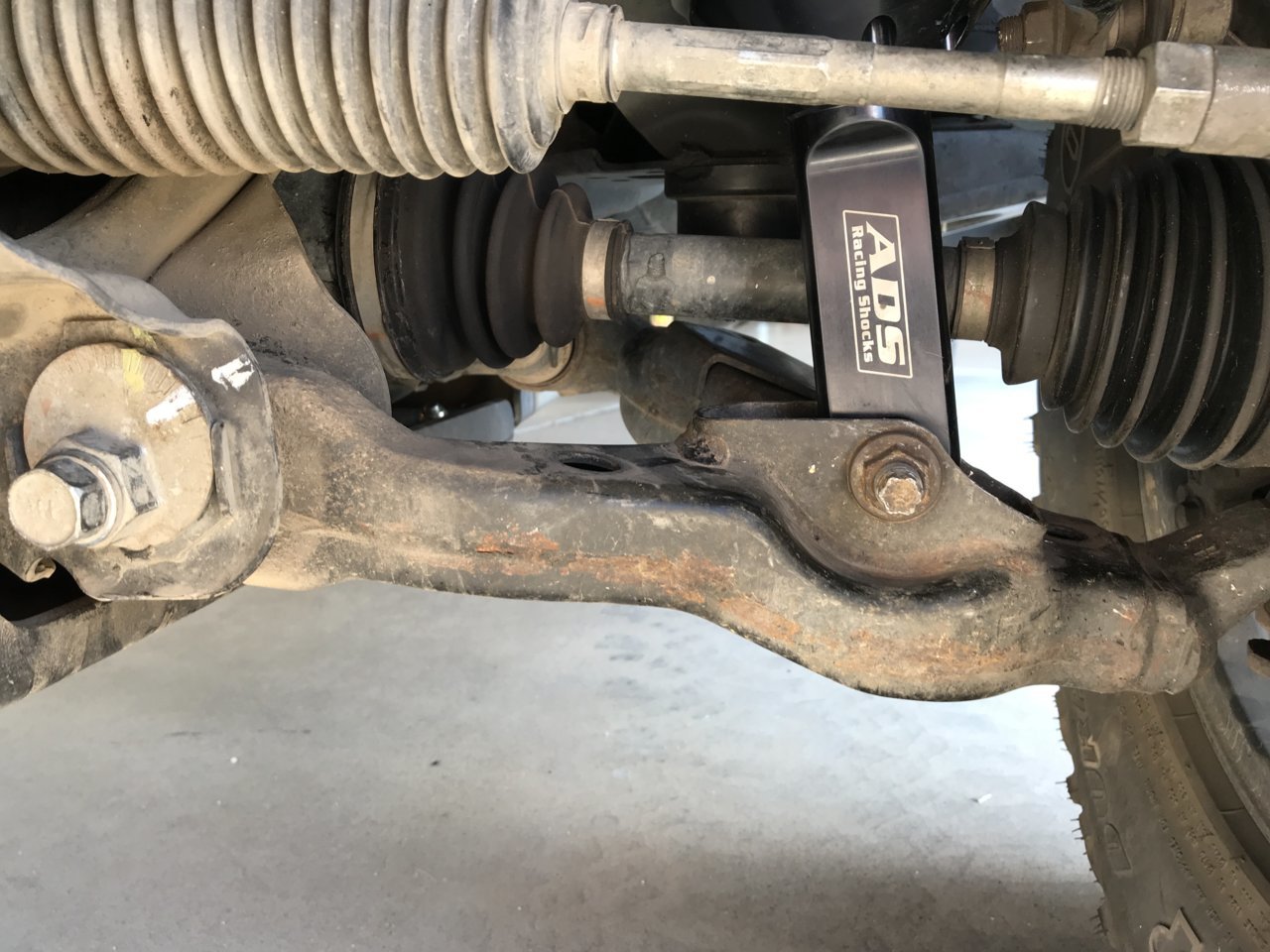

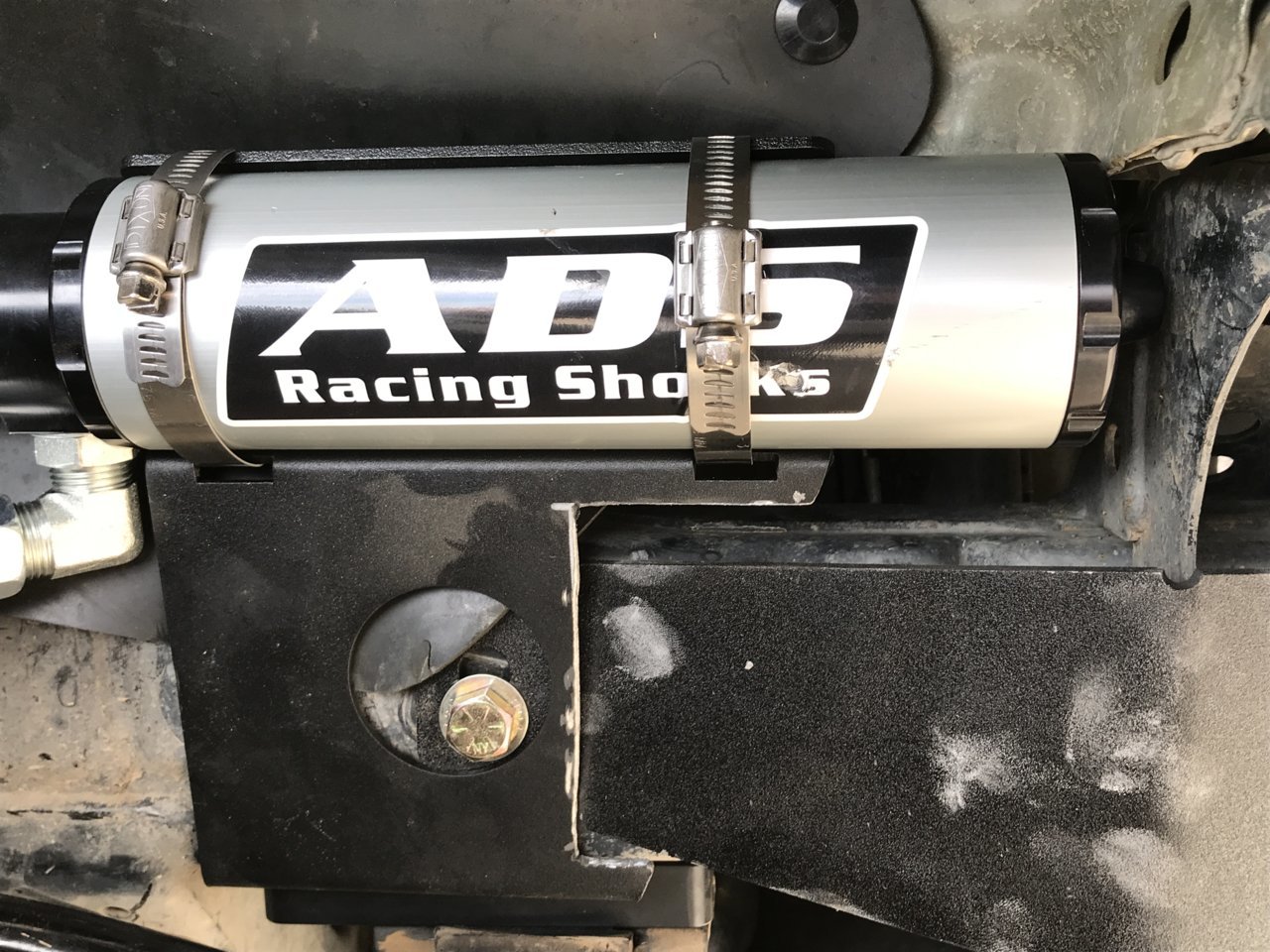

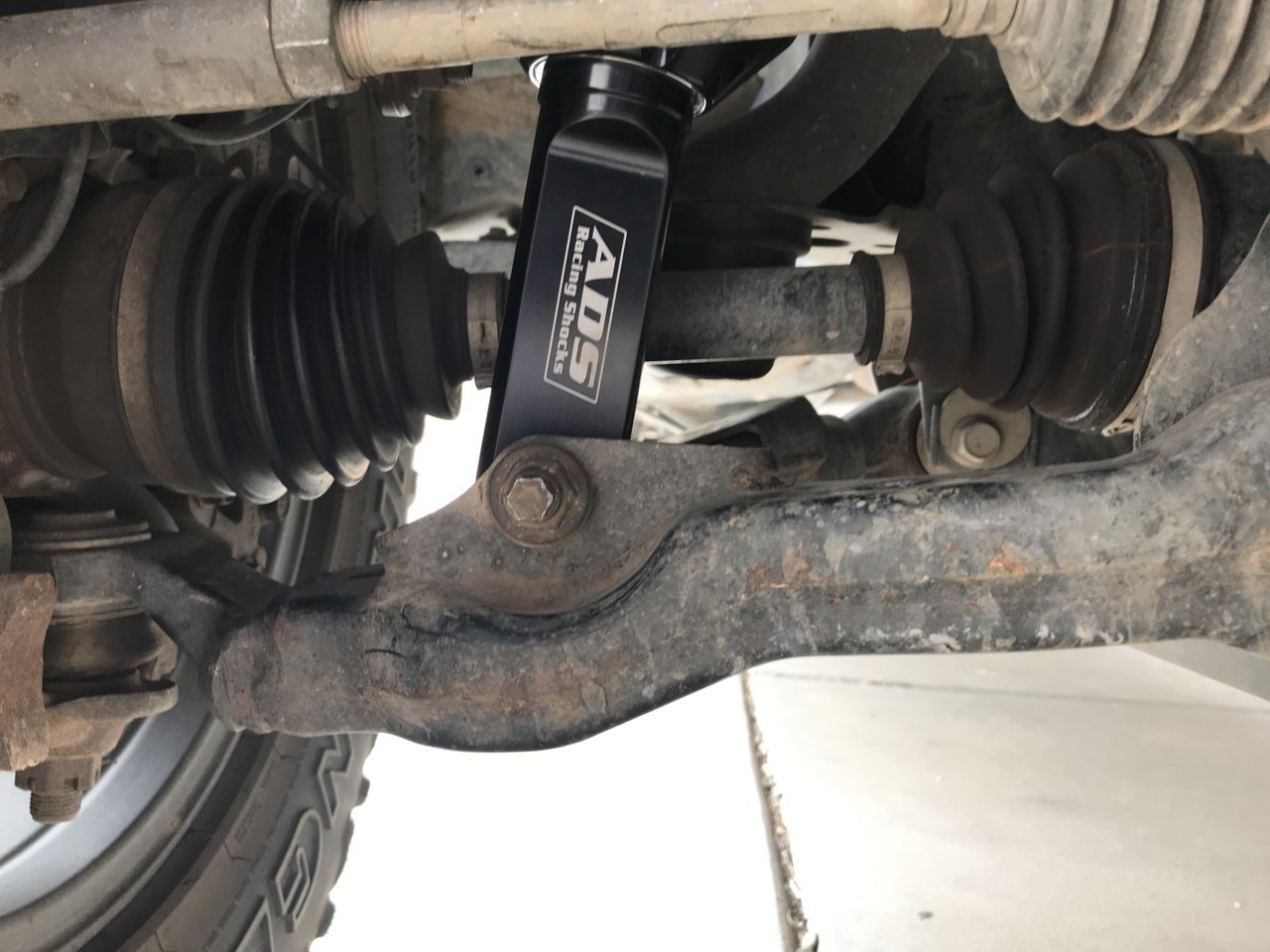

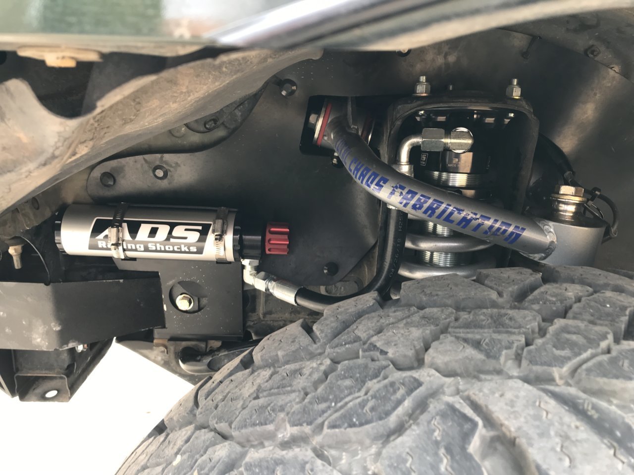

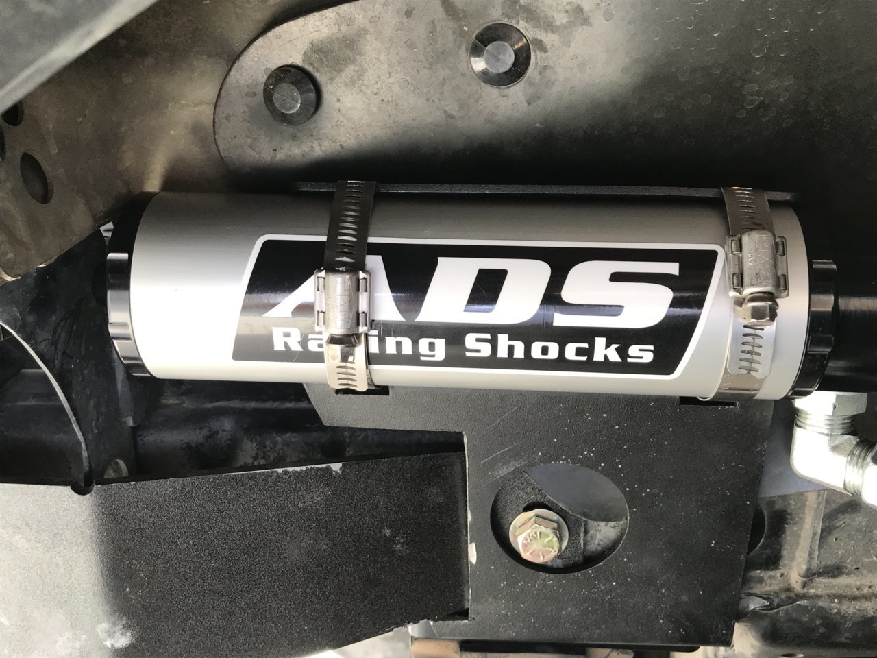

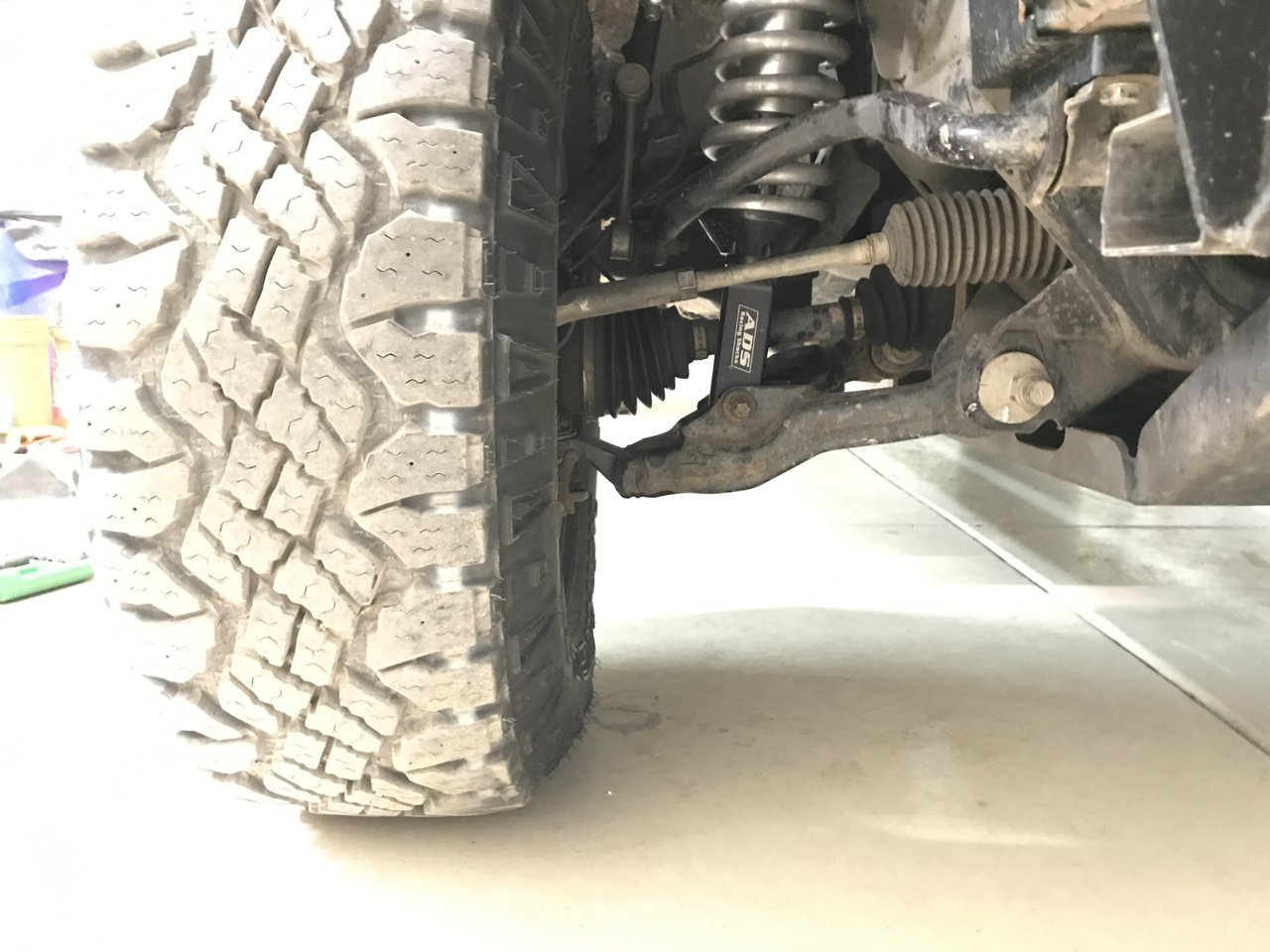

    700lb coils and the shipped amount of preload yielded about 1” of lift over where my TRD PRO Bilsteins were with approximately 200lbs of weight up front (130 lb front bumper + 1/4” IFS skid).
    Pretty straight CV angle’s.

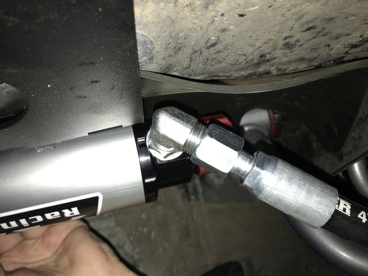

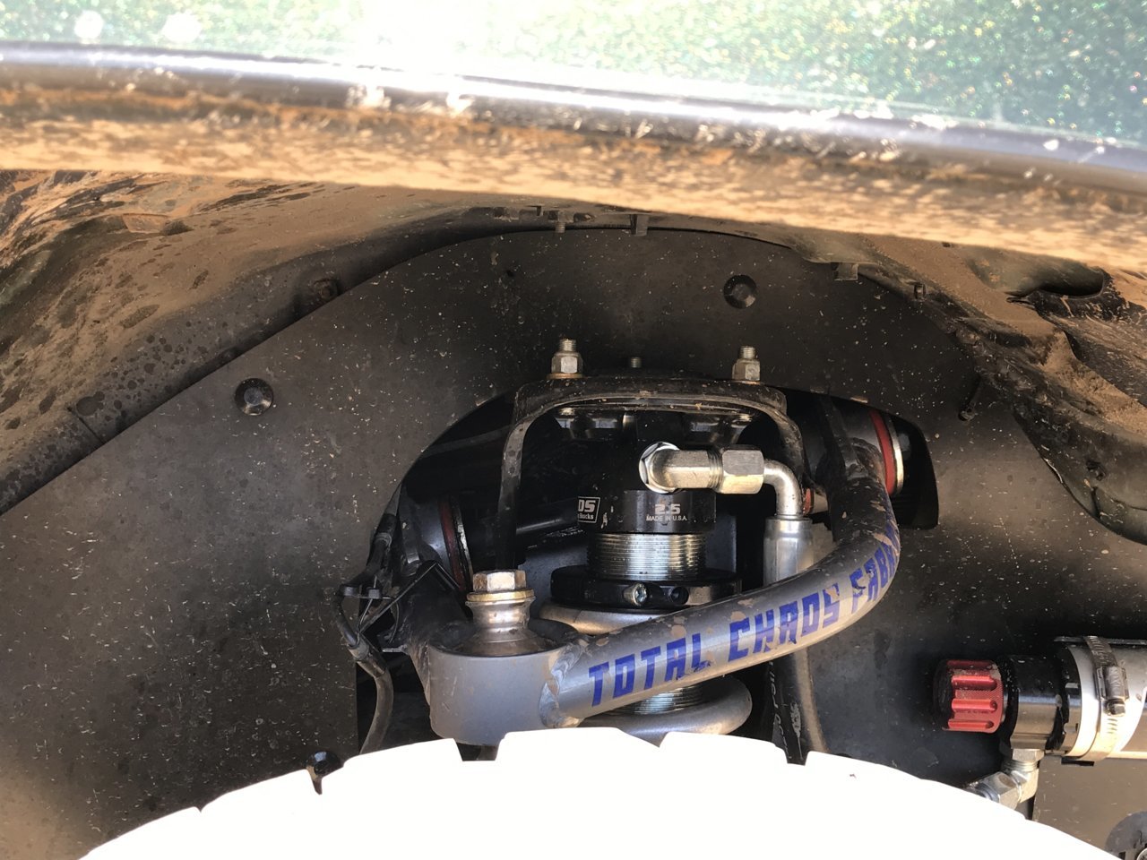

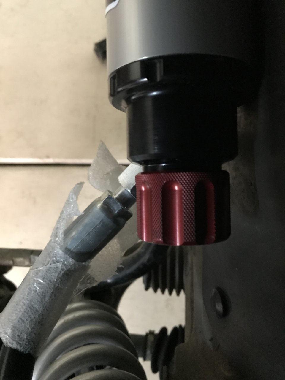

    When the coilovers are shipped they ship with the hoses in line with the clickers on the resi’s. In this way the resi wouldn’t sit flush on the bracket.
    Both hoses had to be adjusted at approximate a 45 degree angle from the clicker.

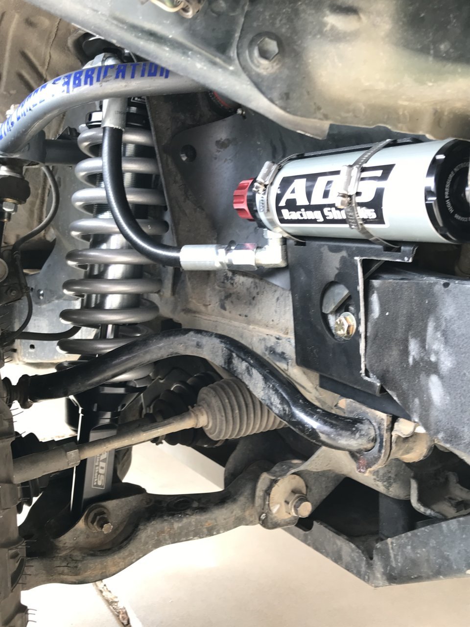

    Drivers side for reference:
    Passenger side from below.
    I did need to notch the resi brackets to work with my At The Helm bumper frame tie-in brackets.
    I’ll be doing a little shake down run on Monday so we’ll see how they handle.

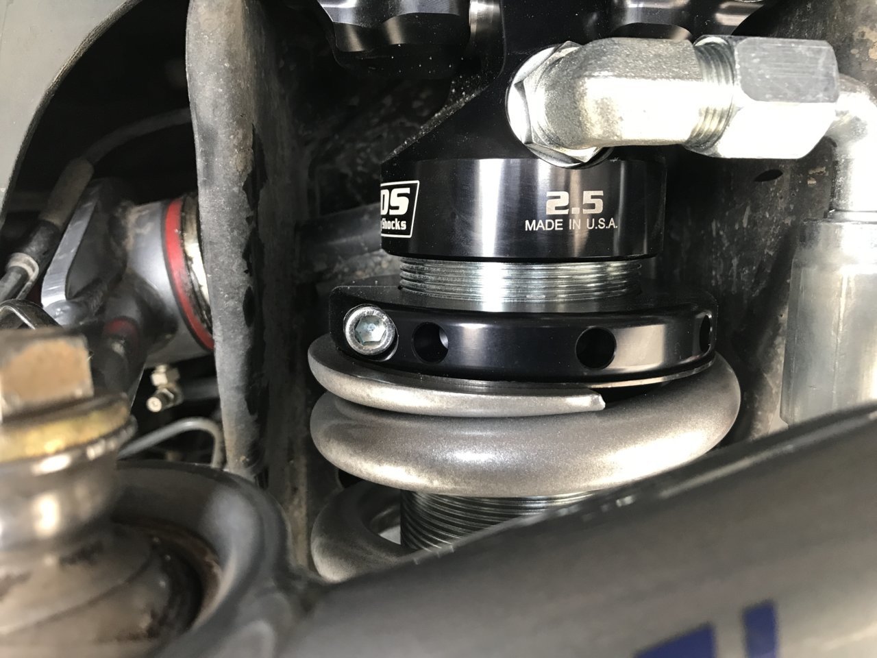

    Well after a thousand miles or so I decided to adjust the preload figuring that the coils should have been well broken in and whatever settling has probably occurred.
    Pre-measurements of the unloaded length of the coils and the amount of preload measured from the top hat to the lock ring were:
    Drivers - 12.25" / 1/2", Passenger - 12.5" / 3/8"
    Adjustment of the collar to increase preload yielded:
    Drivers - 11.75" / 1", Passenger - 12" / 7/8"
    Post-adjustment with a full tank of fuel the ground-to-fender measurements were:
    Drivers Front Passenger Front
    36.5" 37.5"
    Drivers Rear Passenger Rear
    38" 38.5"
    CV angle still seems pretty good.
