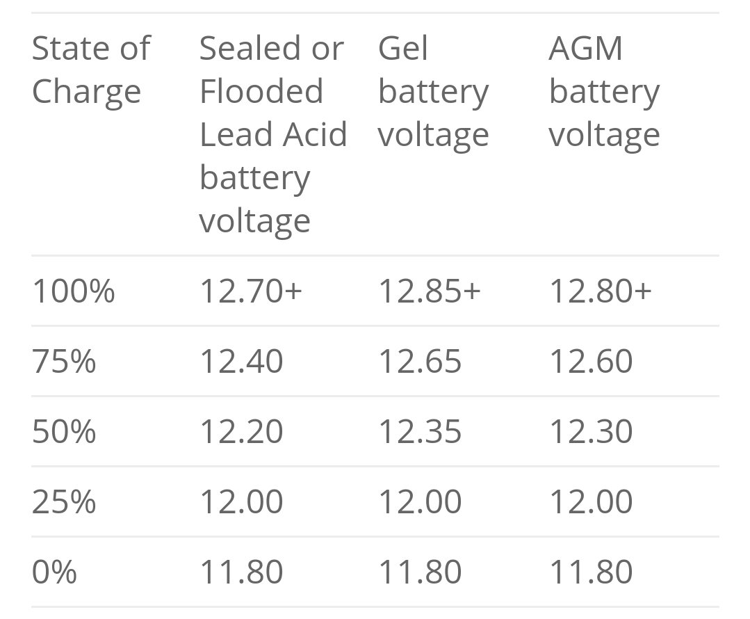

    You really shouldn’t discharge an AGM battery below 50% of its capacity. Determining state of charge based solely on voltage is a bit tricky and not all that accurate. At rest (hours of no load), at about 77°F, 11.8v is basically completely discharged. You can discharge it further and the voltage will continue to drop, but you’ve pretty much gotten all the power out by 11.8v. The tricky part is that the under load voltage can be much lower and the temperature affects the voltage measurement.

    Ok that makes sense. And would explain why the unit is entering protection mode at the point that it is. However, it flies in the face of the heavy advertising @Dometic is putting forth on the CFX3s that they are efficient enough to run off a single battery since last weekend camping it was dead by 5AM after arriving in camp after 4PM.

    Wow, that is much faster than I thought it would be. Would a typical lead acid be better than this though?
    This has really got me thinking that a dual battery system needs to be a lot higher on my list...

    Yea. That chart is slightly misleading:
    https://marinehowto.com/under-load-battery-voltage-vs-soc/
    The chart is probably referencing the voltage under 20-hour load.
    So I’m still basically right.
