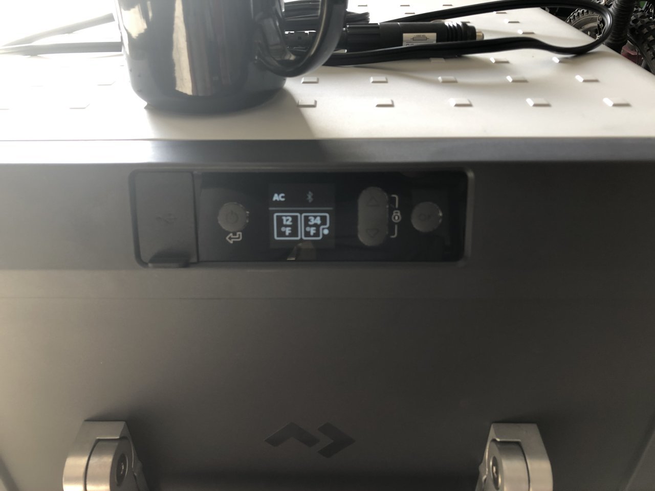

    savin yours
    savin yours Well-Known Member
    Sep 18, 2018
    #266644
    830
    Bryan
    SE Tx
    2018 TRD Off Road
    No, drinks on the fridge side and three large, previously frozen water bottles on the freezer side. Also, the fridge stays in the bed of my truck, but under the tonneau cover, no direct sunlight.

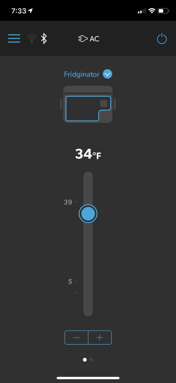

    That’s interesting. Mine has been plugged up to ac since it arrived and it’s been holding at 2 degrees on the freezer side and 37 on the fridge side since. I am swapping it to the truck today once I finish the slide. I know you said deep cycle but what’s the amp hours on the battery?

    This doesn't sound like its very efficient but I want to ask a couple of questions because I have been looking at this same model. I currently run a Whynter 45 - mostly as a fridge but on longer trips I run it as a freezer to support a cooler that I use as the fridge. I'm thinking of switching to this model because of the dual mode but I'm also suspicious of the current draw/efficiency of the Whynter and I'm hoping this will be better. Its pretty apparent there are some issues (like won't go below 9°F ?) but I just want to ask about the power some more.
    One word of caution: Some of the chargers are notoriously fickle so the batteries could certainly be salvageable. Try to boost them another way and see if the charger will take them after that. Or check the manual and see if you can adjust the minimal acceptable pre-charge level.
    - What was the ambient temperature outside and under the tonneau? My buddys tonneau makes an over of his bed and its been hot AF in Texas lately.
    - Did you bring the unit to desired temps (using the 120v or whatever) before hooking it to the batteries or was it starting from ambient each time?
    - You already confirmed you had stuff it it but it sounds like it maybe half full, correct? Were those items cooled before going onto battery power?
    - Can you confirm that on the second battery you did 12 hours first (and it dropped to 12.3v) and then went for another 12 hours (where your changer says is toast)? Not sure I read that right. If so, what is the voltage left at the end?
    - What size battery was used on the second test? Ah?
    - A post on the first page (#18) about the PLB40 gives some expected run times at 75°F for the 40Ah of that unit (https://www.tacomaworld.com/threads/the-dometic-cfx3-mega-thread.647777/#post-22592777). Based on you using both fridge and freezer temps you might land in the middle of the estimates - maybe 24-30 hours. If its hotter than 75 then it would be less.
    Thanks for any answers. Hope this gets resolved to your satisfaction.

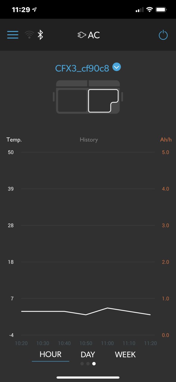

    Plugged into ac mine isn’t even drawing at 1 amp/hr

    see my post above about my current amperage draw on ac I will update with dc later this after noon

    On AC, the current is much lower (10x lower in fact). On 12v, the 75DZ pulls about 6 amps when it's running. But it usually averages about 1.75Ah/h (internal temp at about 32°F), meaning I'll get about 24hrs from a 40Ah PLB-40 (about the same from an 80Ah AGM battery).

    They don't show it while plugged in to AC power. Ah draw/usage is only shown while connected to DC :evil: (it should have been specified in the manual, but I haven't seen it. Maybe I missed it)

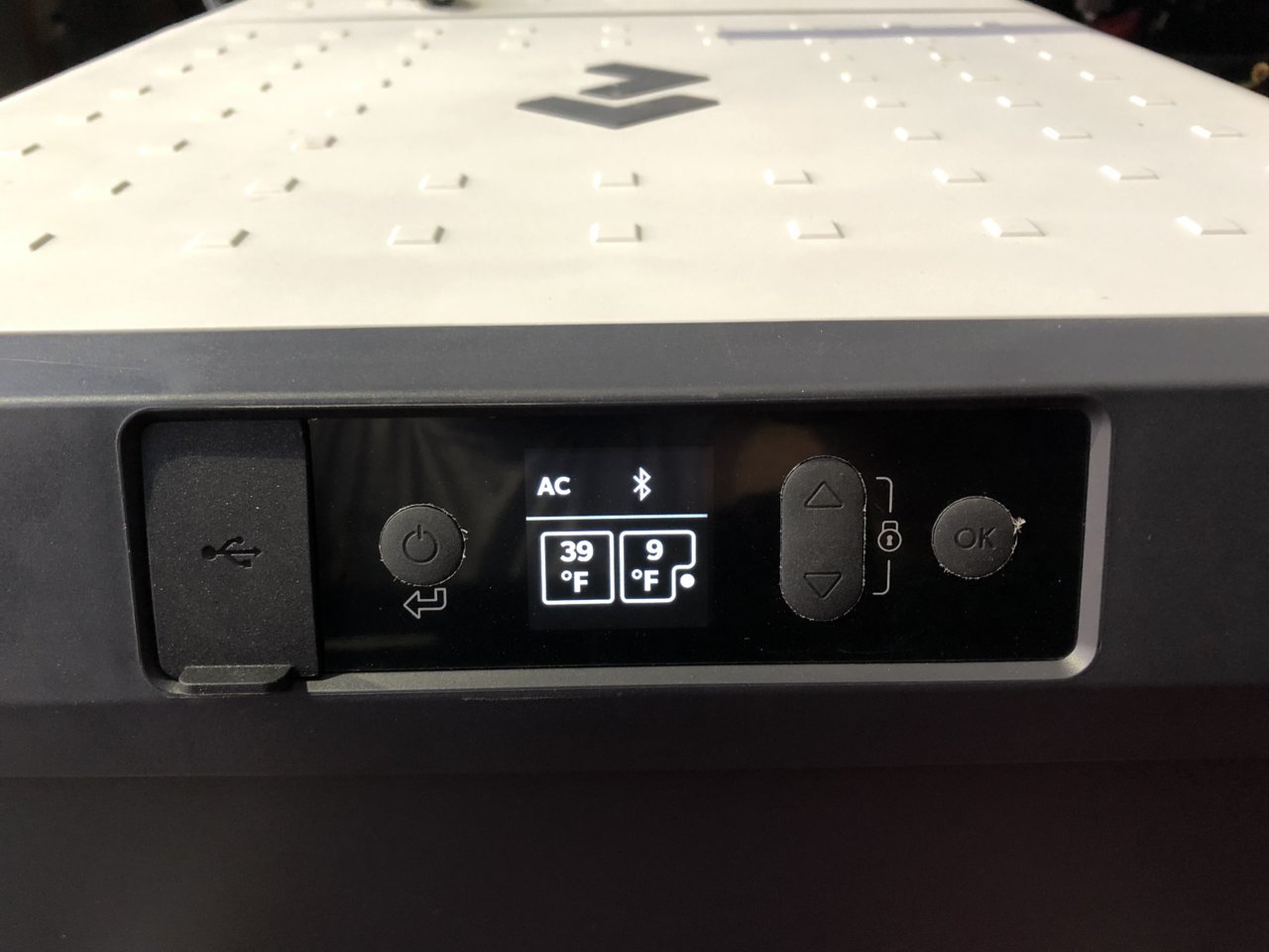

    The outside temps are awful, with very high humidity. In saying that, it was when I got home that I dropped the temp to 5(on AC power). After 12hrs, it dropped from 12 to 9....and that’s it. Parked inside my shop, in the open bed of my truck. Everything that I put in it was cold or frozen before. Infact, the first day I had it , at the voltage dropped to 12.2, the temp on the fridge side kept climbing...to 81!!!! Something is not right. The fridge was initially cooled on AC. The second battery went down to 12.3v in under 12hrs, then I got home, switched to AC power and put the battery on the charge. This is the 3 month old battery that I used on the second day. https://www.academy.com/shop/pdp/in...ne-cranking-amp-battery#repChildCatid=6570502

    That's an 80Ah battery so about as good as can be expected. I does sound like there are some issues with your fridge. I would get on phone with Dometic and see if they can help troubleshoot and if that fails swap it out for a replacement. It may help to just focus on one issue - like the nothing below 9° issue - for better customer service. Try to save that one battery too if you can. I have heard of charger issues with batteries that aren't really faulty, just too low for the default charge.
    I tested my Whynter-45G at 38°F on battery, but indoors at 72°F. I got around 15 hours before the battery cutoff kicked in at 11.3v (i think). I didn't check the pre-voltage but I think it was fully charged. In usage, I have had some issues sustaining overnight but there have been variables. Originally I only had a single 100w panel and when the weather was rainy it never really fully recharged during the day. Once the sun came out for full days then I was able to make it to morning sun again but just barely. This was running at 38° with ambient around 80° at mid day with the fridge about 2/3 full. I now run 2x100w panels and on a recent longer trip I ran the unit at 0°F with days from 60-80° and the unit from full to 2/3 full. We had two days of rain (wife was thrilled) and I had issues on the third morning. Everything stayed rock solid frozen but the battery cutoff kicked in at some point in the night and the display said it was 28° inside. Not sure where the sensor is located but it was still very deep frozen at the bottom.
    My auxiliary battery is only rated at 65 Ah (dual 25/35 setup) so I actually think its doing pretty good. I really want to go to a split unit as I like having a freezer for longer trips. Right now on long trips I'm running the 45G as a freezer, a RTIC-45 as a fridge (fed with ice-packs/frozen bottles from the freezer), and a RTIC-20 as veggie cooler. With the 75DZ I was hoping to get rid of the RTIC-45 since the freezer and RTIC are actually only about half full each with real contents - water bottles are used as space filler/ice packs. (I'm keeping the separate veggie cooler though - that's been a big improvement not having the veggies getting half frozen or abused every time I have to dig under them in the fridge cooler. Stuff was getting too bruised and mushy before.)
    Good luck with this.

    Well, the fridge was plugged into AC, inside my shop(on the floor) all night, and it only got down to 12(set at 0). Also, I replace my battery with the same replacement. Now I’ll call @Dometic.
