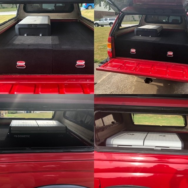

    Ok. Finished drawer system and installed my @Dometic wiring kit and hooked up the 95. No where near enough wire so I had to add more 10 gage wire. I used a 12 gage plug to connect it and to allow me to unplug and remove the drawer system As needed without cutting the wire. 12 gage is all we could find and Oreilly auto parts guy said it should be fine. Is it going to be ok or do I need to get a 10 gage plug? Thanks!

    12 gauge should be just fine. But definitely don’t go any smaller.

    @Natenite - like @Newlife mentioned, 12 gauge should be fine. In our hardwire kit, we use 10AWG but that is designed to run from your battery all the way back to the cooler. You should be good:thumbsup:

    Thanks for the info. The wiring in the packaged kit from you guys was too short so I had to buy and use more 10 gauge wire to reach. Not a ton but maybe 4 or 5 feet. The union is where I added the plug. The double plug device from the kit is nice though. Should be handy. You can see how I had to build around the fridge and that meant a good bit more cable as I have to go to the tail light area to get my wire into the bed of the truck.

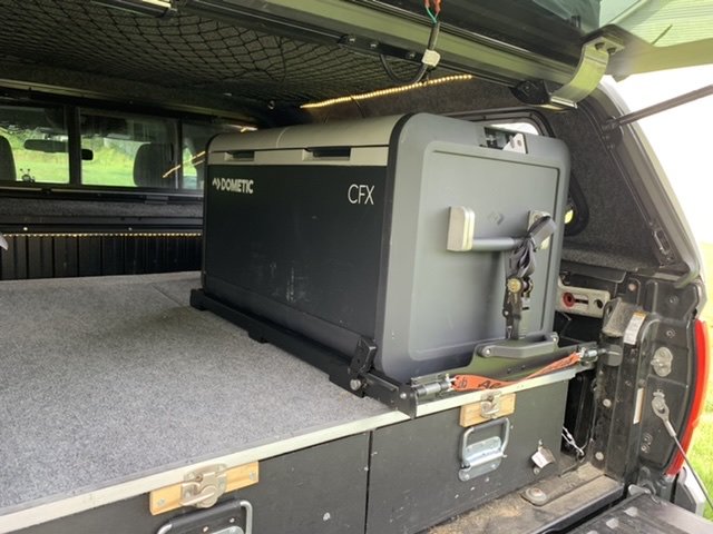

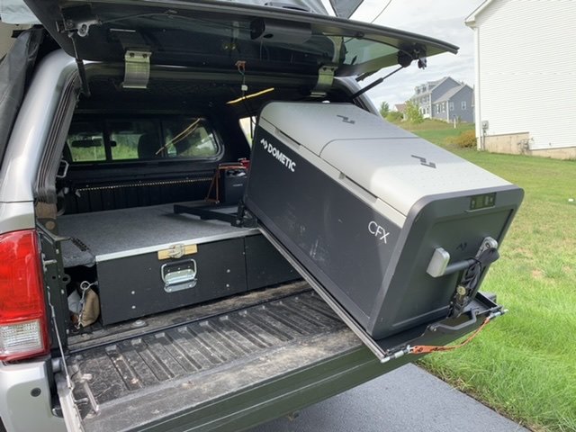

    Finally got my Alu-Cab slide in. Ordered it in the spring but Covid has delayed some of the supply chain. The first ship from South Africa docked on August 1 but my order was on the next ship. Was definitely worth the wait though. Without the tilting feature I’d have to stand on my tip toes to see inside. Also came up with a more permanent system to hold the PLB40 down.
