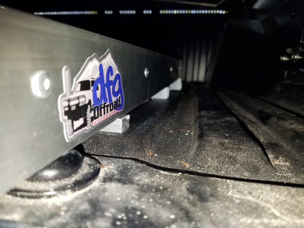

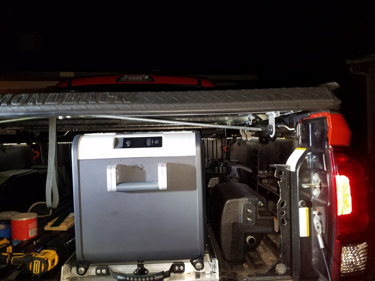

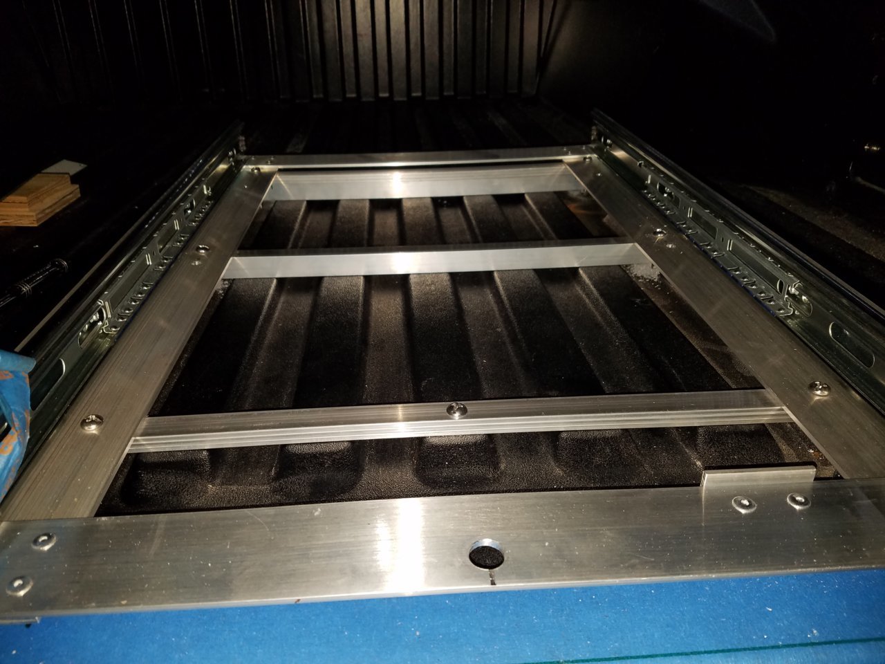

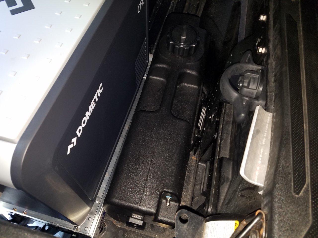

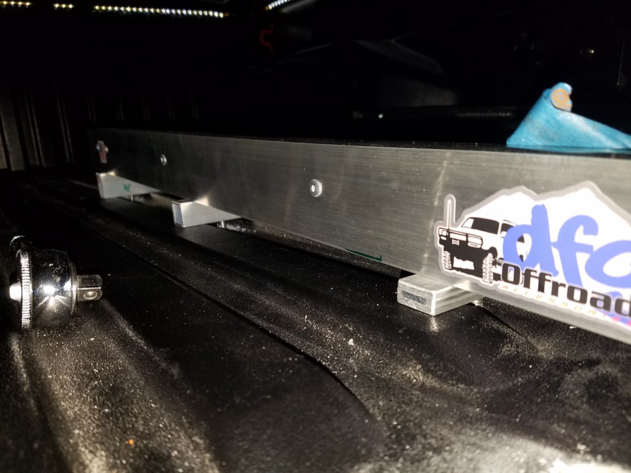

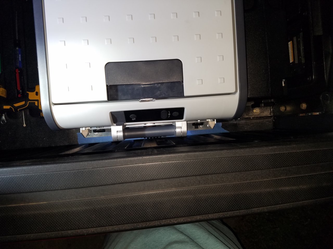

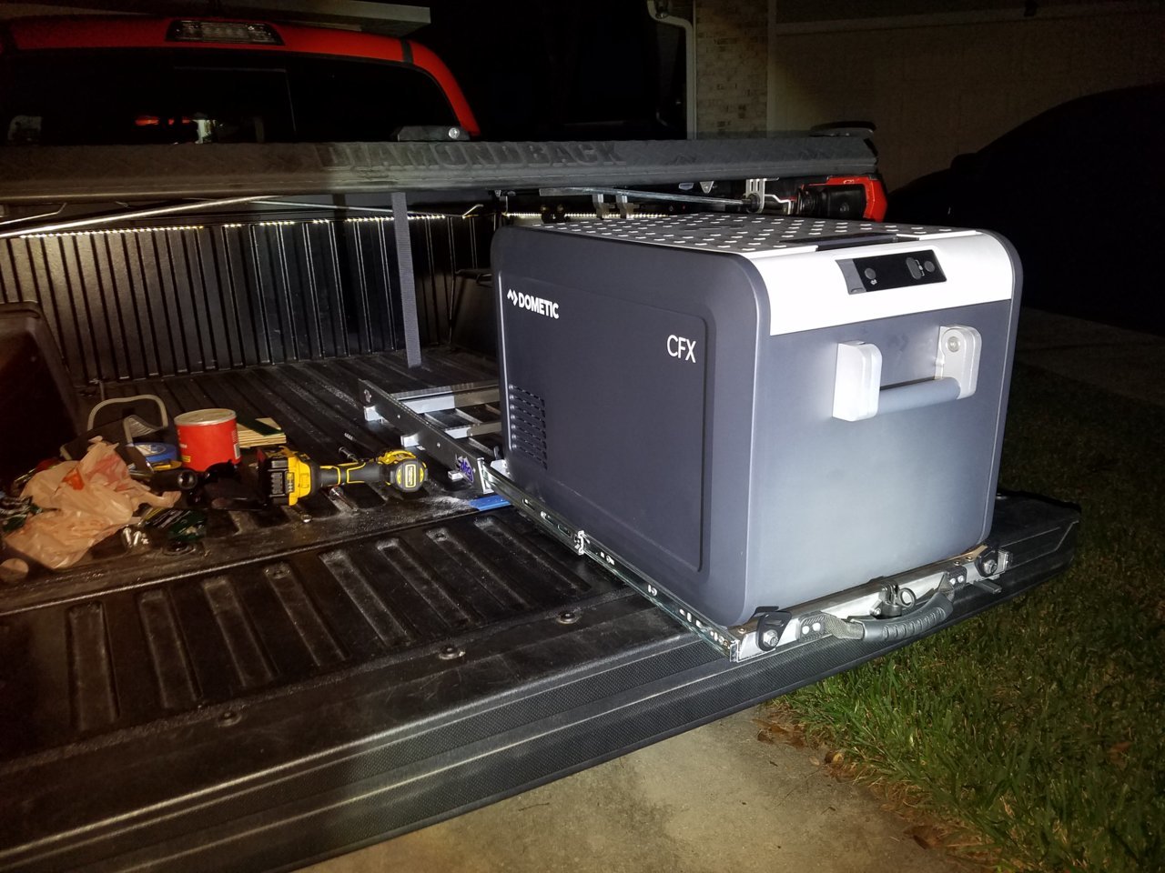

    I just installed my Dometic CFX3 35 under my Diamondback. I used a DFG Offroad slide that is made for the CFX3 35. Both the fridge and slide are well made. No complaints. I had to modify the slide slightly by moving two of the holes, but that was nothing and I almost think they shouldn't pre-drill them so that you can customize with your specific install/setup.
    I was limited by my WaterPort that I wanted up against the right side wall. This does block my power inputs and storage, but I'm probably going to move those in the future. I'm not a fan of the inverter and I also have a Bluetti AC200 Solar Generator on its way that will power the setup and any other needs. I try to keep everything DC as much as possible and I might run a 12V continuous to top off the Bluetti while driving/parked, but need to check on battery cut offs to protect the battery from over draining.
    I lifted it because of the bolt on the edge of the bed stiffener and I tilted it to increase how much the lid can open when the fridge is slid out.
    I used stainless hardware (1/4"x20 SS bolts, fender washers, and nylon nuts). I think I had to use 1 1/4", 1 1/2" , 2" and 2 1/2". Not sure about the 1 1/4". Varying lengths due to tilting. I used aluminum 3-1/8"x3/4"x36" which I cut down to 18" lengths. I also used 1-3/4"x3/4"x36" square aluminum, also cut to 18" lengths.
    The rear has one square tubing and three flat pieces. The middle had one square tubing. The front has 3 flat pieces. I used the front holes, but he middle was moved to 10 1/8" from the front holes and the rear was moved to 20 1/4" from the front holes.
    I moved it as far forward as I could and it doesn't touch the tailgate when fully extended. The planning for this took a second and I had to make two home depot runs.
    Hope this helps someone else looking to do this. I will be cutting my bed mat to fit around this and don't consider that to be a loss. The functionality this adds is huge. I still have plenty of room and large items like sheets of plywood have started to go on top of the Diamondback instead of under it.

    Have you considered just drilling and bolted through your bed mat?

    I did, but my WaterPort hangs low as well. It helps a little with clearance. In the end, I figured on the stability of direct mounting. I'll pay attention to vibration and might add rubber washers or such if needed.
