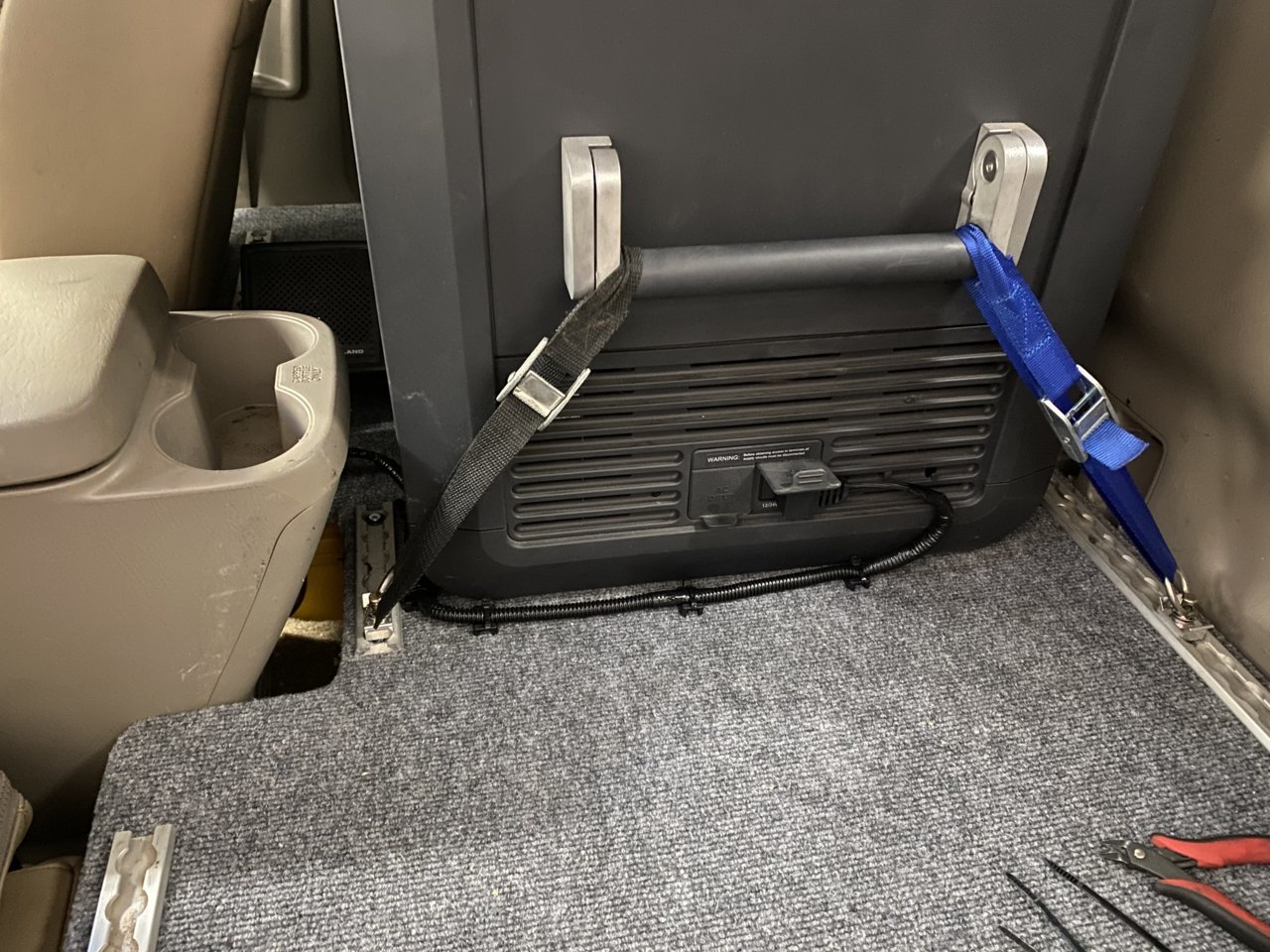

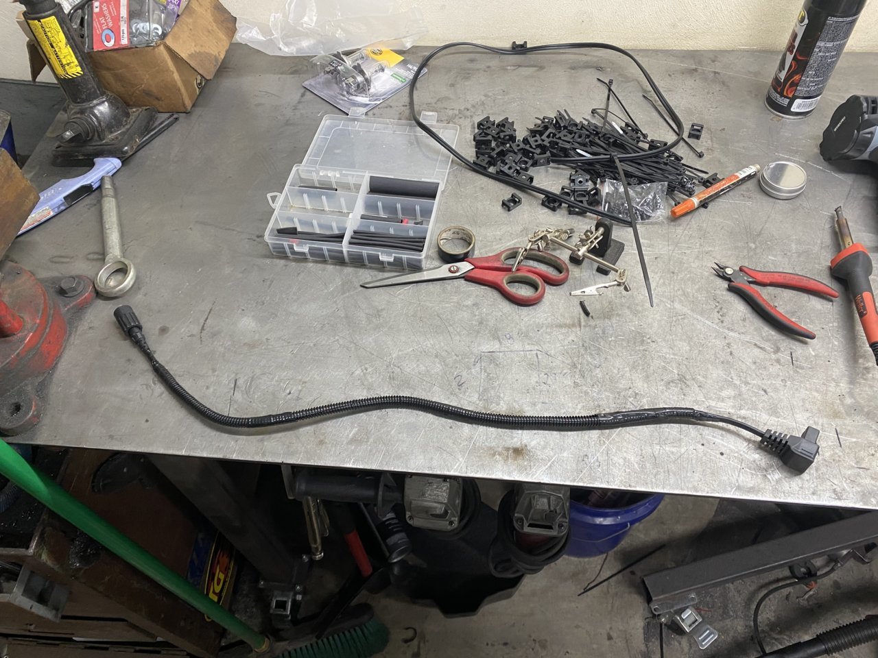

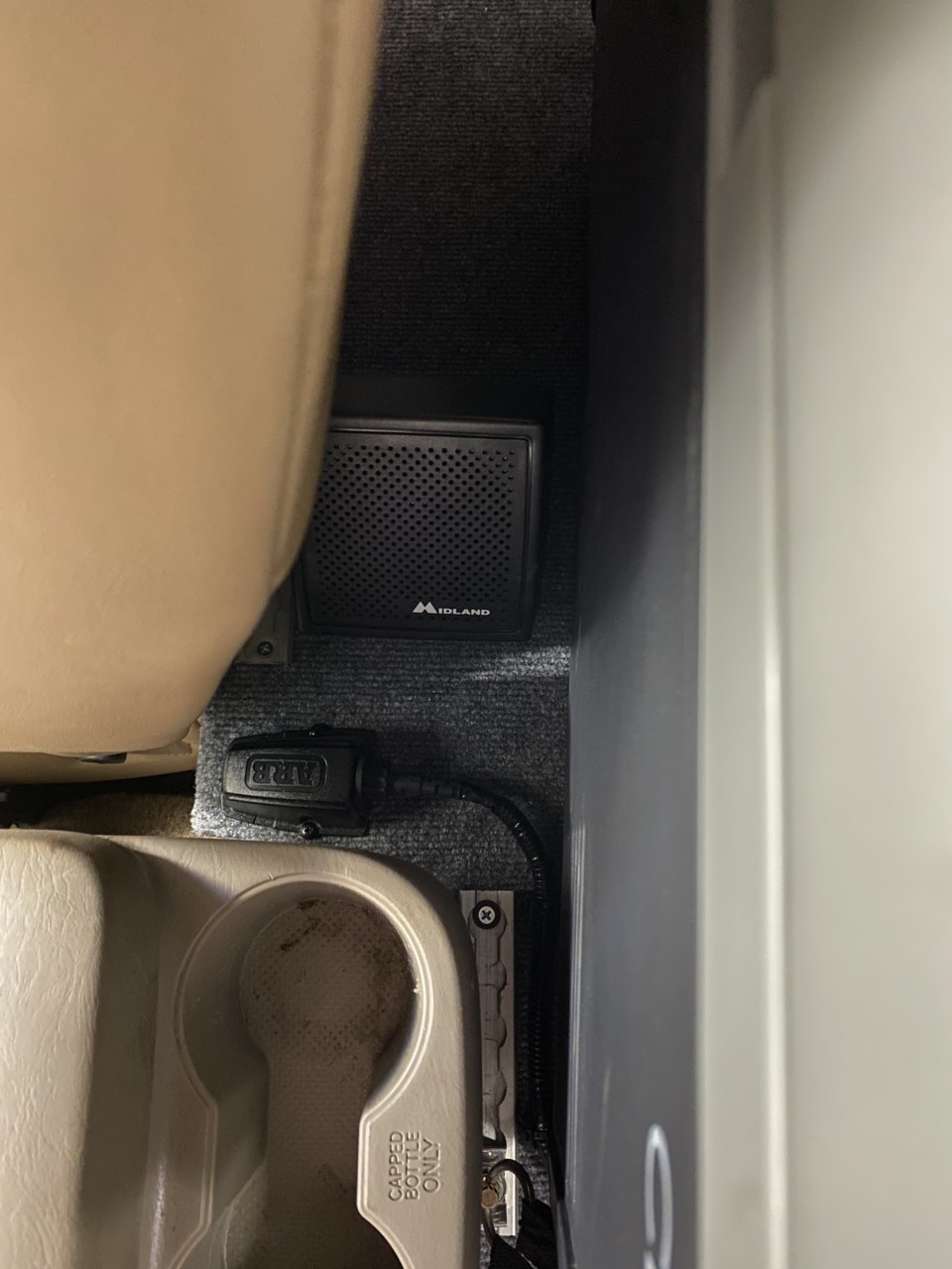

    For those following along, here’s a follow up so you can rest easy now. I went with the arb kit for ease of install and shortened my power cord. Used some cool wire organizers to secure it to the platform. No excess and nothing to get snagged.
