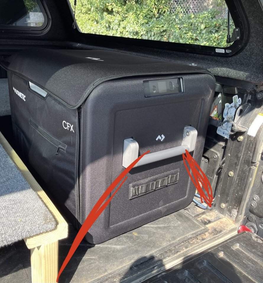

    Got my cfx55im today. Test fit it in my truck, around my modular diy platform system. Question for everybody - how crucial is it to strap it down really tight? I don’t plan on buying a slide (don’t want to bolt that to my bed, and I plan on using the cooler in multiple vehicles). The way I have it positioned, I plan on putting a cam strap around it to snug it up to the side of my bed. I’ll also have gear packed around it.
    Still curious what others thoughts are about having it strapped down really tight.
    pics -
    1407380E-4806-493E-A2F8-927AD11E2723.jpg 5341E637-12DD-4B16-BB47-D0697FC4F0E2.jpg

    Personally I have mine very secure. 4 straps, two on each handle. For yours, I would throw two cam straps here and see where that leaves it sturdiness wise.
    for the other side, maybe two D rings on the platform so you can put straps in a similar position.
    Edit: you mention packing gear around it. Make sure you leave adequate space for ventilation

    Good idea on the D-Rings. I’ll do just that.
    And ya, I’ll have stuff packed around it, but not around the compressor vents.

    you should at a minimum strap it down to the bed stiffener and possibly on the left side as well. you could use the C channel tie downs up front on the passanger side. I wrapped a 4x4 post cut at like 8" long to space the fridge away from that passanger side wall of the truck, the way you have it sitting currently the heat comes out and hits that wall bouncing it back into the unit. I flipped mine around so the screen was facing the cab, this way the heat comes out into the bed but the fan unit pulls air in the 4" gap against the bedside.
