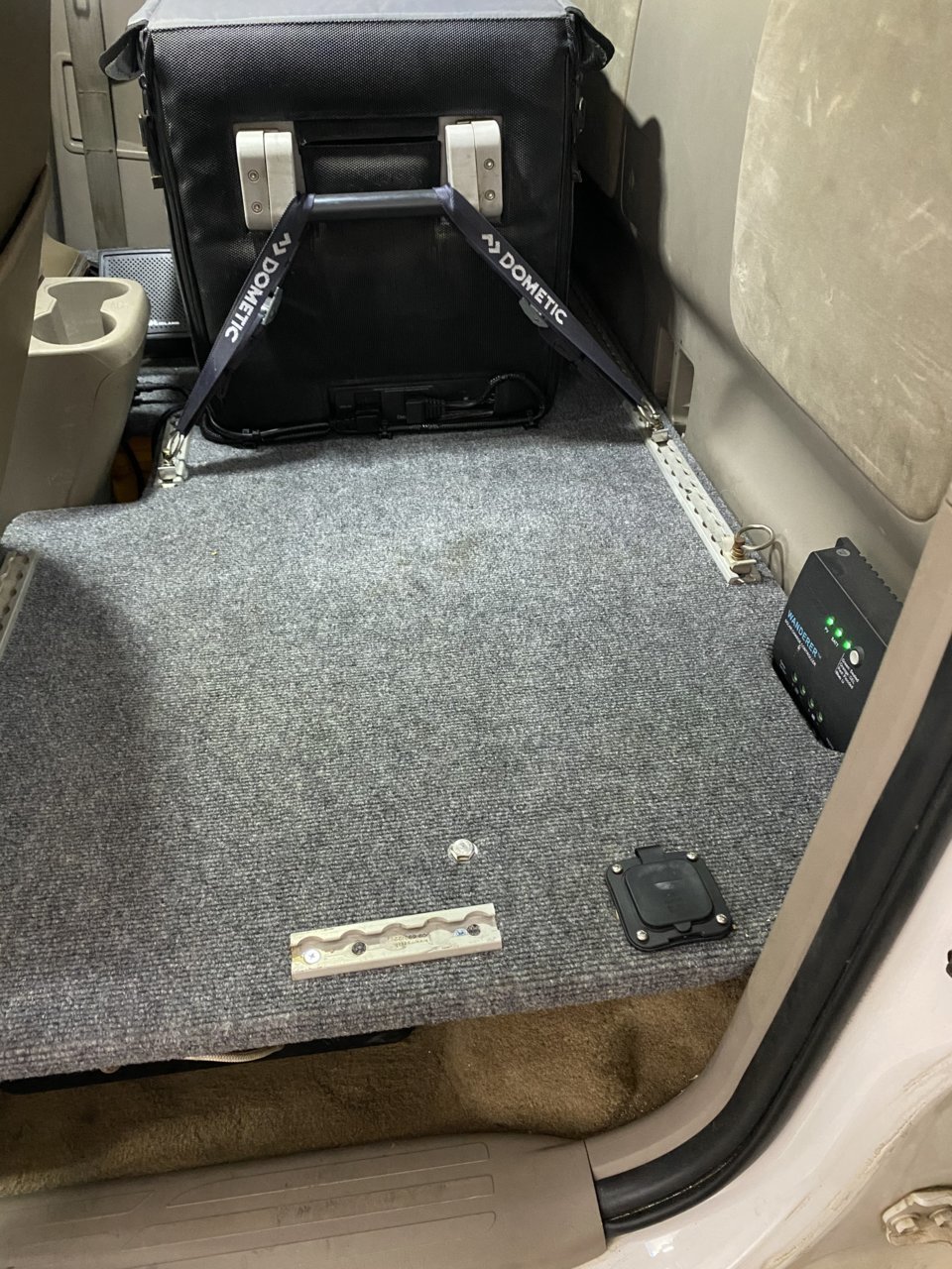

    I ended up shortening the DC power cord and wiring it into an ARB fridge plug since it’s a threaded socket. I also cut up the AC power cord and wired it to a bulkhead connector, pictured lower right of the second pic. Now when I’m trip prepping, I just plug the female end of the extension cord in and the fridge has AC power.

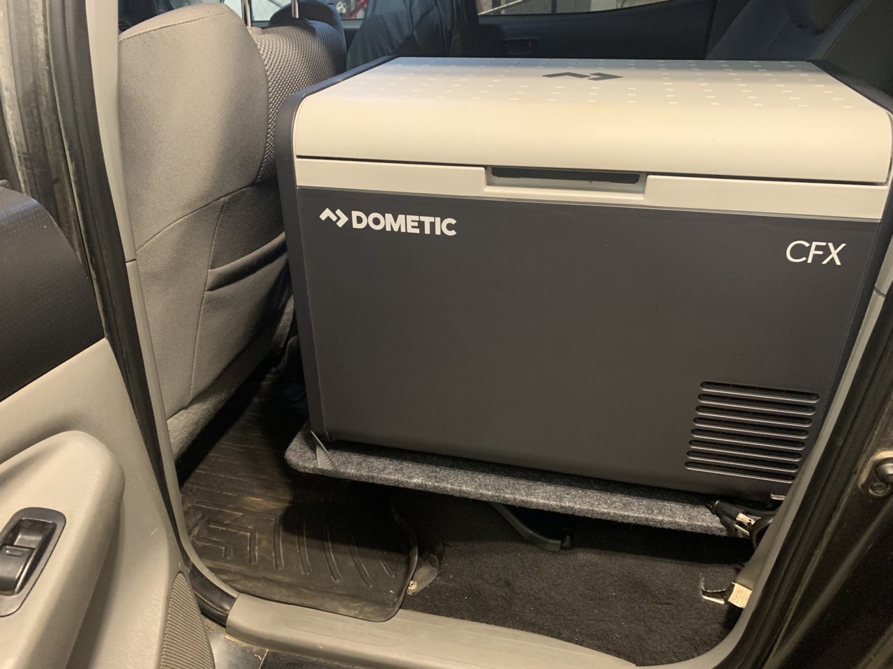

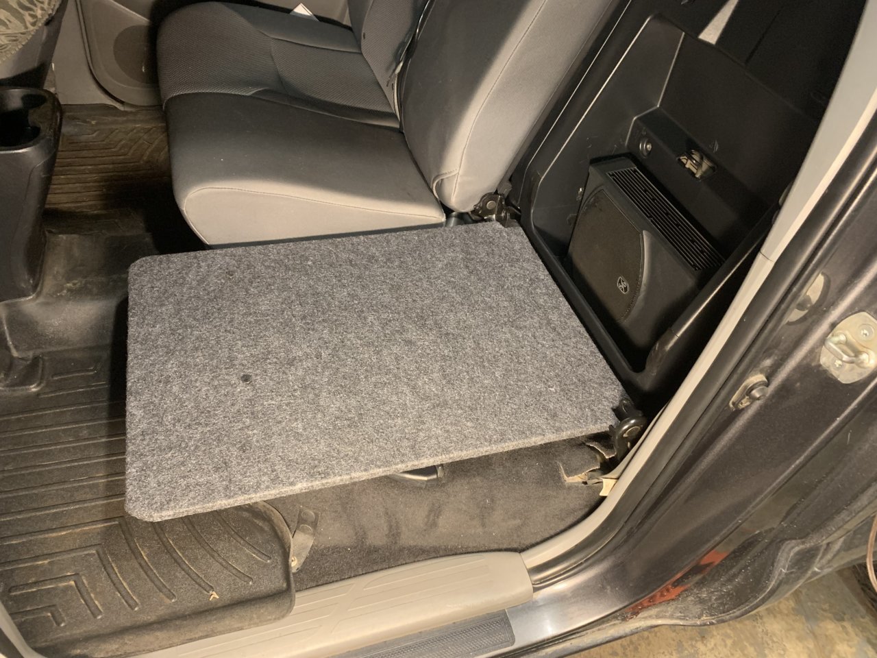

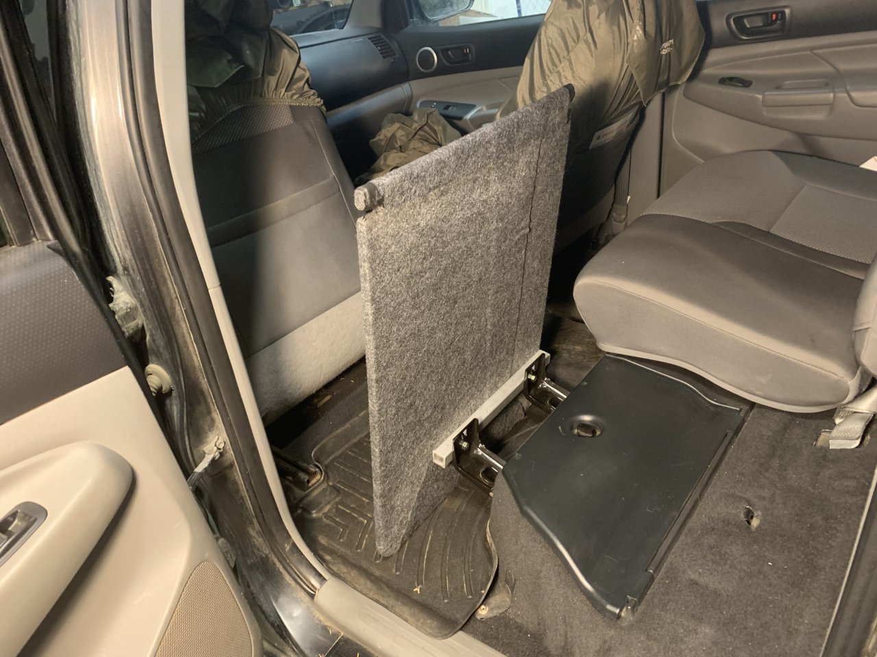

    I don't know if people have noticed this, but the hardware that the seat backrest bolts to is perfect for supporting a CFX3-55IM platform. By notching the platform, the stock hardware doesn't rotate out from under it. Also key is to use a 1" square piece of bar stock bolted to the bottom seat hinge. It sets the platform dead level. Incidentally, I slapped a few squares of mastic tape on the fridge where it would rub on the backrest hardware and it helps to keep it from sliding around. I used 1/2" plywood, but would opt for 3/4" if I did it again.
