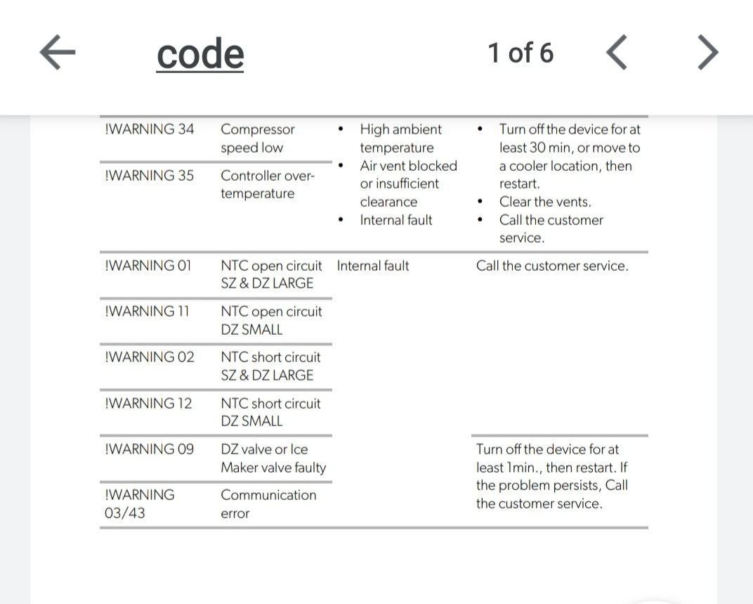

    Has anyone had a Warning 43 error on their 75DZ?

    No, but I googled ... Warning 43 error Dometic
    One result showed this.

    Thank you for checking. Yeah, that's what I found too. Not much info on it.
    I've reached out via their "contact us" in the website, but hopefully I can fix this myself. I'm not the original owner and don't have a reciept.

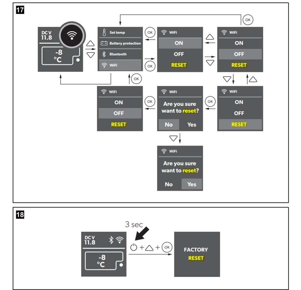

    So, it does not reset as the instructions suggest?
    Communication error. Bluetooth or wifi.
    Is there a factory reset on the display?
    Just guessing.

    I've tried the factory reset from the control, but it didn't seem to do anything. The error persisted.
    I am unable to connect via bluetooth or wifi.

    Not sure you got the same instructions.

    Yep, same as I saw.
    The display temp changed back to *C, so I'm guessing it "succeeded", but didn't fix the issue.
