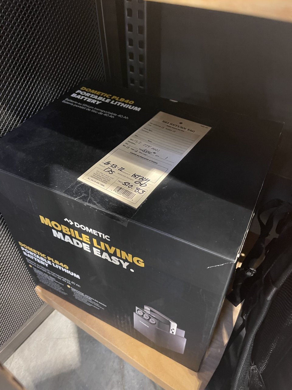

    Found a working cfx3 45 at rei today in the 'in store' 'what used to be' garage sale.

    Nice! How much?
    This is near me.
