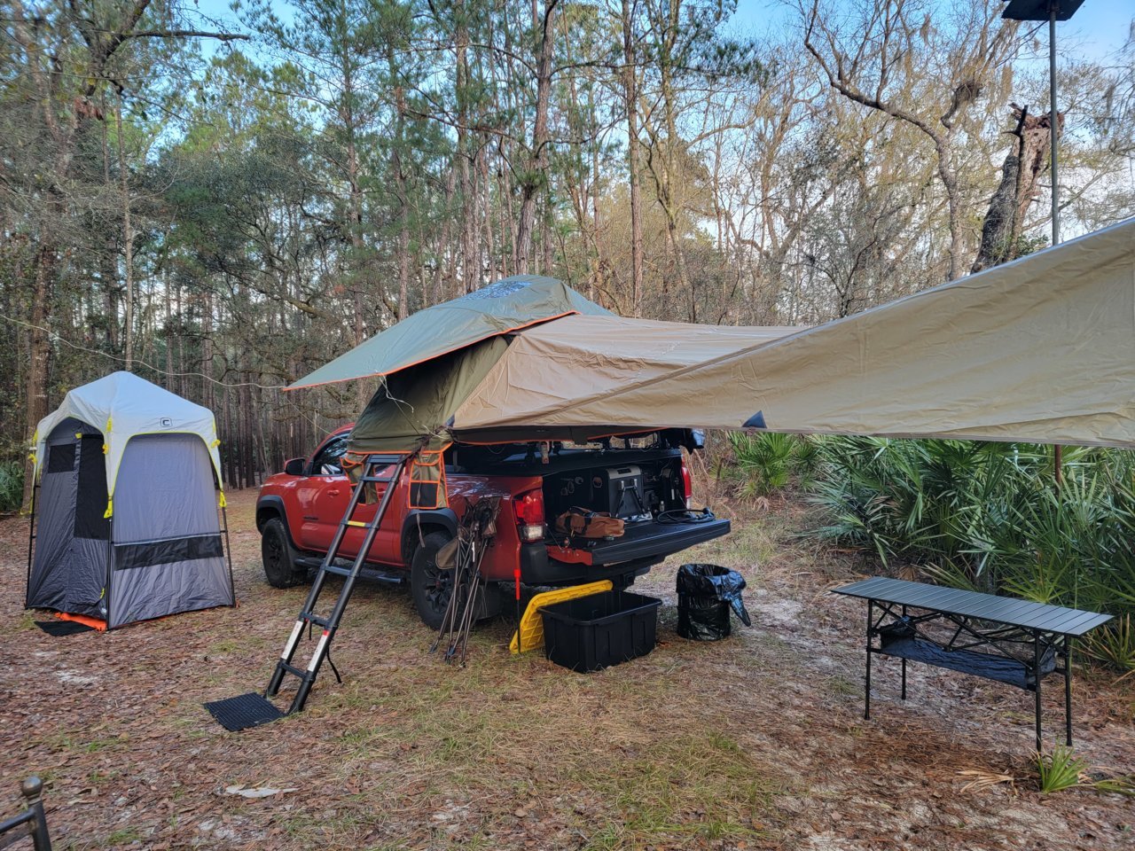

    So i was having some trouble with my Dometic 35 CFX3. It would Fault error code 33 for a failed compressor start. Unfortunately, it didn't seem to try again, or at least wouldn't work until I manually powered it off/on. This didn't work well when travelling longer distances and then finding out it had been turned off for possibly hours. I initially thought it was the Dometic's fault...however, testing proved otherwise.
    I run a couple different battery systems depending on how long of a trip or if I'm just running around town. I have 2 Jackery 300's that I use for really short day or overnight trips and I always keep one in the truck if I ever need to turn on the fridge or other small uses. I'll plug one in overnight and recharge at a hotel or friend's house and swap them as needed. They run the fridge for ~12 hours. I also have a Bluetti AC200P and B230 for longer trips. they are basically 2100 Wh each compared to 300 Wh of the Jackery 300s (7 times the battery).
    I really noticed the Dometic's Fault 33 on my longer trips when I was sleeping in my roof top tent. The whole truck would shake when the compressor tried to start and I'd wake and find the fault.It might start correctly 3-4 times, but would eventually fail and need a power off/on.
    Initially, I didn't see the pattern. Sometimes I still had the Bluetti system in my truck and would use it for the following week before I pulled it out. It would of course error. It did so randomly, but always with the Bluetti...and this recent 5-day/4-night trip while hooked up only to the Jackery, flawless performance. I never removed the Dometic from the Jackery and instead would turn on the Bluetti to charge the Jackery for a couple of hours when needed. I ran the Bluetti B230 down to ~25% while the Jackery remained full by the end of the trip.
    Suffice to say, Bluetti is likely dropping voltage right when the Dometic's compressor needs it. It isn't responding fast enough to the change in voltage. Also, I didn't realize how my wattage was lost while the AC200P was under no load. Basically, if it's on, it will use roughly 10% of the total battery (200+ Watts). That is ridiculous. I'll have to research and test my other battery systems accordingly.
    So, for those that have read this far, be mindful when using Bluetti Solar Generators with Dometic fridges (and likely other brands). Doing so will likely cause Fault 33 error codes on the Dometic Fridge.
