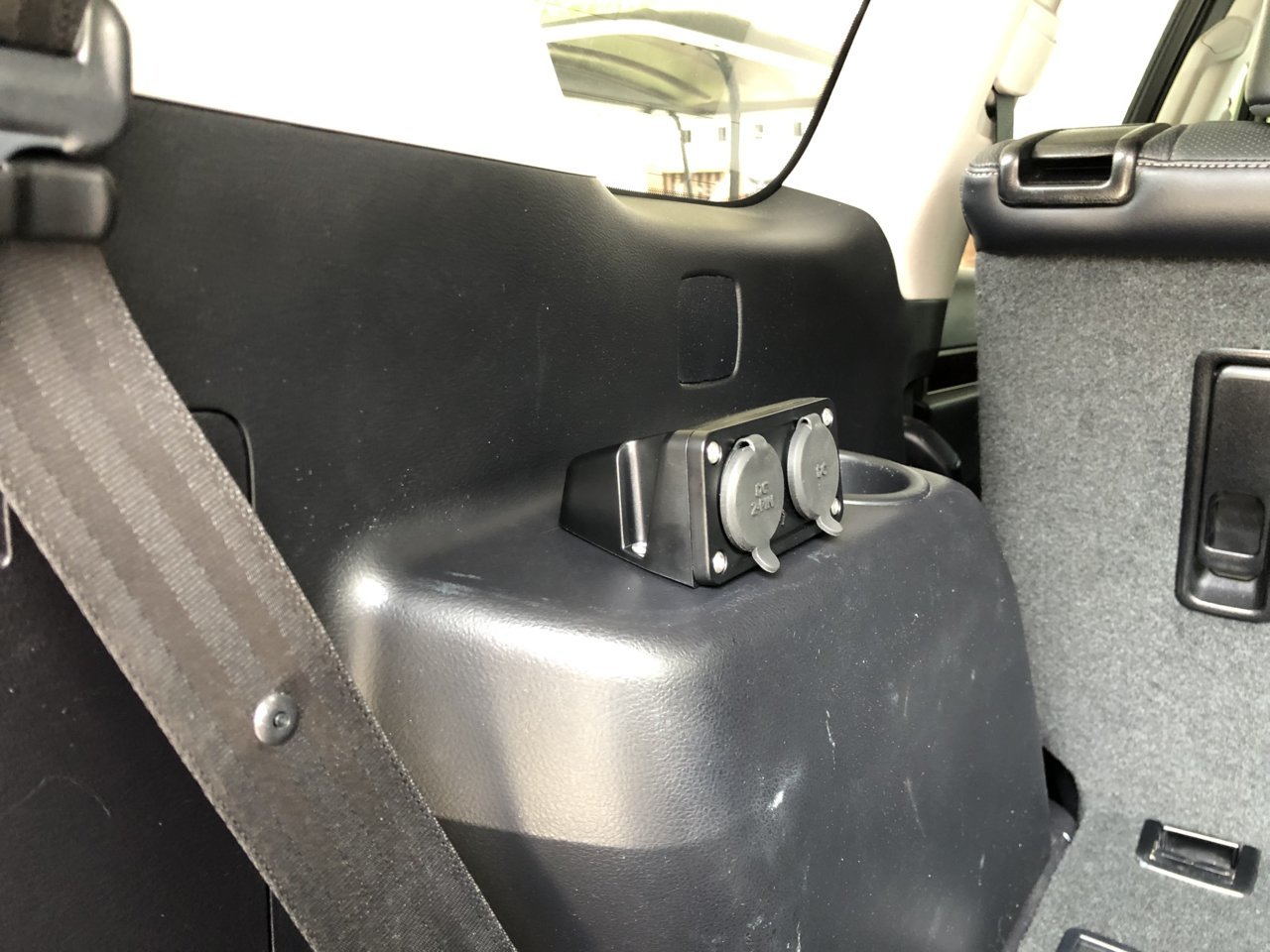

    Do you guys sell an extended power cable for the car charger? Trying to connect to cigarette lighter in front. Or can it be plugged into the power outlet in the rear of the gx460?

    Ideally, you'll want a hardwire kit that directly connects your battery to the cooler. Unfortunately, we've found that OEM wiring, especially in Toyota products, will have a significant voltage drop to power outlets throughout the vehicle. A direct wire solution is usually best, as these voltage drops will trip the cooler's battery protection circuitry with a false positive.

    @kingk0ng I’m using the Dometic power kit quoted in my GX460 and have it running directly to the battery. Easy install and the kit is really high quality and fused at both ends. Plus you get the threaded plug so you don’t have to worry about anything coming loose. It’s really the only option if you want constant power (or a similar modification).
