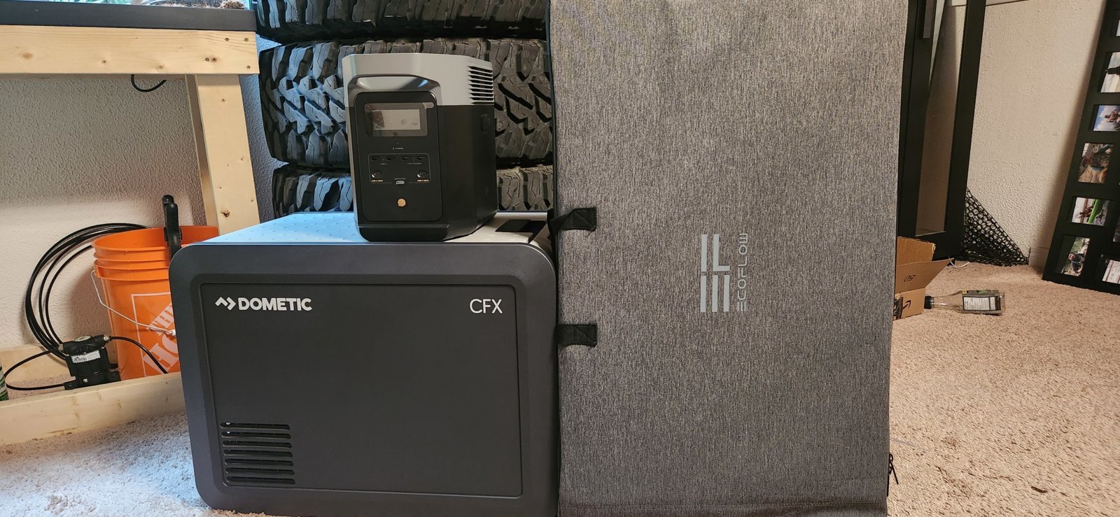

    It's official I'm going to be ice free this year. Scored a deal on a cfx3 45L and an ecoflo delta 2 with 220w solar panel.
    Curious to see how the run time will be.
