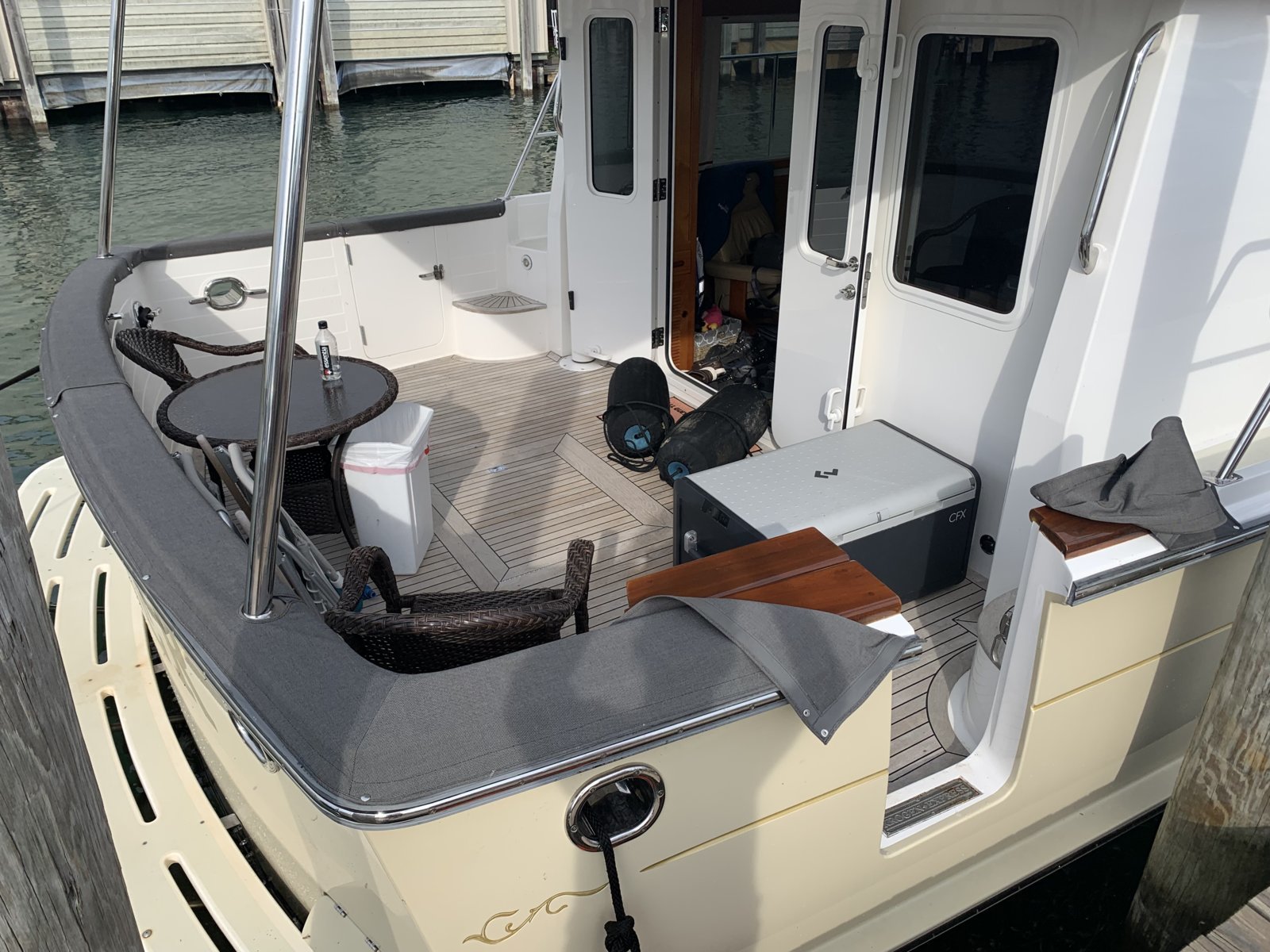

    This cfx100 has sat in the back of my buddies boat (that spot exactly) for the last 8 months. The boat has gone from Detroit, around the Great Lakes, down to Mobile,over to the Bahamas, up the east coast, through the Erie Canal and back to Detroit. Rain and salt spray. Ran perfect the entire time.

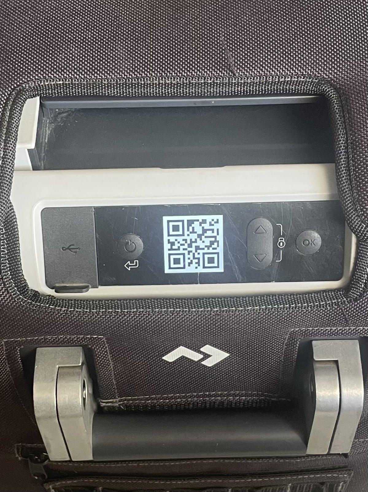

    3D5EB604-2BDB-4938-9943-BC7B17C86A52.jpg I have a dometic cfx335. This QR code is stuck on the control panel.
    Hard reset does not make it go away. My cooler is barely 1 year old with minimal use.
    Anyone else had this problem?

    Interesting

    18 Tacoma DCLB sport
    Have you tried scanning the qr code?

    2017 Tacoma Quicksand DCSB-MT TRD4x4
    Yes, it just goes to google search with its model number “dometic Cfx335.”

    What happened just before the scan code showed?

    I reseted the wifi and then the QR code pops
    Prior the QR code screen locked; all I did was resetting the wifi as stated on the manual.
    Its cooling no problem but stuck on freezer mode.

    Have you called Dometic?

    Also.

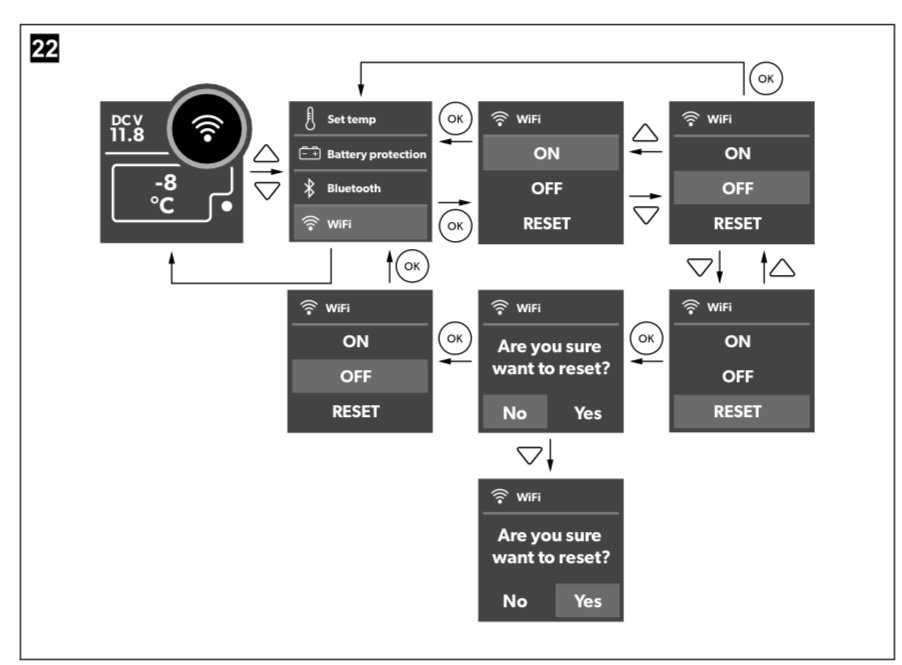

    I would make sure that I was using the factory reset sequence correctly.

    Yeah well can’t do a factory reset with a locked screen.
    Anyways I did contact them. They emailed me an instruction on how to clear it. Basically to download their dometic config app from the app store. Scan the QR code and get to the utility screen but unfortunately as soon as I scan the QR code it states “QR code” is in the wrong format. I also scanned the QR inside the cooler and states the same thing. So now I guess I have to go through the warranty claim process.

    Factory reset in the manual
    is a series of button pushes.

    Did you get the app?
