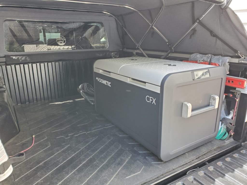

    For whatever reason I have a feeling a single group 34 battery might be a little bit too small to run a fridge and a freezer. What's the Ah rating of the battery?
    Now I'm not speaking from my experience, it's just something that I've read older units (I believe ARB fridges had similar issue).
    When compressor kicks in it draws more on start up vs when it just runs, and the battery voltage drops a little bit, and then battery protection would kick in and shut the fridge off. Maybe you're experiencing that issue?

    That’s entirely possible. The battery has 68 amp hours.

    OK. If you find some time try looking into AGM battery charging voltage requirements. From whatever looks like our third gen alternators they don't produce enough voltage to fully charge AGMs (I believe they need 14.1-14.7 V or so). Second gens have a device that tricks the alternator into producing higher voltage. Unfortunately it does not work on 3rd gens. What I'm getting at, in perfect conditions you would have about 30 usable amp hours from your battery. But if your battery is under charged to begin with, you wouldn't even have that, plus the battery is not operating at 100%, so...
    So if that's the case, you might actually have to look into dual battery setup with DC DC charger. Although it seems kind of silly to drop that kind of coin just to operate a fridge, but unfortunately it might be an answer.

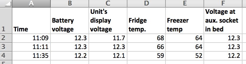

    Called Dometic and spoke to a super helpful tech on the phone. He is having me run the fridge inside the truck off the stock 12v outlet, leaving the ignition on accessory to keep power to that outlet. Doing this to rule out the 12v socket I installed in the bed. I am keeping data of the voltage and temps and going to note where it cuts out. If it is still cutting out at or around 12v then it is likely an issue inside the unit. If it goes all the way to 11.2v then we know it is an issue with the power outlet I ran.

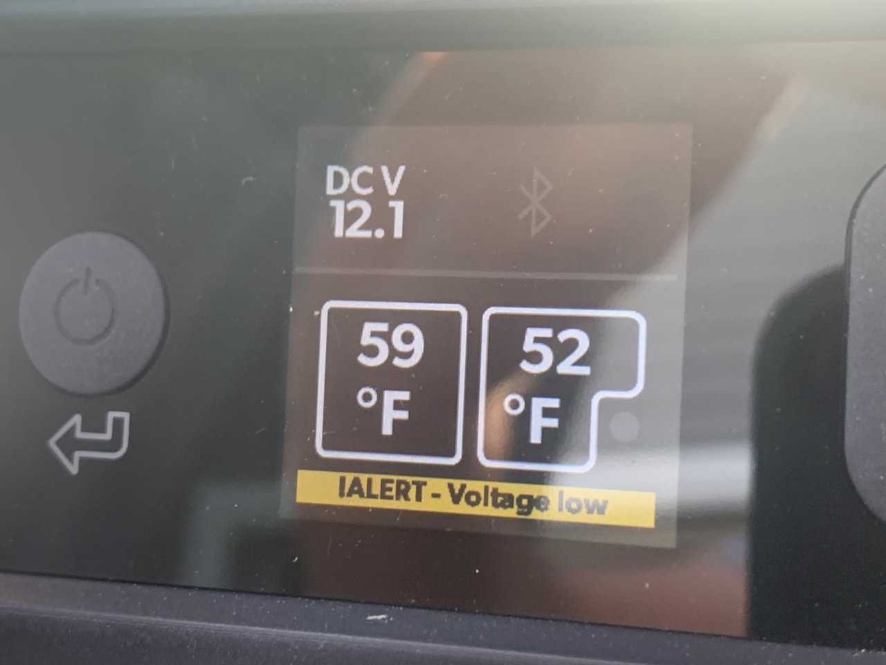

    No luck. That didn't take long. I set the larger portion to 37* and the smaller to 0*. The unit cut out after 26 minutes and was reading low voltage at 12.2v. On hold with @Dometic now. See my data below:
    Edit: Oh and I also turned the voltage protection to low, had the unit startup, waited a minute, then switched it back to medium and the unit shut off. I did this to rule out the startup voltage the unit pulls when first running.
