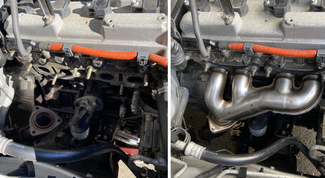

    So my exhaust manifold cracked on my 2.7L 4x4 3RZ FE engine. I certainly know this is a common thing that occurs on these engines. Have any of you all had to replace yours? I am wanting to know if there are any good aftermarket companies you have used for this part with good success. Thanks for any information!

    I think the updated OEM part is made thicker to resolve the issue. You can also use the newer-style manifold from the 01+ Tacomas, or an aftermarket header.

    I really liked my LC Engineering long tube.

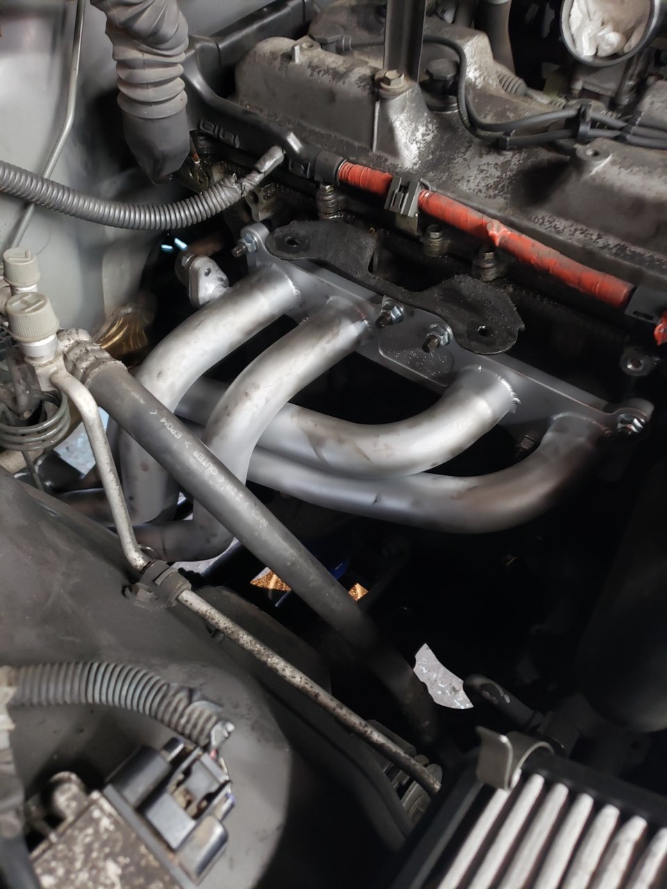

    Toytec coil-overs, SPC upper, OME CS019 leafs w/ 5110 bilstein, LCE header
    What I did w/ my fractured manifold

    Lots of options......
    all the way from another cast iron sand mold one for about $59....everywhere .....parts geek...ect..
    and then the steel/stainless steel ones start at $100......upto $400....
    I have heard some fitment issues with the long tube one from LCE....
    so I would be careful buying a 'long tube'......do some research.....
    message who ever you buy from to make sure it fits......
