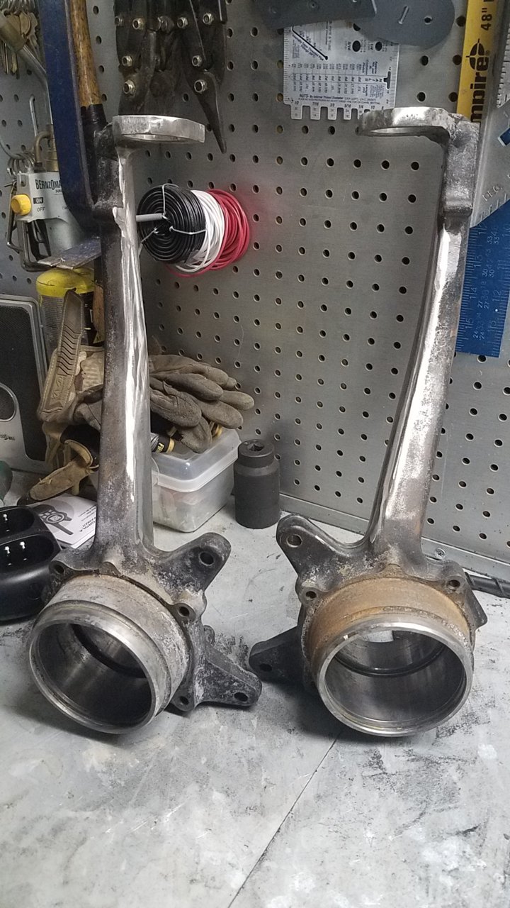

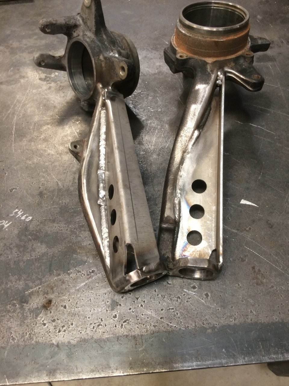

    Ordered a set of Total Chaos gussets. Figured since I have a spare set of spindles laying around for the conversion, now would be a good time to strip down the spindles and have them welded.
    @foxrcing07 helped me with his press getting the bearings out, I planned on replacing the wheel bearings anyway. We also pressed out the upper ball joint seeing as I wont need the OEM UBJ in the spindle because my SPC upper control arms re-locate the ball joint to the control arm.

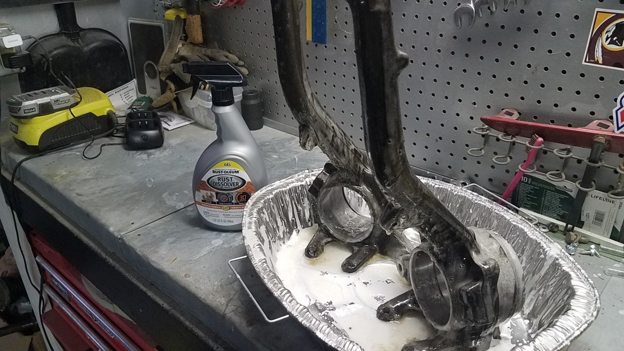

    Used the Rustoleum gel rust remover (that stuff works pretty good) and ground down most of the areas where the gussets would contact the spindles, to clean them up as best I could.

    @Radarninja was kind enough to lend his welding skills to my project. And I very much appreciate it. I think the gussets came out top notch! :thumbsup:
    I'll blast these things with some more rust remover and spray them down with Por15 recommended by @BartMaster1234

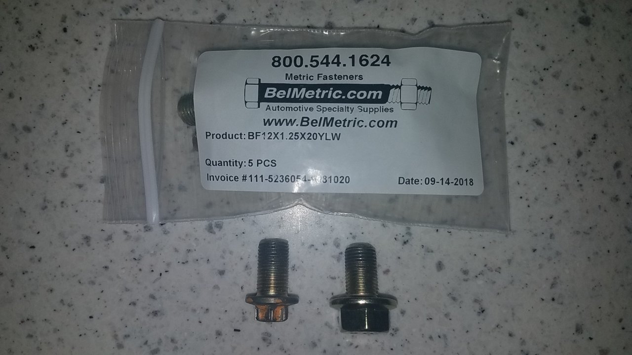

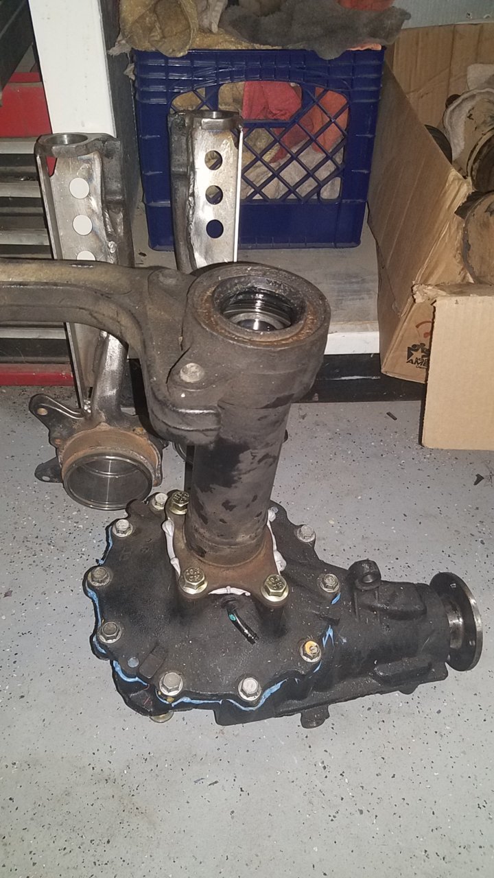

    So, I've been pretty busy with a lot of other things lately. Haven't been able to keep this thread up to date... and haven't really done a whole lot with the swap.
    I did get a chance to replace the ADD jack shaft with a manual. I was missing one of the, short, original star bolts that attach the shaft to the diff... and 2 of the bolts on the ADD shaft are too long to use on yhe manual shaft. So, I found replacement bolt on Amazon... they worked like a Champ!

    You should use the mounting arm I gave you instead of that crusty one on the manual tube, I sandblasted it down to bare metal and painted it with POR15.

    I will. That one was just still on the shaft. I just haven't been motivated to take it off and put the other one on yet... lol
