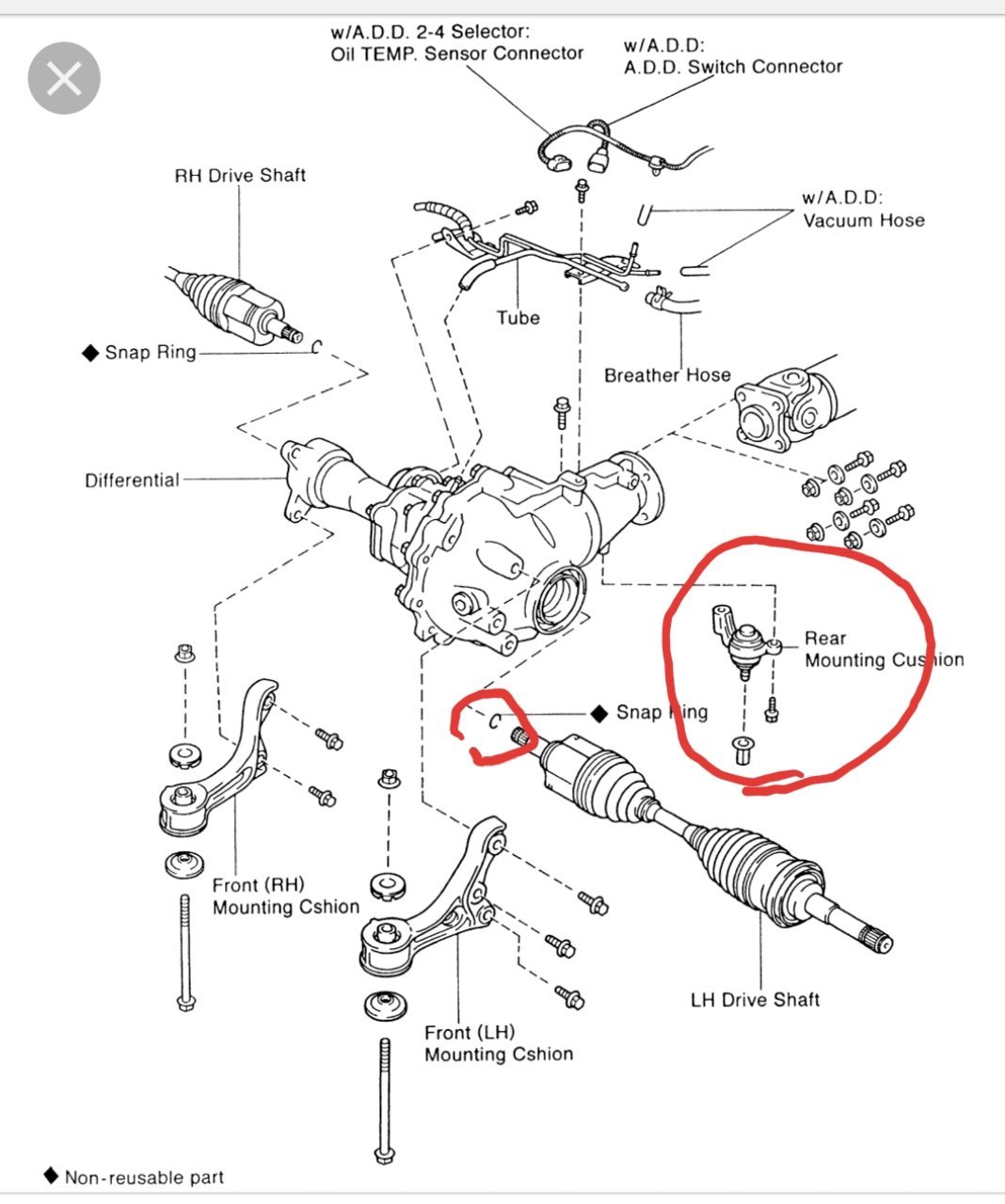

    So... I requested a price/availability, for some parts, from @gunny1005 a week ago... No answer. (not the first time btw)... So I bit the bullet and went to Modesto (local) Toyota.
    Ordered:
    CV snap rings
    CV end bolts
    Both diff/cv seals
    Fill plug
    Fill plug crush gasket
    Drain plug
    Drain plug crush gasket
    Should be here on Tuesday or Wednesday.
    Forgot about the rear diff mounting cushion (circled in pic below). I'll see if they can get it ordered for me, when I pick up the parts I ordered today.
