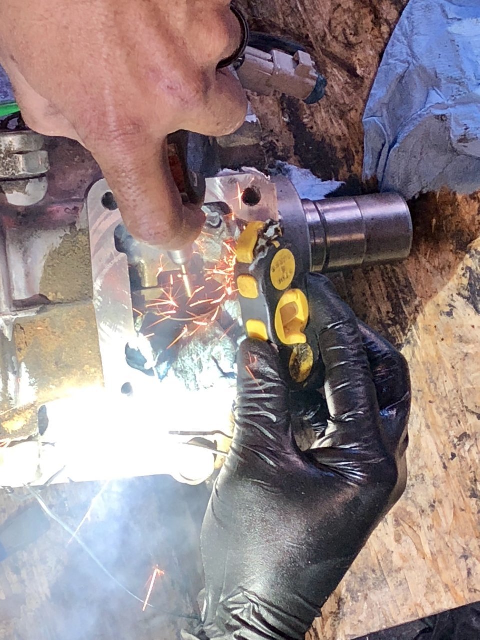

    Well, here's a pic of what it looked like to cut the ear off the shift rail in the T-case. This was a bit of a pucker moment.
