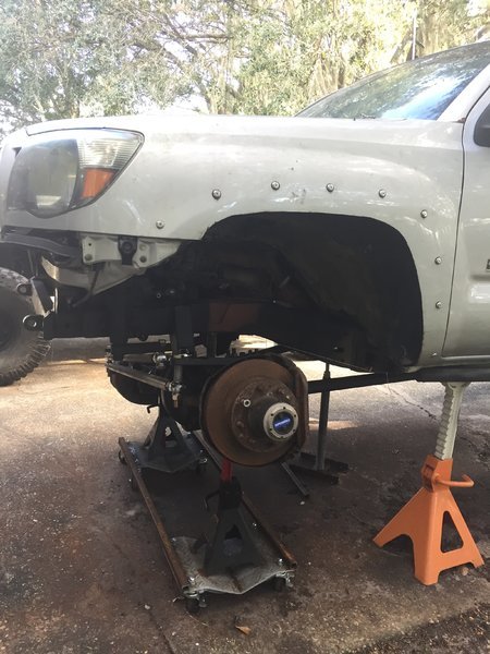

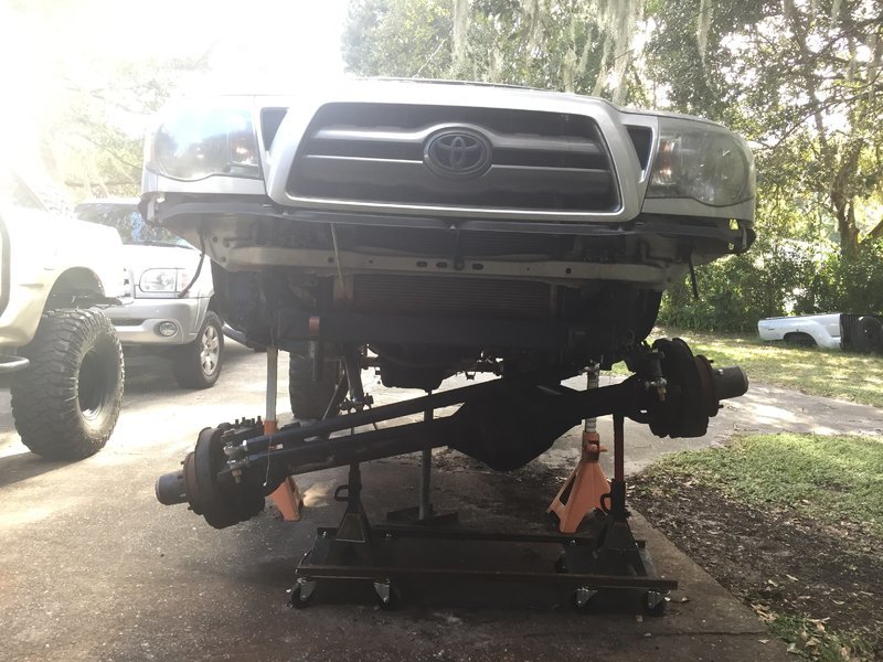

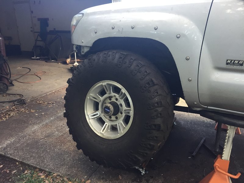

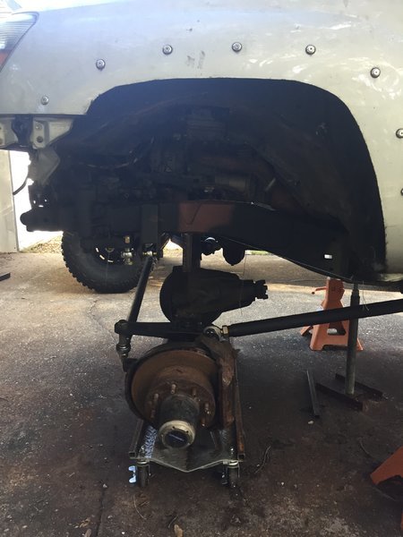

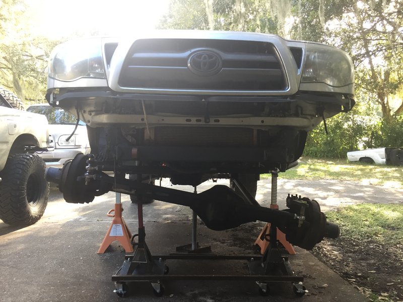

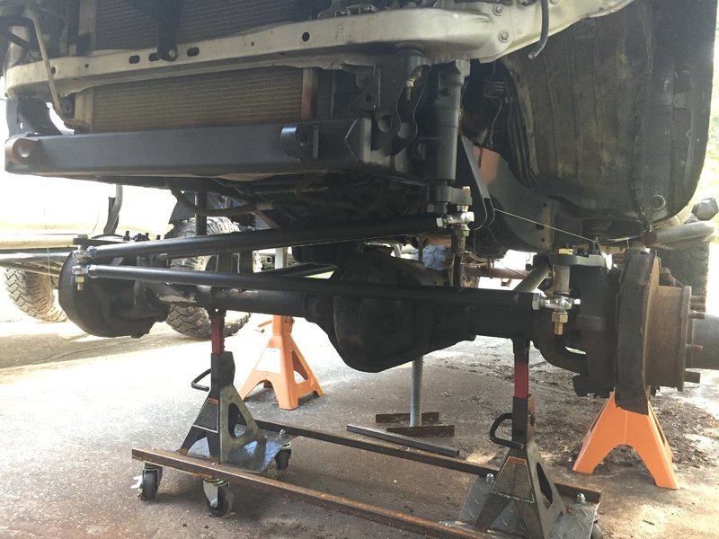

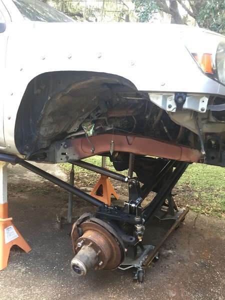

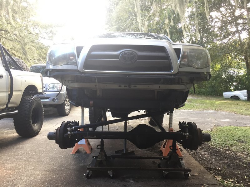

    Axle end panhard bar mocked up and suspension flexed....
    Photo Oct 30, 4 00 16 PM.jpg Photo Oct 30, 4 00 30 PM.jpg Photo Oct 30, 4 00 44 PM.jpg Photo Oct 30, 4 02 18 PM.jpg Photo Oct 30, 4 02 28 PM.jpg Photo Oct 30, 4 04 34 PM.jpg Photo Oct 30, 4 09 25 PM.jpg Photo Oct 30, 4 09 36 PM.jpg Photo Oct 30, 4 09 45 PM.jpg

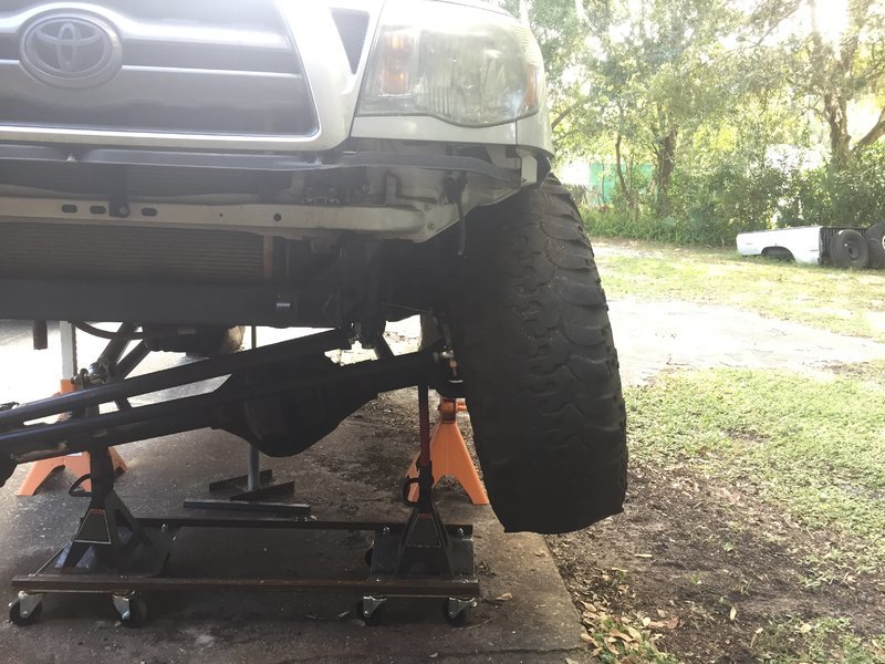

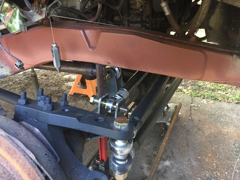

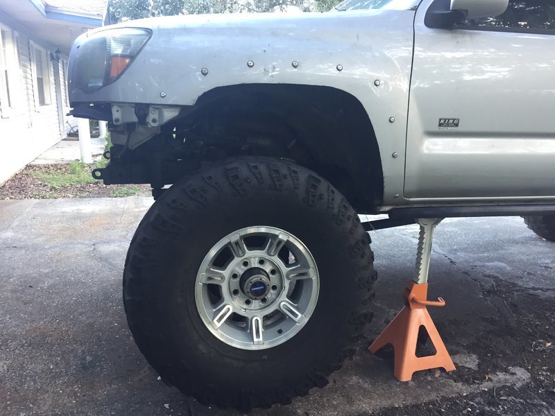

    And this is somewhat around what ride height will be. This is giving it 4" of uptravel and will be around 24" of frame height on 40s

    Awesome!
    Damn, mine was like 27" height when put on its own weight for the first time (which was not bad at all actually). Have a couple of more inches to go down as the rear springs and we play with the coilovers.
    Bet you cursed a lot when moving that axle up/down :D Man, my D60 was like 550lbs! what a royal PITA to move that big pig of an axle around.

    yea the axle is a real pain in the ass to move around and flex out. I just had to muscle it up and down while trying to raise and lower the jackstand at the same time... fun stuff.
    It amazes me how some of these guys can get their frame heights so low. My truck is around 23" to the frame on 35's when others with the same size tires are even lower than that. It's just all in how much time you want to spend changing things a million times to get the most clearance with the front suspension parts haha
