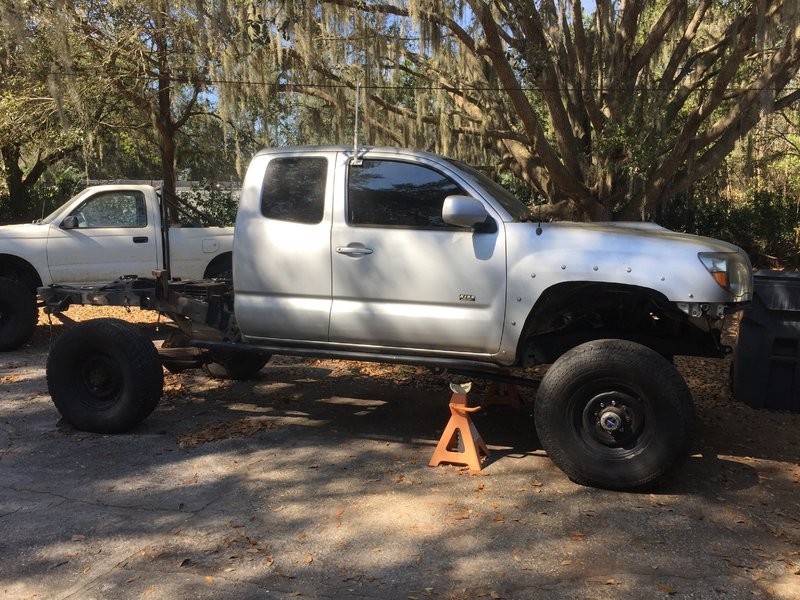

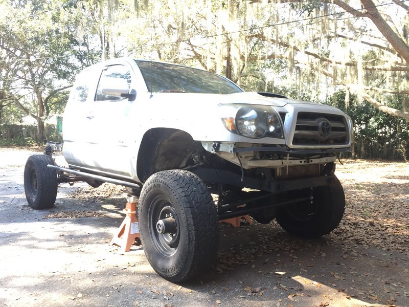

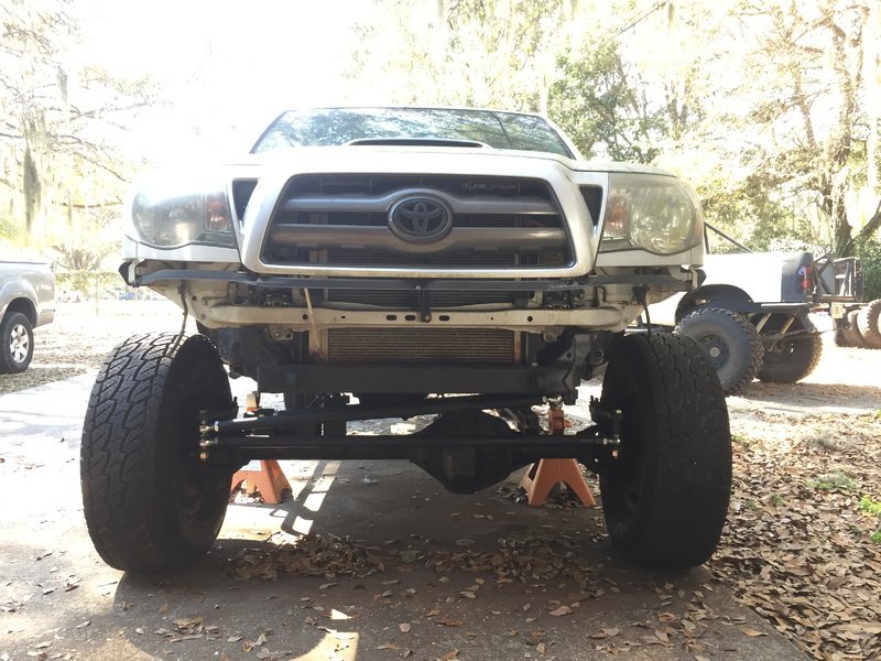

    Put some roll arounds on it and took it off the jack stands. At ride height on these 33s, the frame height is 22 3/8" with 4" of up travel. The rear of the truck will come down some when I mount those 63s correctly and remove some leafs.
