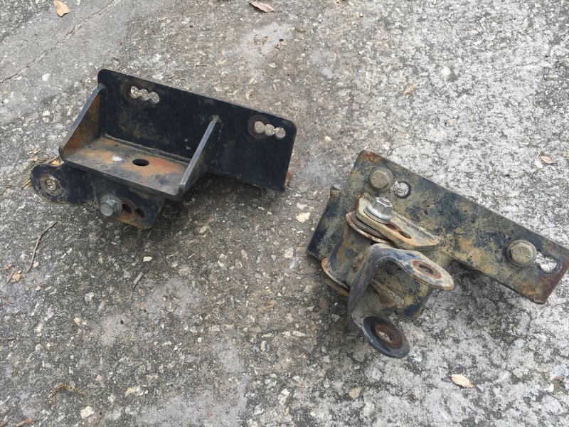

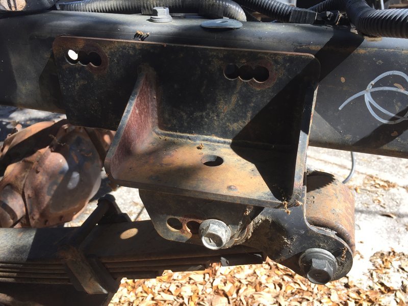

    Small update is better than no update I guess. Got the ATO shackle flip kit pulled off to be sent to its new owner. No more ghetto spring/shackle setup!

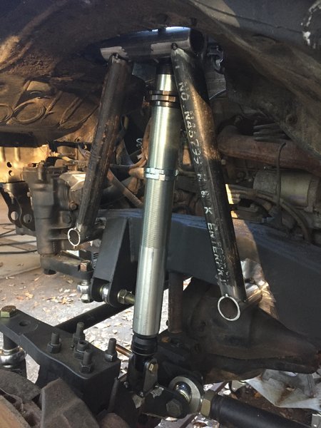

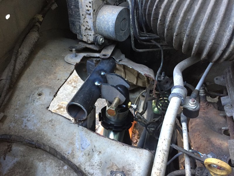

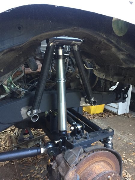

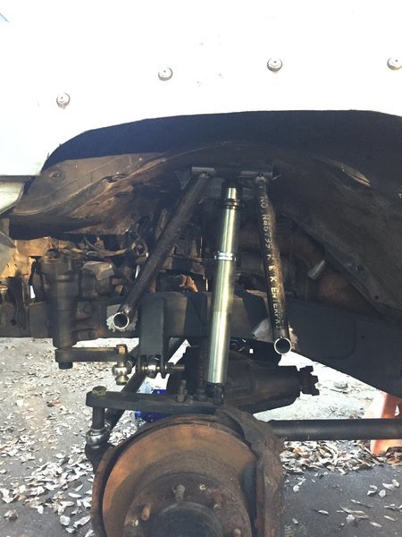

    Hoops are tacked up and on. I already know I need to drop the lower mounts about 3/4" to get closer to ideal full compression. I'll be checking clearance for the next couple of days.
