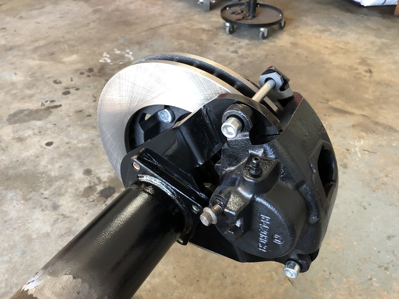

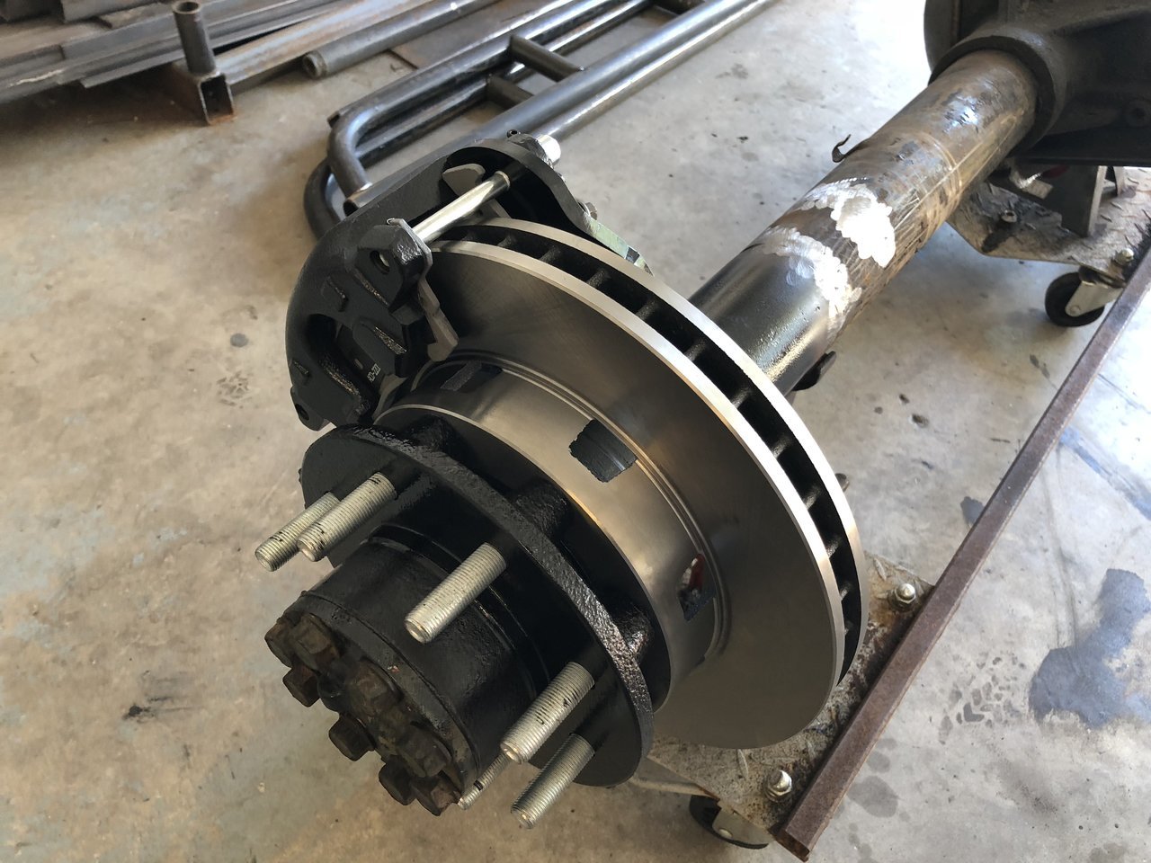

    Disk brakes done....
    AD921C8E-A22D-40B2-9F51-57F82290EE9F.jpg 1C182FA5-F386-4580-8AFC-BA22E7AF7BCB.jpg

    No e-brake then, I take it? o_O

    Nope. I think you can adapt some calipers that have an integrated e-brake to work but we aren't worried about it.

    The caddy had them and from what I read it’s a pain in the ass to keep them adjusted. Easier to run a line lock

    Unless you blow a piston seal or tear a line off or something. If the truck is an automatic, then you probably don't really need a parking brake, but having an option if your hydraulics are compromised is a pretty good ideer. ;)

    :goingcrazy: Parking brakes on a rig that’s going to be offroad. Meh. I won’t mess with one

    What master cylinder/booster are you guys going to run?

    Not sure yet. I've been peeking into your thread and saw your brake setup.... How is the new master cylinder and booster working?

    The Tundra master and booster stop the truck pretty well, but I'm still not happy with the pedal. It has more throw than I would like before they engage. So when you're coming off an obstacle I feel like I have to stab the pedal instead of feathering the brake.
    I have a new reman master that I'm going to bolt up in case my used master is faulty. I doubt that's the issue though.
    I feel like the ABS systems on these trucks do more than we think in helping with braking performance, but I could be off base. It looks like you're using the same brakes as me. The 1/2 ton chevy stuff from lugnut?

    The rears are whatever ruffstuff sells in their kits.... I believe Chevy 3/4 ton front calipers and the front axle I haven't touched yet, but I believe we are going to go with what you mentioned, the lugnut 1/2 ton brake setup.

    The caliper you have shown up above looks exactly like the lugnut stuff, pretty sure they're the same.
    So the problem is that the master isn't pushing enough fluid. There's a pedal there, but it's very low. I'm looking around for an adapter to run a 1 ton master on the tundra booster. I may have to make one.
