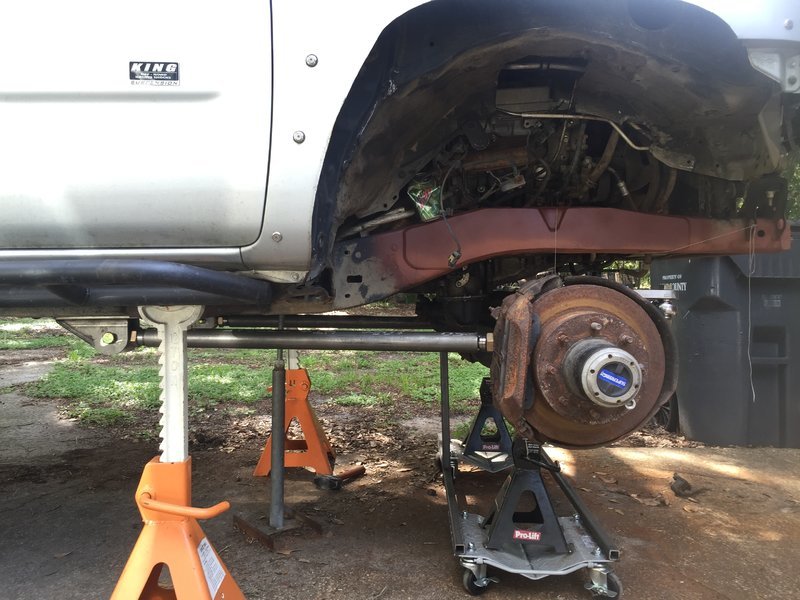

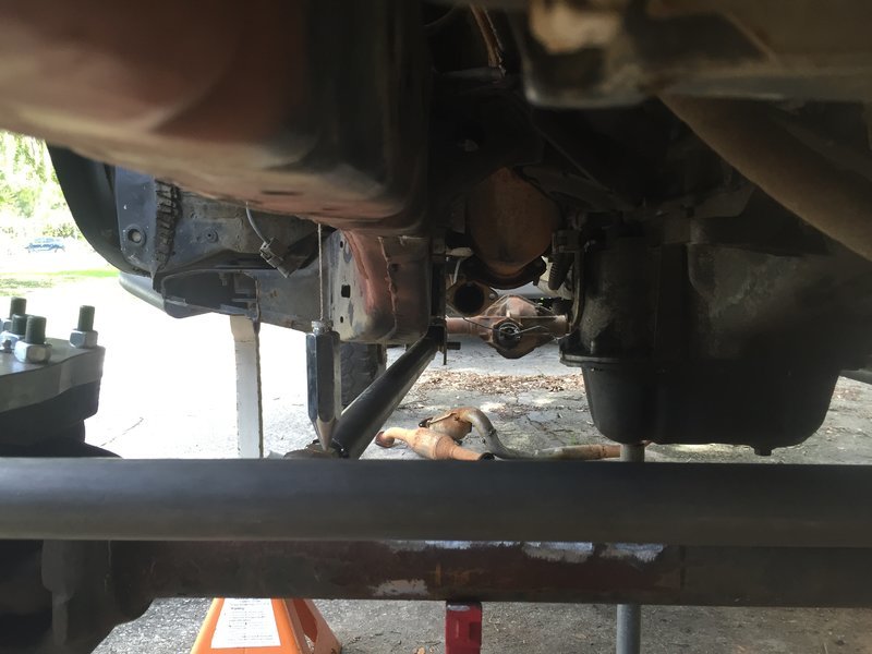

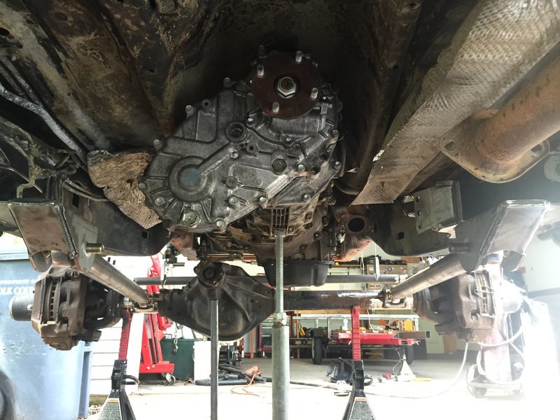

    Damn near a month since I've touched this thing. Work has kept me busy and the hot westher/high humidity and constant afternoon storms have prevents me from getting much done.
    Anyhow, got to work on it today. I got the exhaust out, frame mounts temporarily tacked to the frame, axle set, pitman arm on, and lower links cut and mocked up. Lower links are 41" and the pics are just about at full compression.

    When do you work so I can come get my mount on the passenger side? Hahahaha. I need that mount

    Hell, I had to change the mounts again today. Every time I mock it up I have to modify something lol

    I know you said 37s but look at all that room for 40s.

    I know. At first I was wondering why there was still so much room at full bump but realized your fenders are all hacked up. We will throw the iroks on there when everything is tacked up.

    Full stuff with a 39.5. It would be in the fender well more if the other side was drooped though @The End
