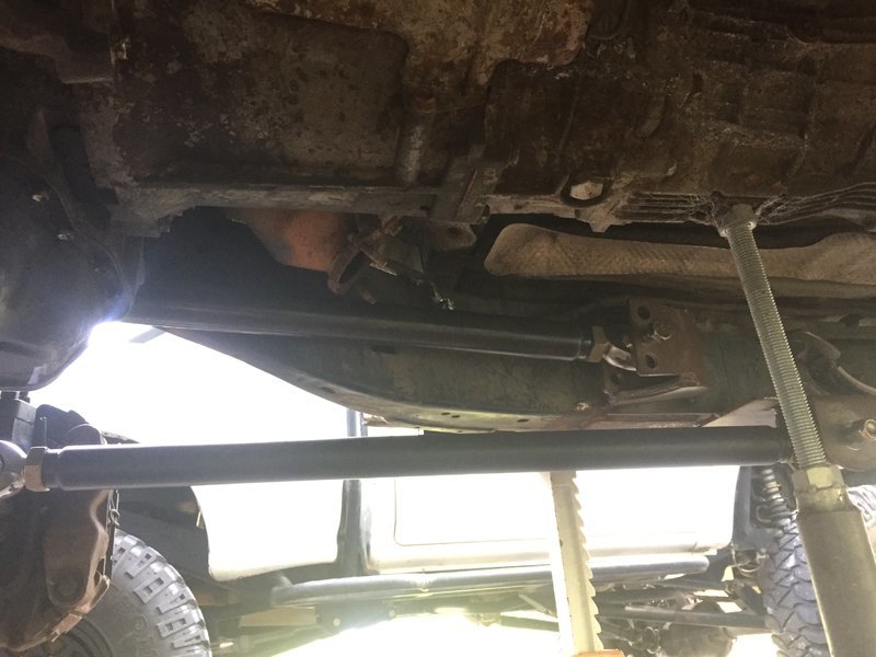

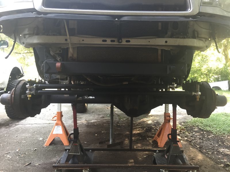

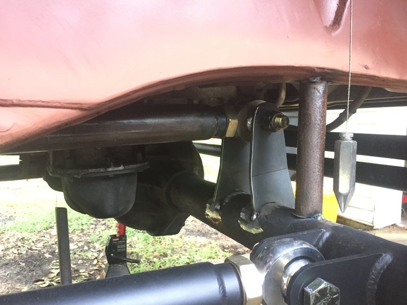

    Started the upper link axle bracket today and got that tacked up. Also got the axle temporarily welded to the frame at full bump to prevent movement while I get the panhard bar built.

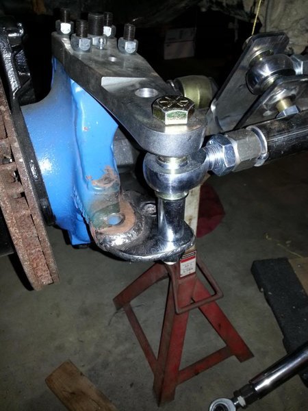

    Hey Todd, got a question for ya (that might display my ignorance, but oh, well...): how come the drag link (?) isn't on top of the steering arm with the tie rod on the bottom, rather than both of them being on the bottom and have all that extra leverage on the steering arm? I've always wondered about that. It seems like it'd be much stronger and more rigid if the heims were as close to the steering arm as possible.

    I have them this way to gain more uptravel. Doing it this way as opposed to the way you described got me another 2" of compression. I'll be making everything double sheer like the pic below (which is where I got the idea of this steering setup).

    Thanks for 'splainin' it. :hattip: Yeah, with that double shear configuration it seems way less sketchy. :D It sure would be handy though if they made a steering arm with a 2" drop or so. ;)

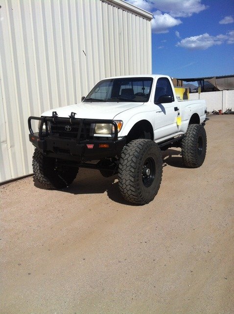

    #175
    1999RegCab
    1999RegCab Well-Known Member
    Apr 4, 2014
    #127007
    1,522
    Cacti Land, AZ
    1999 Reg Cab, 2.7, 5 speed
    3-link SAS

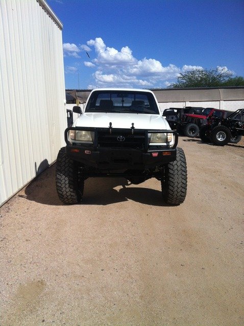

    Oh, I beg to differ. 1 tons look quite nice under 1st gens :D
    F844CA09-0679-40BB-B20B-EFA6EB7CA963_zps_9b96bb99be9f7b8b615c686478ee992089e55deb.jpg
    430D873E-F218-4454-8355-02177C6A5E4A_zps_d7c6d473df114e98249a13876f863daffe8c0c0e.jpg
    Same axle as the one on this thread - which is a D60 kingpin. Also rolling on 40"s but all wrapped in a smaller package :D
    MarX, 5 Lug Fury, Bobcdn and 8 others like this.
  16. Oct 29, 2016 at 8:38 AM
    #176
    ChadsPride
    Nov 26, 2014
    #143119
    127,315
    Sponsored by TacomaWorld.com
    Sweet rig man
  17. Oct 29, 2016 at 1:08 PM
    #177
    Taco No Baka
    Taco No Baka Interco Tire Snob
    May 9, 2013
    #103866
    8,434
    Lee
    Tampa, FL
    1998 SR5 Xtra Cab 4WD V6 Spartan Package
    OME 3" lift with Dakar rear leaves and 883 front coils. 36x12.50 Super Swamper TSL/SXs on Pro Comp Series 97 15x8 Steelies, Bud Built Front Skid, 4xI rock sliders, 4.88s and an Eaton True Trac LSD up front, 4.88s and a Detroit Locker in the rear, LED cab clearance lights, Sway Bar Delete, Rear Diff Breather Mod, Autometer Monster Tach, Cobra 25LTD Classic, Roof-mounted 3' Firestik Firefly, Garmin GPS, HiLift Jack, Flush-mount LED pod lights in rear bumper, 28" light bar in the front bumper, rear shock relocation (Ruff Stuff brackets), u-bolt flip with Ruff Stuff Anti-wrap perches, CBI rear frame reinforcements, 10" travel Bilstein 5125 rear shocks, heavy duty front crossmember made by Allenfab, Rear shock mounts/crossmember (for upper mounts), spring perches, frame plates, and front crossmember welded in by Allenfab, CBI Ditch Light Brackets, Ditch Light Pods. AllenFab Custom Hybrid front bumper and recovery points. Drivetrain lifted 2" in conjunction with a 2" BL. Modified Trail Gear transmission crossmember/skid. Warn Xeon 10K winch. Large left side body mod.
    Nice. :thumbsup: Looks a little like Todd's machine, haha. Still, I'm going to stand by my statement. ;)
    ChadsPride likes this.
  18. Oct 29, 2016 at 1:17 PM
    #178
    1999RegCab
    Apr 4, 2014
    #127007
    1,522
    Cacti Land, AZ
    3-link SAS
    Thanks!
    Haha. So what is it exactly that you don't like about little trucks with big arse axles and tires? :D
    ChadsPride[QUOTED] likes this.
  19. Oct 29, 2016 at 1:28 PM
    #179
    Taco No Baka
    May 9, 2013
    #103866
    8,434
    Lee
    Tampa, FL
    They just look a little cartoony to me. Don't get me wrong, I think 1st Gens, being smaller and lighter, are superior platforms for trail rigs in all other ways. I guess I'm just not a fan of more than half the tire width sticking out from under the fenders. Looks too 'open-wheel' for me. And again, don't get me wrong, if I ever have the means to SAS, and I didn't have any other options (like a hybrid axle), I'd go with full width axles under mine probably before I went with a Toyota straight axle...maybe. Yers is definitely better than some I've seen though. :cool:
  20. Oct 29, 2016 at 2:41 PM
    #180
    1999RegCab
    Apr 4, 2014
    #127007
    1,522
    Cacti Land, AZ
    3-link SAS
    I hear what you are saying. Some people don't want to have their trucks look like something that came out of a redneck video game LOL
    But it's not about looks. It's all about function man. Wait until you wheel a smaller rig with full-width axles and big tires:thumbsup: (if you haven't done so) Full width axles add so much more stability, it's a huge difference. No wonder why rock buggies and Ultra 4 rigs follow that formula. Not that you cannot wheel with a bigger rig with big axles and tires
    Also, Having the tires out of the way makes wrenching easier; and anybody that has done a SAS will tell you that building a rig with a straight axle is easier with full width axles. It just creates more room for clearance for steering and suspension components, etc.
    More than once I've heard the famous last words:
    "I'll never go bigger than 37"s"
    "I should have gone with 1ton/full width axles from the beginning".
    Make sure you are not one of those guys haha :D ...cause it costs a shit load of money to rebuild things:eek:
