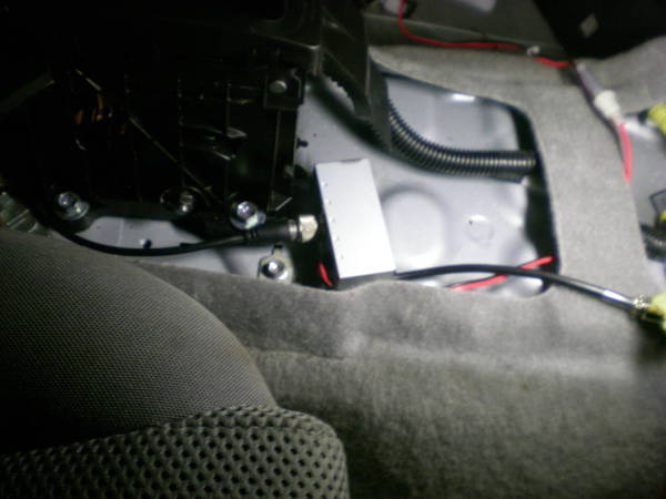

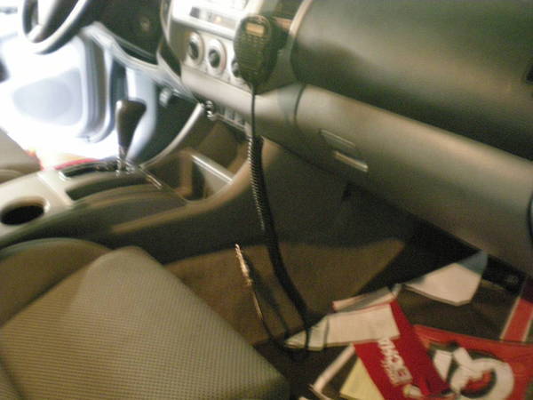

    I went with cobra 75 SWT, I finished my install over the forth.
    Here is a couple pictures
    and finished

    I own a Midland 75 that I use as a loaner (with a mag antenna). Its decent radio but its worthless as a handheld. Its just the nature of the wavelength and its inefficiency on small antennas. I have to say, the Cobra is a nice unit. A friend of mine has this radio and it sounds clear. The cable management is better, too in my opinion. You mount the box in a hidden location, then the unit plugs into one cable when you want to use it. You can power this box by going straight to the battery for less noise. The midland unit uses a cigarette lighter plug which picks up a lot of engine noise, in addition to having more wires all over. It works well as a loaner for that reason, but I think the Cobra is a better unit if you install it well.
    Both radios should put out the same power - about 4 watts, so your ability to be heard depends on your antenna and a good install. I would recommend going with the biggest antenna you can tolerate. the Firestiks work pretty well, and roof mount antennas work even better. Hope this helps..
