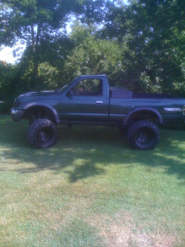

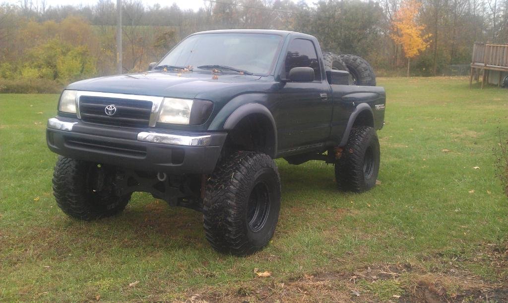

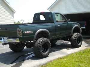

    Musher will be getting a big makeover for the next month so I figured I'd start me a build thread finally lol. I'll post up some of the original pics I have of her.

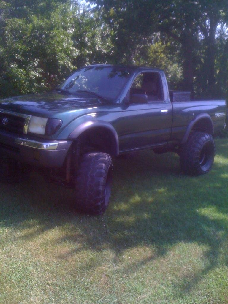

    Here are specs when I bought her.
    1999 toyota tacoma standard cab 4x4
    200,000 mile
    3rz 4cylinder, 5spd, 5.29 gears.
    6" Fabtech lift, 15x10 black steelies and some wore out 33x15.50 swampers.

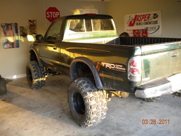

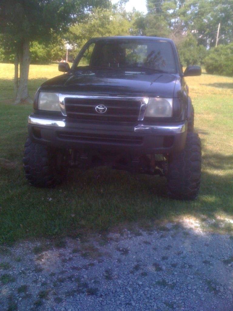

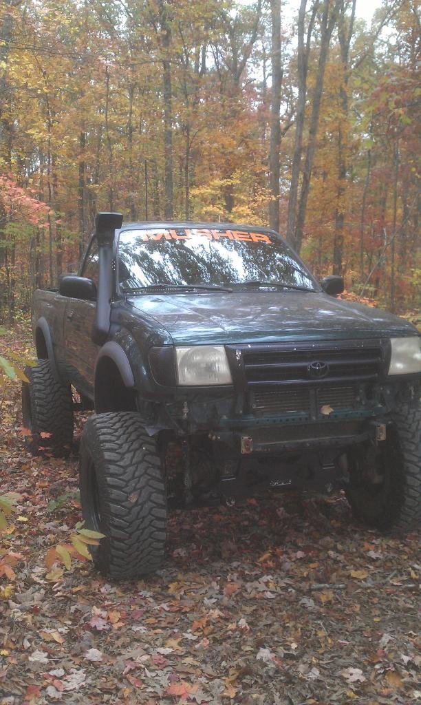

    When I got Musher it had 33" tires that looked kinda small for the lift it had so I bought used 35" Cooper STTs off Craigslist to see how they fit.

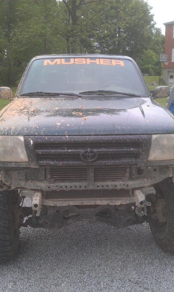

    Next I painted my grill black because it looked kinda rough so figured painting it black would be cheaper than buying a new one lol and while I was at it I removed my front bumper trying to motivate me to get a after market bumper built but just havent had the time or extra cash to move forward.
    next I had to replace the used tires I had bought so I stuck with the good ole Cooper STTs because they are one awesome tire and priced very well.

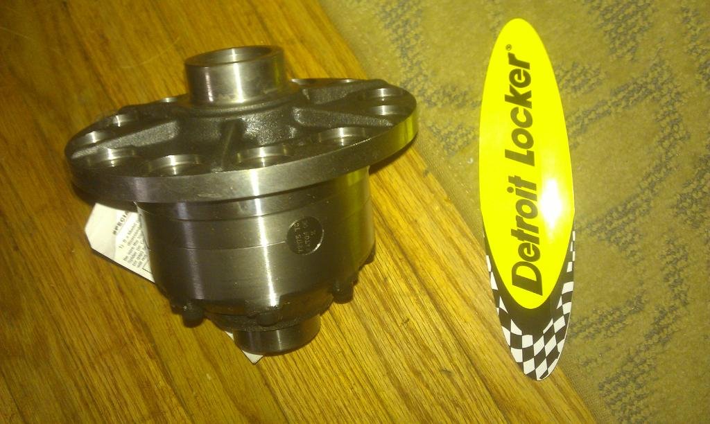

    I started getting parts in this week but didnt get started on musher yet. My detroit should be here tomorrow I got a big box from allpro and smitty built yesterday. Heres a little eye candy for everyone lol.
    Some eye candy!!!!!!!!!!!!!!!

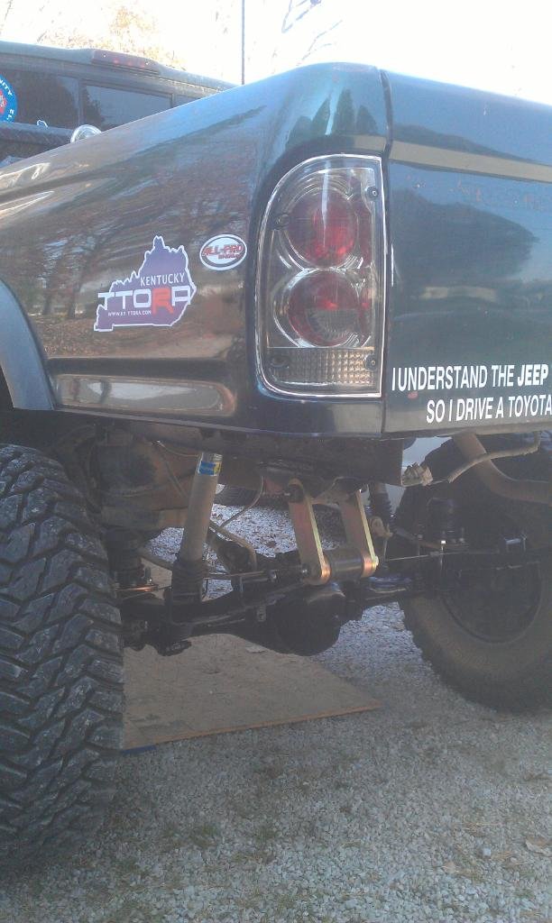

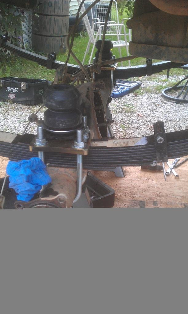

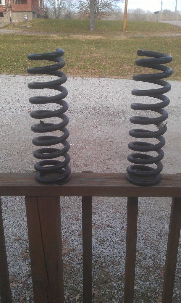

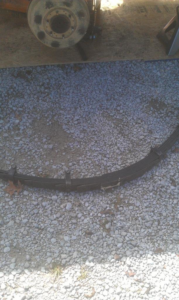

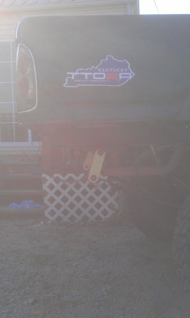

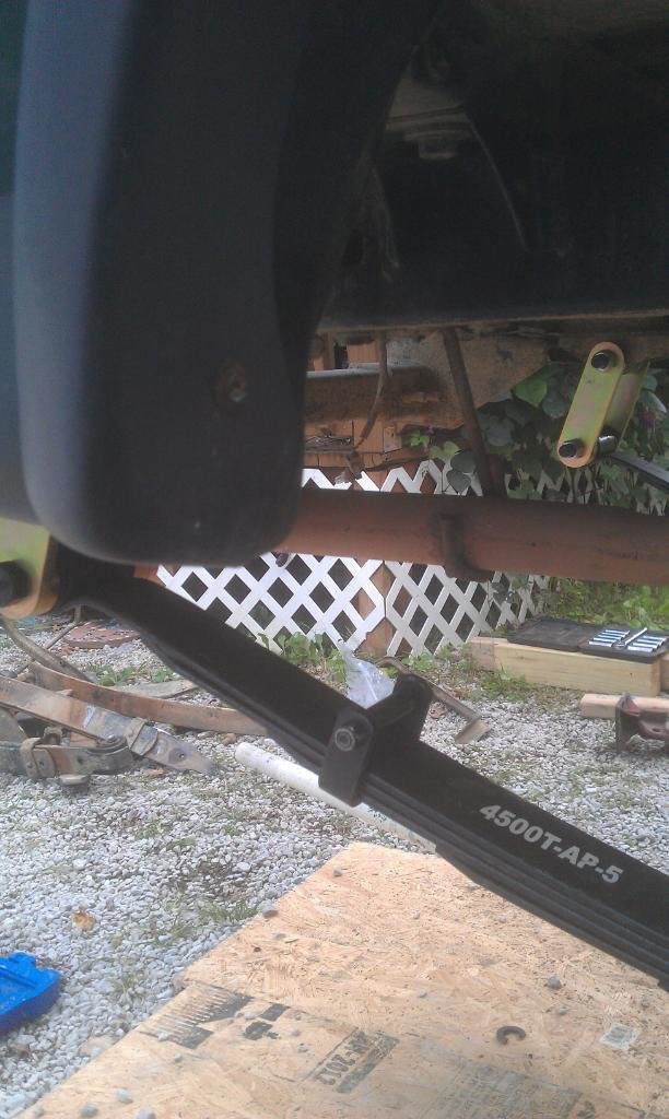

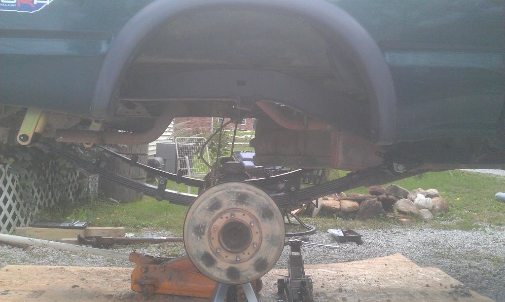

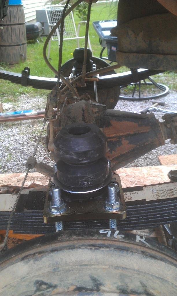

    So I finally officially got started on my project today. Got all the rear suspension buttoned up minus getting the new shock mounts welded to the axle. Heres a few pictures of my new allpro setup. 5" lift springs, 1.5" grease able shackles ubolt flip kit with tembrin bumpstops.
    Out with the old and broke springs.
    And in with the new!!!!

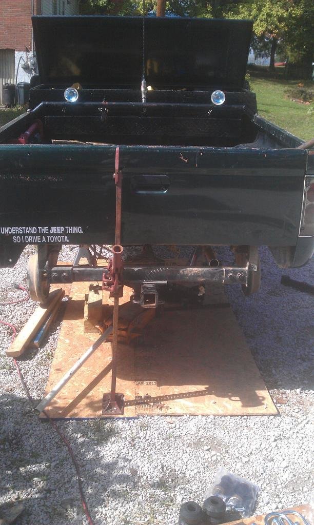

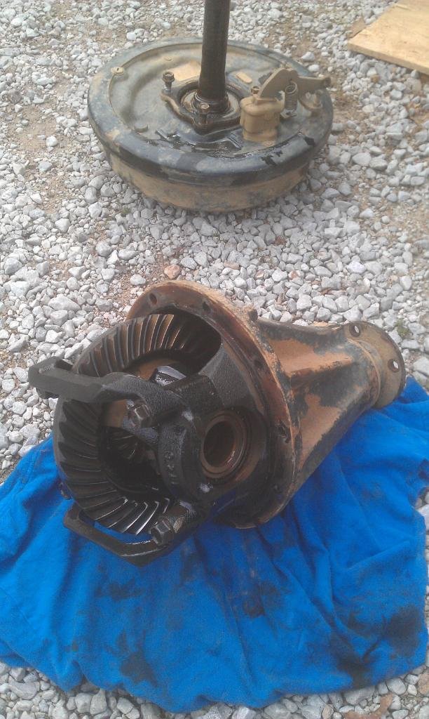

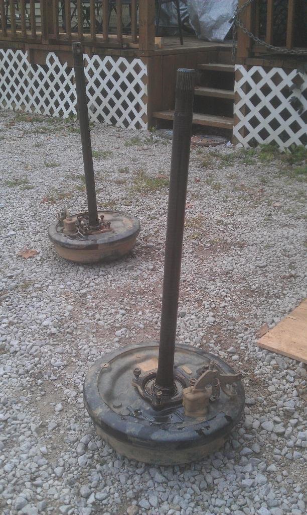

    Started on my locker install this morning since the weather was good. I received my master install kit and detroit locker last week so I've been itching to get it installed. I pulled my rear axle shafts this morning and rear third to have everything checked out since I suspect I have a bent axle shaft. So I dropped everything off at a local shop in Winchester to have both axles checked and my locker installed.
    Heres the axles pulled out and ready for inspection.
    Third just waiting for the Detroit!!
    Empty axle housing!
    Well made a little progress over the weekend finally. Got the rear diff back Wednesday night but it was missing a few ring gear bolts. So after pulling a few teeth I finally got the bolts ordered and received them Saturday but Saturday was the wifes birthday so worky on truck lol. Started on it today by lock titing the bolts in and torqueing them down. Got the rear end out together, fluid added and brakes bled. Took a small test run and rides great. Also ordered a battery box from Ballistic Fab, a snorkel in a group buy and debating on a little tire upgrade for something a little more aggressive but not decided yet. Heres a few pictures I took and remembered to take lol.

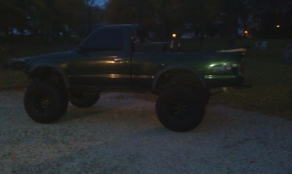

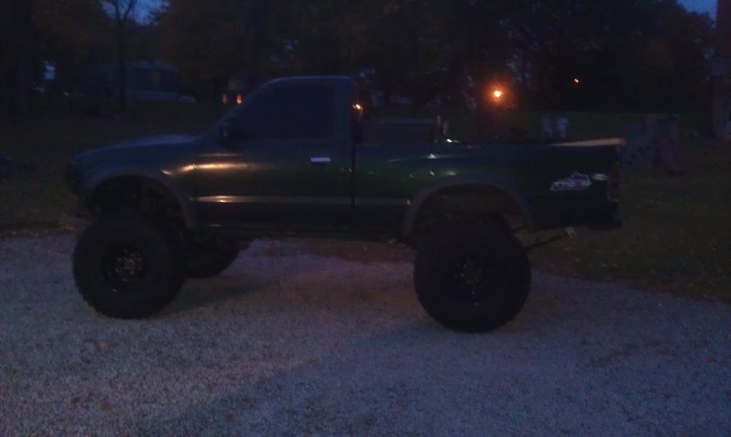

    Heres a few pictures of how MUSHER sits with her new springs and shackles installed. It was almost dark so pics suck.

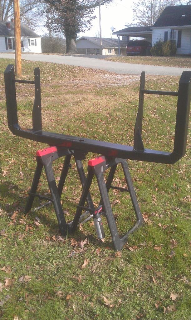

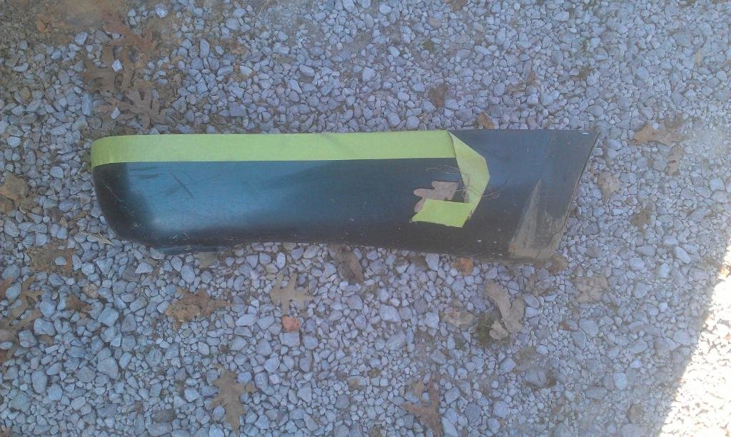

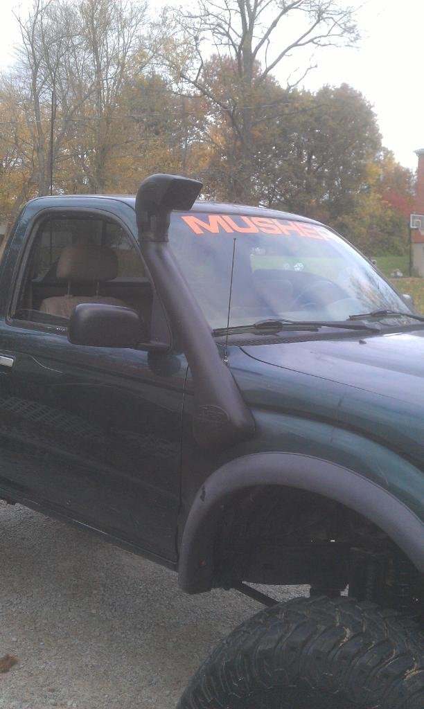

    Well I have been pretty busy lately but have made a little progress on musher. Right now just kinda a waiting game on getting the bumpers and sliders done. He's supppose to start on it in a week or so. Last weekend I received the snorkel I had ordered in a group buy so here's a couple pictures of it installed. I always get in a hurry and never get any pictures of the install in progress lol.
    Then yesterday while the weather was good outside since I don't have a garage to work in yet I cut my bed sides off for the high clearnace bumper I'm gonna have him build for me. I also went to tractor supply and picked up the D-ring shackles. Heres a couple pictures of how much bedside I cut off and how it turned out.

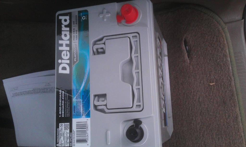

    So while I've been working on MUSHER and adding stuff I thought it might be a good time to upgrade my battery to match the battery box since I'm adding a winch, lights and a few other things. So while I was looking into batteries like the optima and others a buddy of mine had done some extensive research into batteries and he recommended the diehard Platinum being better than the optima. So yesterday I picked up a diehard platinum to match the box I ordered.

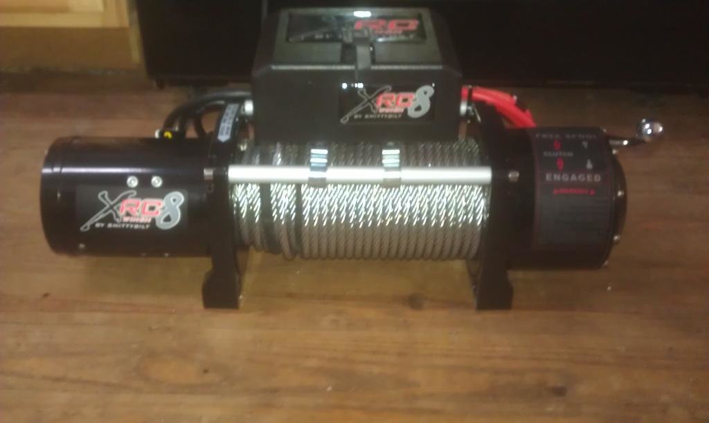

    Didnt get much of anything done yesterday because our baby sitter was sick so I got stuck being baby sitter for the day with Rayna having to work. I did however get my winch out of the box and get it put together so I can take it with musher this weekend to have bumpers made. Gonna take him the winch too so he can make a mount for it to be mounted to.

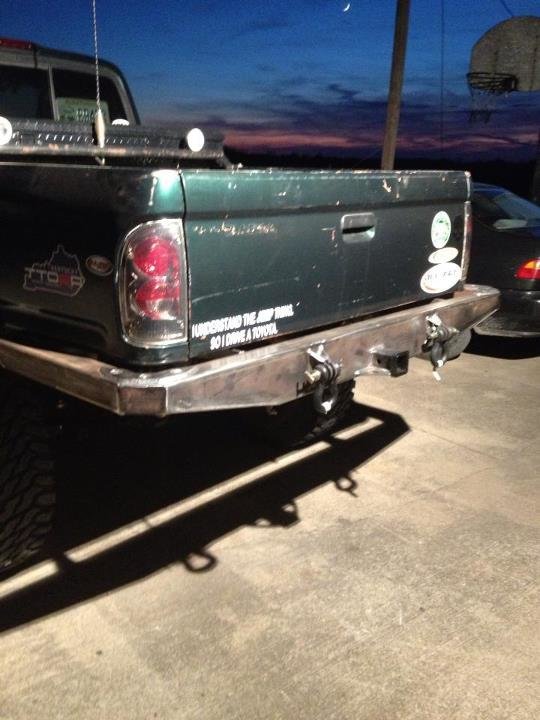

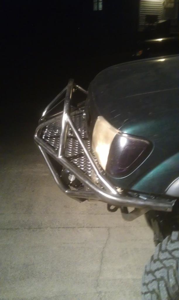

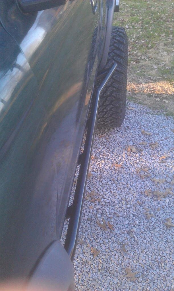

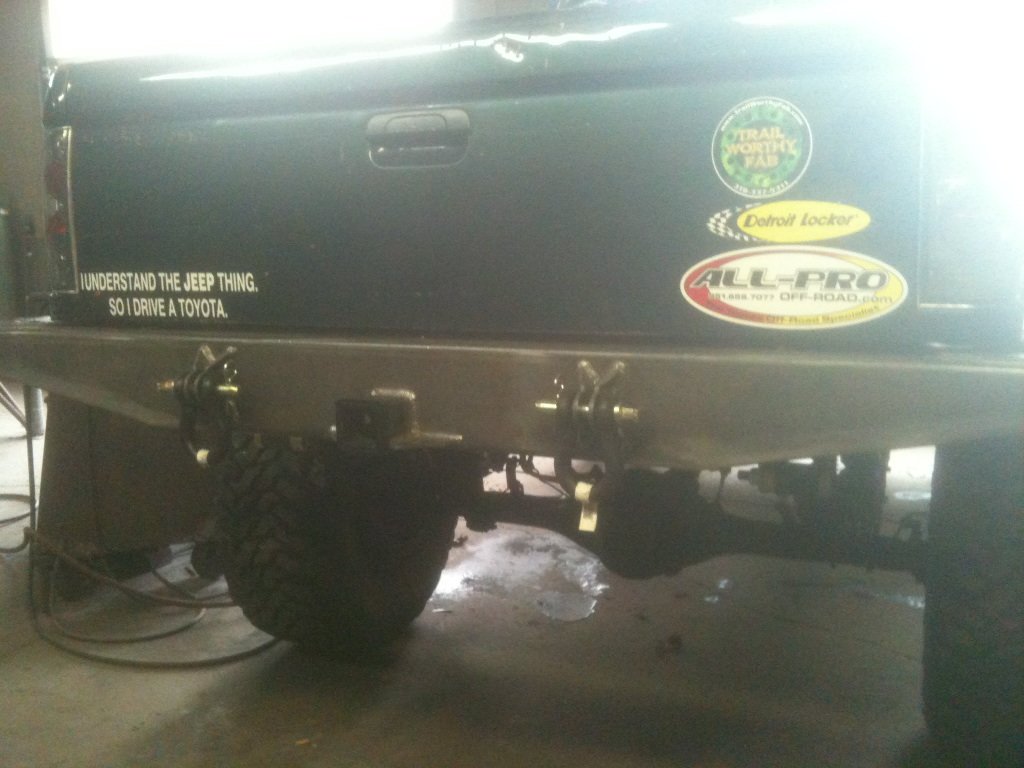

    Well not alot been going on here. Musher has been at a local shop since last Sunday having bumpers and sliders custom made. So its been slow going but I did get a sneak peek of how the rear bumper is looking so far. So figured I would share it.

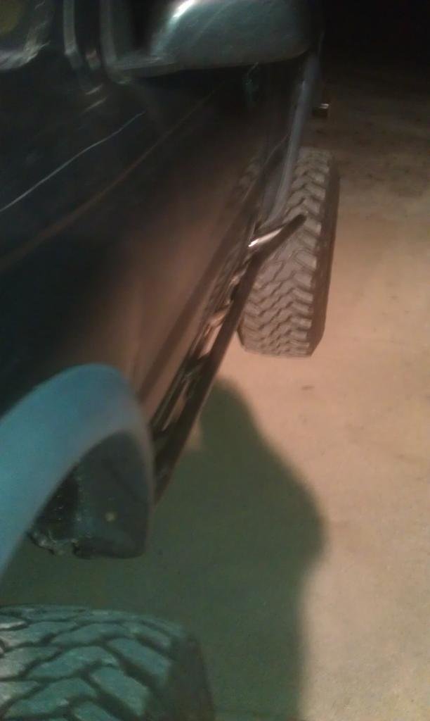

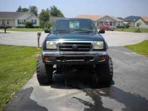

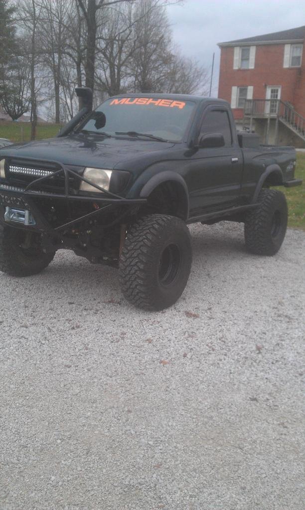

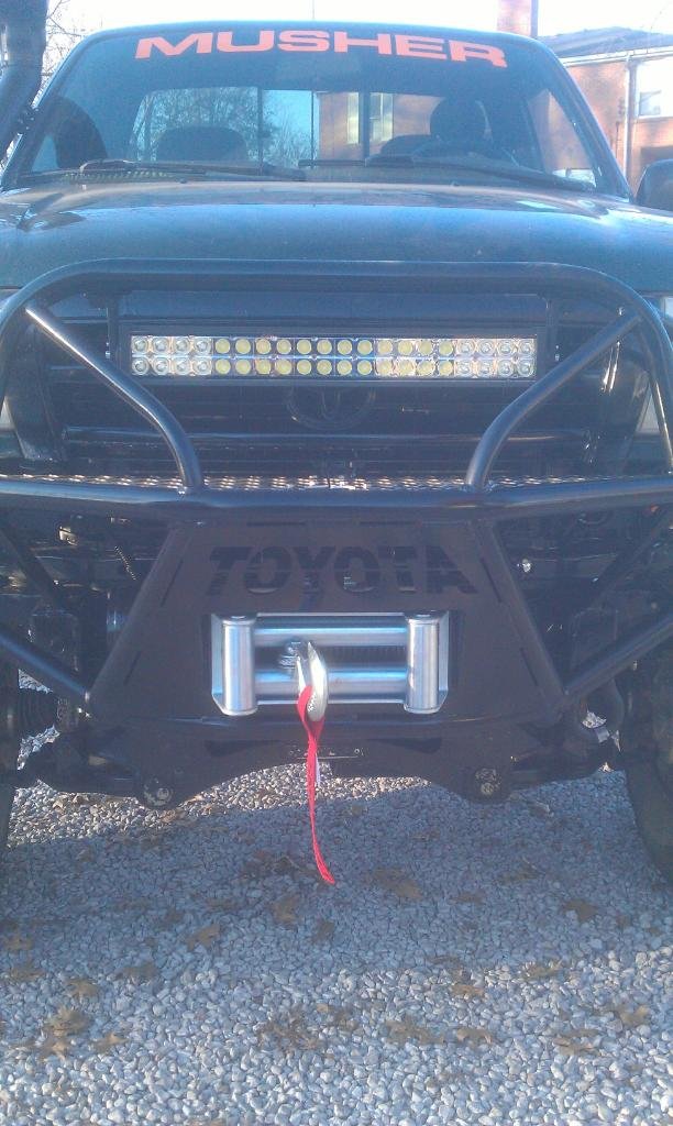

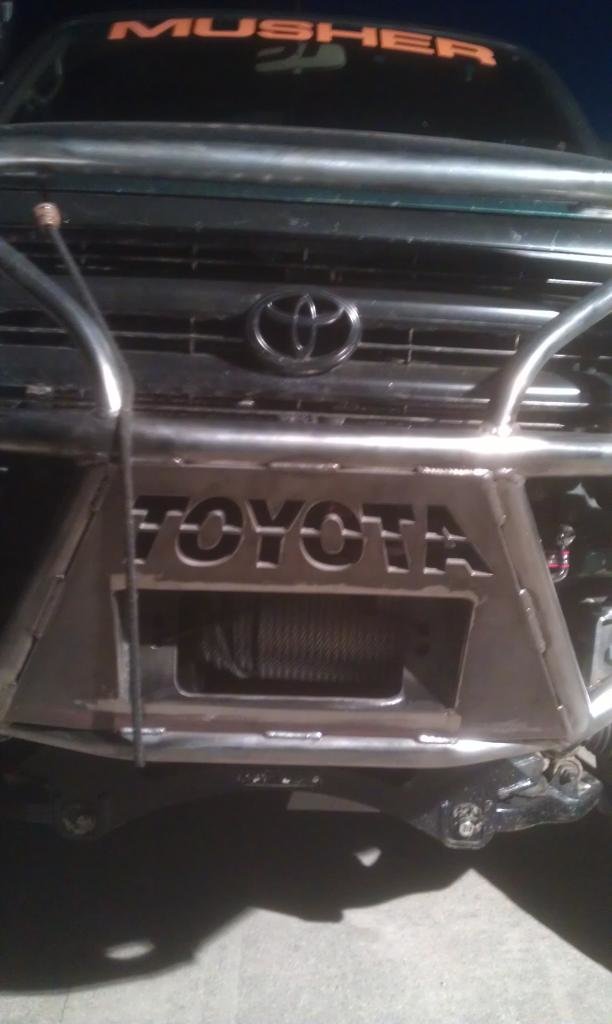

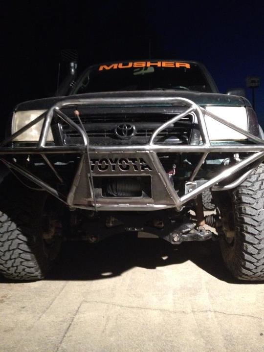

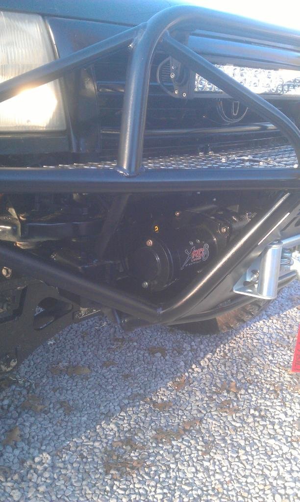

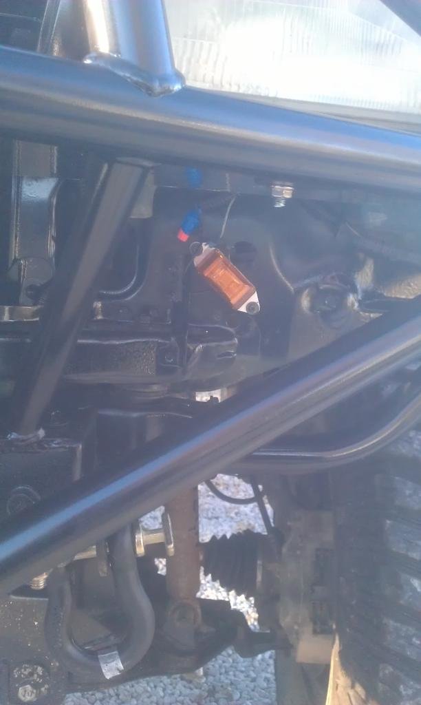

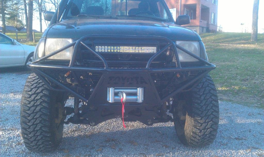

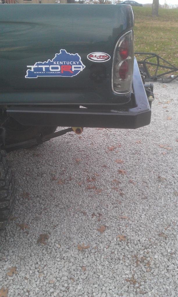

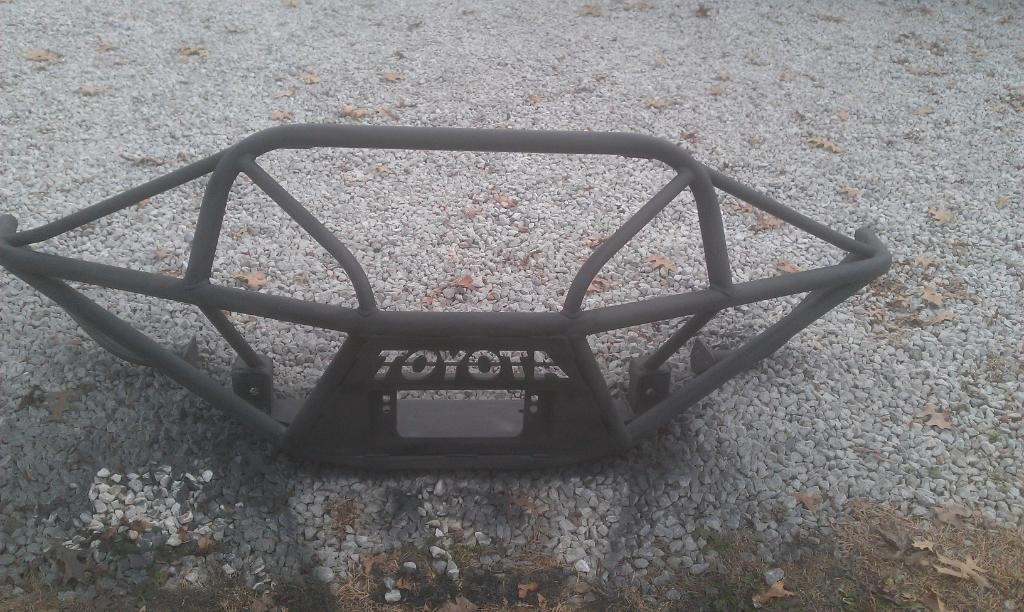

    Well I've got some updates for you guys I finally got musher back last Thursday and was very pleased with the outcome of the bumpers and sliders but i've been busy so hadnt had time to post any new pics yet so heres some pics of the bumpers the night I got them and some of them as I'm painting them this week. I finished painting everything today but didn't get new pics. So here what I got.
    New bare metal.
    And a few with paint in progress and finally decided where to mount my license plate.

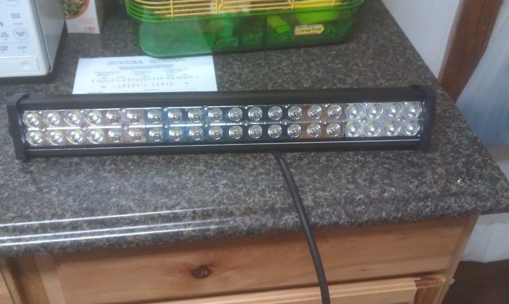

    Well finished up painting everything yesterday and got both bumpers secured good. Today I got the winch, led light bar mounted and and the diamond plate top plate mounted up. Got the wires plumbed but dont have any switches yet to hook everything up. Did replace my factory front turn signals with some new led lights and got them mounted. Heres a few pics.

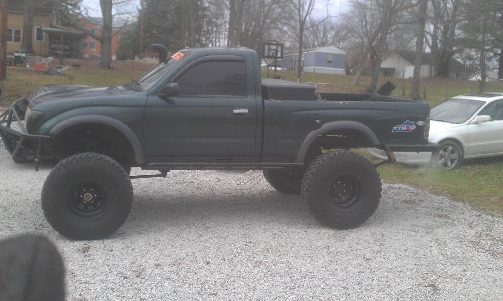

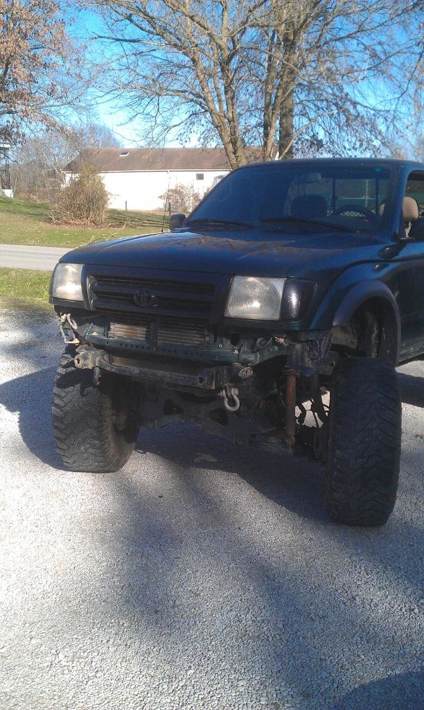

    Well not alot been going on lately with the holidays and all that crap going on but I did decide I didn't like the way the front end was setting but didn't want to drop alot of money into it since I'm planning to SAS it next winter. So I remembered Matt had added heavier coils to his front lift when he did his fabtech lift. So I found a used set cheap and installed them this week. Heres a couple pics after the install. Only a few things left to do and then gather the rest of the parts over the summer for the SAS.

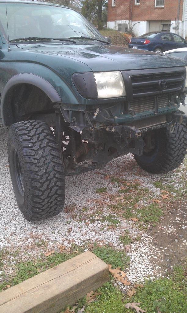

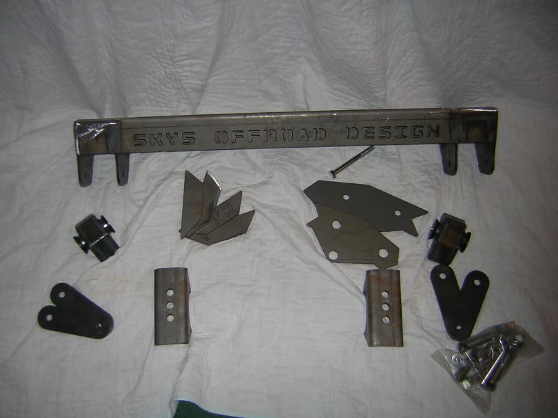

    Well not a lot going on here. Had some wheel bearing issues so I'm through with ifs. Solid axle swap to start very soon. Watch for progress.

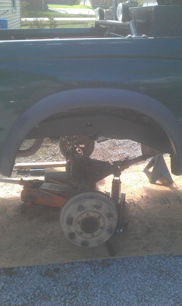

    #46676
    396

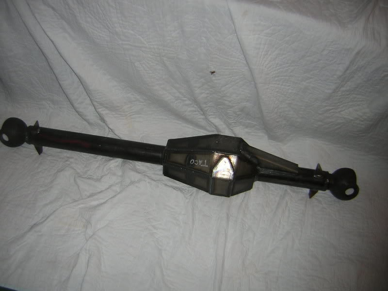

    A little progress with the sas. I'll post up more details when I get a chance.
