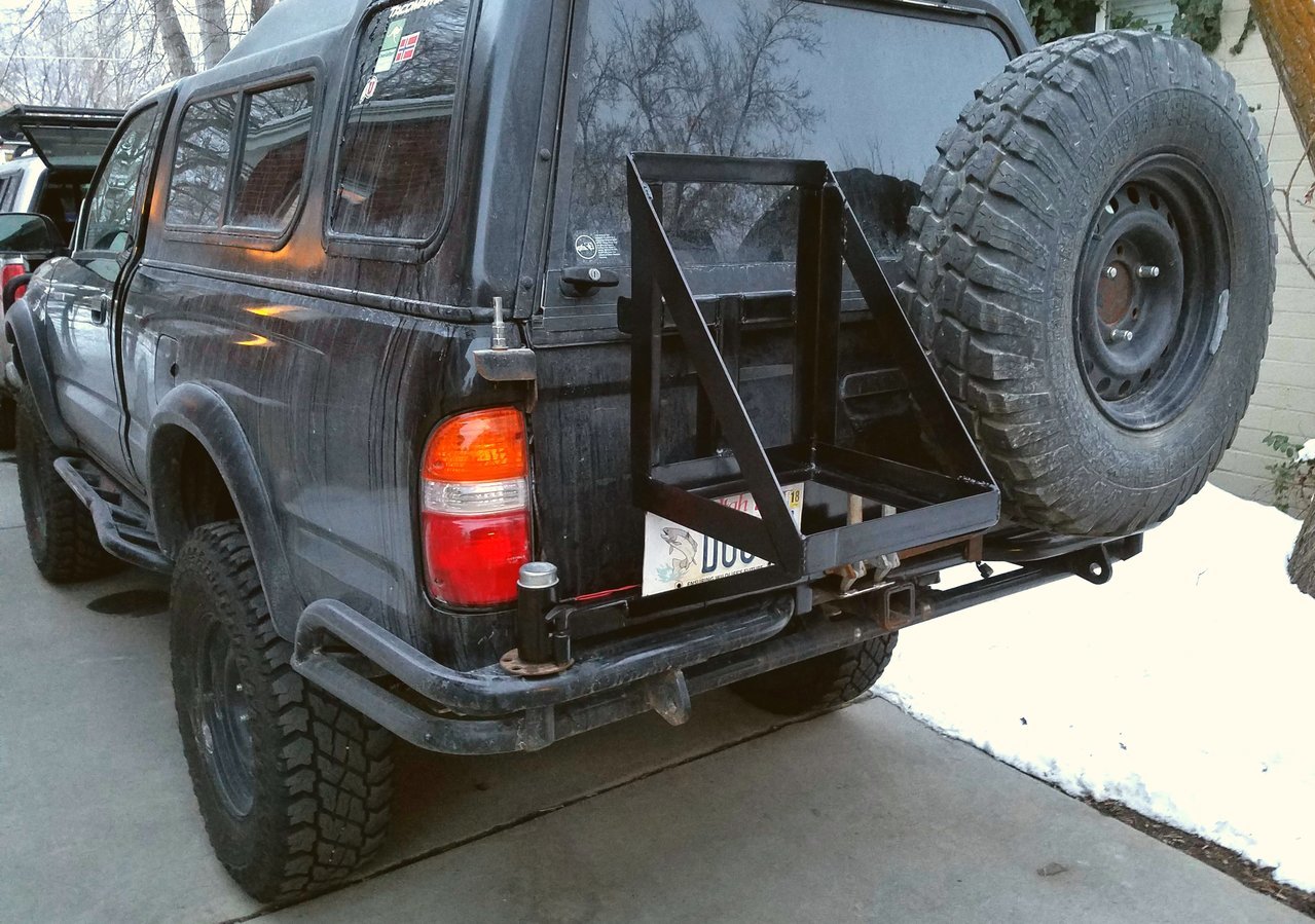

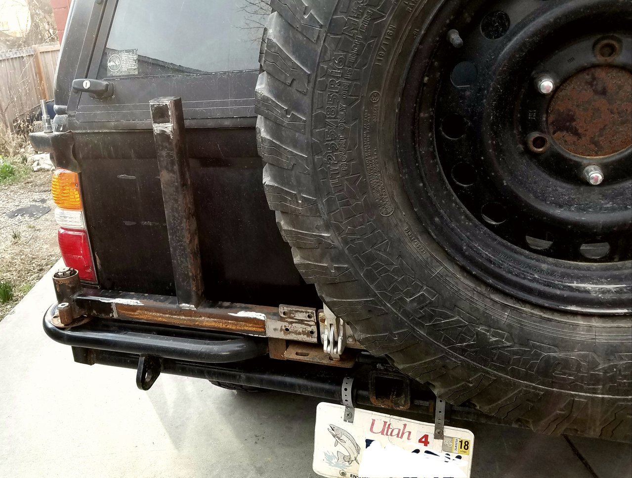

    Started fixing up this bumper mess. Utah salt sucks.

    Departure angle fixed, slowly getting there.

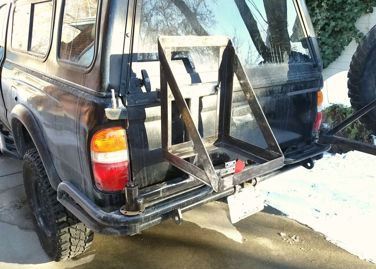

    Gas can side fixed, then went and played around in Goblin Valley.

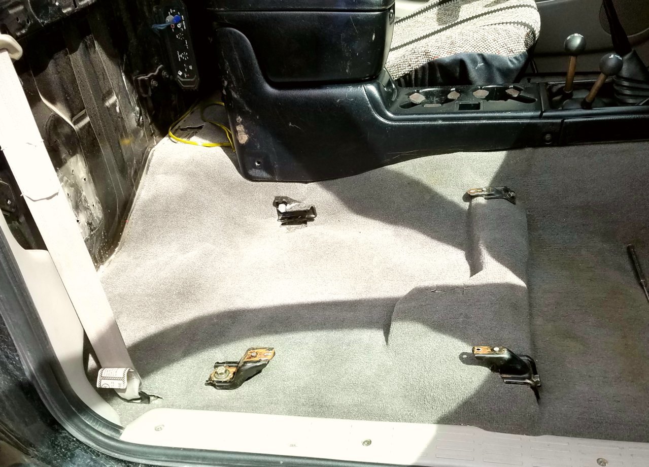

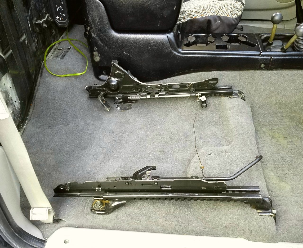

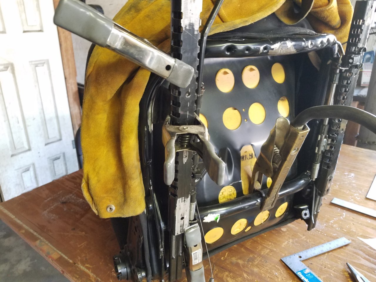

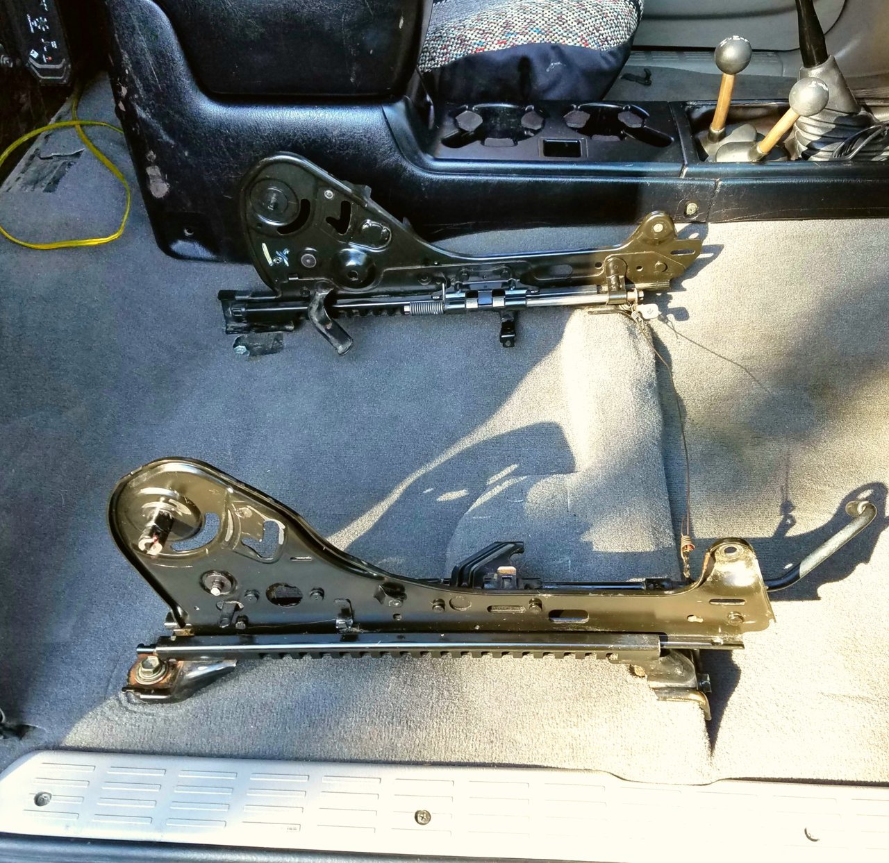

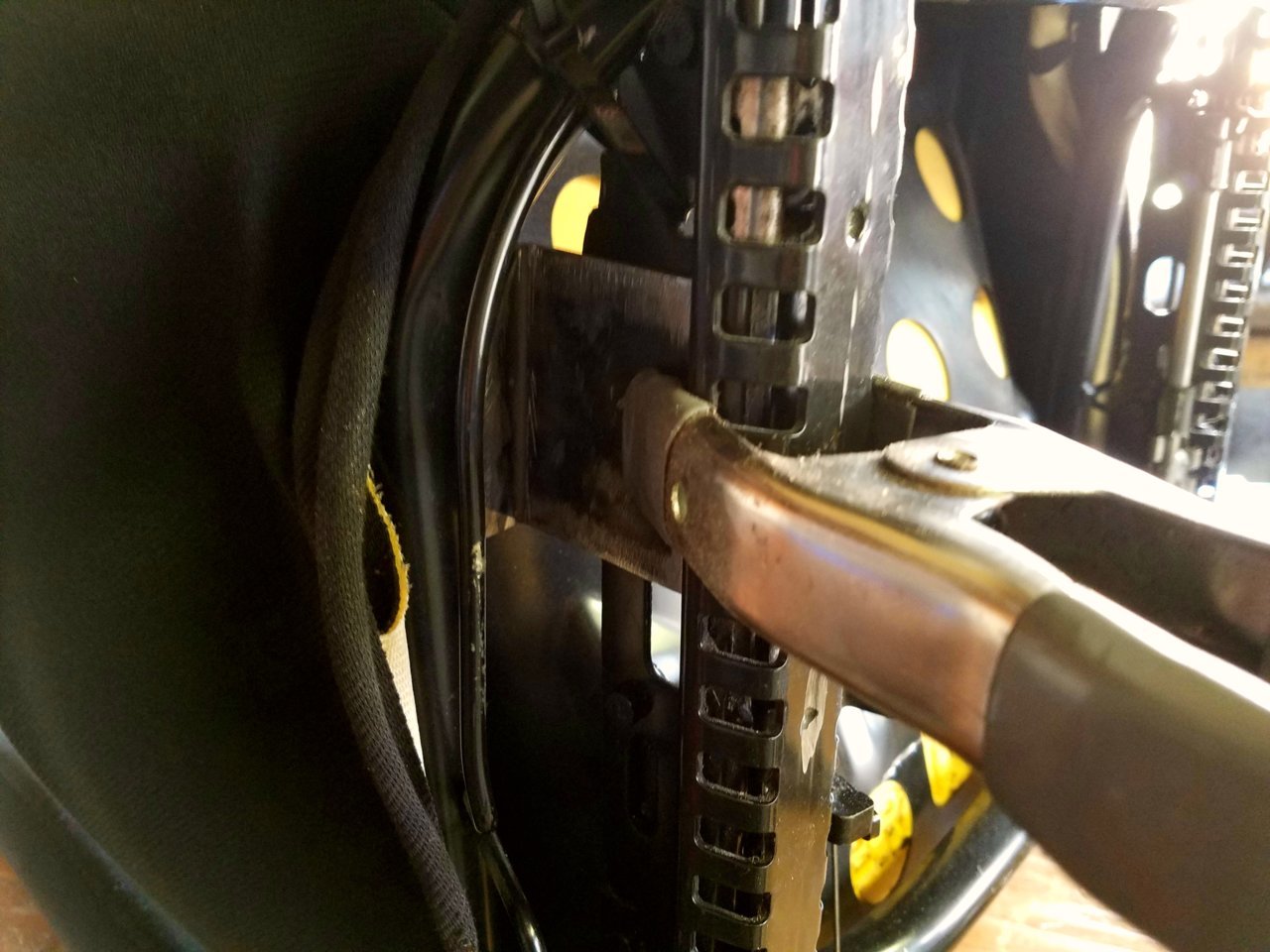

    The weather's good and had some time to start this seat swap.

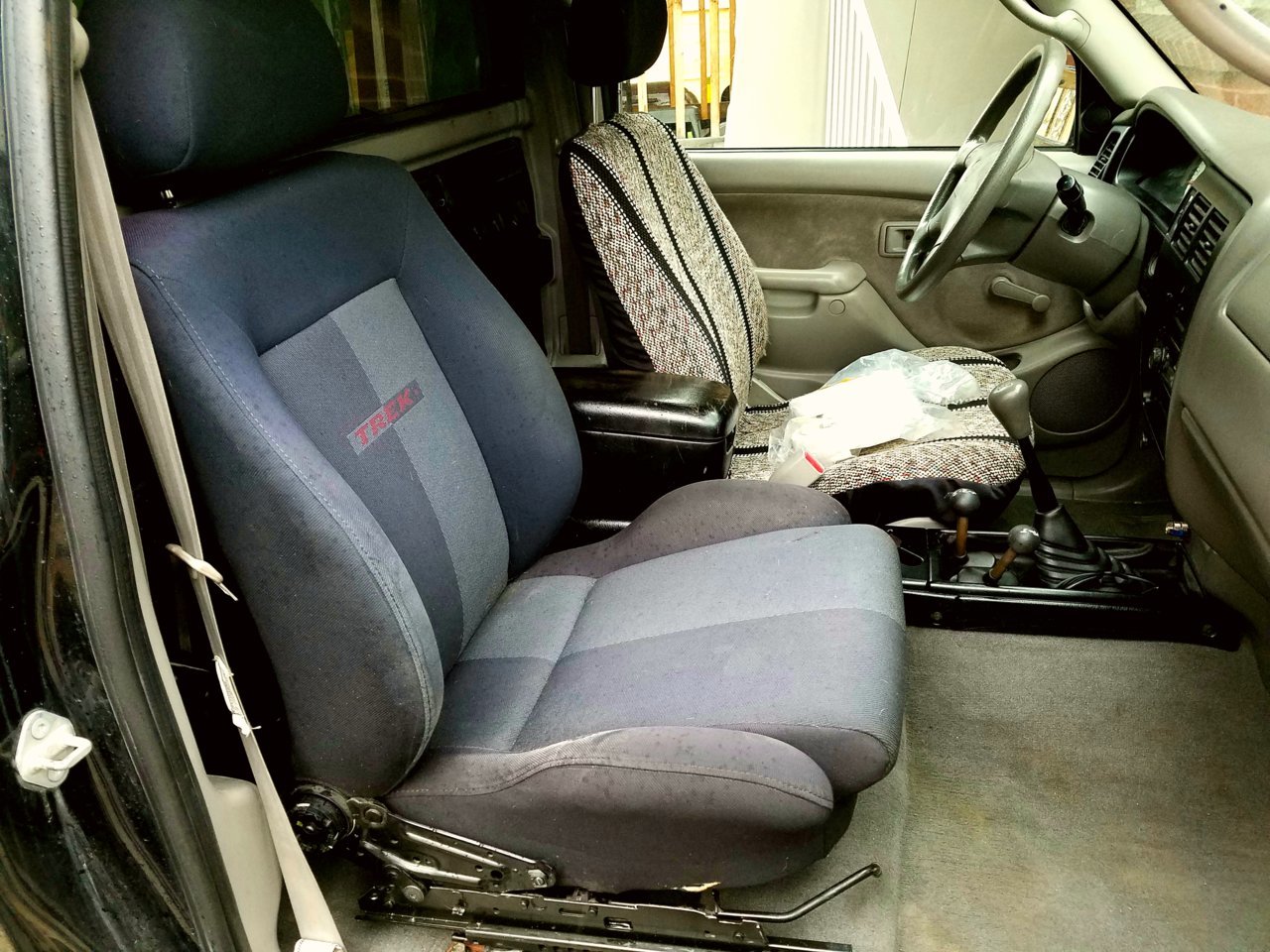

    These are what I'm swapping in. VW Jetta Treks from the late 90's, big upgrade from the factory taco buckets.
    Picked up some sacrificial taco buckets for a cool 20 bucks and tore them apart for the rails.
    Too wide for the Treks so I chopped them down a bit.
    Found the height I wanted but the rails now need to be moved in for a solid attachment point so I cut the legs off.
    Built some brackets and melted them on.
    And... that's where I'm at for the day. More fun to come.

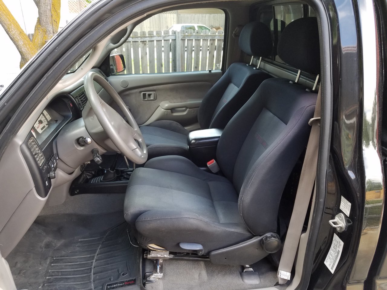

    Co-pilot seat is in.
    They are pretty sun faded, thinking about reapolstering them in black, gray and red tartan, something like this, maybe...

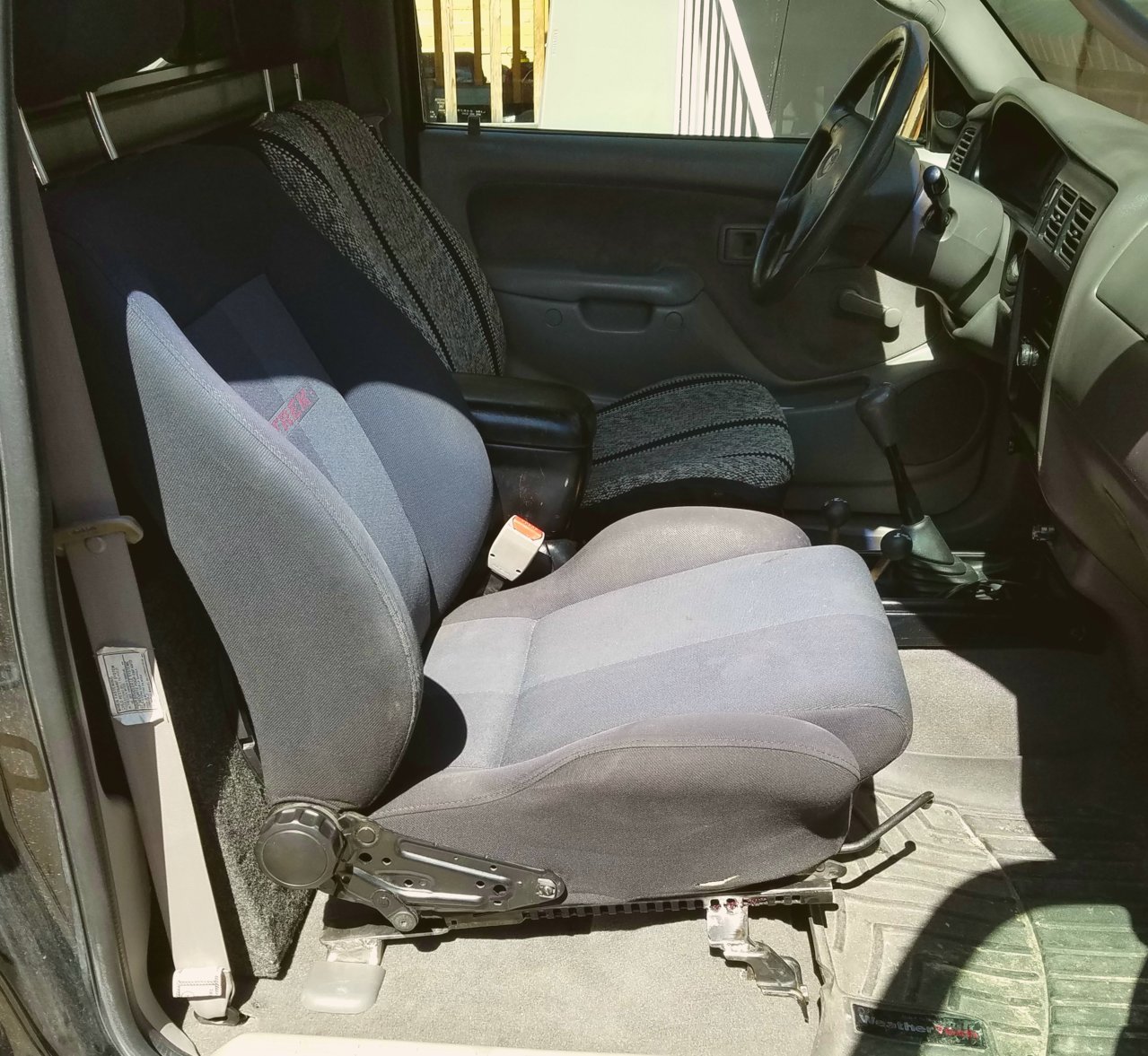

    Finally finished up the seat swap, looking forward to some long drives now.
