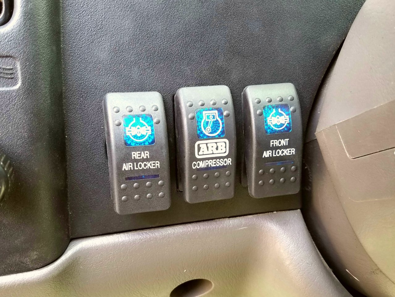

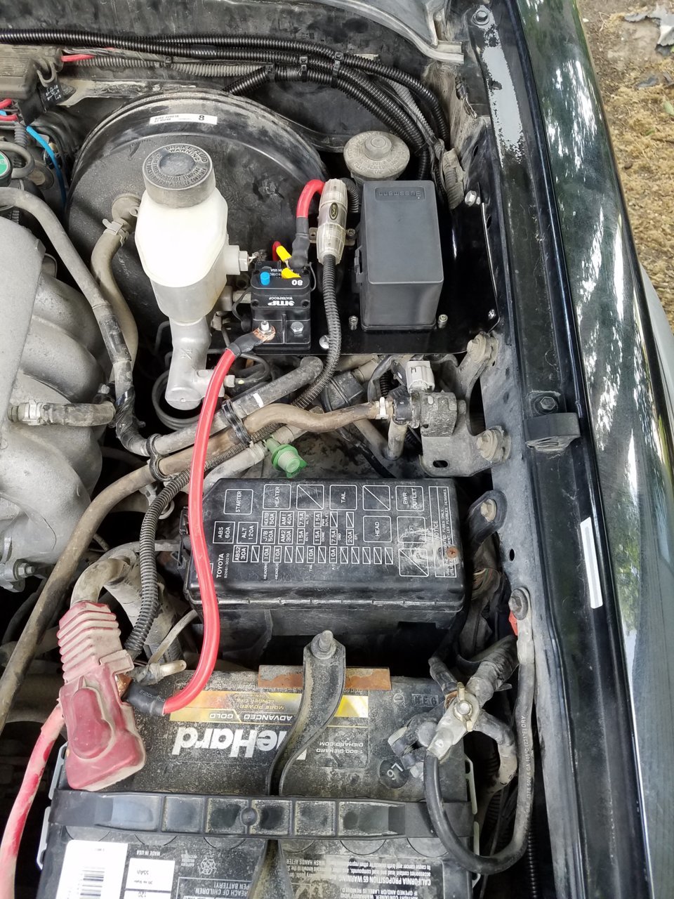

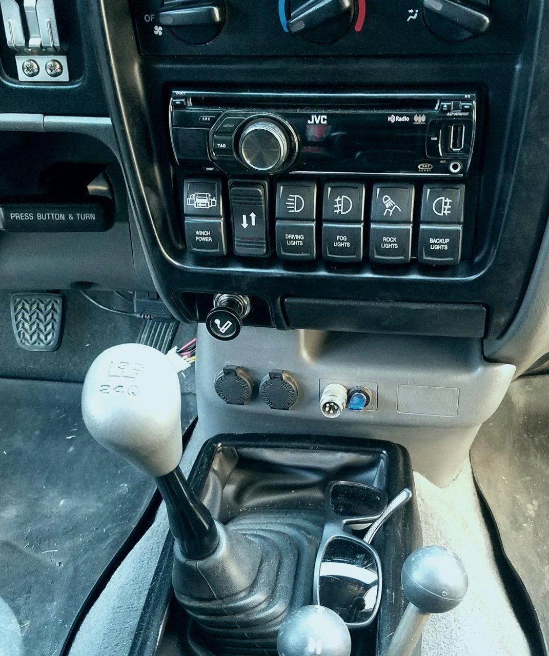

    Stuff and things that make it better.
    Added some switches, lights and things.
  2. Jul 4, 2018 at 8:06 PM
    #202
    arctic04trd
    arctic04trd VA7XTE
    Nov 23, 2015
    #170508
    880
    British Columbia
    2010 DCLB
    I like your mic holder location. I would totally copy it....if my ARB locker and air compressor switches were not already there.

  3. Jul 4, 2018 at 8:10 PM
    #203
    Jiveydude
    Jiveydude [OP] Well-Known Member
    Oct 22, 2013
    #115035
    1,324
    Micah
    OH
    04Taco
    You could always move them to the other side of the wheel like mine.
  4. Jul 4, 2018 at 8:11 PM
    #204
    arctic04trd
    arctic04trd VA7XTE
    Nov 23, 2015
    #170508
    880
    British Columbia
    2010 DCLB
    But my rear locker and clutch start cancel are there....
    Hmmm getting me thinking
  5. Jul 4, 2018 at 8:13 PM
    #205
    Jiveydude
    Oct 22, 2013
    #115035
    1,324
    Micah
    OH
    04Taco
    All 3 can fit.
  6. Jul 4, 2018 at 8:14 PM
    #206
    arctic04trd
    arctic04trd VA7XTE
    Nov 23, 2015
    #170508
    880
    British Columbia
    2010 DCLB
    Looks sexy........that really is an attractive option

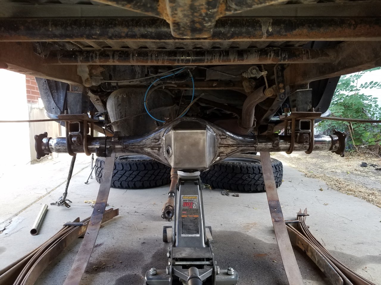

  9. Jul 13, 2018 at 3:43 PM
    #209
    Jiveydude
    Oct 22, 2013
    #115035
    1,324
    Micah
    OH
    04Taco

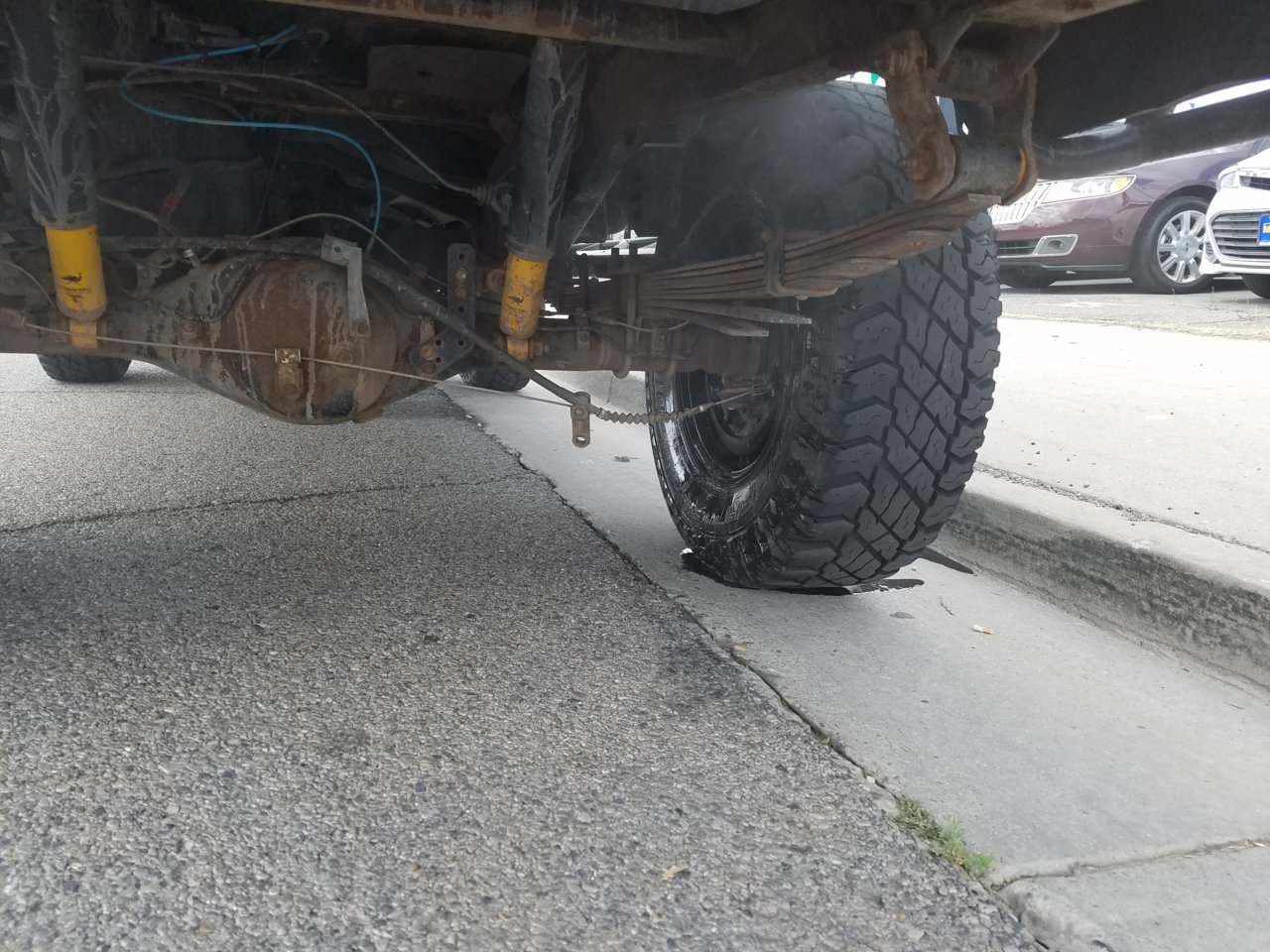

    Going under the knife tomorrow, got a bent axle housing that probably should've been fixed miles ago. Most likely caused the seal failure. On a positive note, no abs in the doner axle. (yes @DJB1, the e brake cable will be attended to :rolleyes:)

  11. Jul 14, 2018 at 12:51 PM
    #211
    Jiveydude
    Oct 22, 2013
    #115035
    1,324
    Micah
    OH
    04Taco
    Well, there's your problem...

  12. Jul 15, 2018 at 11:22 AM
    #212
    DJB1
    DJB1 Well-Known Member
    Jun 8, 2013
    #105835
    2,223
    Dave
    SLC, UT
    2003 Regular Cab 4X4 5MT
    You got some incredible longevity out of those axle parts. You drove it for months knowing that the housing was bent, then we went on a 500 mile round trip in 100 degree heat with at least 300 of those miles on dirt, you took it on gnarly OHV trails, and it still didn't outright fail until you were a few miles from home. It is surprising how much abuse OEM Toyota parts can handle.

  13. Jul 15, 2018 at 12:31 PM
    #213
    Jiveydude
    Oct 22, 2013
    #115035
    1,324
    Micah
    OH
    04Taco
    OEM for the win. Just a slight bend in the housing...

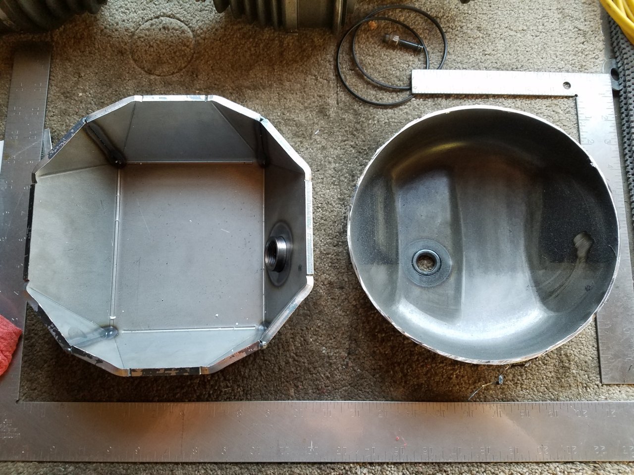

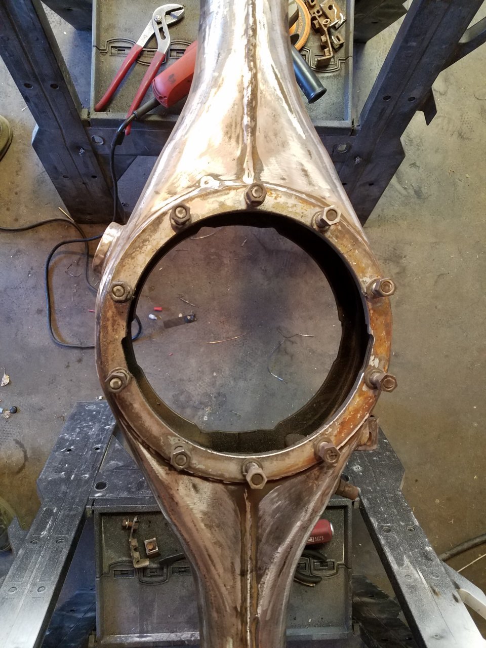

  14. Jul 19, 2018 at 2:41 PM
    #214
    Jiveydude
    Oct 22, 2013
    #115035
    1,324
    Micah
    OH
    04Taco
    Got the doner axle cleaned up and decided that I might as well add some beef to it.
    Cut the weak point off.
    Quarterpounder with cheese vs the kiddy meal.
    Should be much stronger.
    Now for the weld and cool down wait, would hate to warp up another one.

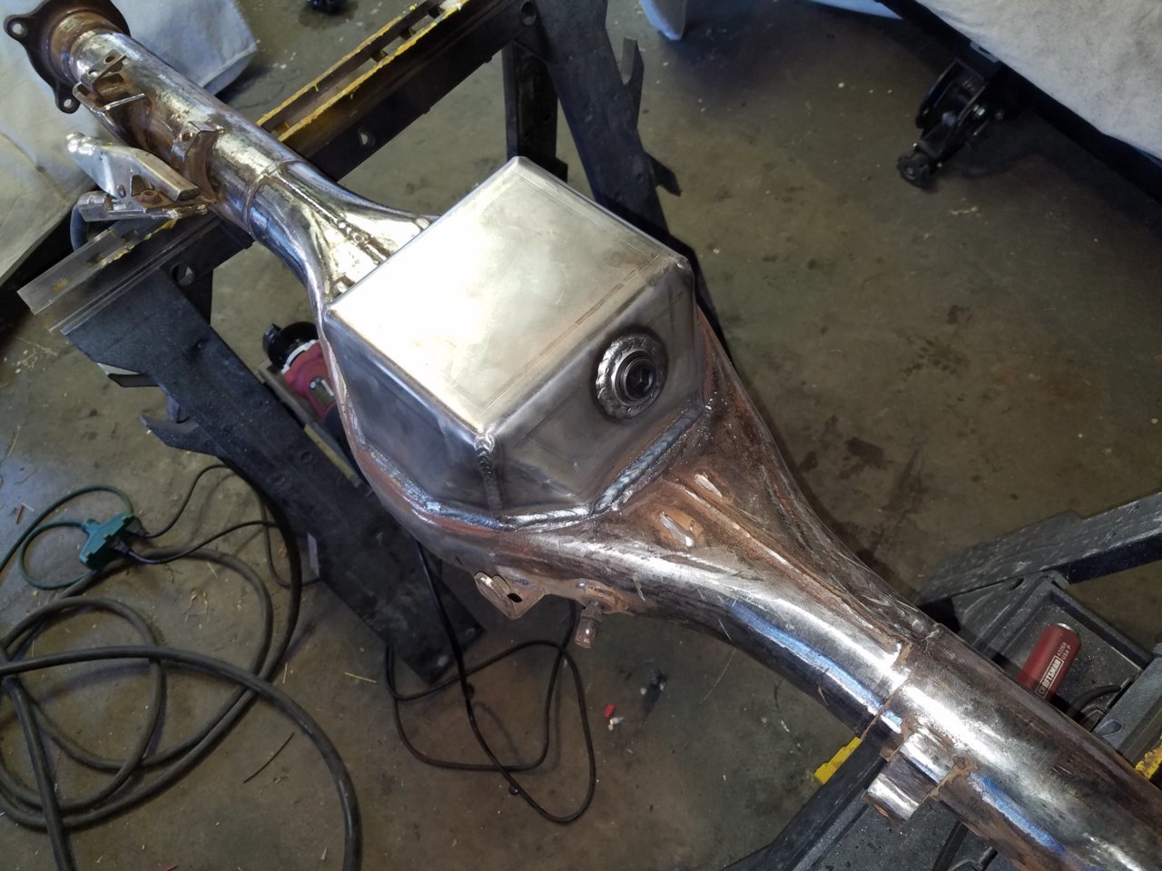

  15. Jul 19, 2018 at 5:53 PM
    #215
    Jiveydude
    Oct 22, 2013
    #115035
    1,324
    Micah
    OH
    04Taco

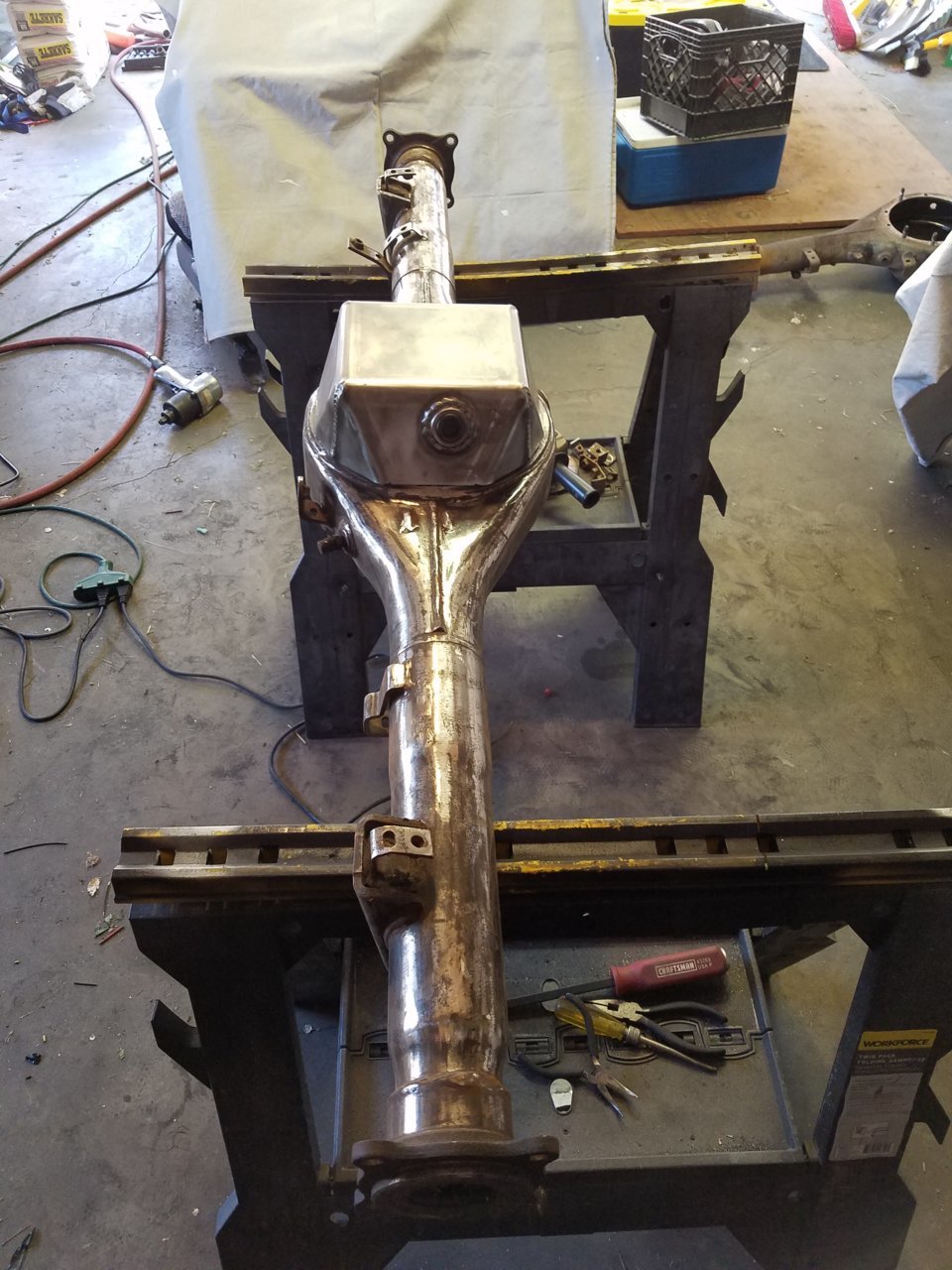

    All melted up, feels like I just welded a lunch box to my rear end.
    And some cycling for better shock placement.

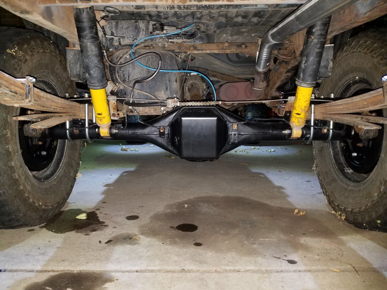

  17. Jul 29, 2018 at 10:24 PM
    #217
    Jiveydude
    Oct 22, 2013
    #115035
    1,324
    Micah
    OH
    04Taco
    She's on her own feet again.

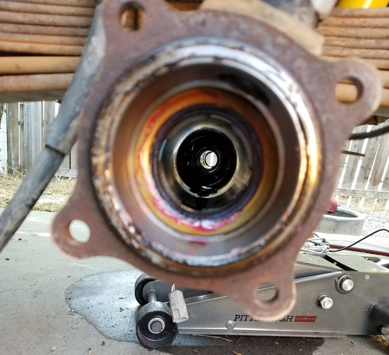

  18. Aug 13, 2018 at 3:16 PM
    #218
    Jiveydude
    Oct 22, 2013
    #115035
    1,324
    Micah
    OH
    04Taco

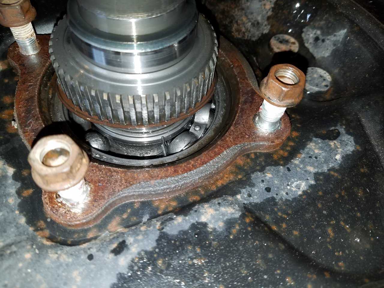

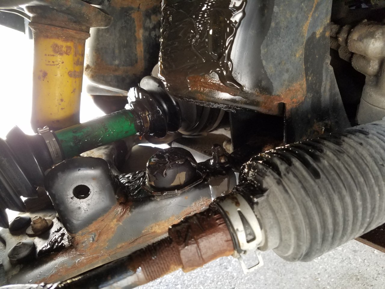

    Was going to install some of @Plastics Guy's bump stops and found this mess today...
    Looks like I'll be rebooting my axles this weekend instead of fishing.

  19. Aug 13, 2018 at 7:03 PM
    #219
    DJB1
    Jun 8, 2013
    #105835
    2,223
    Dave
    SLC, UT
    There should be a "Dislike" for that.
  20. Aug 13, 2018 at 8:00 PM
    #220
    Jiveydude
    Oct 22, 2013
    #115035
    1,324
    Micah
    OH
    04Taco
    I concur
