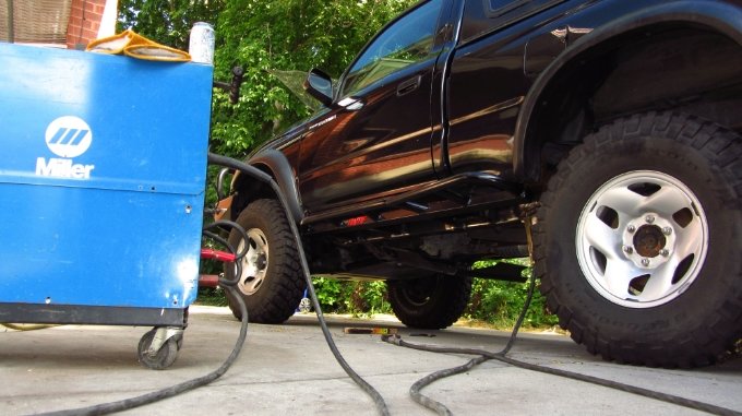

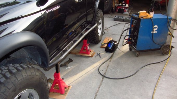

    Welded on my BAMF sliders a few weeks ago, here are some pics.
    Straight from the factory.

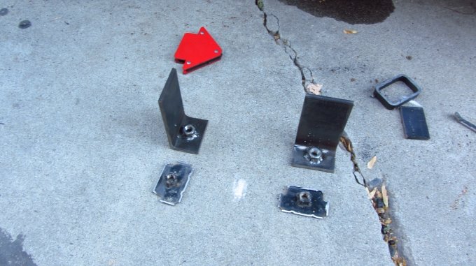

    Tacking on the frame plates and gussets.

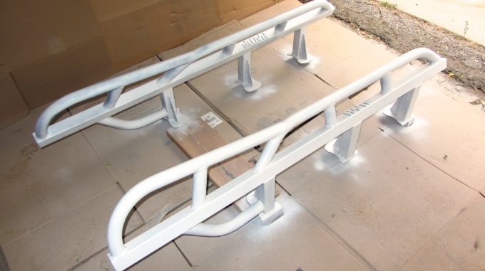

    A couple coats of primer.

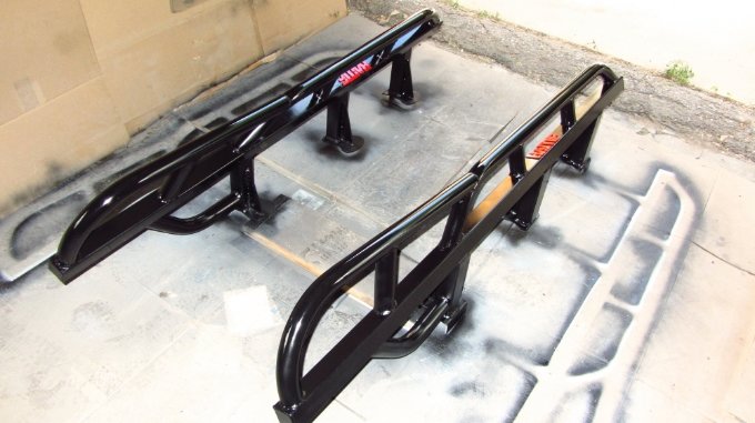

    A couple coats of black with a splash of red.
    Then the permanent attachment.

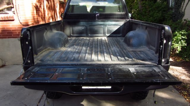

    Got quite a few things done over the past few days.

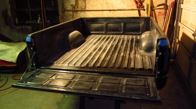

    First, took the plastic liner out of the bed.

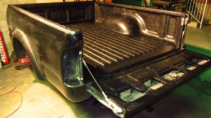

    Then took the bed off and prepped it for some rubberized liner.
    Rolled on a few coats.

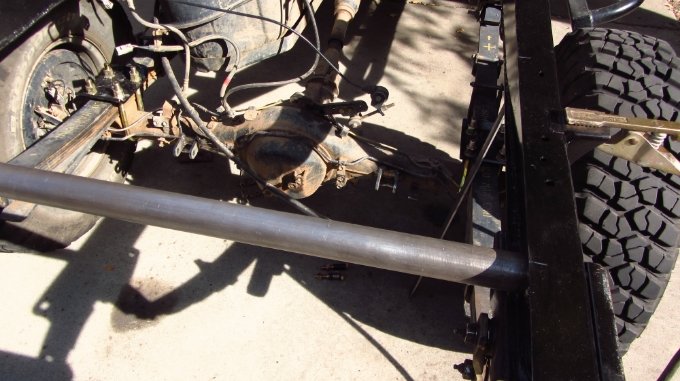

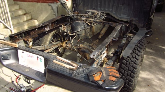

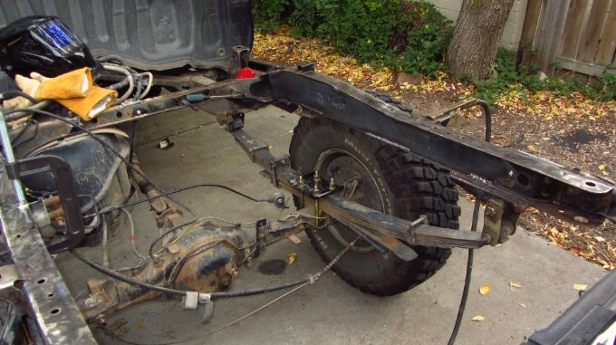

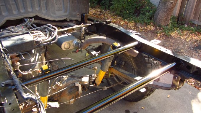

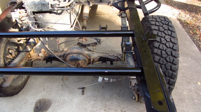

    Yanked out the spare tire carrier, cut off the upper shock mounts, removed the lowers with the axle brackets, sized up some frame plates and installed a Marlin flip kit.
    Boxing the Frame.
    Melted some new lower shock mounts to the axle and added a rear crossmember.
    Upper shock mounts and another crossmember.
    A few coats of overnight paint.

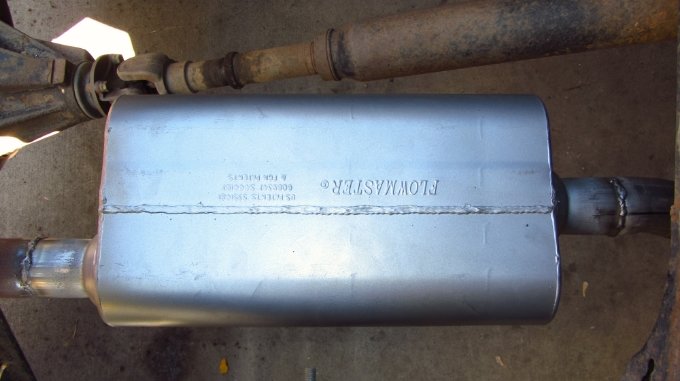

    Added a Flowmaster Delta Flow 50 series. It was quite fun welding with .035 in the wind on exhaust pipe. Ugly welds but no leaks, so whatever.
    All buttoned up although, I might add some new exhaust pipe later.

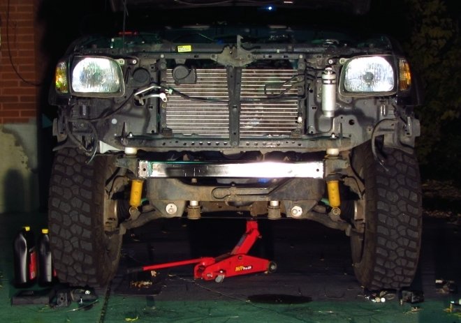

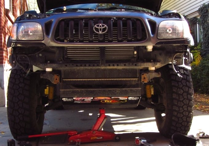

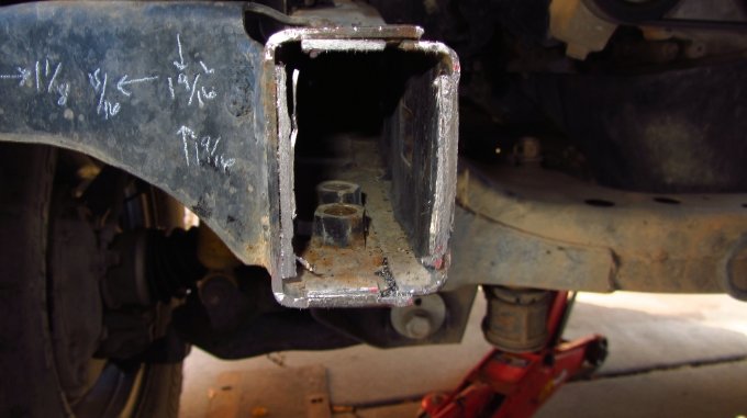

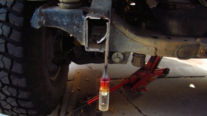

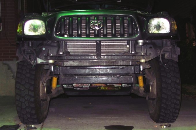

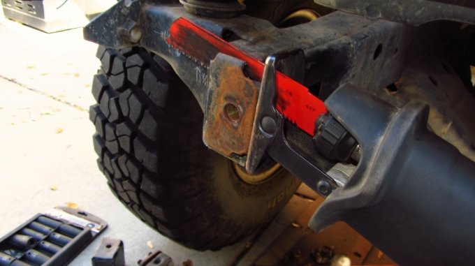

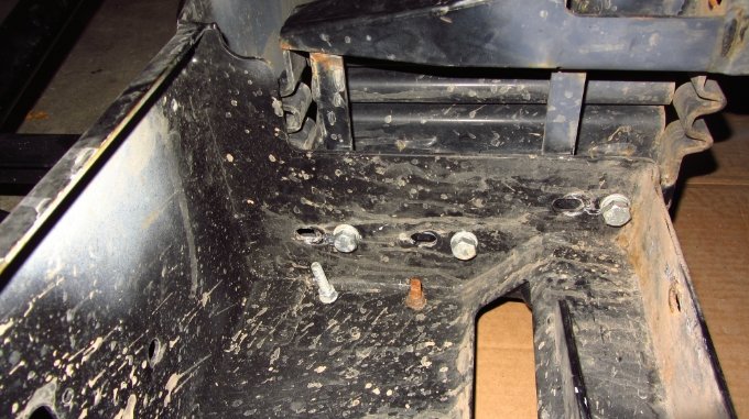

    Started by taking off the front bumper to get to the end caps.
    Cut those weak bastards off.
    While I had access, I added some more spot welds to these bolts,
    and cleaned up the area for the new angle iron.
    Welded some high grade nuts to the back of the new metal.
    Old vs. new.
    Angle welded in and a few rosettes added on the side.
    Then welded in a new crossmember in the dark.
    Ready for the bumper to go back on.
    But first...

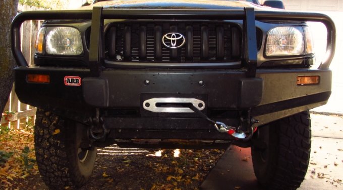

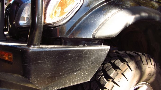

    The body lift that I installed a while back left a pretty big gap to the bumper.
    So I drilled out some new bolt locations to lift it back up.
    Voila, no more gap.

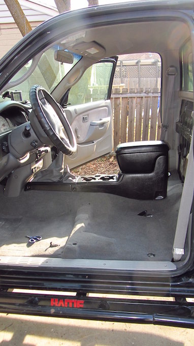

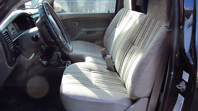

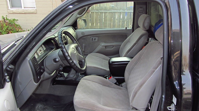

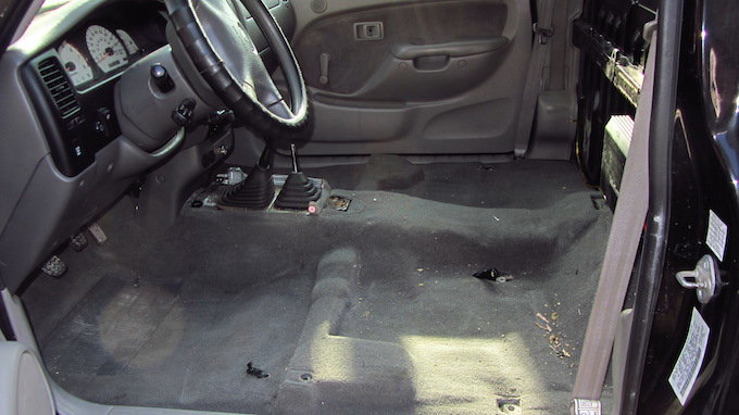

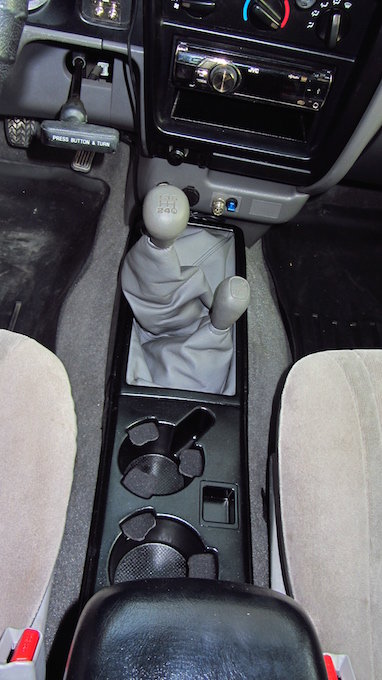

    Finally tracked down all the parts I needed to swap out the seats.
    Goodbye bench, you will be missed.
    Everything out.
    Hello storage space.
    All finished.
    LostHusker, hoverlover and H3llRid3r like this.

    stock
    Looks great, i so want to get rid of my bench seat, what did you get your seats/ center console out of?
  15. Mar 4, 2015 at 9:53 AM
    #35
    Jiveydude
    Jiveydude [OP] Well-Known Member
    Oct 22, 2013
    #115035
    1,324
    Micah
    OH
    04Taco
    Stuff and things that make it better.
    I got the seats off a local classified for $30.00 and the console off eBay for around $70.00. The seatbelts (female ends) I had to buy new, I think they were $30.00 each. It took quite a few months of searching with the elusive console taking the longest, I got super lucky and was bidding on another one when a buy it now one popped up for way cheaper.
