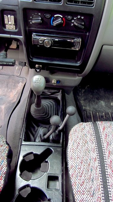

    dang man! hopefully that insurance check will fund a bad ass rear swing out set up for you. can you elaborate your twin stick set up??

    The twin-stick allows me to keep it in low while switching from 4WD to 2WD, pretty useless unless you're trying to turn sharply with the front locker engaged and need a tighter radius turn or don't want to blow out your CV's :spy:

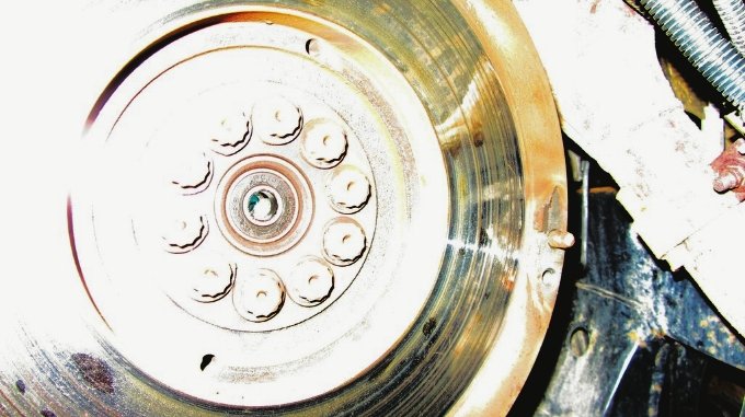

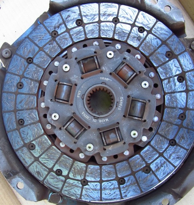

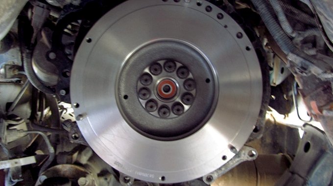

    Replaced the clutch and it feels like a new truck :D
    The old flywheel (flash on for a better view of the burnt and scored shityness :rolleyes:)
    The culprit for why all this had to happen
    New hotness
    And a pic of the sticks installed for shits and giggles

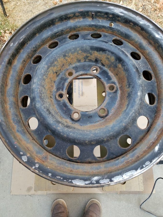

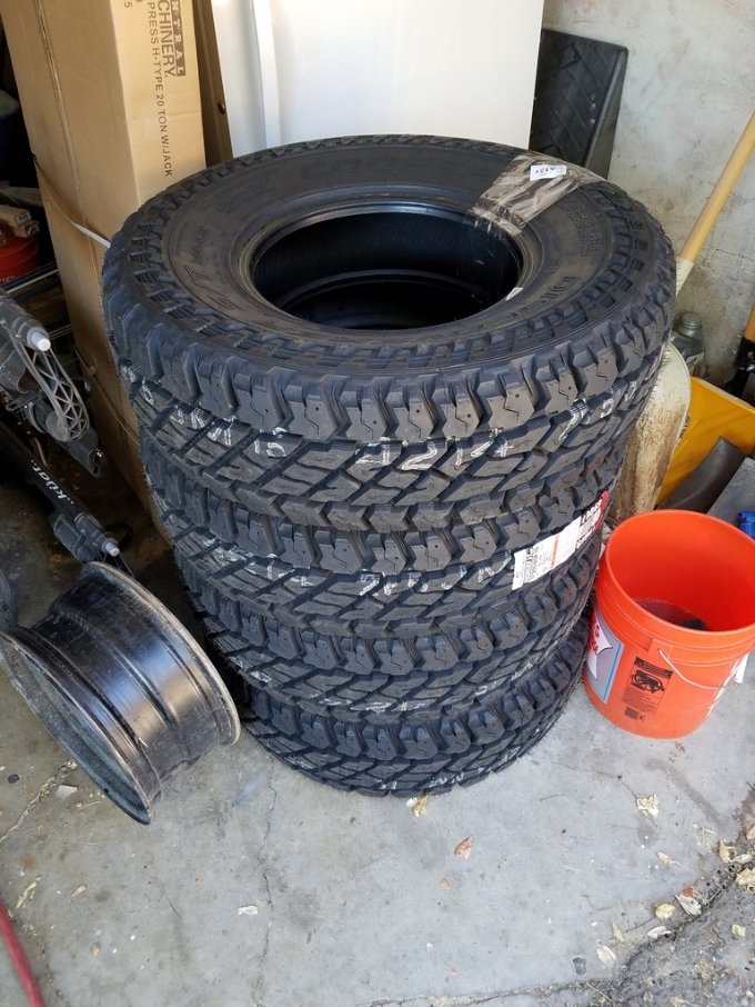

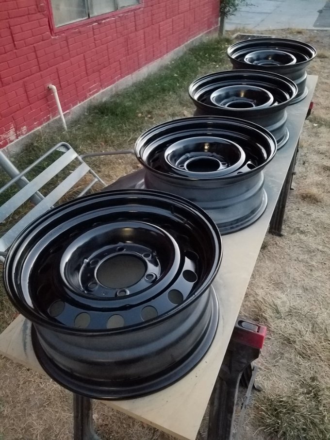

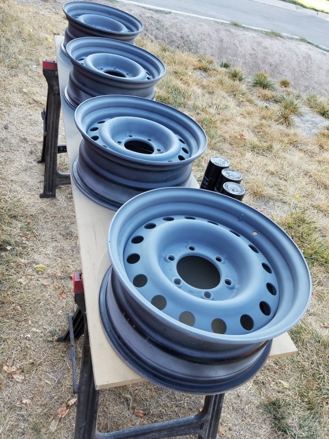

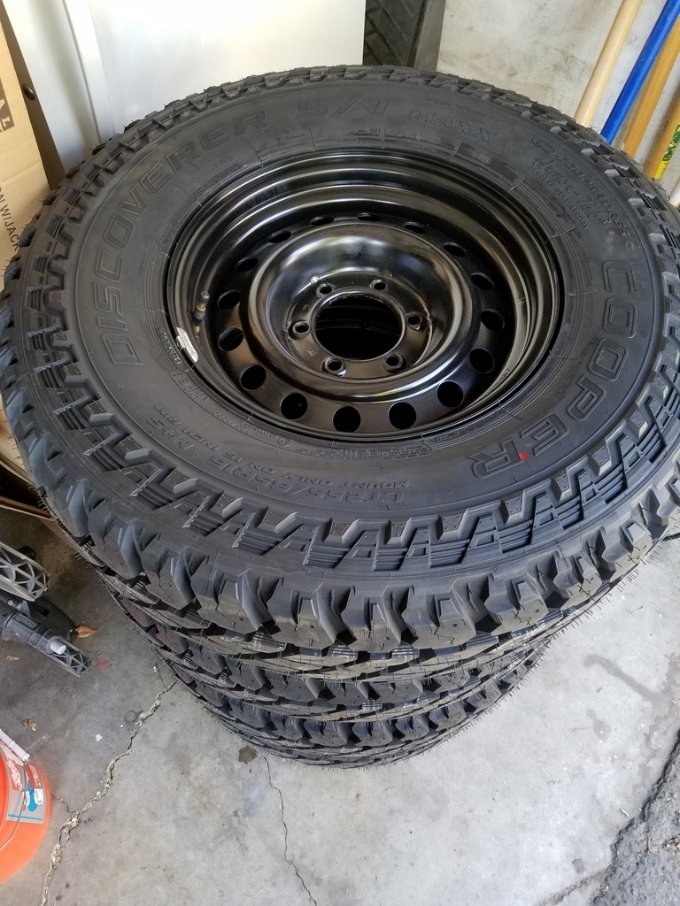

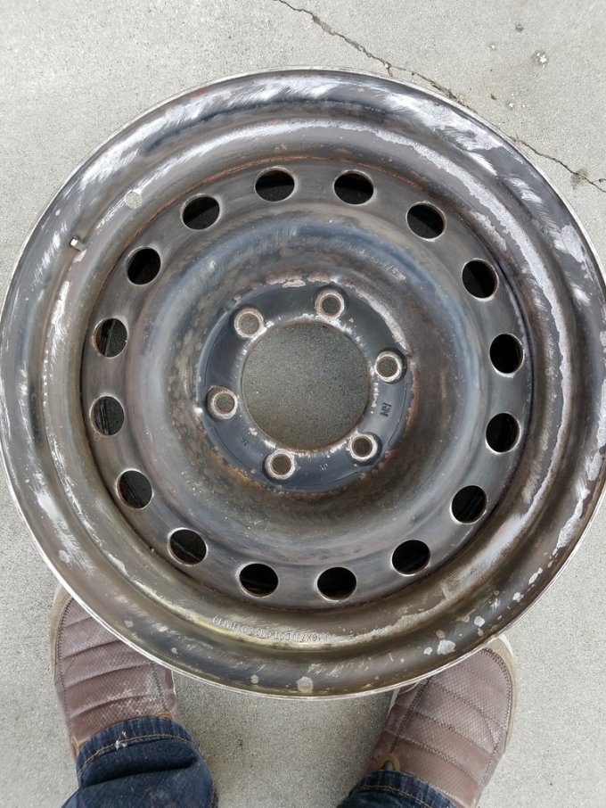

    So waiting 4 months to get an alignment wasn't a smart move, I probably wasted a couple thousand miles off the current tires. But, that brings me to these:
    Going with Cooper S/T Maxx this time, hopefully they are better in the winter than the hockey puck KM2's. I also picked up the elusive fourth steely, it was pretty rusty but with some grinding and a little use of the HF sand/forearm blaster it cleaned up ok.
    After some primer, paint, mounting and balancing they'll be ready to go on after the alignment tomorrow :rolleyes: just in time for some weekend fishing.

    those rims are magical, looks awesome dude.

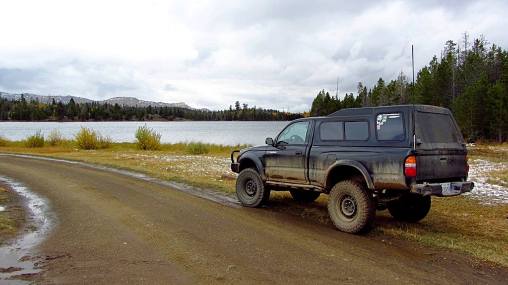

    pic with the tires on
