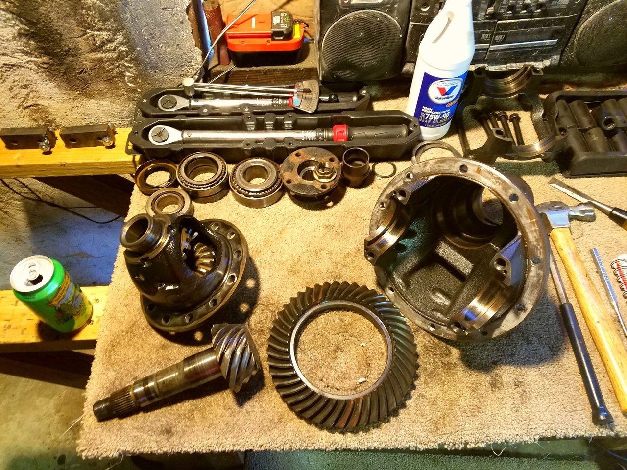

    Used 3.58 diff torn down.

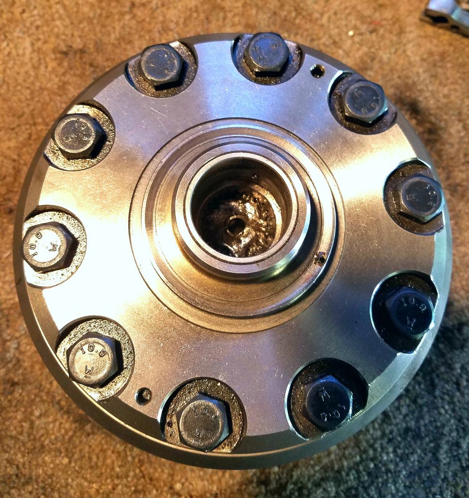

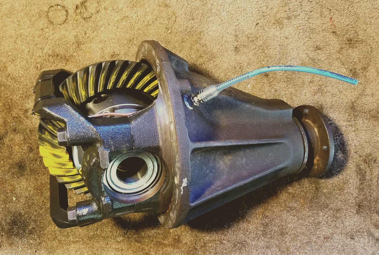

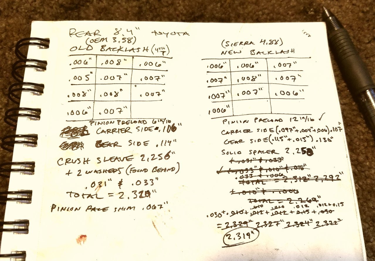

    Finished the rear.
    Notes for posterity
    Now on to the front...

    Nice! I'd like to tackle a spare diff I have. Was this your first? Got any tips?
    Did you use solid spacers or crush sleeve?
    I tried about 15 years ago while installing an ARB. It didn't end well, but now I'm older and smarter (and have more tools)...
    Jiveydude[OP] likes this.
  7. Oct 17, 2017 at 8:00 PM
    #167
    Jiveydude
    Jiveydude [OP] Well-Known Member
    Oct 22, 2013
    #115035
    1,324
    Micah
    OH
    04Taco
    Stuff and things that make it better.
    Pretty straight forward gear change. This was my first toyota but ive done a few Ford's. Great website for info on Toyota diffs: www.gearinstalls.com @ZUK know's his shit. Couldn't of done it without his expertise.
    I used a solid spacer, that part took the longest. I finally was able to get a decent cbpl after tearing it down about 10 times. Having the right tools makes a world of difference ;)

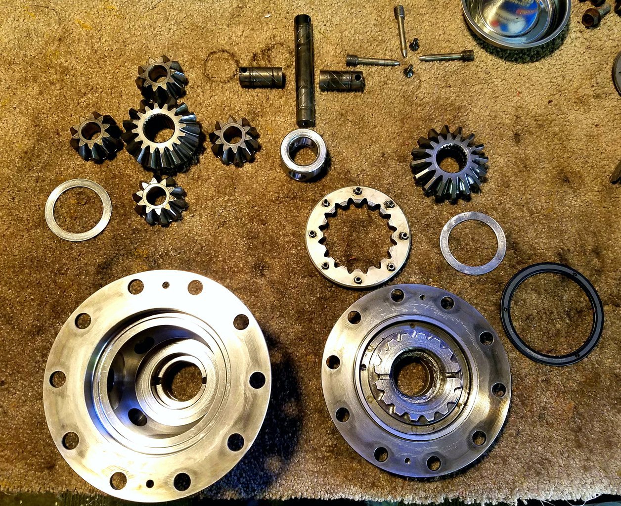

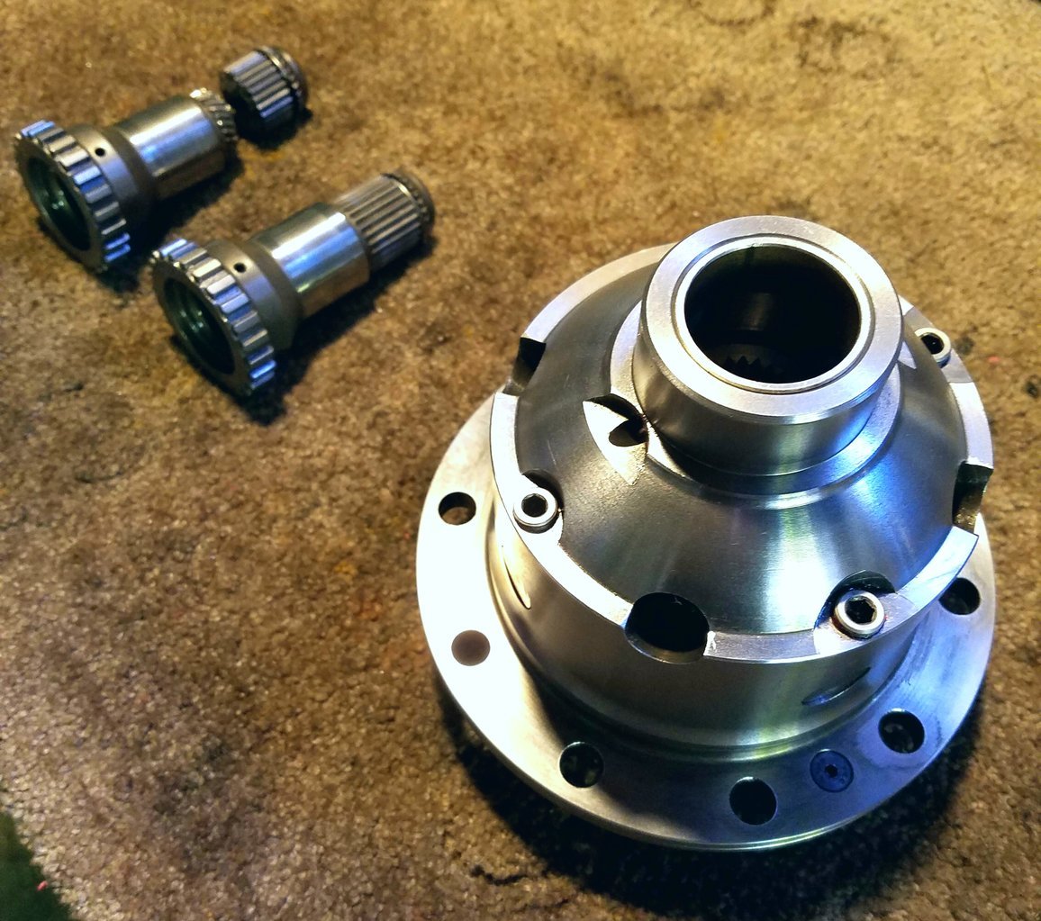

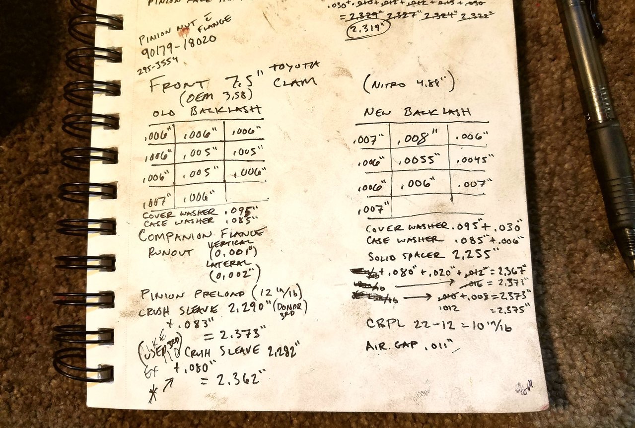

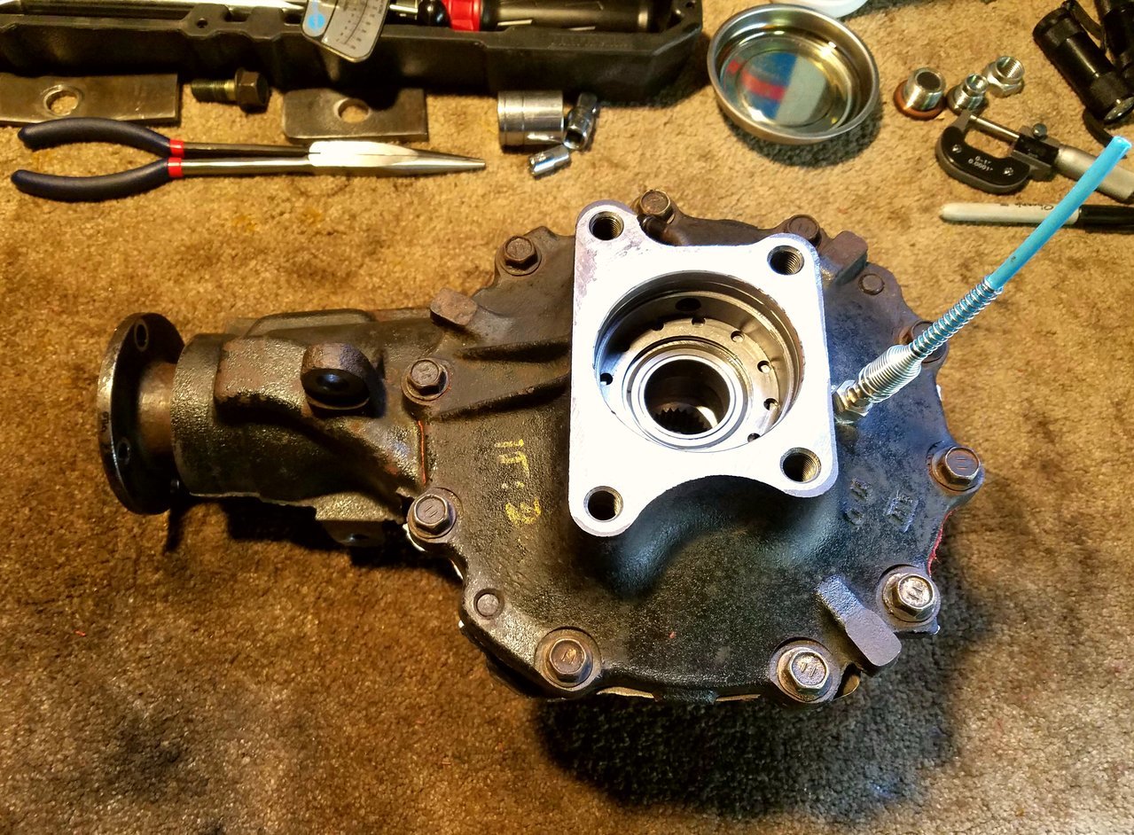

    Front is done!
    More notes.

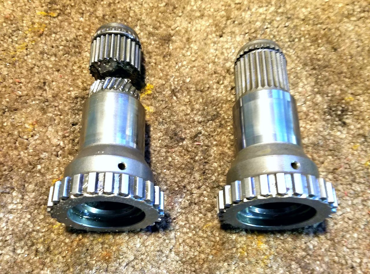

    Total pain in the ass, could of used a bigger selection of shims but the main issue (also why the locker only cost the price of the gears) was the carnage of the broken stub shaft.
    Had to break the whole thing down to get the shaft out and to clean up all the metal bits.
    Shit vs new.
    It did some internal damage but the good folks up at ARB said I should be fine, so I'm crossing my fingers.

    Got everything in today, it all works and no leaks. Can't really say how the power has changed yet as I've been driving like a grandpa for the break in period. I can tell that my shifting pattern is different, much quicker to 3rd.
