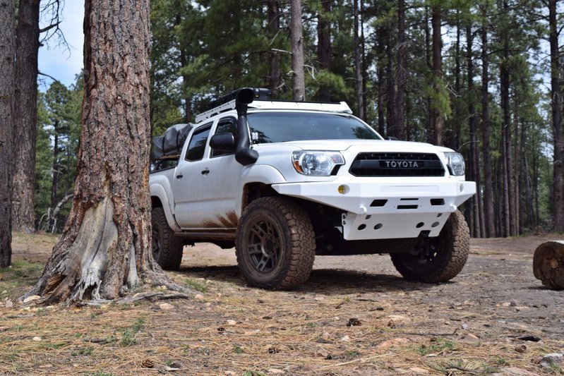

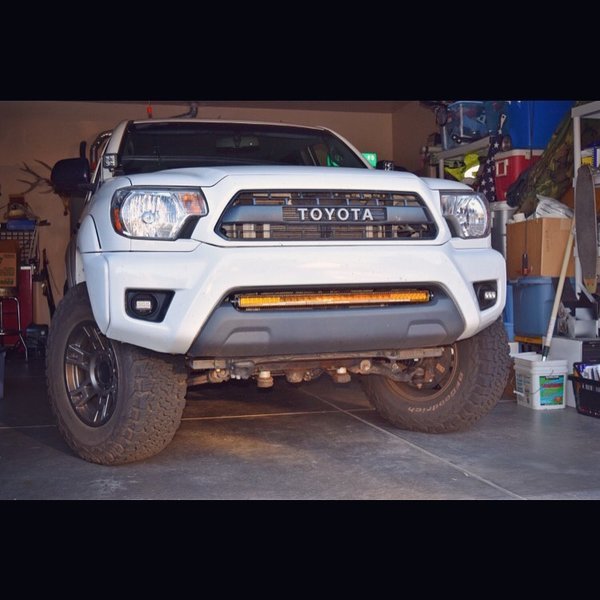

    Cody's 2013 Super White DCSB Tacoma OFF-ROAD
    V6/6-Speed/4x4/TRD Supercharger
    -the beginning to a never ending project-
    Most recent pics I have
    5/5/16
    Photos taken on 08/07/2015 the day I got it from the dealer
    truck had 21,521 miles on it
    Powertrain | Drivetrain Mods
    • TRD supercharger
    • TRD Cat back
    • TRD short throw shifter
    • Air Flow Snorkel
    Suspension
    • Icon 2.5 Remote Reservoir Extended Travel Coilovers
    • Dirt King Tubular UCA's
    Wheels | Tires
    • 285/70/17 BFG KO2
    • Bronze 17" FN FX-Pro
    ARMOR
    Exterior | Lighting Mods
    Interior | Electronic Mods
    • Weather-Tech Digital floor-mats
    • @csjumper2003 LED map/dome lights
    • 15% tint on rear windows
    • 30% tint on front 2
    • @Coupe shift knob
    • @csjumper2003 vanity LED lights
    Camping Gear
    @GEOADVENTUREGEAR G-165 RTT

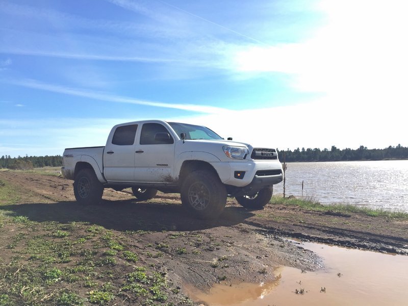

    image.jpg What all trimming had to be done to fit those tires? I'm running Method double standard wheels. I've got 265/75/16s now and just trying to research what it would take to move up. I'm running a three inch lift. Also what are your wheel specs as far as backspacing and offset?

    So method is pretty much always a
    4.75 backspace
    0 offsett
    (which mine is this)
    There is 0 trimming done other that the removal of my front mud flaps
    I have a slight rub when the wheel is cranked left or right an I'm pulling in/backing out of a driveway,other than that it's all good

    That's awesome. That definitely makes me want to give the 285/76/16s a try. Thanks for the info man. I was told my wheels had a 4.5 inch backspacing.

    Are you running just a 2.5 inch spacer lift with stock UCAS?

    Correct everything is stock under there besides the spacer!
