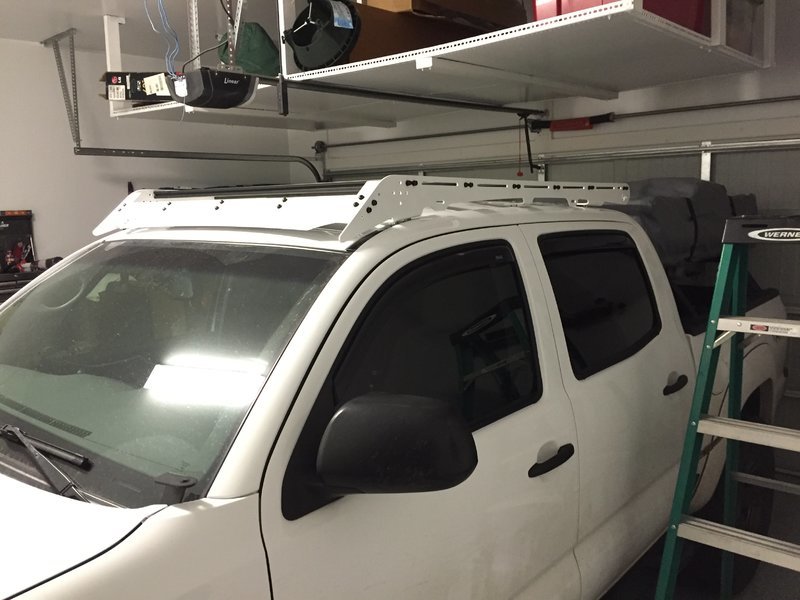

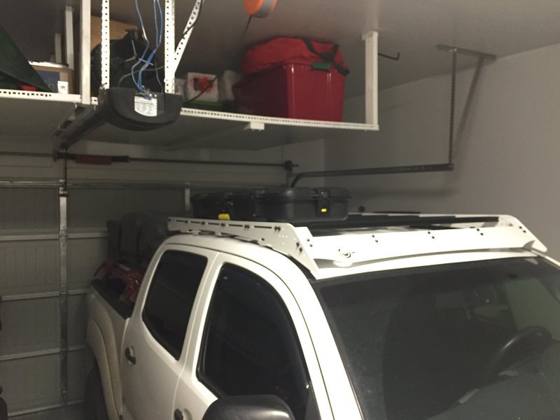

    Got the Prisnu rack mounted up finally!
    Decided to go color matched. I love it!
    I need to get a lightbar mounted though. She hums pretty loud without it image.jpg

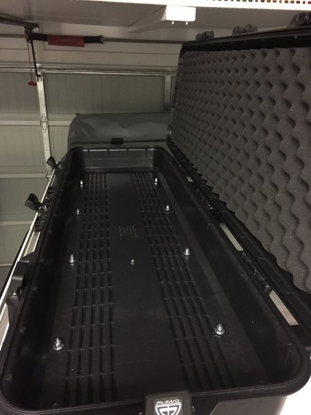

    Also mounted up my Plano case! I prob went overkill with how many bolts I threw on it but oh well shit won't move.

    uuuuggggh.. it hums because 1) you need to lower the front deflector down to the roof, and 2) you need the weatherstripping on said deflectors lip. the weatherstrip actually creates a seal between deflector and roof.
    ChadsPride likes this.
  16. Feb 28, 2017 at 8:35 PM
    #456
    StOrMyThEtAcO
    StOrMyThEtAcO [OP] @stormythetaco
    Mar 23, 2015
    #151561
    7,411
    Cody
    CO
    18 TRD Sport mom bus
    All of them
    Two very strong points!
    Yeahh I wasnt sure if it would clear on the lowest but I saw one the other day that was all the way down so I'll do that an order the weather stripping too from him.

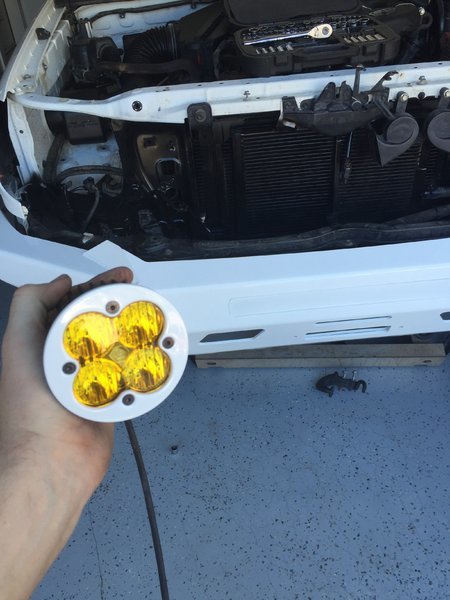

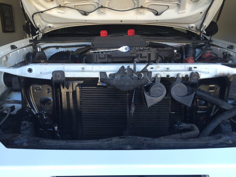

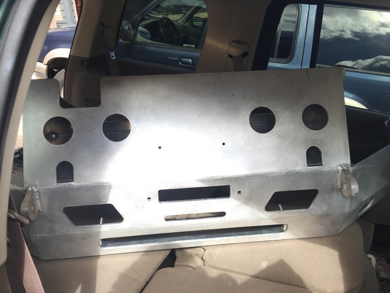

    So lots of updates to come to this thing, been a bumpy 2 months with the truck I thought that I was going to dump it after a cylinder 6 misfire. I attempted to fix it myself so I replaced all 6 spark plugs and all 6 ignition coils, put the truck back together and still misfiring. So after almost 2 moths sitting in the garage I decided it was beyond my ability to fix and to the dealer it went. Turned out to be a minor issue the dealer ended up fixing it and eating the cost to do all the tests!
    The issue was internal on the supercharger. An O-ring had failed allowing the intercooler so slowly leak into the cylinder. It was small amounts but significant enough to cause an issue.

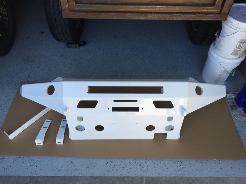

    Now for the good stuff! while the truck was down i received some goodies. My aluminum @Pelfreybilt bumper came in and I immediately took it to the powder-coater to get it coated
    Here it is in the wife's car heading to the PC
    got it back a few days looking BEAUTIFUL!!

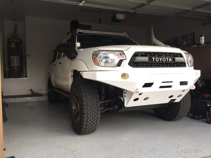

    Before mounting the bumper i painted all the components behind the grill/bumper black for a sleeker look
    i also had the Baja Designs lights color matched to the bumper :D
    bumpers all mounted up!

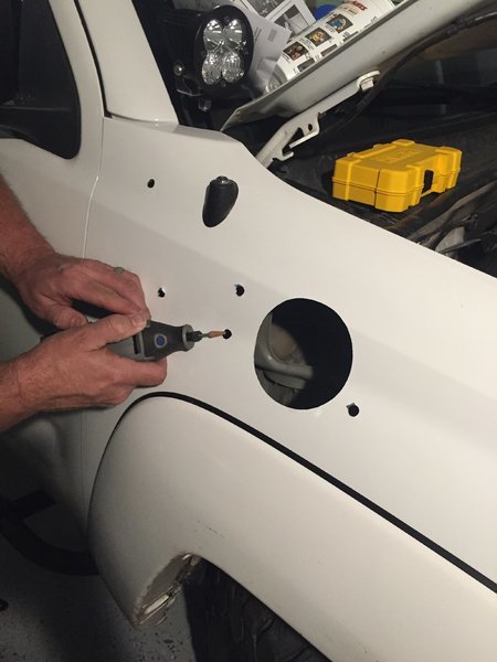

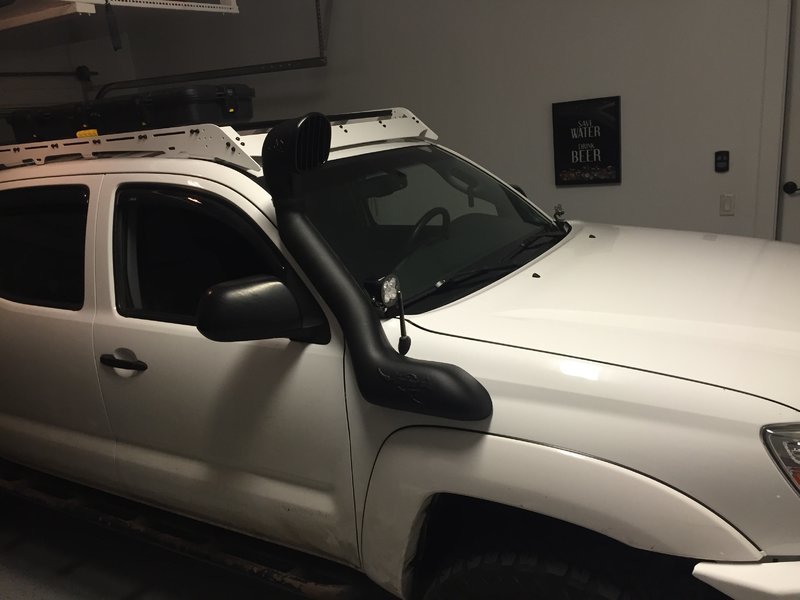

    Next was the Air Flow Snorkel!
    And finally all of it together
