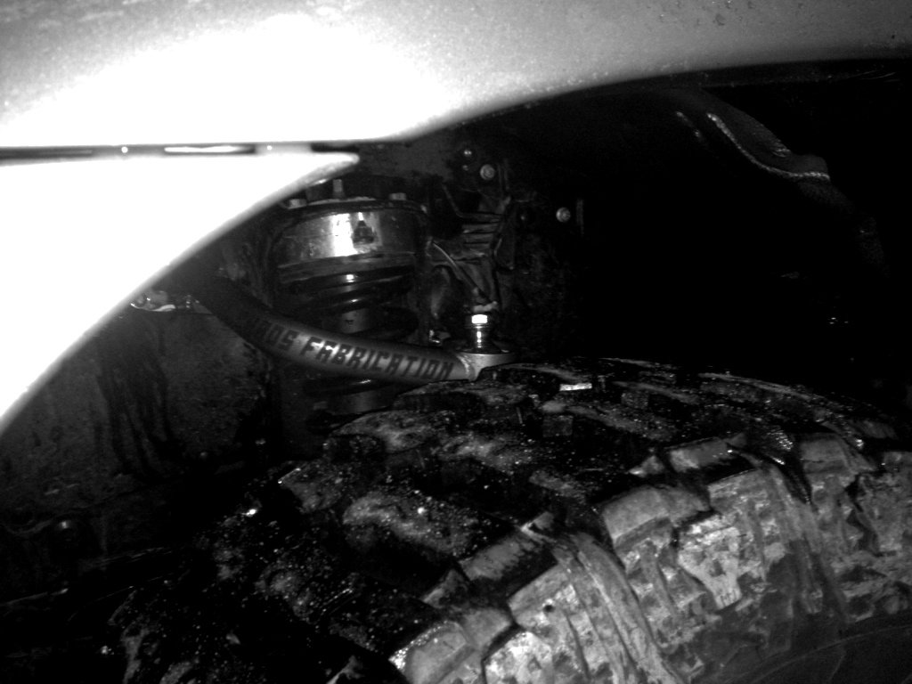

    Just a few little things. It's my DD
    Shit I love my spacers and I don't get the stupid "bro lean"
