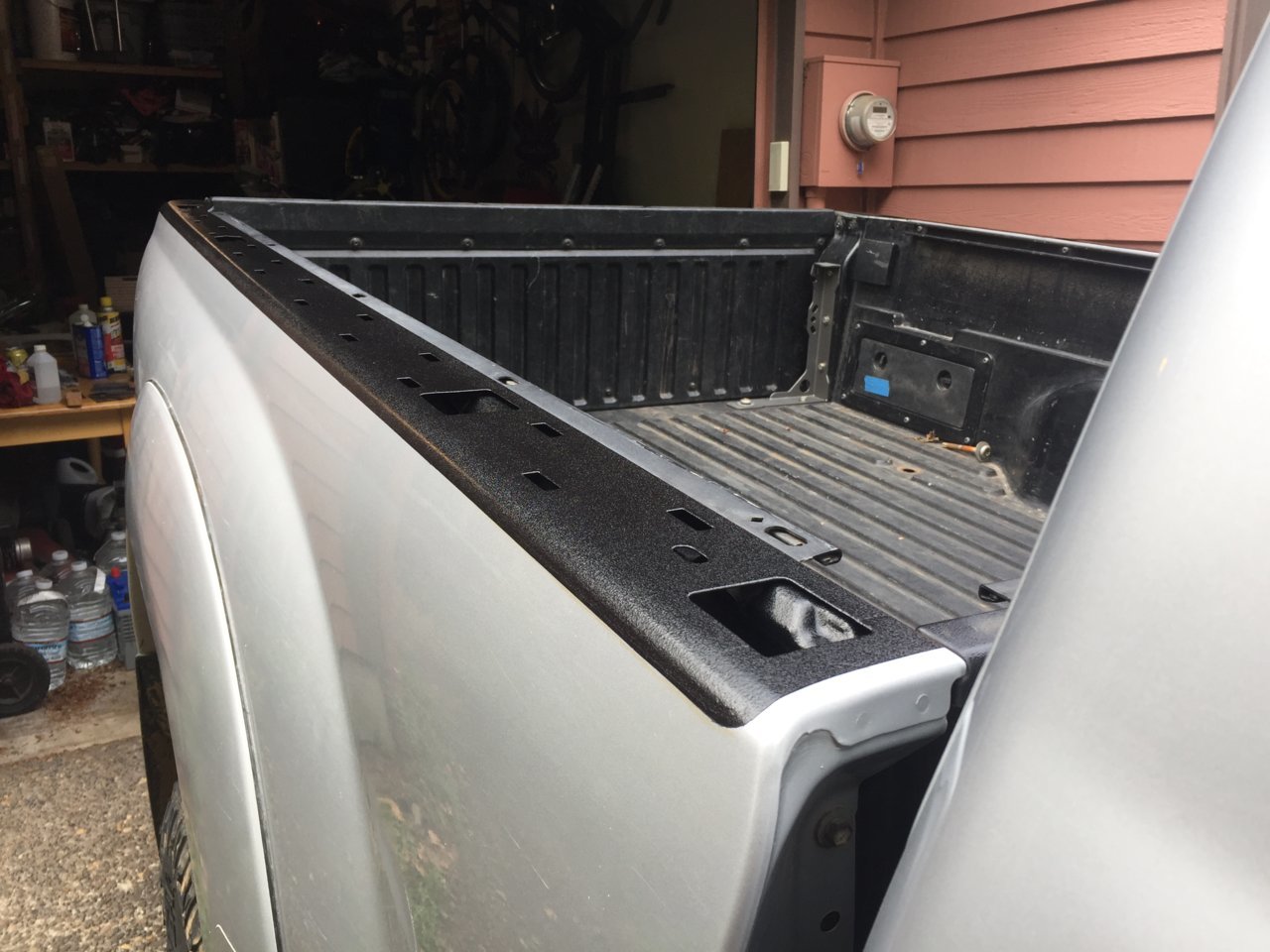

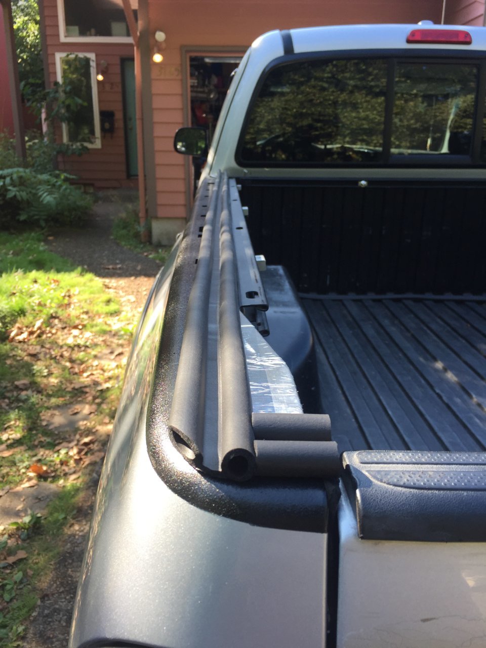

    With all the bed rail sealing talk here is what I did l on my 2nd gen. Ditched the plastic caps, spray bedlined my rails (to cover all the gouges in my paint from 8 years with a fiberglass shell and the plastic caps in place), layer of butyl window flashing tape to cover all the holes, then bulb seals on top. I hear the 3rd gen plastic caps aren’t as stupidly designed as 2nd gens but don’t have any experience with them.

    Does that compress well with the weight of the shell?

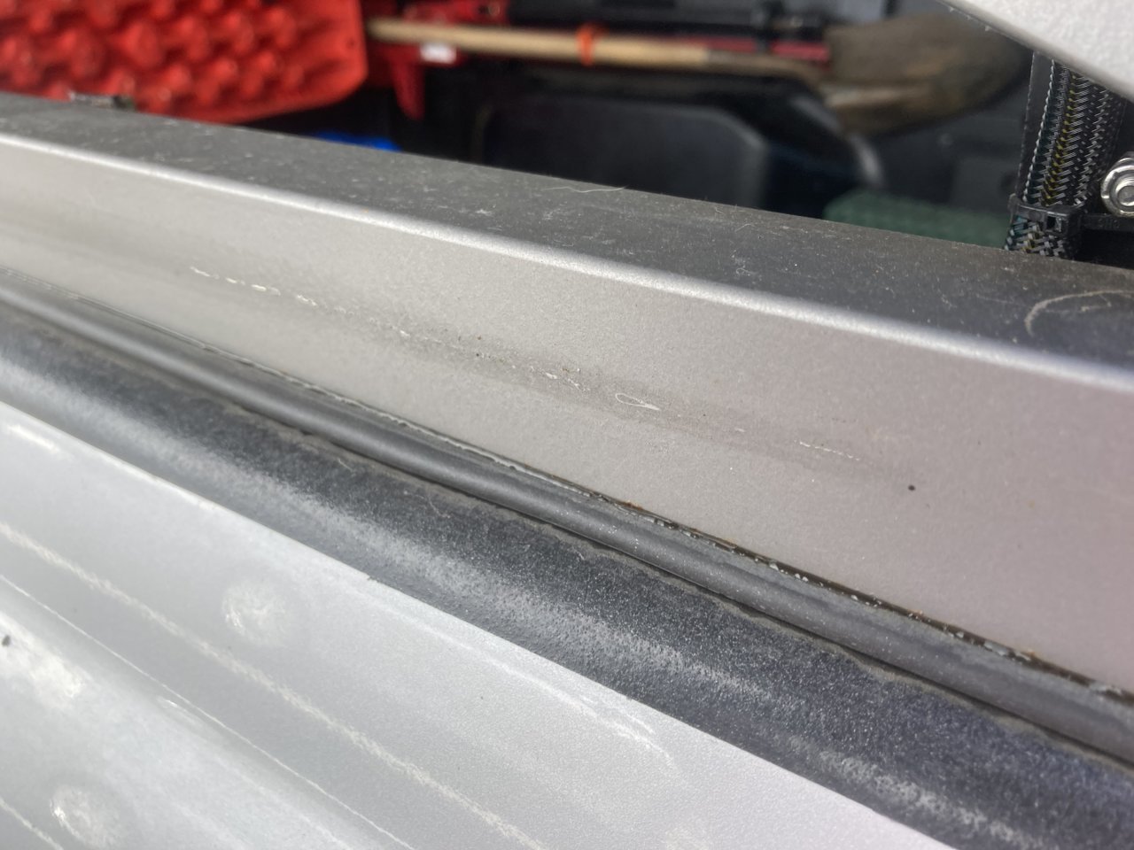

    compresses great. It’s a foam double bulb seal.
    https://www.mcmaster.com/93085K92/
    And just to clarify I’m using it with a steel framed wedge camper so alittle different but same idea.

    I feel ya. I seriously regret only putting one coat of paint on the frame of my wedge camper because I ran out and didn’t wanna wait for more steel it to ship.
    I’m just letting it rust in a few spots until I muster up the motivation to pull it off and re-spray sometime this summer. Realistically I’ll probably procrastinate until the fall and then rush to get it done right before the rain shows back up.
