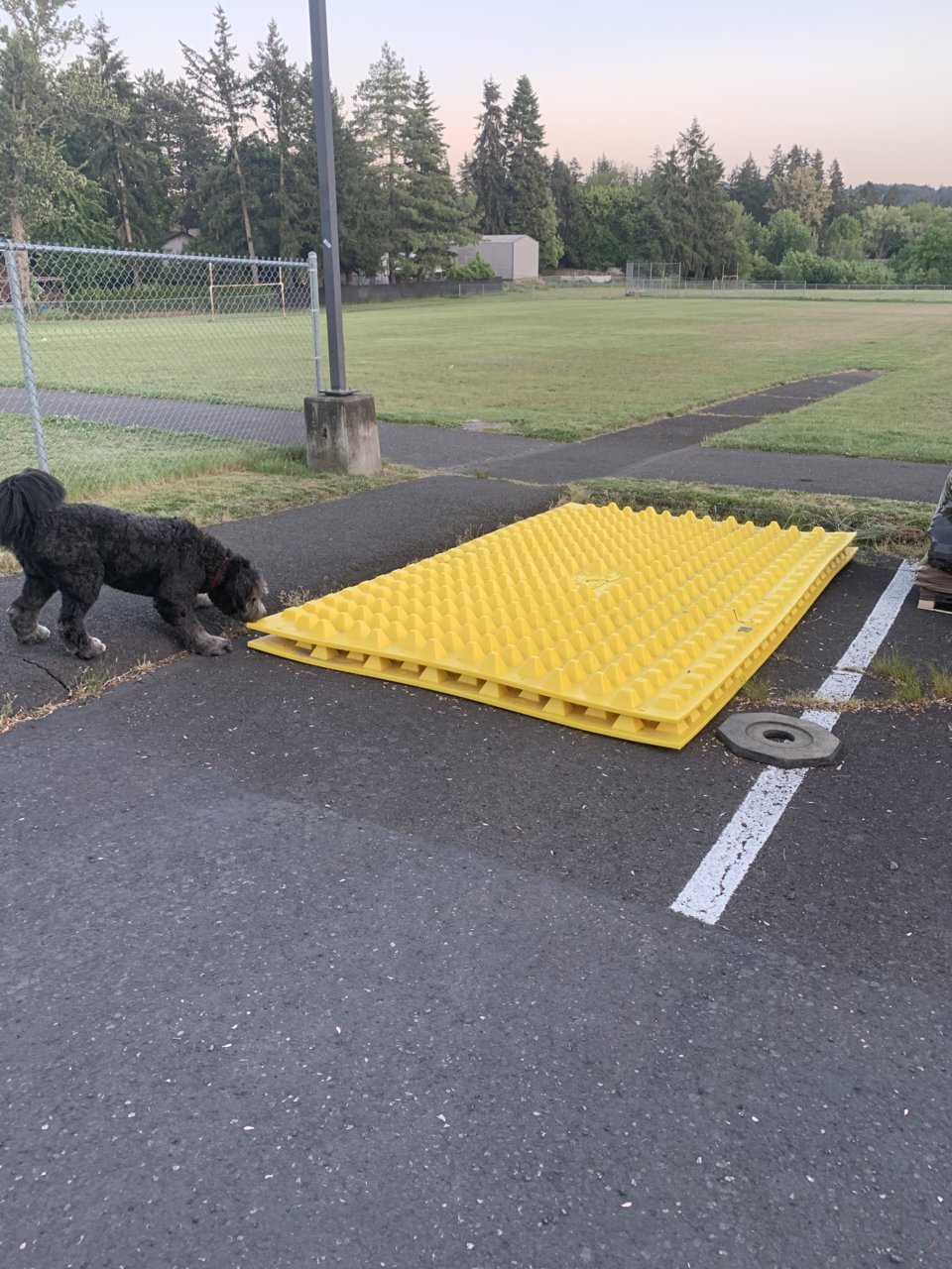

    Anybody need some maxtrax? Found some up the roadA17583ED-E49A-410E-B0C9-5A542E490C70.jpg

    What size?

    OOOH! cut them into snowshoes and you'll be a hero!

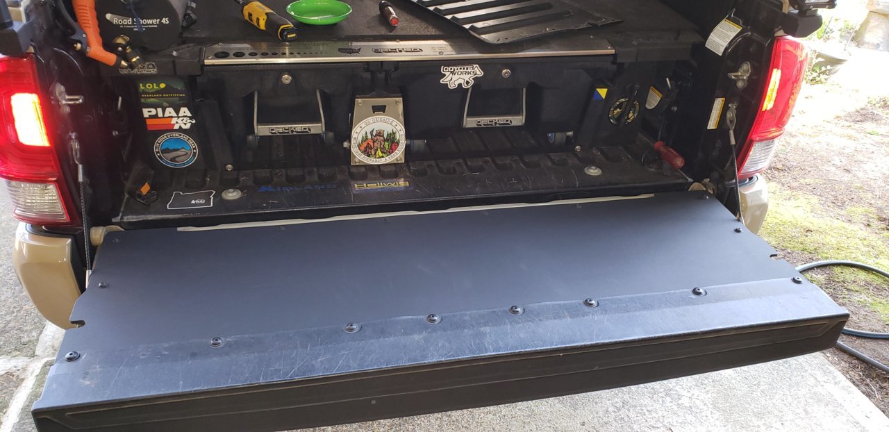

    Picked up a sheet of HDPE from Tap plastics. Really happy with this flat surface tailgate panel.

    Nice! Any details on the install and exact product? Been wanting something like this, but only see white boards. I’m sure there is a thread...lol

    I used 1/4" marine grade "King starboard" HDPE plastic from Tap Plastics. https://www.tapplastics.com/product/plastics/cut_to_size_plastic/king_starboard/526 Cost me $50 for the plastic. You can get it in a few colors. I just pulled off the ribbed panel and traced it out. Cut it out with a jig saw, and cleaned up the edges with a file and sandpaper. There is a thread for details. You have to cut around a bump, and shave the bump stops. But it was a fun easy Saturday morning project.

    Sorry, 265/75 16

    Thanks! Nice work!

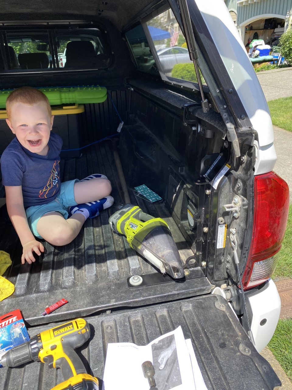

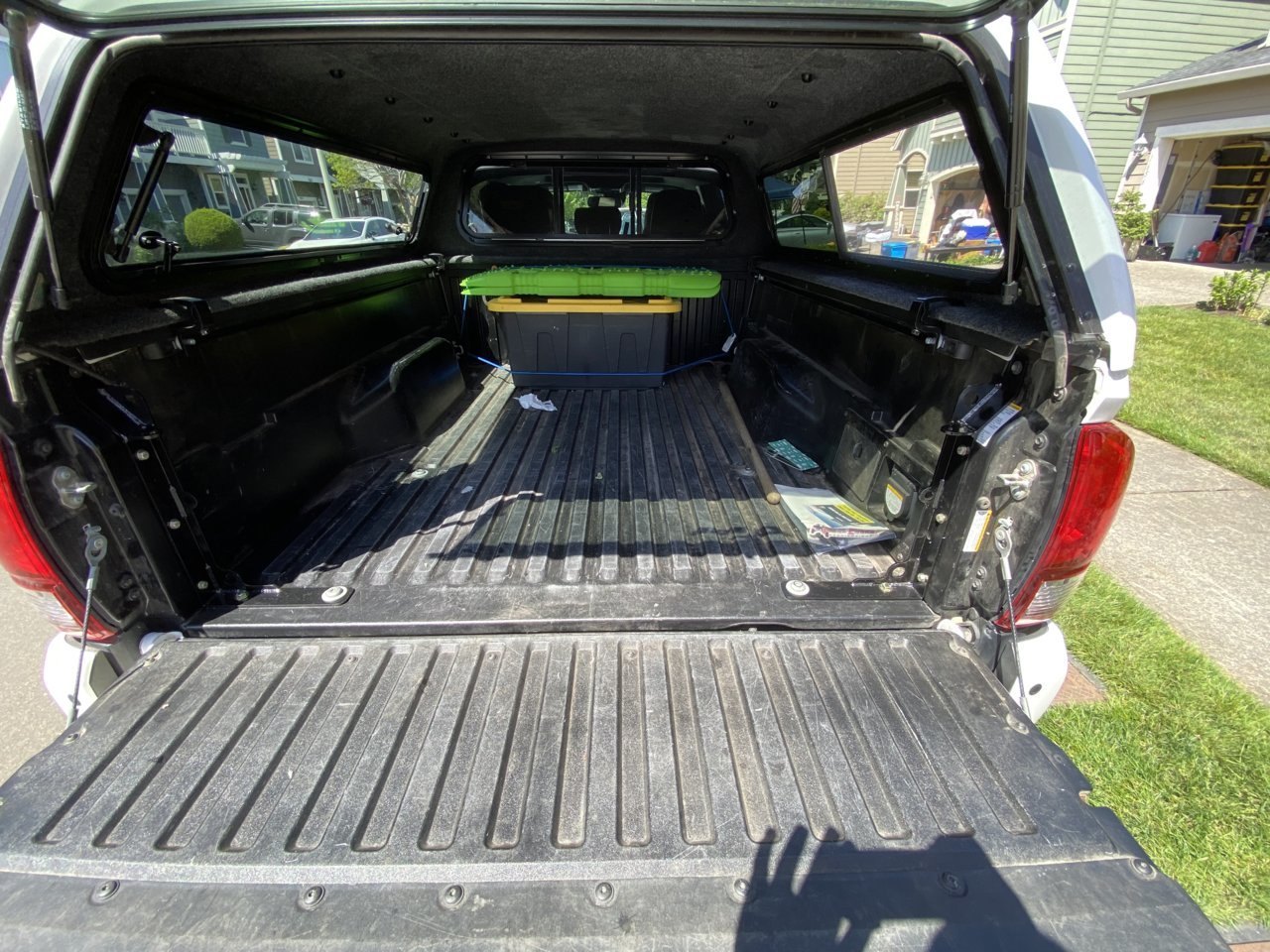

    With some help from my son; got the bed stiffeners installed. Pretty fun install. But this made me realize how nice a flat tailgate surface would have been.
