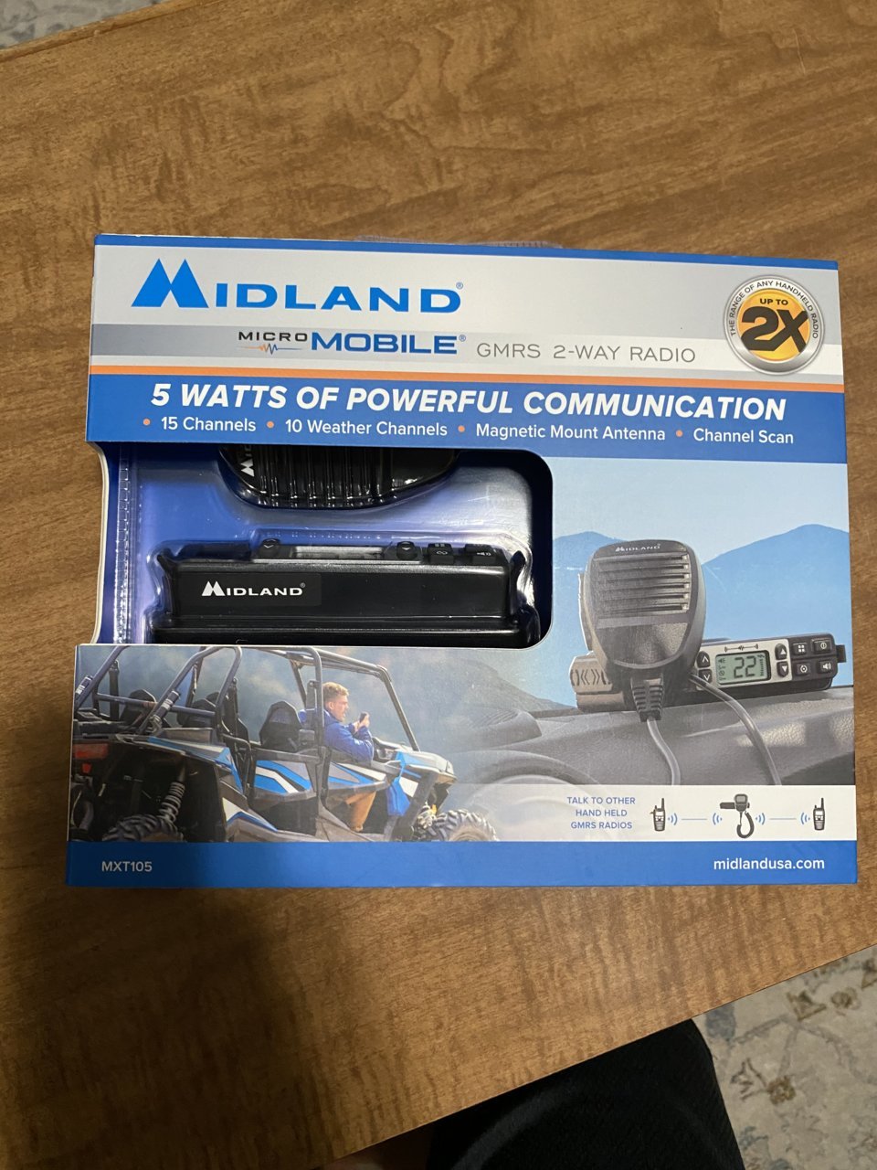

    Going to give this a try. Anyone in here ever use one or something similar? If it’s a good fit, then the license is next. Thanks.

    Did you ever get one of these installed and tested out?

    I was about to tag him, but I see you beat me to it. I think he was using this radio when we wheeled together earlier this year. If so, it worked good for that day. I don't know how much range it has in the forest. Maybe he could tell ya. @lightnfast

    I will test as well; for the price it is nice having something that can be permanent and not have to worry about the batteries. At the same time, if it doesn’t improve range, I think it may be a better choice to get a car charger option and keep using the handhelds. Then I don’t have to get a license too. We shall see, now we just need a trail run!
