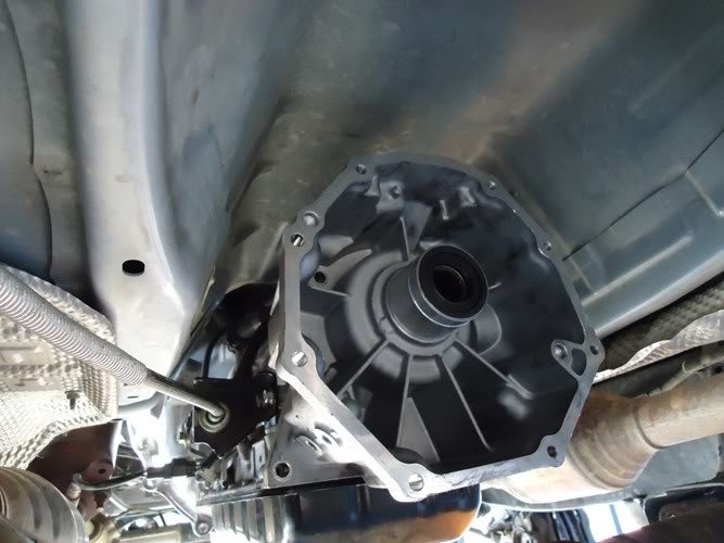

    Internally the transmissions are the same. It's just the rear output shaft and extension housings that are not the same. They also use very different transmission mounts and cross members between the two.
    Could I just swap the output shaft and extension housing for the transfer case to bolt up? I know the crossmember would require mods, but i am just trying not to replace my 65k mile transmission.

    @BamaTaco56 This will give you a good idea of the crossmember!
  15. Jun 1, 2020 at 8:35 AM
    #55
    BamaTaco56
    BamaTaco56 Well-Known Member
    Mar 25, 2017
    #214383
    10,306
    Trey
    cutting sections out of the old crossmember will definitely help getting it lined up.
